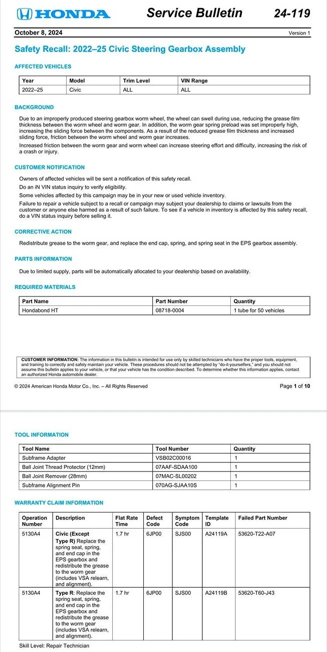

If this TSB is only paying the techs 1.7 hours on flat rate, and the subframe has to be dropped, and the steering rack removed expect some carnage Left behind. I think this time also includes the alignment, this is not enough time.

In Europe we are very attentive to the evolution of this matter. Our dealers know nothing about this issue although we assume that the FL5 sold here are also affected by this problem. It would be very useful to have the complete Service Bulletin in pdf format so that this matter can be escalated to a higher level. Thank you.
Here's the service bulletin

AKA Parts are not available yet for this recall, and they will prioritize vehicles that are having a steering issue over one without. If you aren't experiencing any issues do not try and get your car in.

This is my unofficial analysis:
The old design spec for the return spring was too high. This can result in the grease being pushed out of the worm gear's contact interface. What's interesting to note is that all non type R 22+ Civics have one part, and the Type R another.
My guess is that the Type R specific part, even in the old design spec, was on the safer side of the design range versus the regular cars. Even though problems haven't shown up in FL5/DE5s, they are moving the spring to the new "safe" spec to fully resolve the chance.
