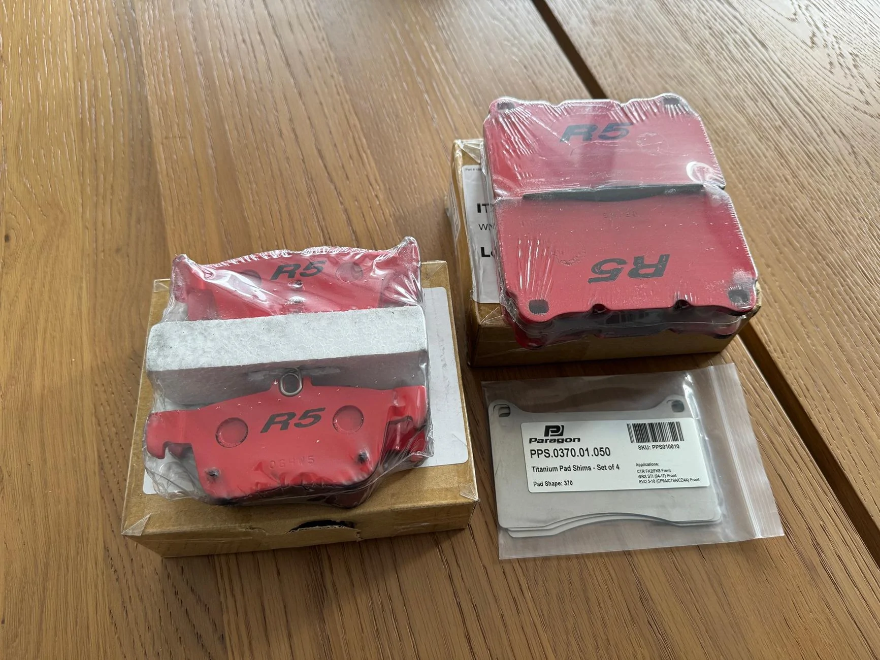

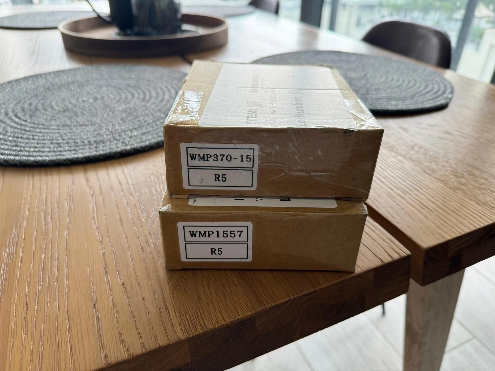

I have a track day coming up at the end of this month and my Project Mu's are looking a bit thin. So I just picked up a set of the rebranded Winmax W5 pads that everyone is talking about, along with the titanium shims.

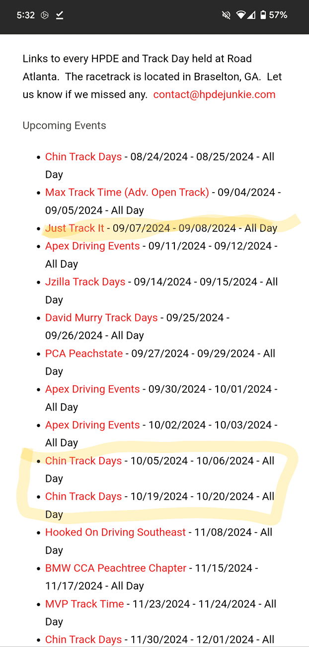

Anyone attending either of these weekends at Road Atlanta?

I have the three you highlighted on my radar but have not decided yet.

Same here. I am leaning toward the 2 dates with chin since I have 2 local events Aug 24 and 25th. Sept 7 and 8 may be a little close together for me.
