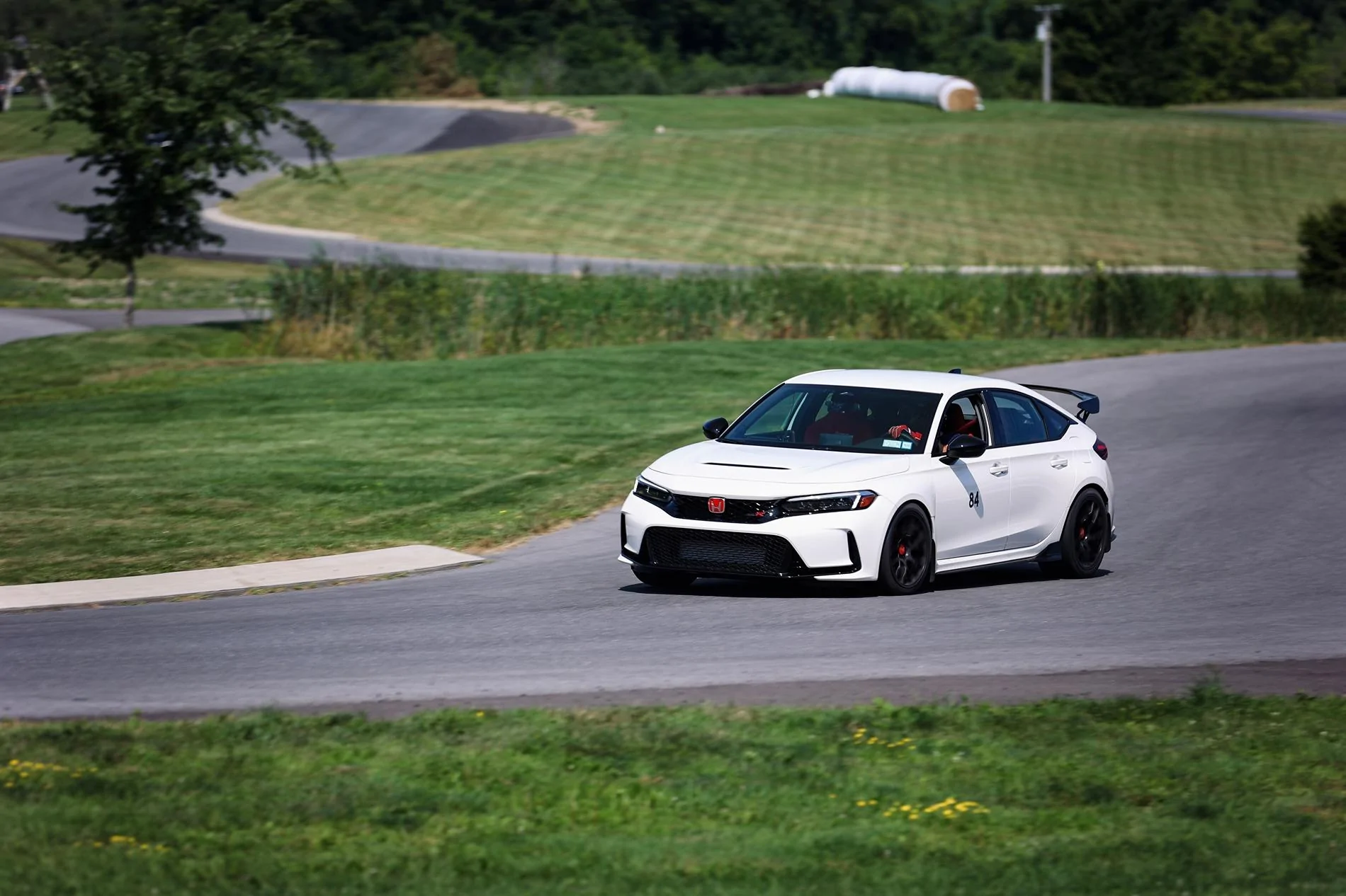

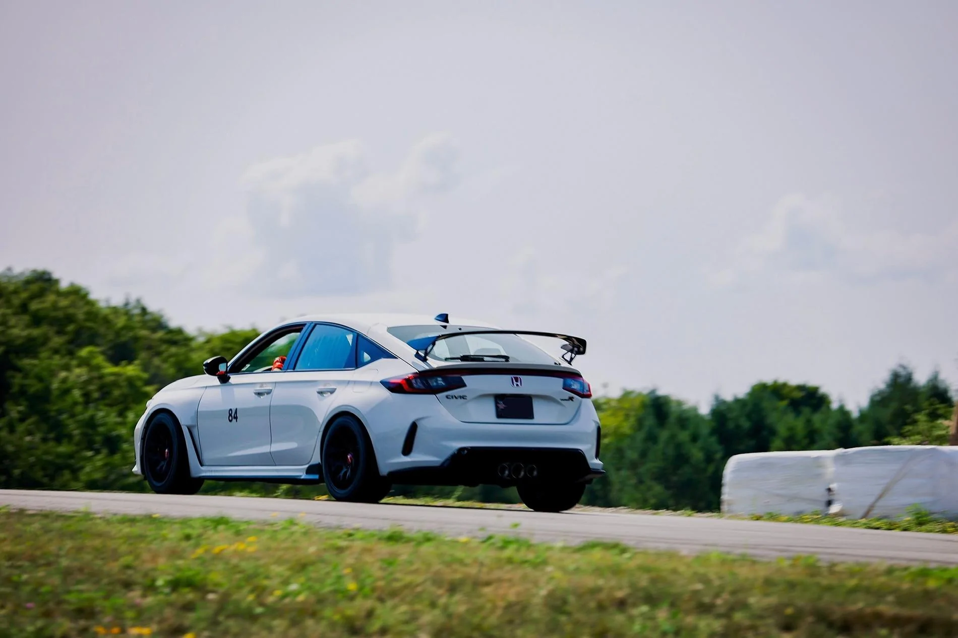

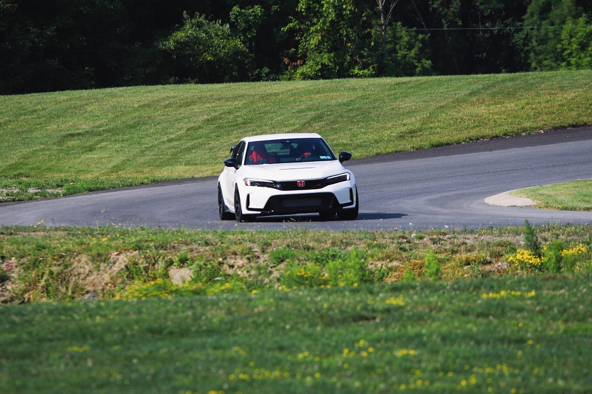

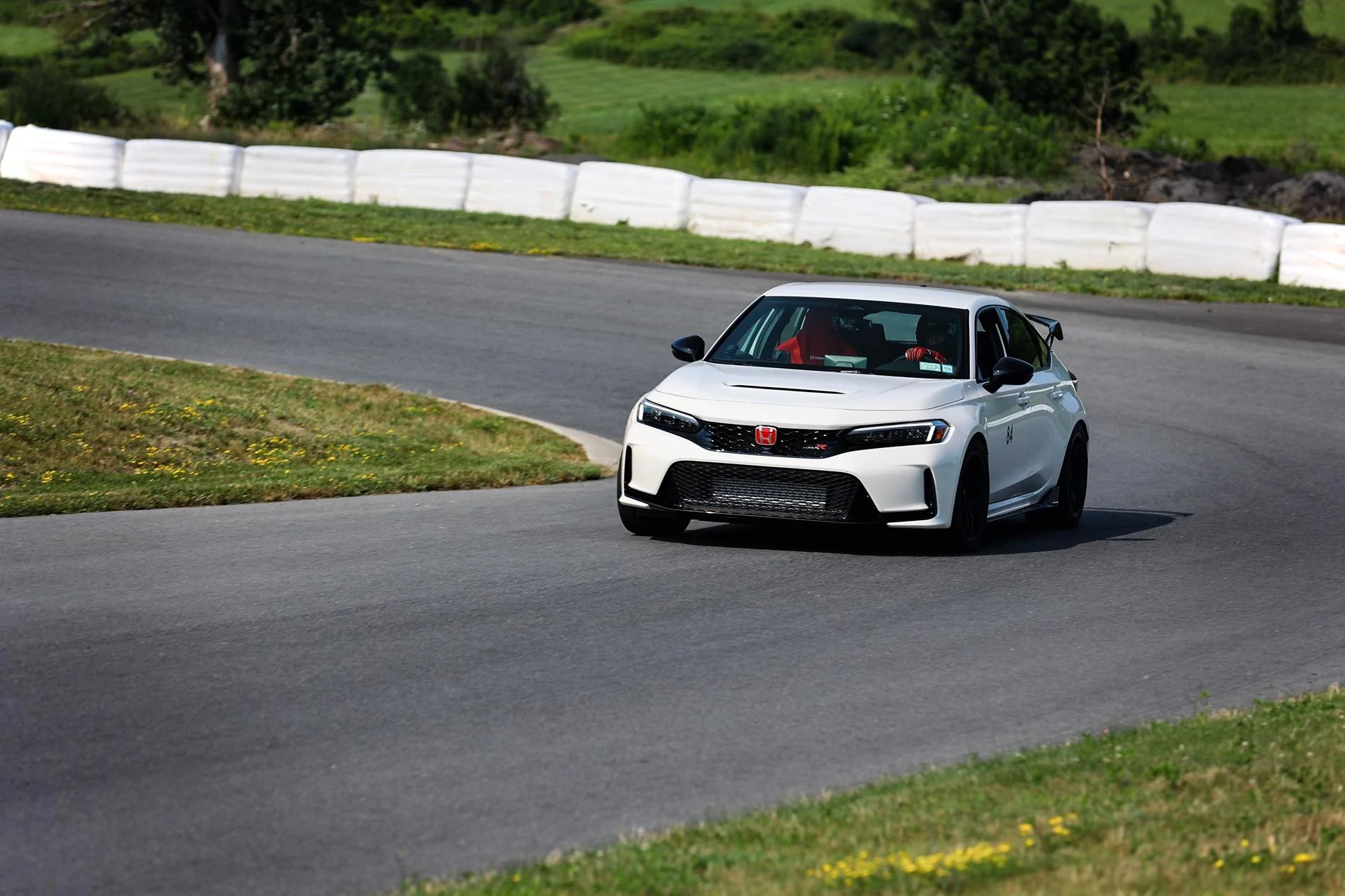

Awesome day at Pineview run. What a car. Very fun track, 1.8 miles and felt more like a big auto cross with a faster straight (like 90mph) and rest lower speeds, very technical. A bit bumpy as they are still working on it but a lot of fun. I had no idea what the line was (could not find anything on youtube with a guide since its a fairly new track) so I spent the whole day just having fun and trying to figure it out. Car did not even come close to over heating, was only 80 out and I was not pushing that hard/not a super fast track.
Still struggling with the brake judder, although was way better than my last track day where the car was barely drivable. It got much better after sanding the pads but after a couple of events its back at the same. I think its the paragon pads, they are prone to leave deposits. I can't say for sure but I am going to get something else, likely either CSG or Ferodos.

Give the ebc sr11 a try. Curious other thoughts on them.
Looks like a fun track. Similar to my local track I think. Did it flow well despite being busy?

will look into EBC SR11, thank you.
The track flows pretty well, pretty fun. At first I thought there were going to be too many people on it (its not a super short track, 1.8 miles but being a bit of a slower track since very technical) but probably the best I ever seen with the point bys, people were on point and giving out point bys immediately which meant things were flowing nicely and for the first time I never once ran into a train.
