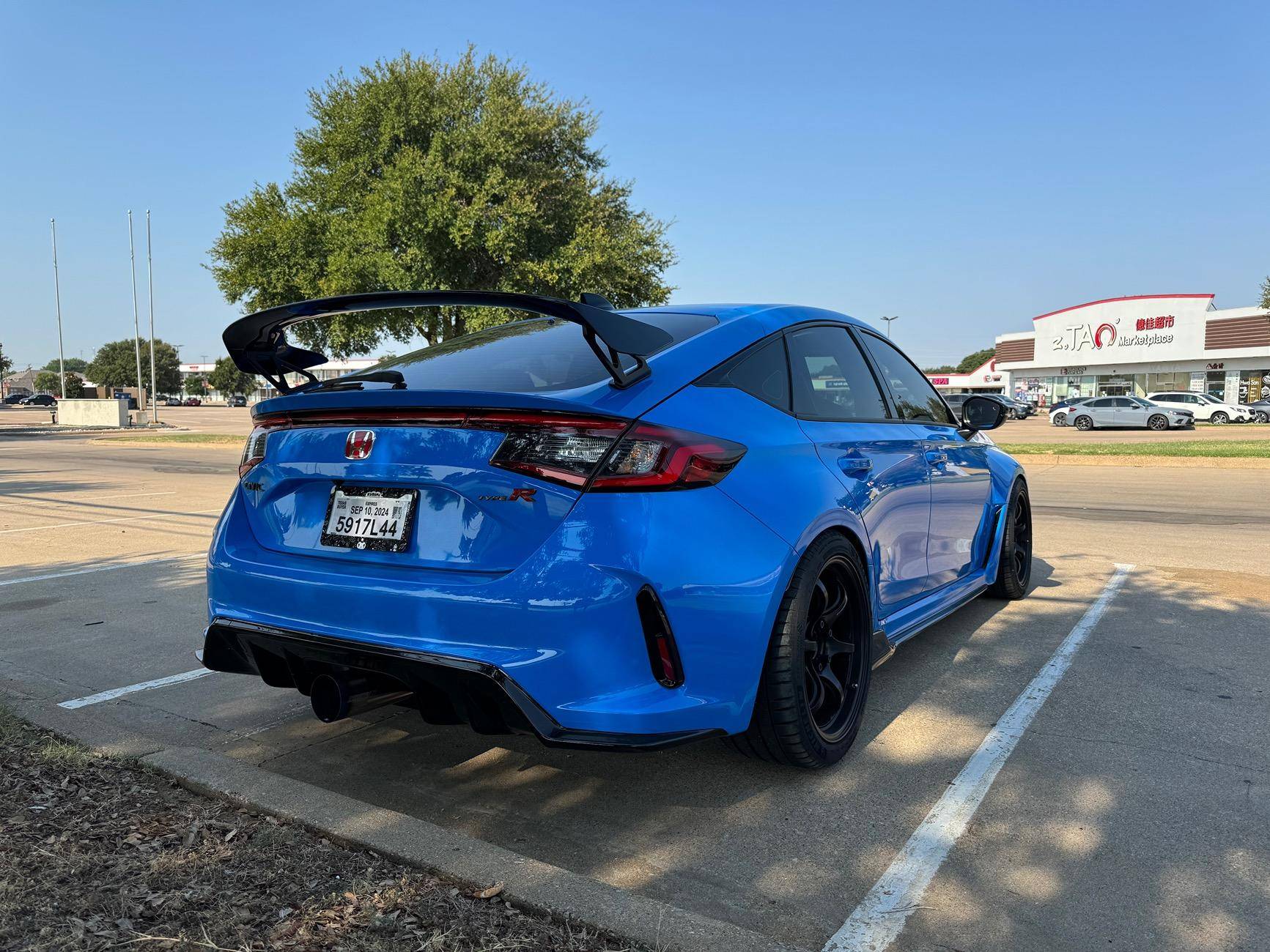

Does anyone here that’s lowered run a 18x9.5 +35 wheel with a 275/35 tire? Just curious…
Here's another member running that spec. A lot of people on the FB groups run this spec. I've seen as low as +22 on a 10.5 wheel on 275s with added camber.

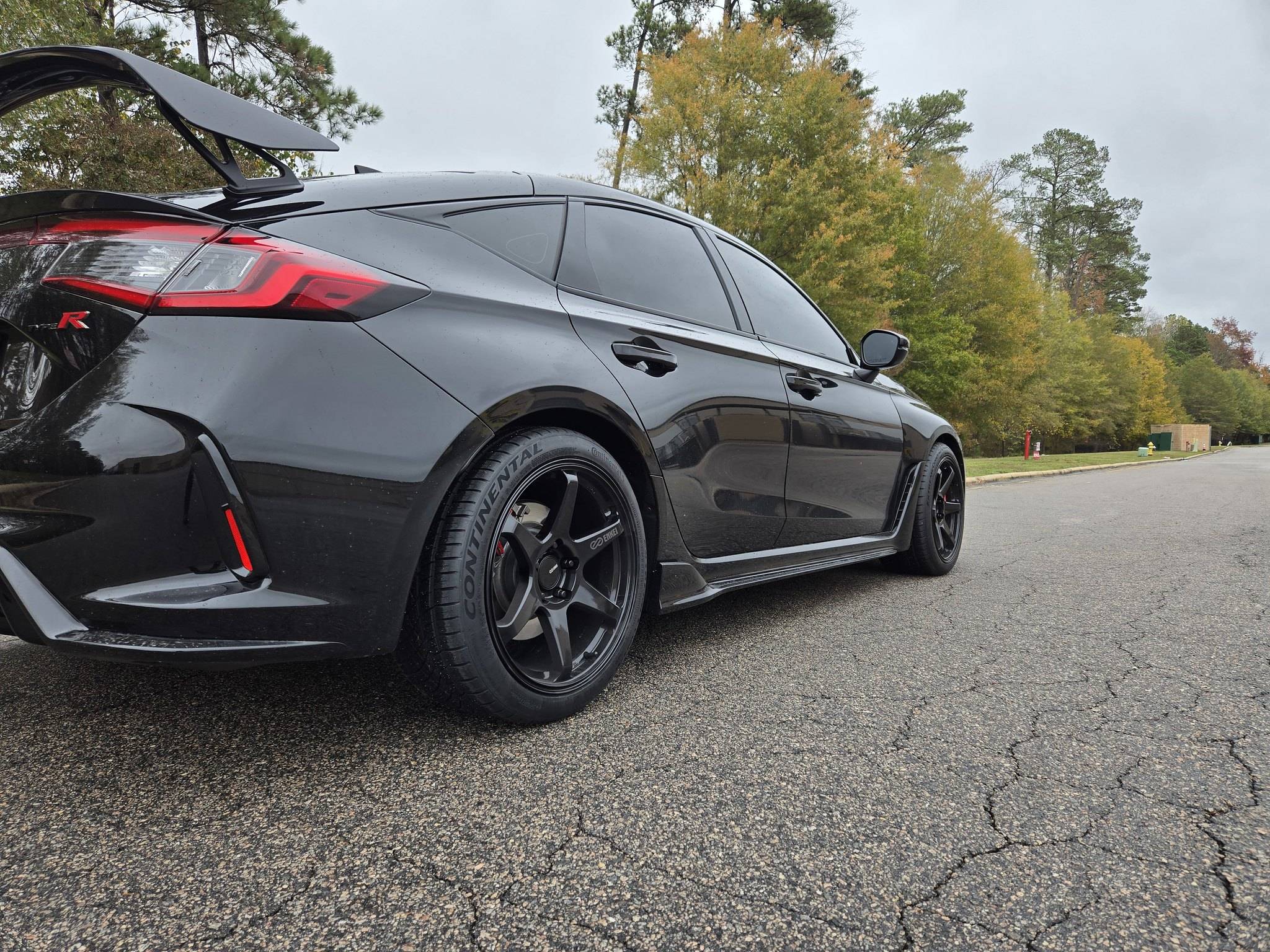

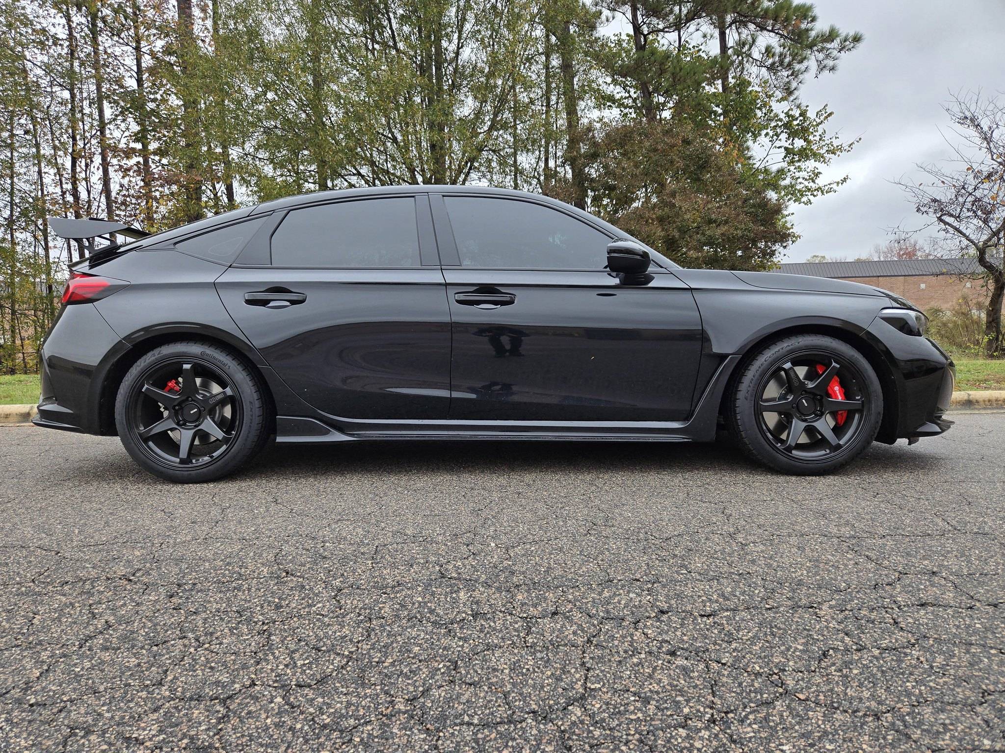

Late Fall\Winter Setup [OEM Suspension\Height and OEM alignment]
Wheel: Enkie T6R -- 18x9.5 ET45 -- Bore 72.6 -- [Part#: 539-895-1245BK]
  • REQUIRED: TireRack provides Hub Centric Ring 72.62mm to 64.10mm plastic adapter
  • REQUIRED: TireRack provides Gorilla Lug Nuts - Black M14x1.5 [Part#: 41148BC]
    • TireRack provides the two items above for free when ordering Wheel\Tire Combo and having them mount the tire on the wheel for home delivery
Tire: Continental ExtremeContact DWS 06 Plus -- 265/35/R19 [Part#: 1557328]
The overall diameter is only 0.55mm more, which is a difference of -0.17% on the speedo [BEFORE 60MPH = AFTER 59.9MPH]. So you pretty much don't have to worry about speedo correction. Wheel offset gives it a near flush look.

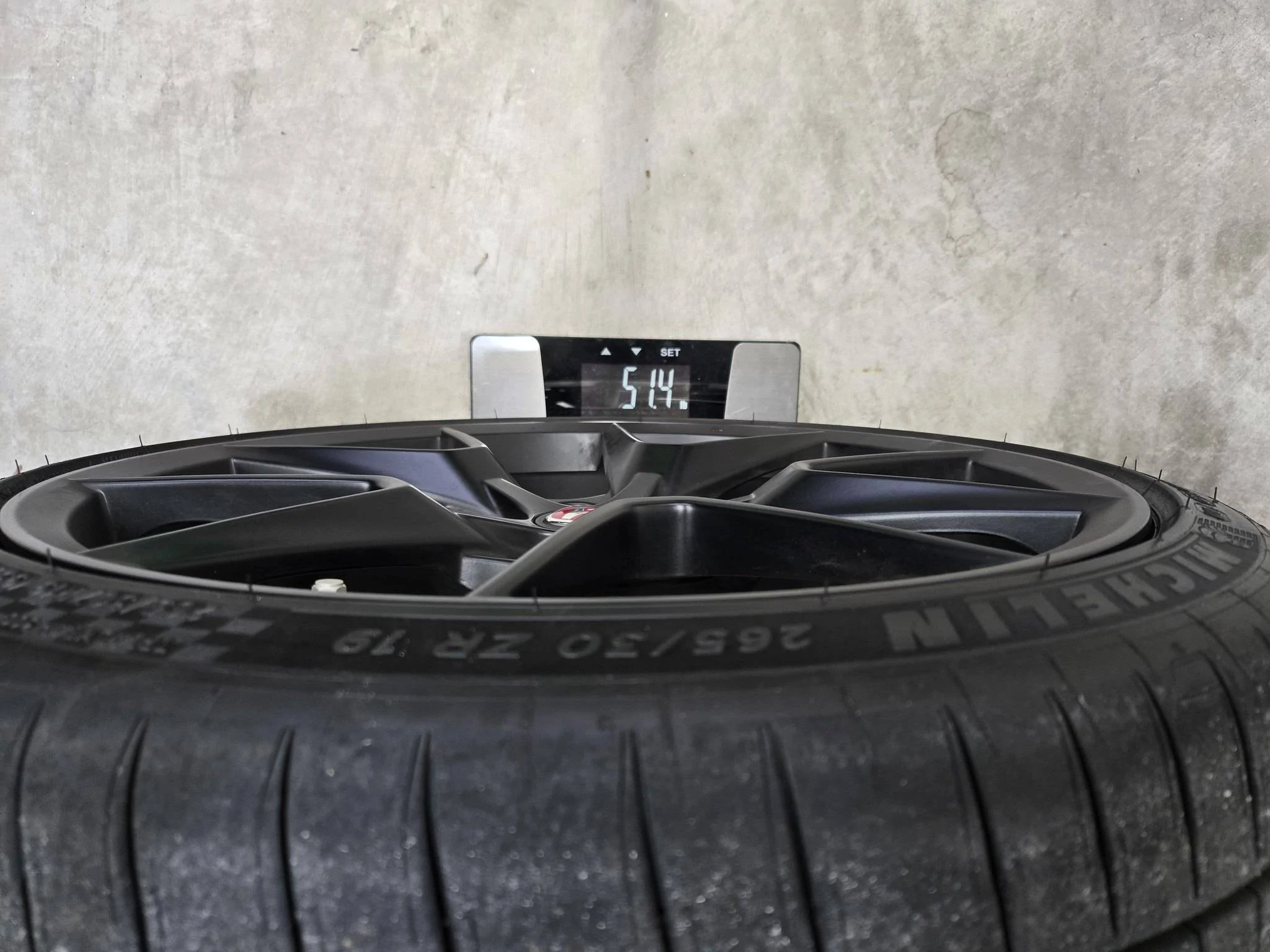

Weight Difference:
OEM\PS4S: 51.4lbs
Enkie\DWS06: 45.6lbs
Nearly 6lbs lighter [Continental's are usually lighter tires compared to Michelin too]

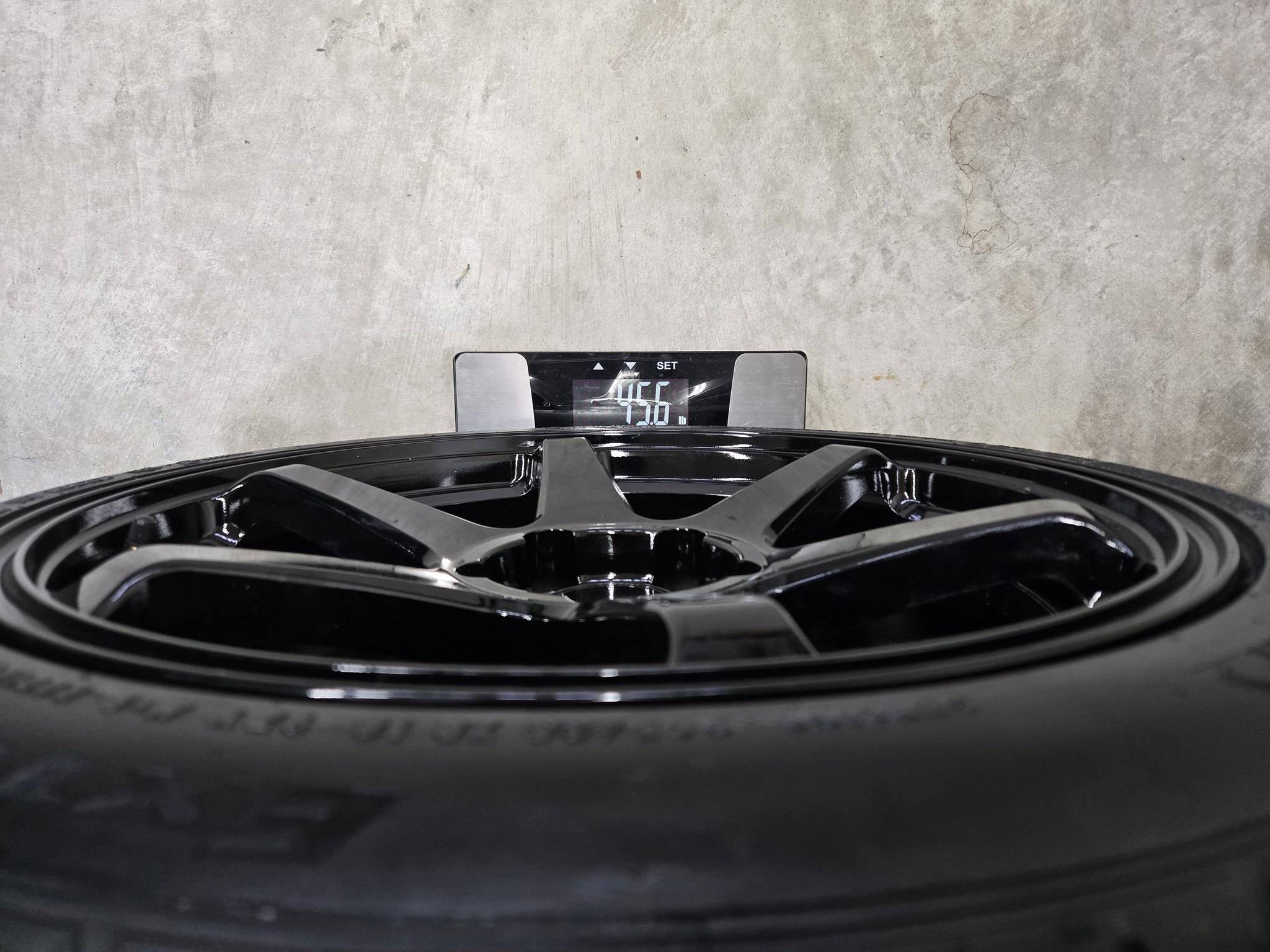

Unfortunately one wheel had two scuffs on the lip from what appears to have been damaged during tire installation and not shipment. Either case, TireRack is sending me a wheel replacement. In the meantime I did weigh the OEM and Aftermarket setup to compare:
OEM\PS4S: 51.4lbs

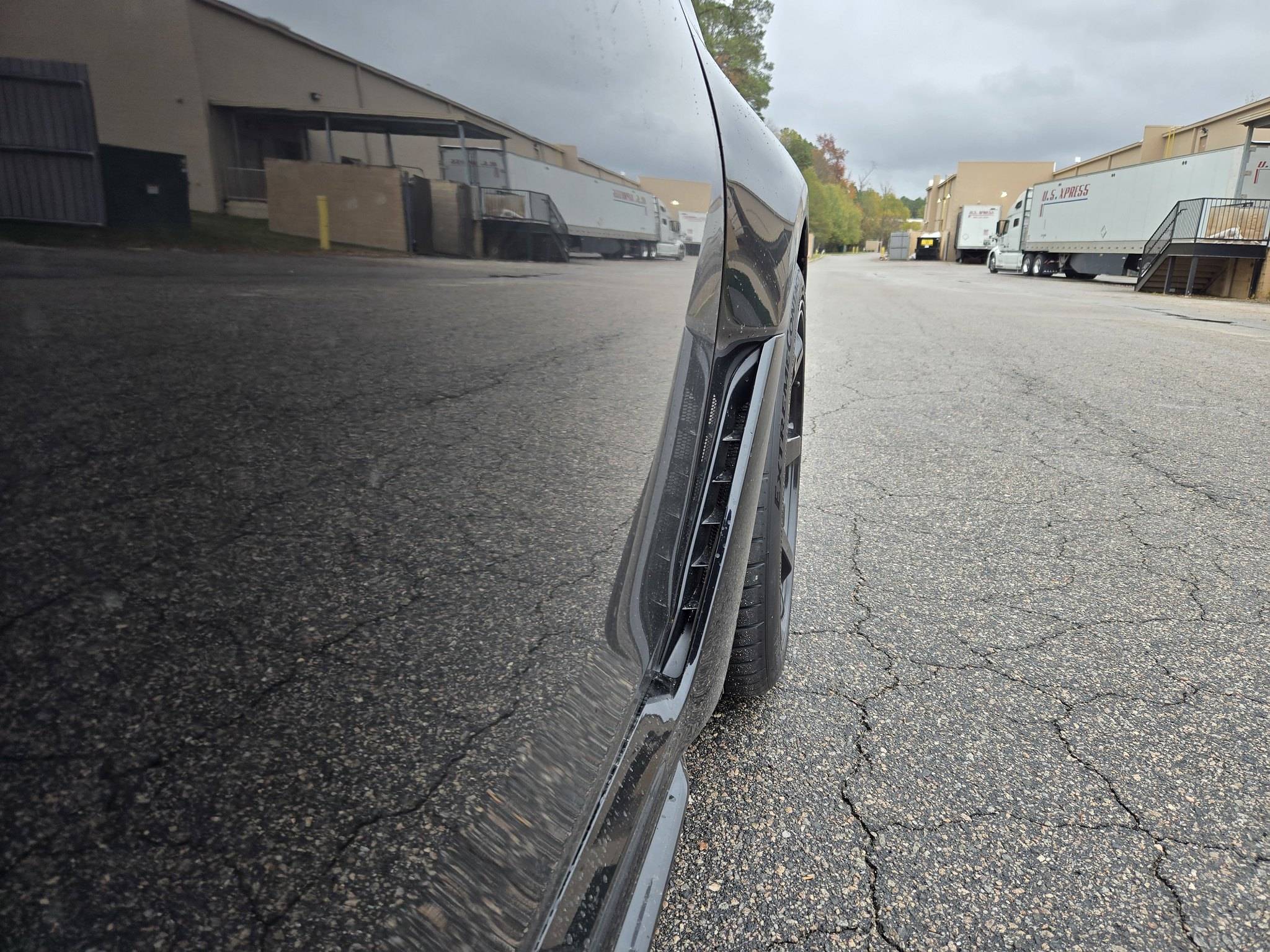

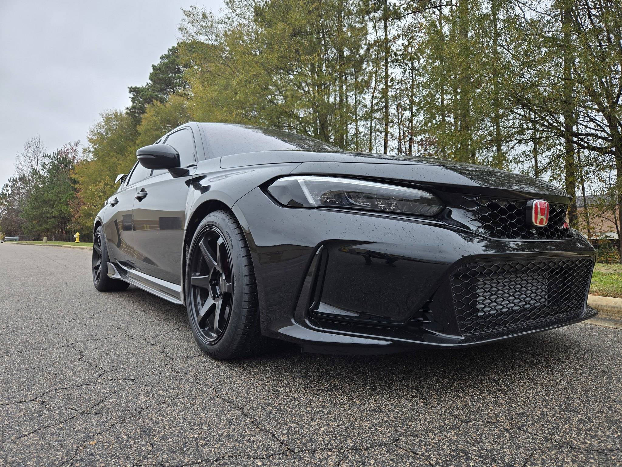

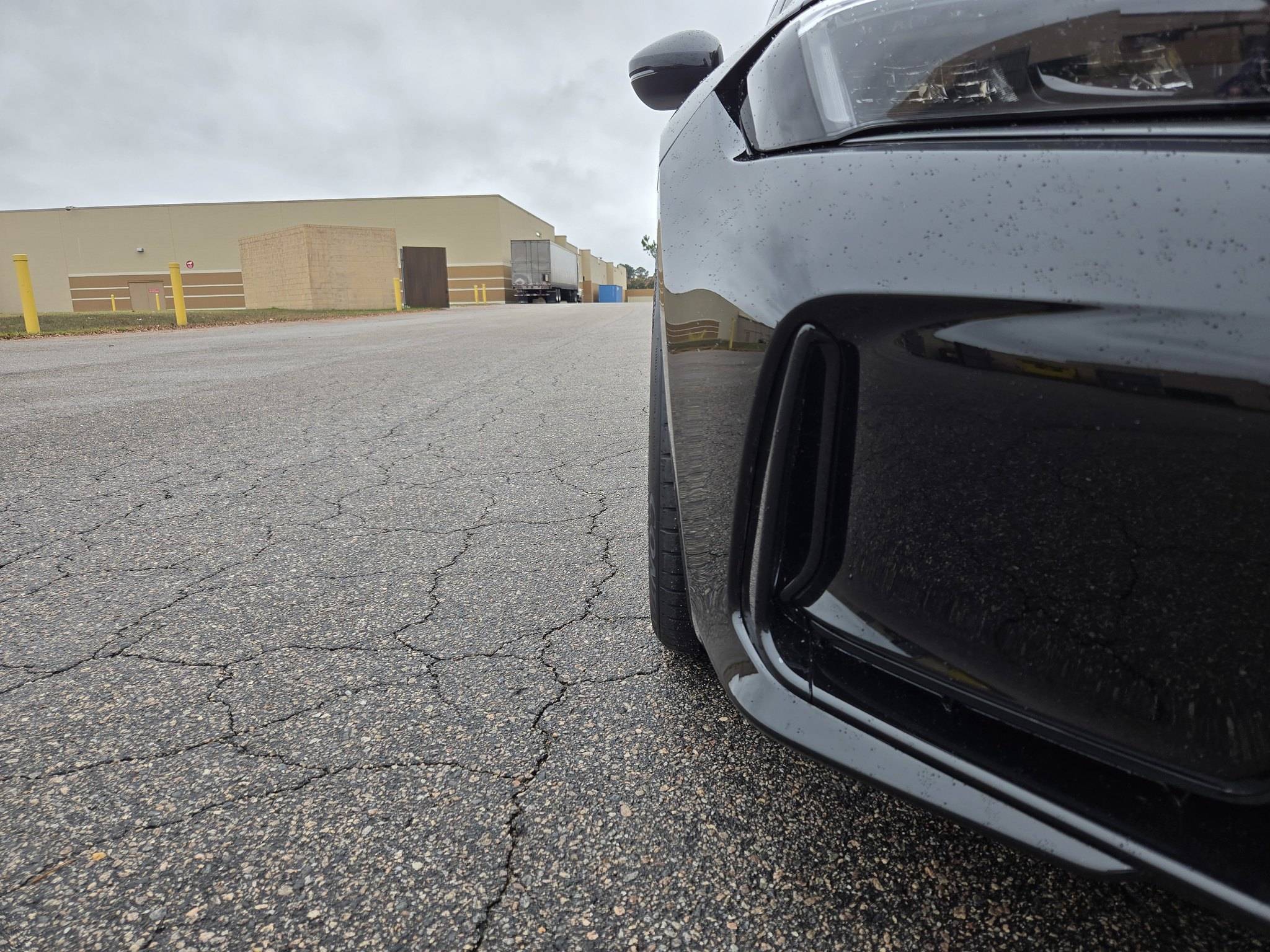

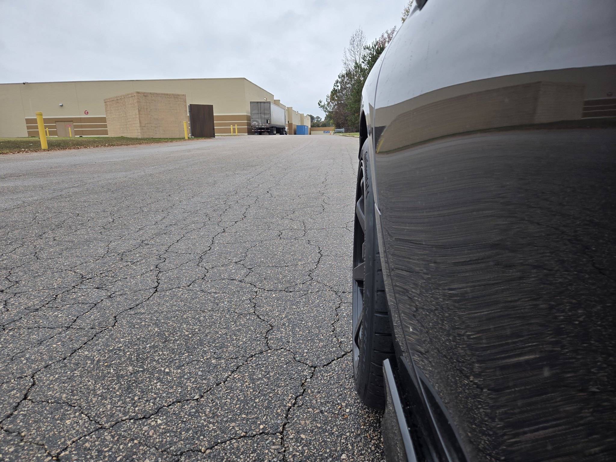

I'd love to see more pics of this setup from the side showing poke etc. They look nice from that view.
Starman703
Nov 12, 2024
RTP, North Carolina
2024 Type R

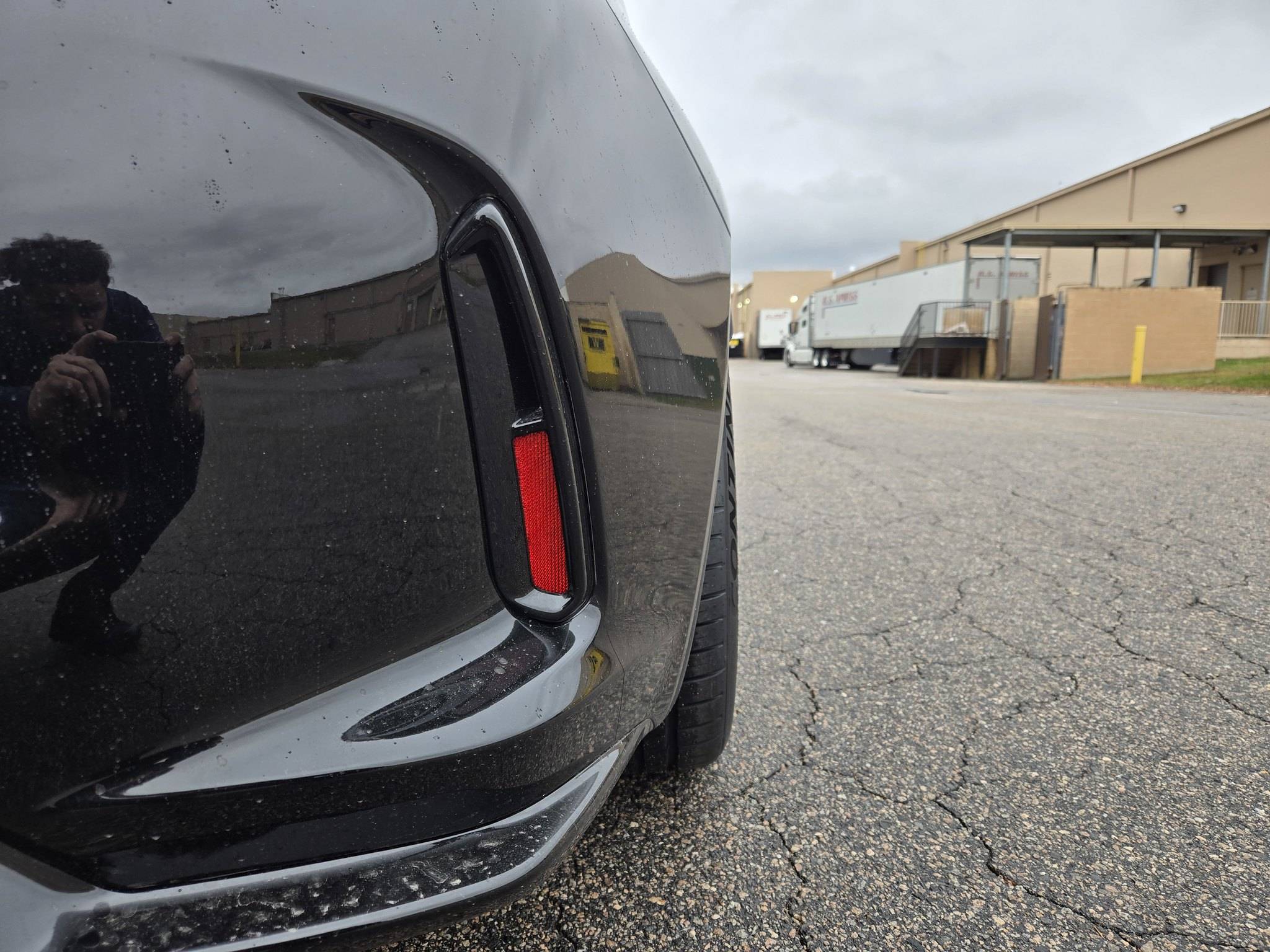

Yeah I had mounted only one and saw the one wheel damaged in two places. So I took it off and put OEM for now. Tire Rack is sending me replacement wheel, hopefully next week I'll receive it and mount all 4 with more pictures

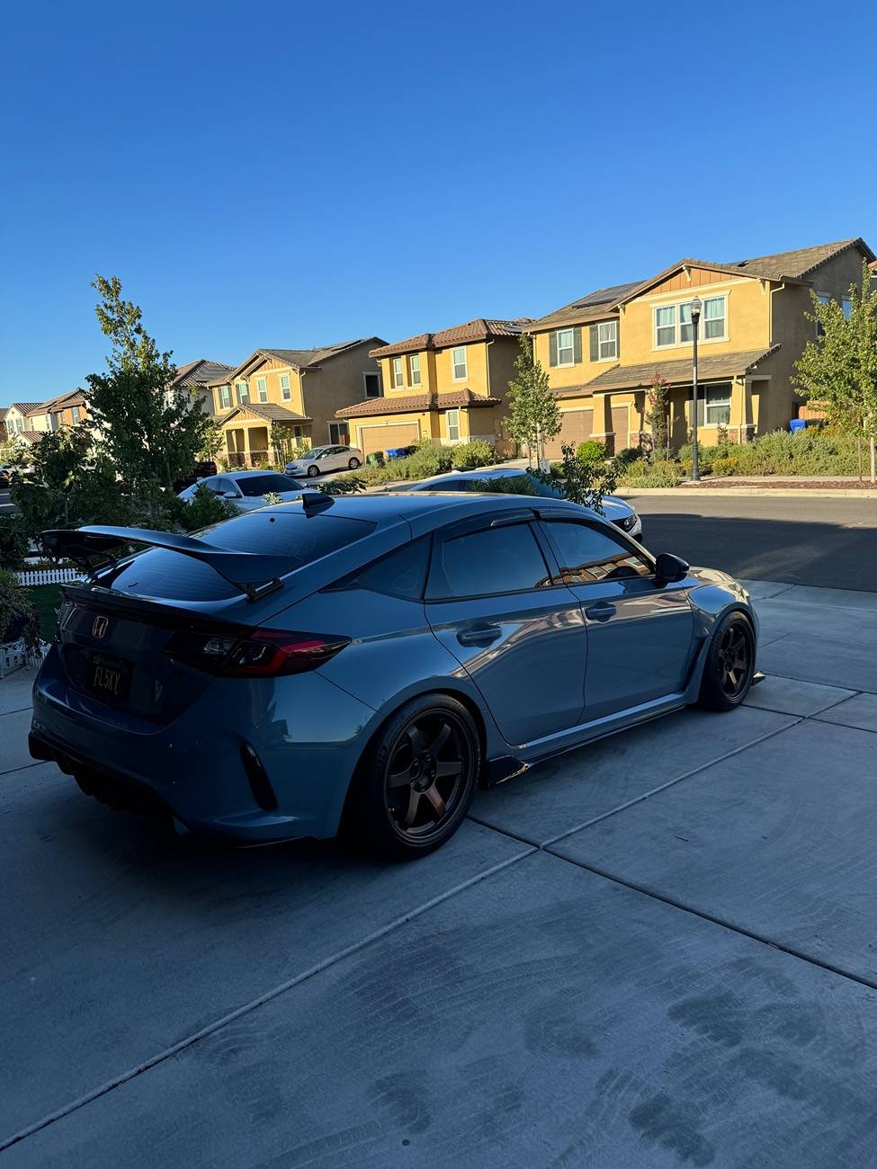

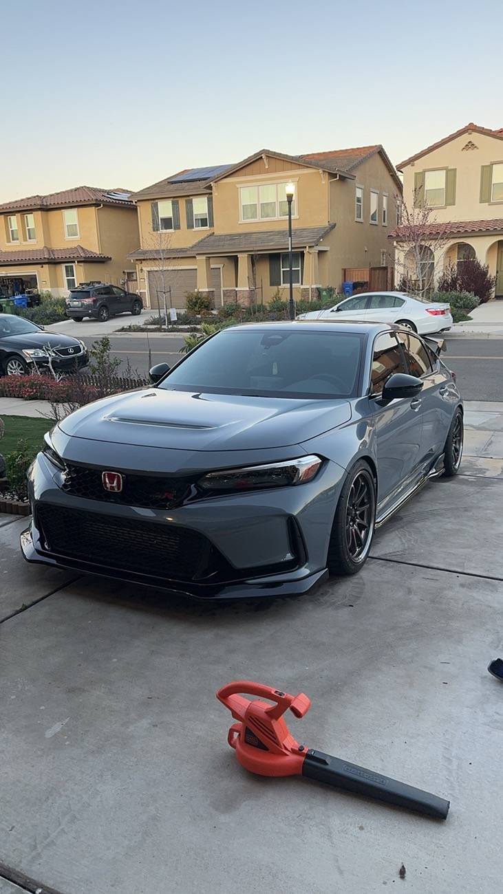

previous setup with my CE28s (18x9.5 +35 w/ 265/35 tires) and current setup with my Te’s (18x10 +40 w/ 265/35 tires). No rubbing with both setups, lowered on swift springs w/ natural rear camber and -3 front camber with ball joints. Gonna get coils soon to adjust the height a bit lower.
