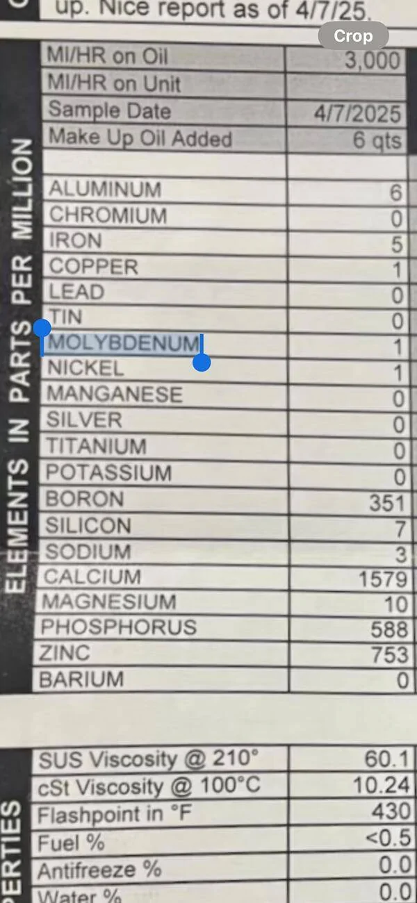

Ok this Blackstone result is pretty interesting.
This is API SP Motul 5w-30 Power 8100.
Ran 5 Track days and 3000 miles.
This is from my friend that is extremely aggressive at Laguna Seca with his FL5, Aggressive suspension, ~1.39 Laguna Seca time, dual oil coolers etc....
What we're confused about - maybe someone knows - How can moly be at 1 ppm ??!!! We requested blackstone to come back with an Answer.
Anyone got a VOA virgin oil analysis of Motul power 8100 5w30?

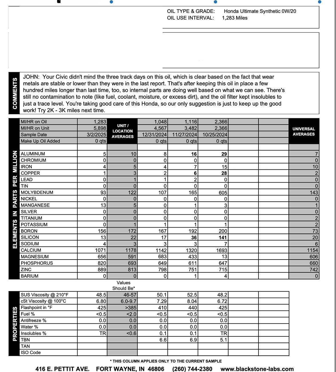

OPs Honda Ultimate Full Synthetic 0W20
This is the Virgin Oil Analysis, meaning this is a baseline of what the Oil looks like.
This is OPs Report from using the oil. You want to look at the cST Viscosity and SUS Viscosity numbers which are at the bottom. These values are important because it is showing how viscous the oil is and how much protection/lubrication the oil is providing the engine
You can see the base values have dropped. This means that the oil had thinned out and is no longer providing the expected lubrication for the engine.
SUS - 11.8 point drop : 60.3 to 48.5
cSt - 3.49 drop : 10.29 to 6.8
I have only used Amsoil Signature Series 5W30 and based on my reports the Viscosity drop values are nowhere near that range.
VOA for Amsoil SS 5W30 With my Report
SUS - 2.6 point drop : 59.3 to 56.7
cSt - 0.79 point drop 10.03 to 9.27
All oil will thin and SUS and cSt values will drop from a VOA simply because the oil is being used and degraded but you can see that with Amsoil the viscosity isnt degrading nowhere the same rate as Honda Ultimate 0W20. Amsoil 5W30 is still maintaining its baseline Viscosity ratings with minimal drop despite the high engine loads of track use. Degradation is minimal and the service interval can be pushed out more. I added 2,000 miles and did 3 track days so the Viscosity Ratings should be lower, but how low? Idk. Im waiting on the results

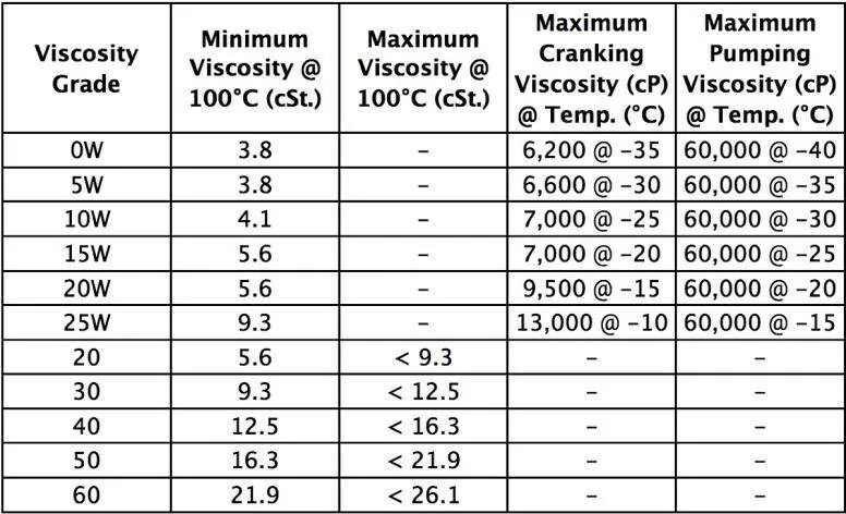

I've also looked at that site and the data looks incorrect at 10.29 cst at 100c.
First, indicator that it is possibly incorrect is that, 10.29 is a 5w/30 weight oil.
The typical viscosity range for 0W-20 oil at 100°C, measured in centistokes (cSt), is:
6.9 cSt to 9.3 cSt at 100°C
SAE GradeViscosity at 100°C (cSt)
0W-206.9 to 9.3
You would be correct, that going from 10.29 cst to 6 would be bad, but we already have the same exact oil lab tested below. The 10.29 cst is incorrect data online. The Honda Ultimate 0w20 came back from the lab at a 7.99 CST at 100c.
Here are the typical ranges:

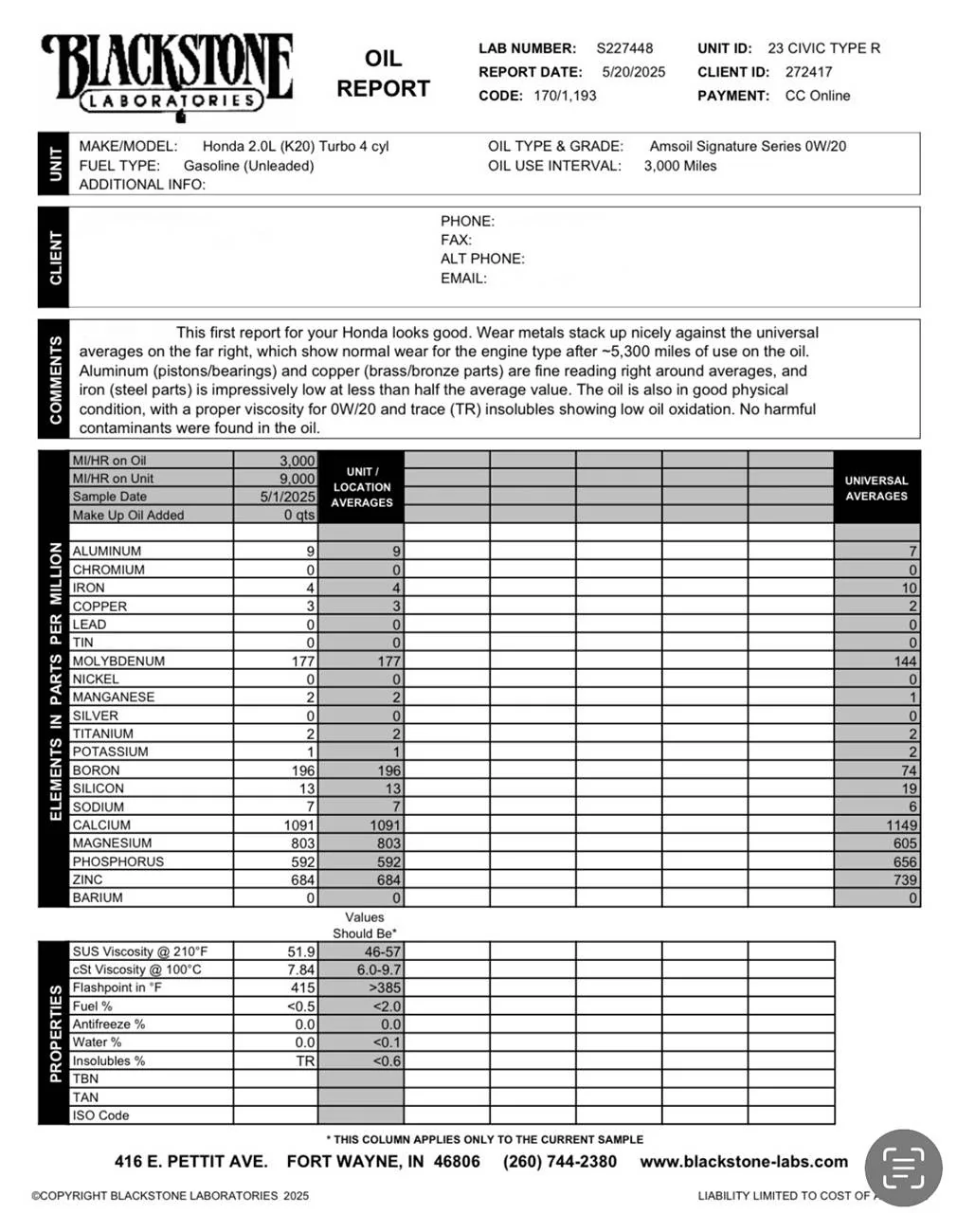

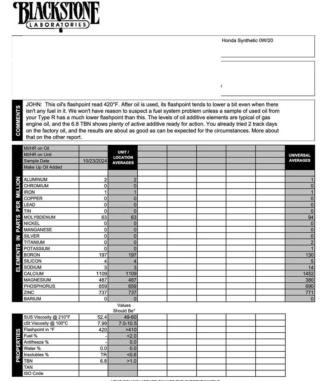

We lab tested the VOA ( Virgin Oil Analysis ) of the Honda Ultimate 0W-20 full synthetic and it's at 7.99 CST at 100c.
11th Gen Honda Civic 🔴💊 Engine Oil Red Pill Thread: Only Post If You Have UOA - Official Honda Civic Type R K20C1 Engine Oil Analysis 1745822496554-vh
When you are looking to compare results, check out the lab results of the virgin sample first, then second, compare it to the used oil sample from the same lab, and same oil batch - tested together - for best accuracy. Sometimes oil formulas do change through the year - without notice to customers.
For this test - it was sent in at the same exact time, to the same exact lab, from the same exact batch of oil -- to ensure we are controlling the variables.
There is only a ~1 CST reduction based on the exact same oil tested before and after 2-3 track days.
And Aluminum is at now 5ppm showing it is protecting the engine very very well. The wear metals are the ultimate truth and validator.
11th Gen Honda Civic 🔴💊 Engine Oil Red Pill Thread: Only Post If You Have UOA - Official Honda Civic Type R K20C1 Engine Oil Analysis 1745822508502-w5
Hope that helps,

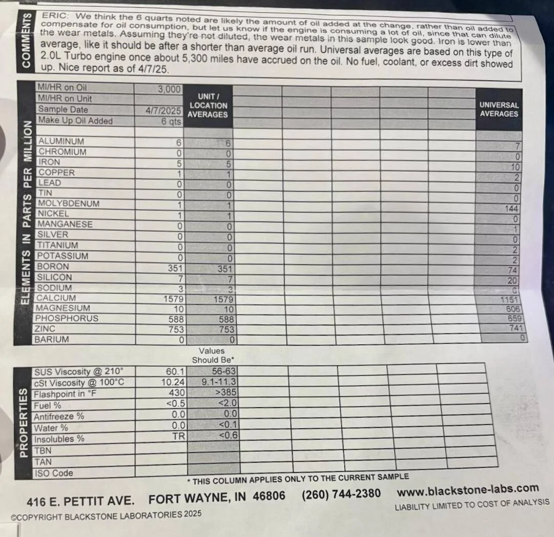

Blackstone, called my friend back.
Looks like, ApI SP Motul Power 8100 doesn’t use. Moly, but protected the engine very well.
“ Motul 8100 is formulated without molybdenum. Boron, phosphorus, and zinc perform the same function though, so this is still perfectly good oil and it clearly worked well at keeping internal parts healthy.”
Very interesting... I've never seen an API SP engine oil without Moly, perform this good. Learned something new.
Remember look at the PPM of Aluminum and wear metals, to truly understand how well your oil is performing.
