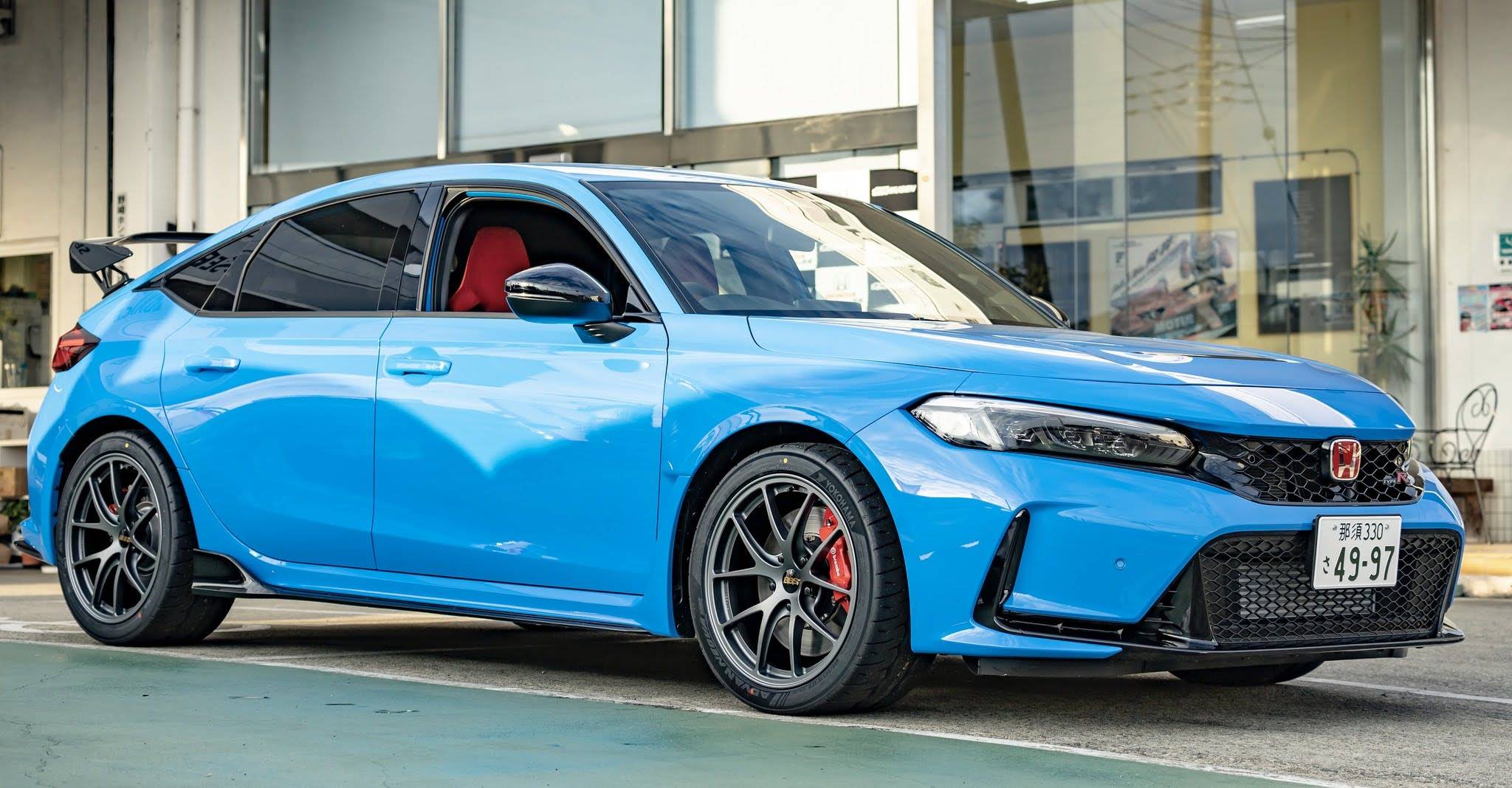

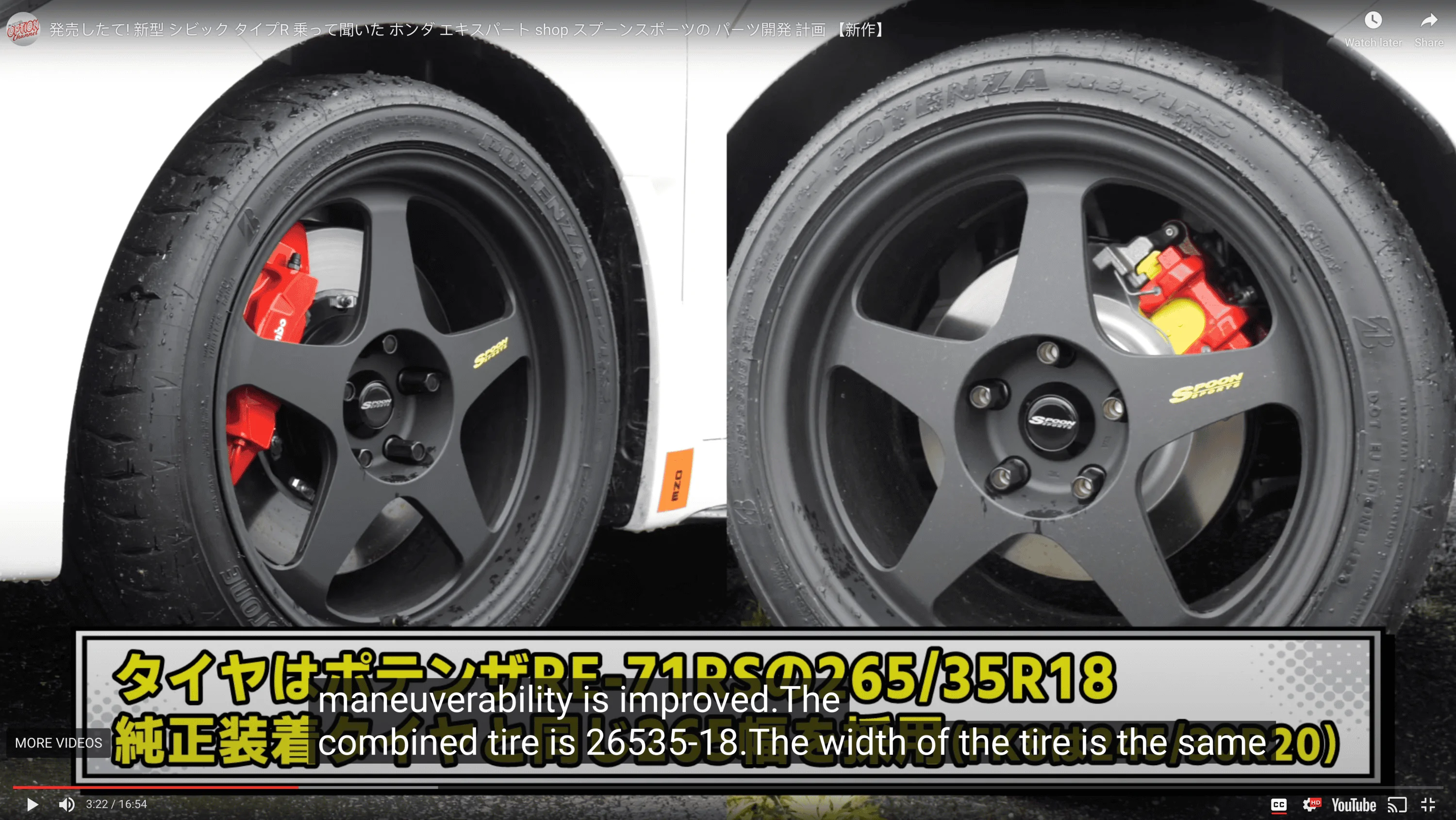

@System Motorsports Looks like Spoon is running 265/35/18 as well :)
Correct! The TE37SL in 18x9.5 +45 5x120 will be the perfect fit! These boast a large concave face profile (whereas other TE37 variants do not). We are very excited and can't wait to get these on the car!
