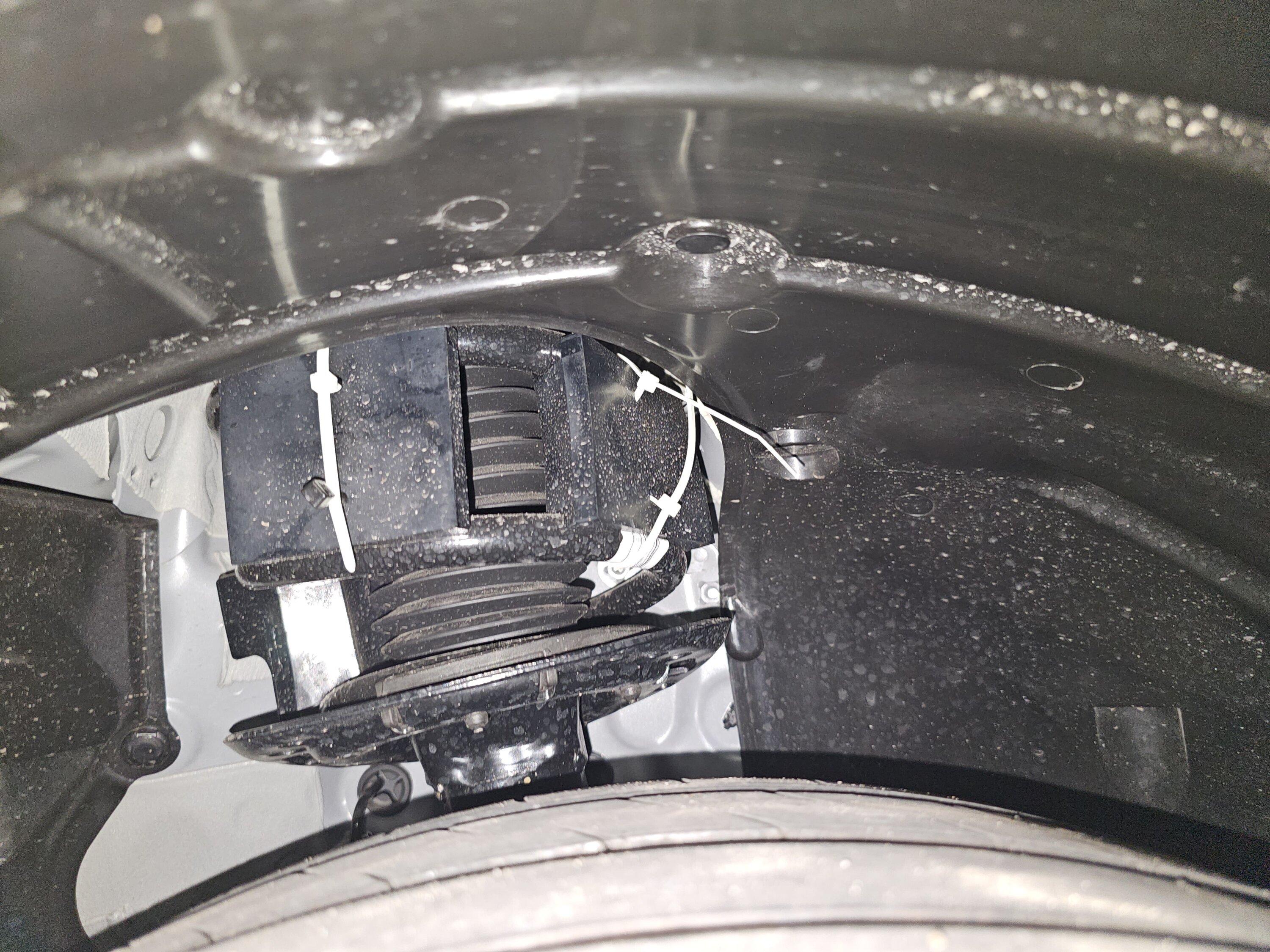

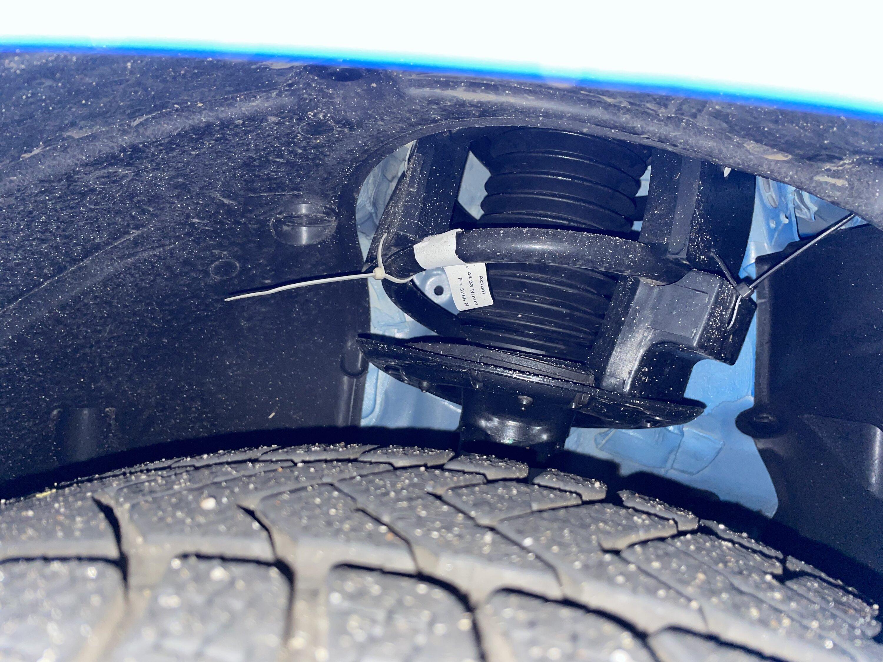

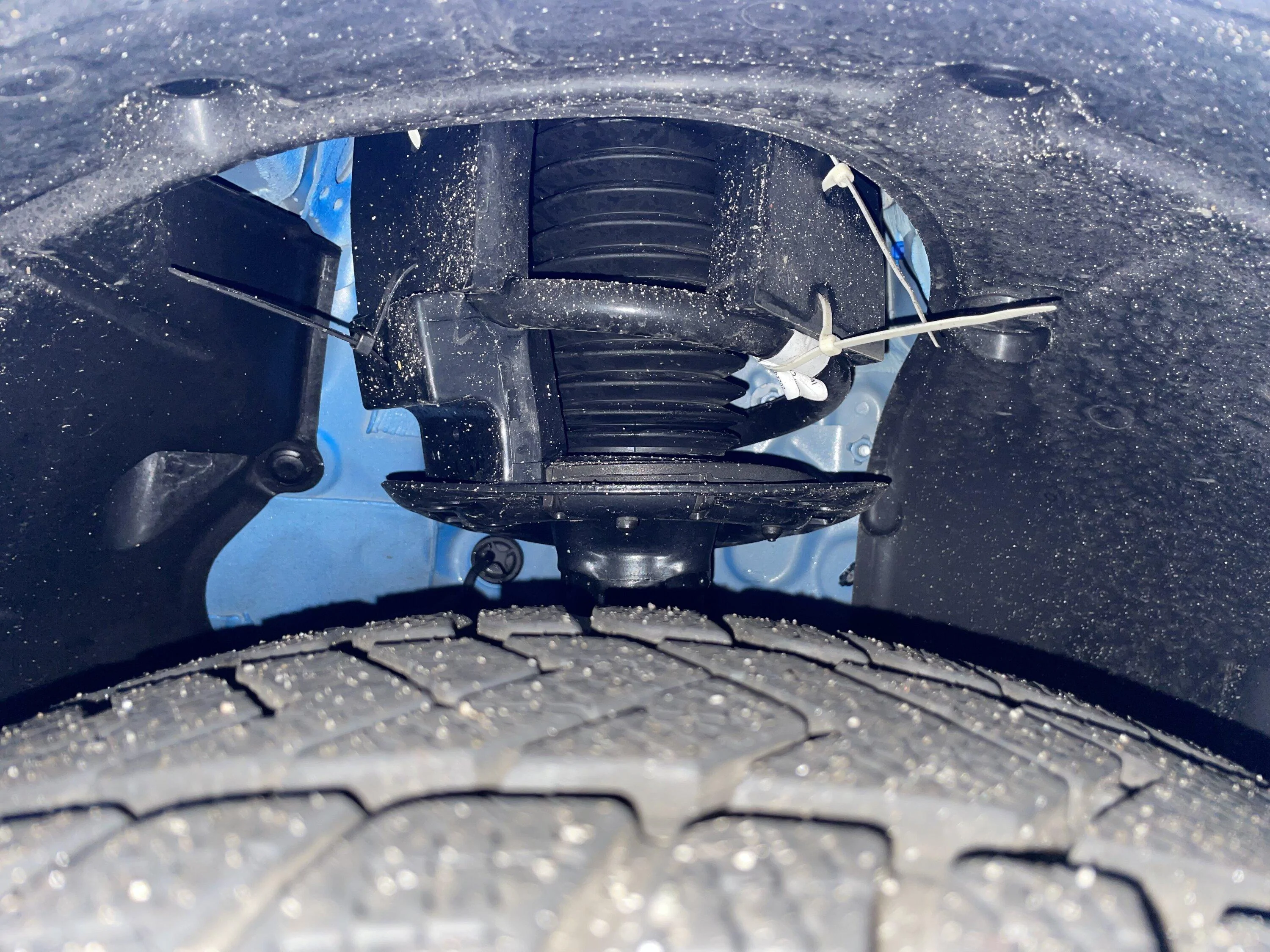

Yup. Can confirm my dealer missed mine. Drove home 65 miles on them. Noticed the car was sitting a bit high and thought, "well that is strange". Took a look and there they were. I did go on record with my dealer that they were there - but I just jacked the car up a bit and cut them off myself.

Same thing happened to me! Probably had 100 miles on the car since I bought it out of state. Kept looking at it in my driveway thinking, "wtf is the front end so much higher than the rear???" Lol went and looked and cut those suckers out!

Thanks all for the photos. Mine were removed, my tires were a bit high, but below 40psi

I am so glad you posted this! I have 2,300 miles and they are still on!

Didnā€™t happen with my fk8 or fl5. But I just found a fl5 at Disney with these still on. Left dude a note
