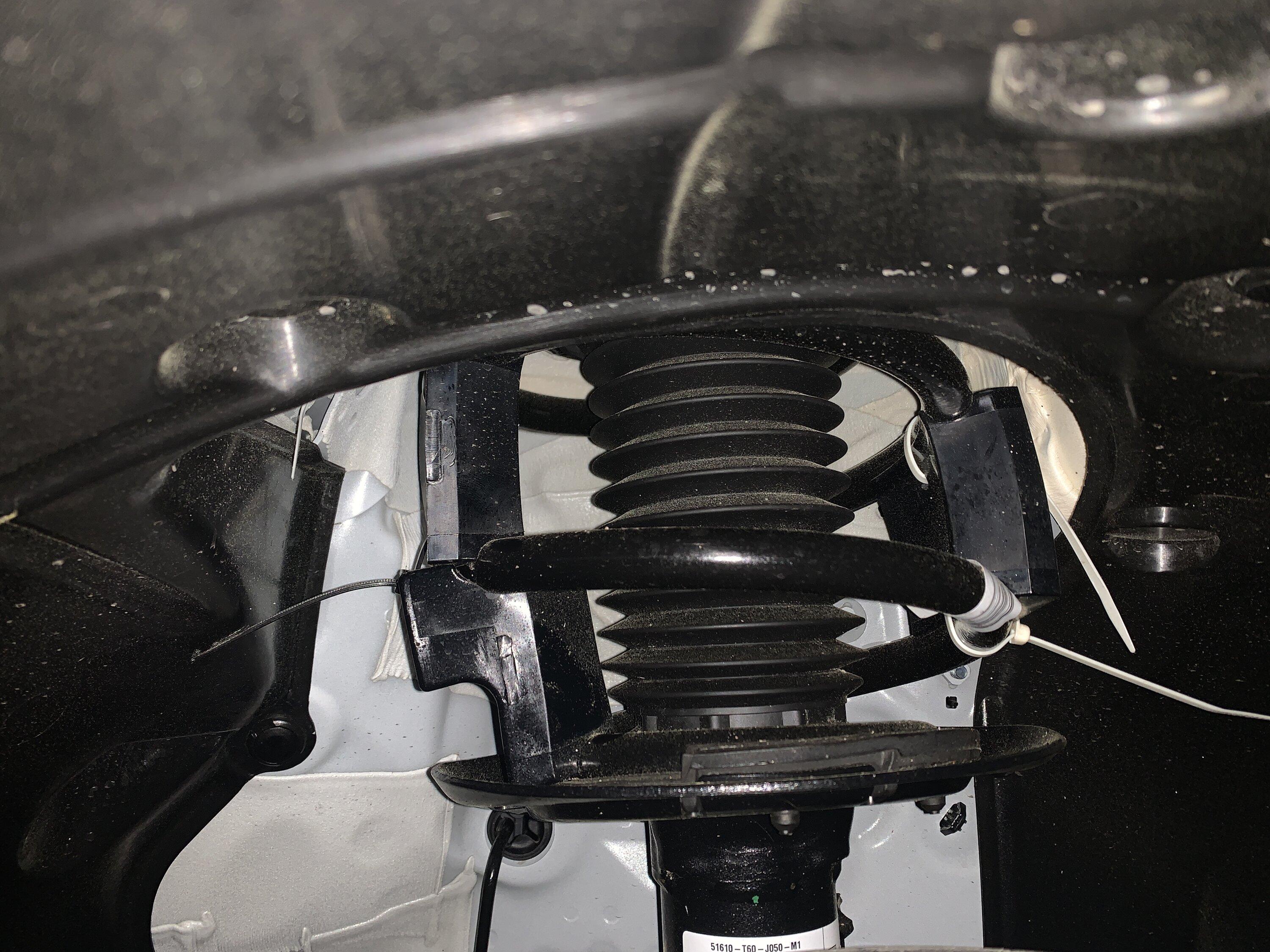

11th Gen Honda Civic Transport Blocks PSA: make sure your dealer removes suspension transport blocks before taking delivery! 3B867326-D74D-4D37-AEFA-091ED67ED9E9
Had the same problem.. I’d heard that comfort mode was stiff, but it was much stiffer than I expected. As soon as I got home I googled how to recalibrate the suspension modes thinking I might could soften it. Came upon another thread on here and saw a post about the blocks. Went to look and sure enough, blocks are still in. I’m going to ask the dealer to do the whole PDI over. I knew for a fact that they’d pencil whipped the inspections at oil changes in the past, but I couldn’t believe they didn’t even put this car on a lift. PDI check lists suspension. I’ve definitely lost some faith in the service department. If they want to make it up to me? Forged wheels please.
I might never have known if it wasn’t posted here. Thanks so much!

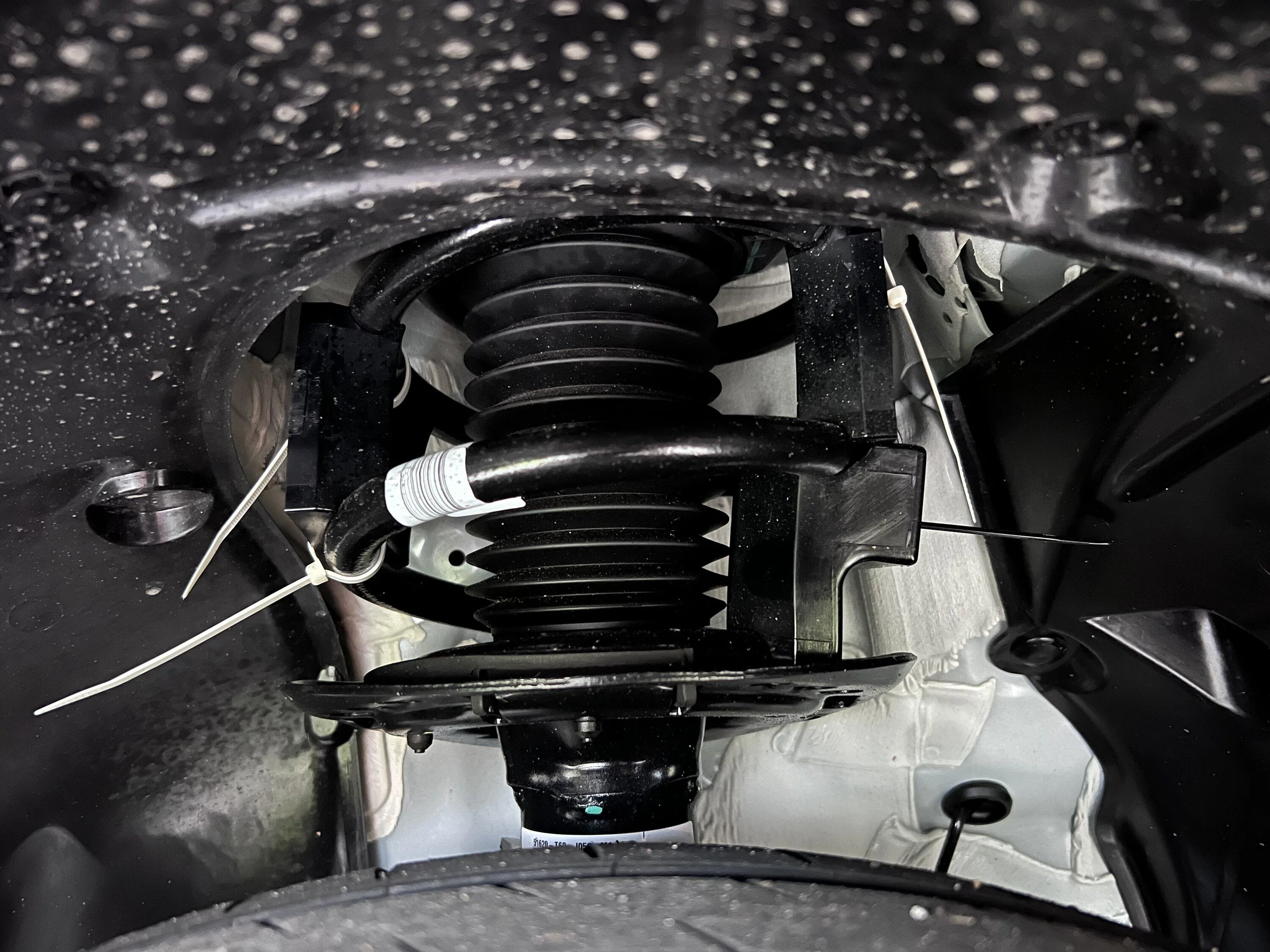

Picked mine up today and drove 120 miles. Parked the car in driveway and noticed the front-end sitting higher than expected. The dealer didn’t remove mine either. Wtf! I really don’t want to take the car back to dealer to remove. Easy enough to jack up and remove myself? I’m quite capable mechanically. Though, I’ve never removed spacers. Thanks for any input.
11th Gen Honda Civic Transport Blocks PSA: make sure your dealer removes suspension transport blocks before taking delivery! 43E6E34A-FF12-47AD-A1F6-B8C2344705D0
It's relatively straightforward. You need to take the load off the suspension by jacking the car up. Once you do that you simply cut the zip ties and remove the blocks.
