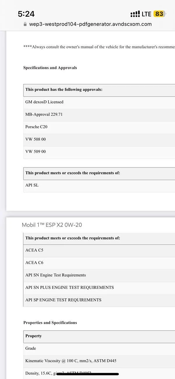

The Mobil-1 ESP 0W20 is also Porsche and MB certified so that must be decent oil for anyone looking to stick to the lower viscosity:
Porsche C20 Oil Spec
In the USA the Porsche C20 oil specification began seeing use in Porsche engines in 2019. Currently, this oil formulation is primarily used in small displacement Porsche inline turbocharged 2.0-liter 4 cylinder and turbocharged 3.0-liter V6 engines from 2019 onward. Many of these engines are used in Porsche SUV and sedan models. This is a Mid-SAPS additive (Mid Sulphated Ash Phosphorus Sulfur) level formulation, suitable for extended oil change intervals, reducing fuel consumption, reducing engine emissions, and should have a minimum high-temperature high shear viscosity HTHS of 2.6 - 2.9 mPa*s, and a minimum TBN of 6.0. The Porsche C20 oil specification will typically correspond to the ACEA C5 oil specification and 0W-20 viscosity.
check calcium levels / should be within LSPI API SP levels - try not to exceed ~1500 ppm - I can see it’s an API SL oil
11th Gen Honda Civic For occasional track use , which oil viscosity to use? Using oil data sheet for guidance IMG_6146
