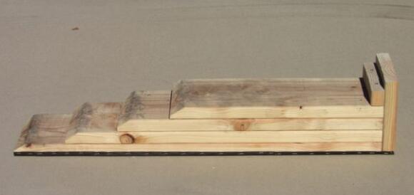

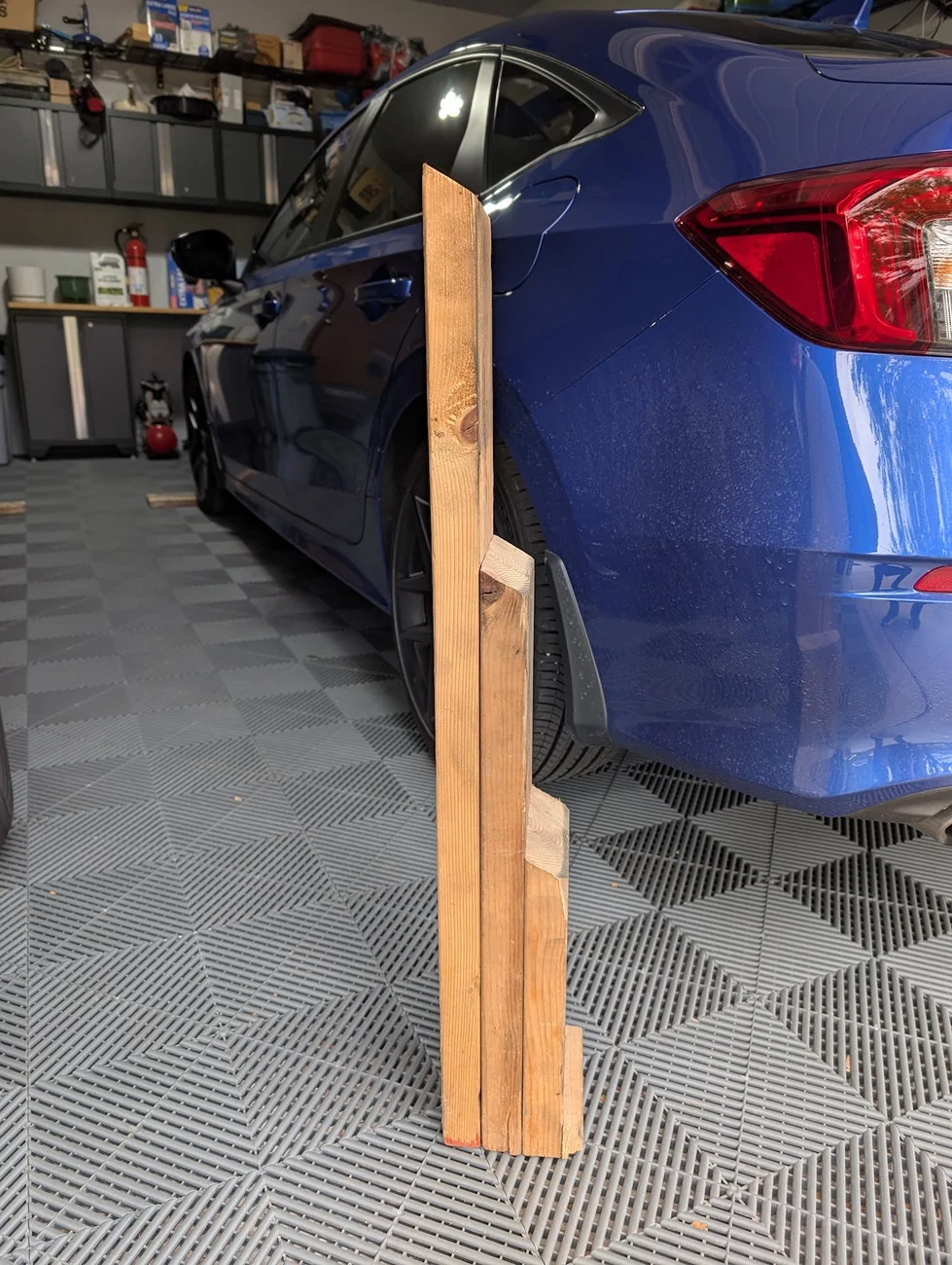

How did you setup wood ramps? Id bought some race ramps but they are actually really big and would rather use something alot smaller
I actually came up with a "track"/"portable" ramp set-up that I'll be trying out in a couple of weeks. It's a 3-layer 3ft length stack of 2x4's with bevels cut on the end. Driving my front wheel up gives me 6" of clearance to squeeze my aluminum racing jack under to reach the front jacking point.
Looks something like this but shorter and narrower.
