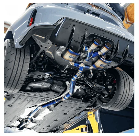

Try it out and let us know how it is.

It will be loud when the valve opens (one resonator and straight pipe), and restrictive otherwise (right angle bends). Depends on if you value your hearing and how much you want the police to notice.
The system has a lot of welds, which can be prone to cracking if really titanium. I'm a retired aerospace engineer with plenty of titanium experience.

I actually think this is one of the valved exhausts that actually get quiet when the valve is closed, and loud when the valve is opened. It even sounds okay when the valve is open. It also comes in stainless steel either through AeroflowDynamics (AD) or through Alibaba if the Ti is too risky, I can't remember.
The things that prevented me from pulling the trigger on it was just lack of others buying it, it being an Alibaba exhaust, and also the amount of negative experiences people have had with AD (Reddit and other forums).
