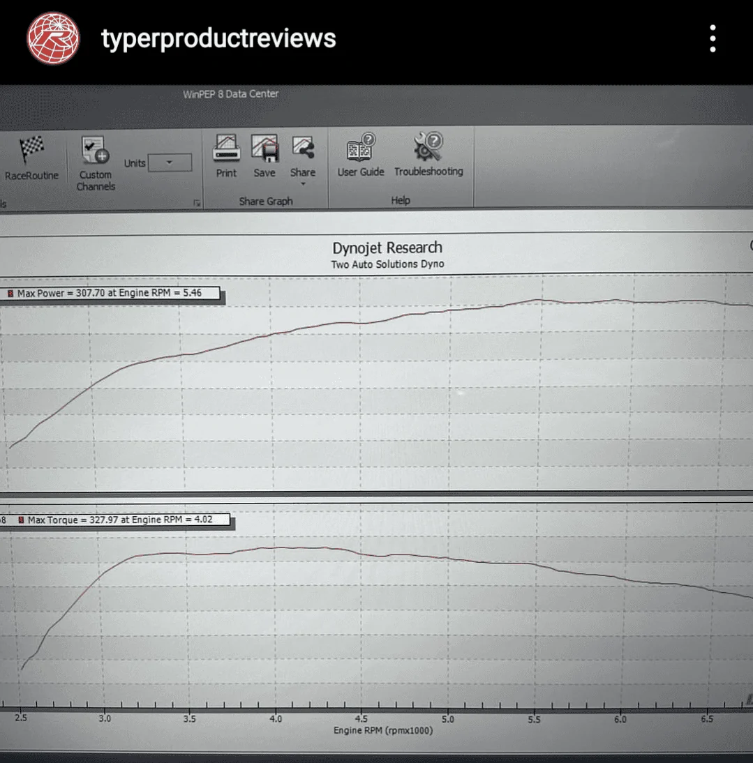

Wait so w/ 93 octane there'd be no torque dip?
So basically that "torque dip" your seeing which I wouldn't call a dip at all is a result of the wastegate trying to gain boost control. It's nothing to be concerned about and you can't fix it with octane. It'll pretty much always happen but you will never feel it in the car. It's based on what gear your in and the load on the turbo. You can try to tune it out so it's perfectly flat but again, not a issue. Once the wastegate has control it smooths out.
N/A motors won't see a dip there because there is no boost to control.

Do sneakers count if I put wheels on them?
For those wondering about the dip in torque. There's a smaller dip in the Puerto Rico Dyno. They ran 93 octane.
But again, take it with a grain of salt unless Hondata or someone else can run both on the same dyno
