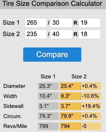

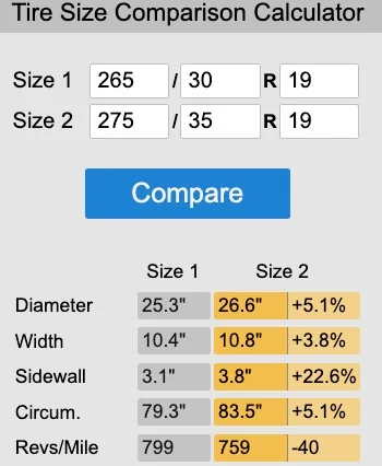

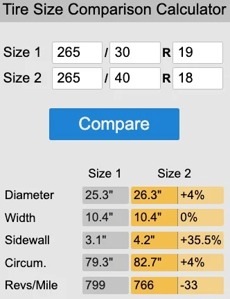

https://tiresize.com/comparison/
I was kinda wondering the same myself...
would keeping the 19 wheels and using 275/35-R19 work on the Type R?
the 275 is about the same overall diameter as OP proposed 265/40-R18, 26.3 vs 26.6 (both are taller than the OEM 25.3")
side wall will increase from 3.1" on OEM to 3.8" for the 275/35-R19 vs 4.2" on the 265/40-R18
note that in order to get about the same overall size as OEM on 18" wheel would require 235/40-R18 which has the same sidewall as the 275/35-R19
11th Gen Honda Civic Weirdo 2025 Type R Noob wants to INCREASE ground clearance.  He clearly needs help. tiresize.com 275-35-19
11th Gen Honda Civic Weirdo 2025 Type R Noob wants to INCREASE ground clearance.  He clearly needs help. tiresize.com 265-40-18
11th Gen Honda Civic Weirdo 2025 Type R Noob wants to INCREASE ground clearance.  He clearly needs help. tiresize.com 235-40-18
