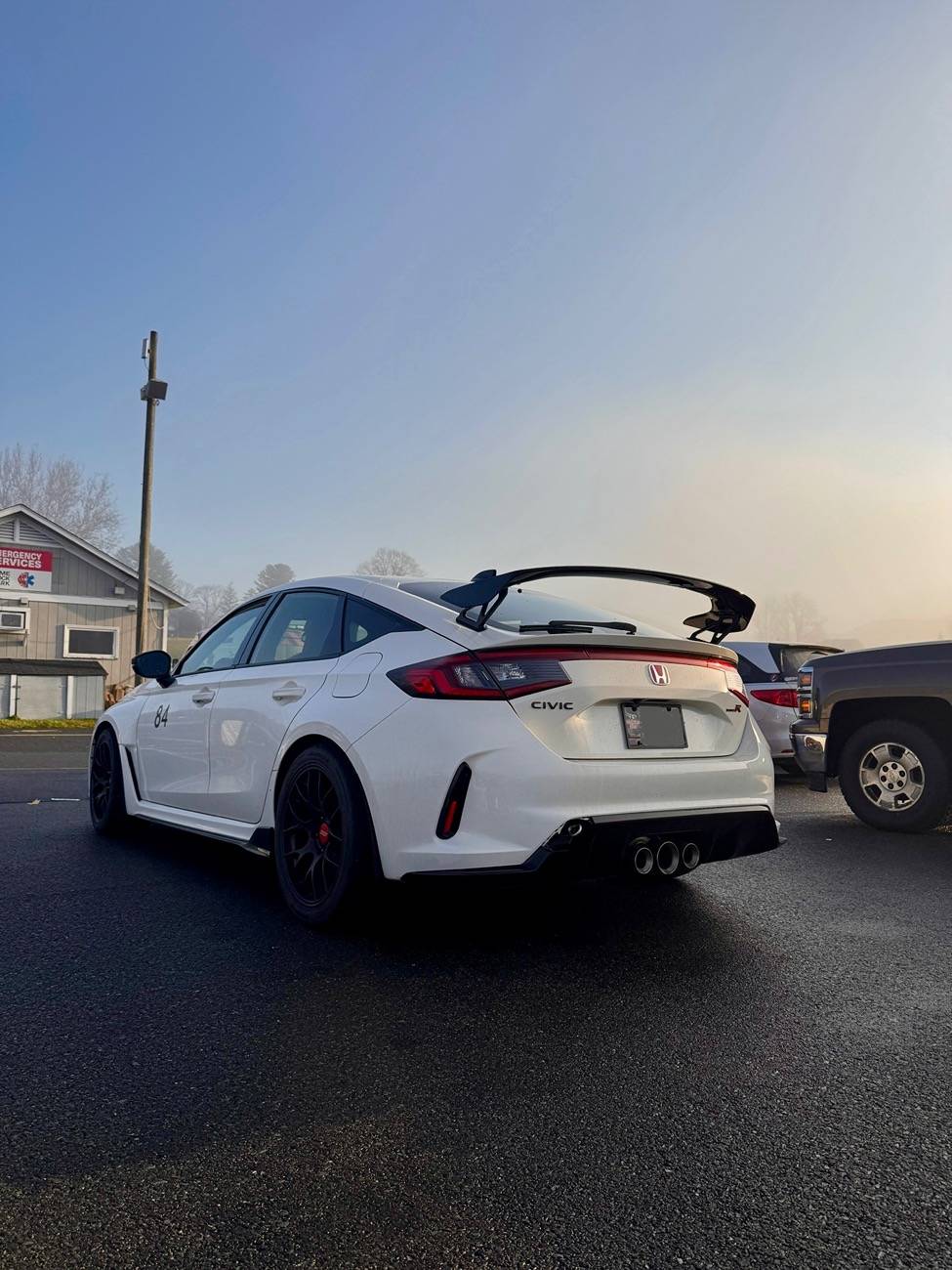

pushing the wheels out will induce a little more wheelspin, especially when adding camber.
That being said, Honda uses +55 9.5" wheels on their Civic Race cars or a 18x10" Titan wheel on their TCX DE5
I actually forgot you have EC-7s lmao 😂🤣. Gotcha. I'll just get them in +43. Im just worried about the fitment but it looks like thats a non issue
yeah the +43 fits excellent, they look like they were made for the FL5, perfect fitment, just perfect flush
