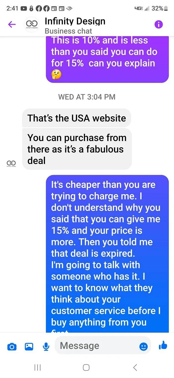

Oh wow that is definitely disappointing to know. I just reached out to them via email asking for special BF deals.. Let see what they response with and I will update everyone here.
On another note, I've been eyeing this kit since late sept ish, and noticed that they used to have a bundle discount (intake and the turbo inlet) but looks like they stop offering this. I also notice the price for the turbo inlet is now higher than when I first looked at it.
11th Gen Honda Civic Tegiwa intake comparison/test Screenshot_20241114_144138_Messenger
