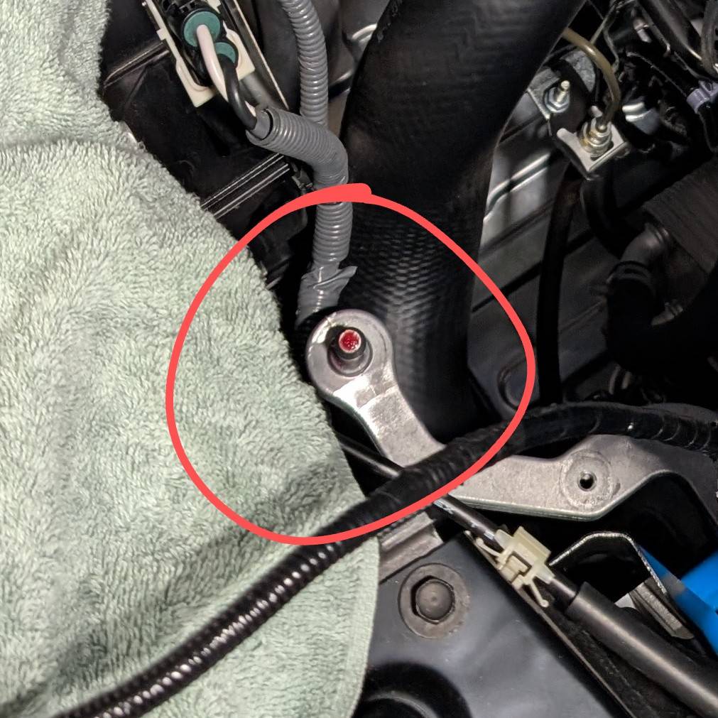

It should have fit, even with those upgrades. TJ from AHC has all those modifications and his fit as well. I had trouble fitting it until I realized it had to fall through the ring of the ID bracket/mount.
I just installed mine and had the same issues with the Acuity Reverse Flow hoses and possibly CSF Radiator reducing clearance and in the way of using the lower front mount. In AHC's video they never show that mount/bracket being used and kind of gloss over it and just show the box installed and then tightening the rear and front bolts. I tried to slow down the video to see if their lower bracket was still present but couldn't get a view/vantage point. They might've glossed past that for a reason.
I just removed the Infinity Design bracket from the bottom of the box and left the OEM mount/stub as is and used the rear and forward bolts to secure it.

This was a pain point for me too. I even reversed the bracket thinking that it was improperly attached. I moved it back, attached the OEM rubber grommet, and forced the stem or pin through it. I celebrated a bit when it fell into place lol.

It looks like the common issue is the Acuity reverse flow hoses. I was sitting there looking for a while and that upper hose really impedes in the way of being able to use that front mount.
@Benny are you running the Acuity Reverse Flow hoses with your setup? It seems like that might be the issue we're all having that we're unable to use that mounting point.
