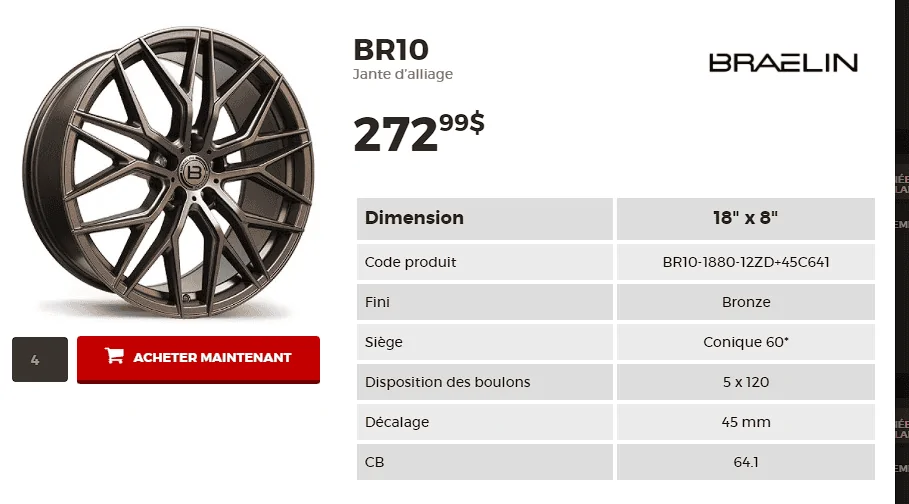

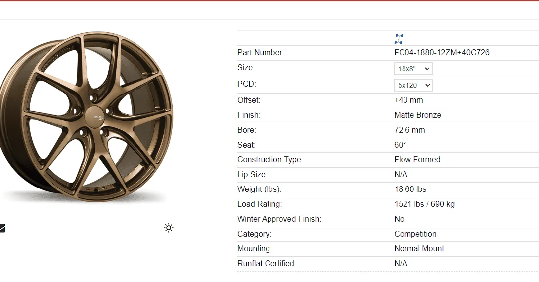

looking to buy a winter kit, 225-45-18 Bridgestone ws90 with those fast wheels or braelin. Will those setups fit well?

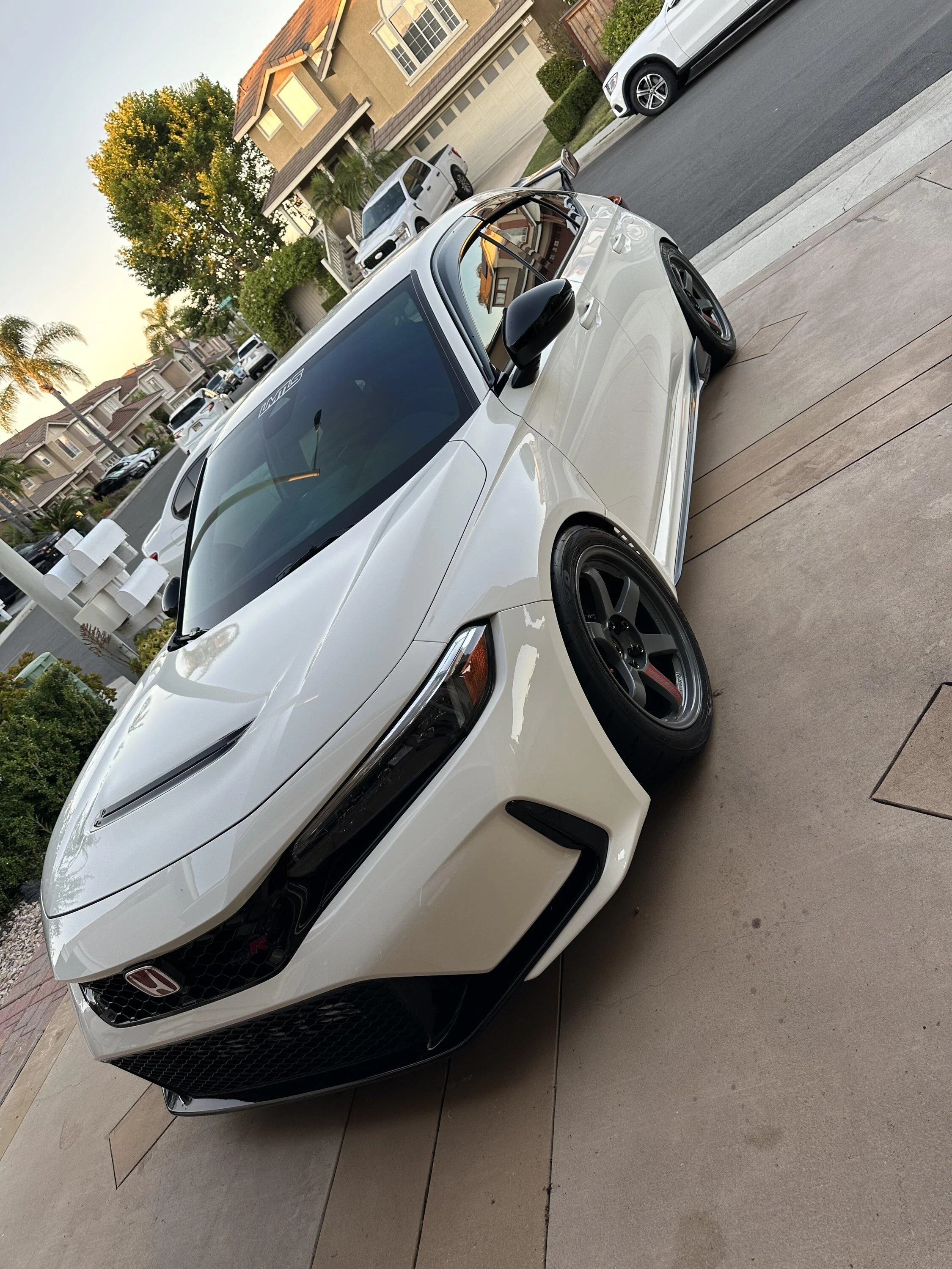

Wanted to post my set-up for reference if anyone feels spicy enough to run 10s as well.
Very similar to the FK8s where I think the sweet spots are 18x9.5 +45-+38 and 18x10 +40. I don't think I would go lower than +40 on an 18x10.
18x10 +40 TE37SL's
Falken RT615k+ 265/35/18
H&R FK8 Lowering Springs
Removed top hat guide pins for little extra camber.
Looks great - any more photos namely on the front end? Any signs of rubbing?

does anyone know if 18 x 10 +40 will rub with 275/35/18?
It'll be close, but it'll work as long as you don't hit a crazy huge bump with a full car.

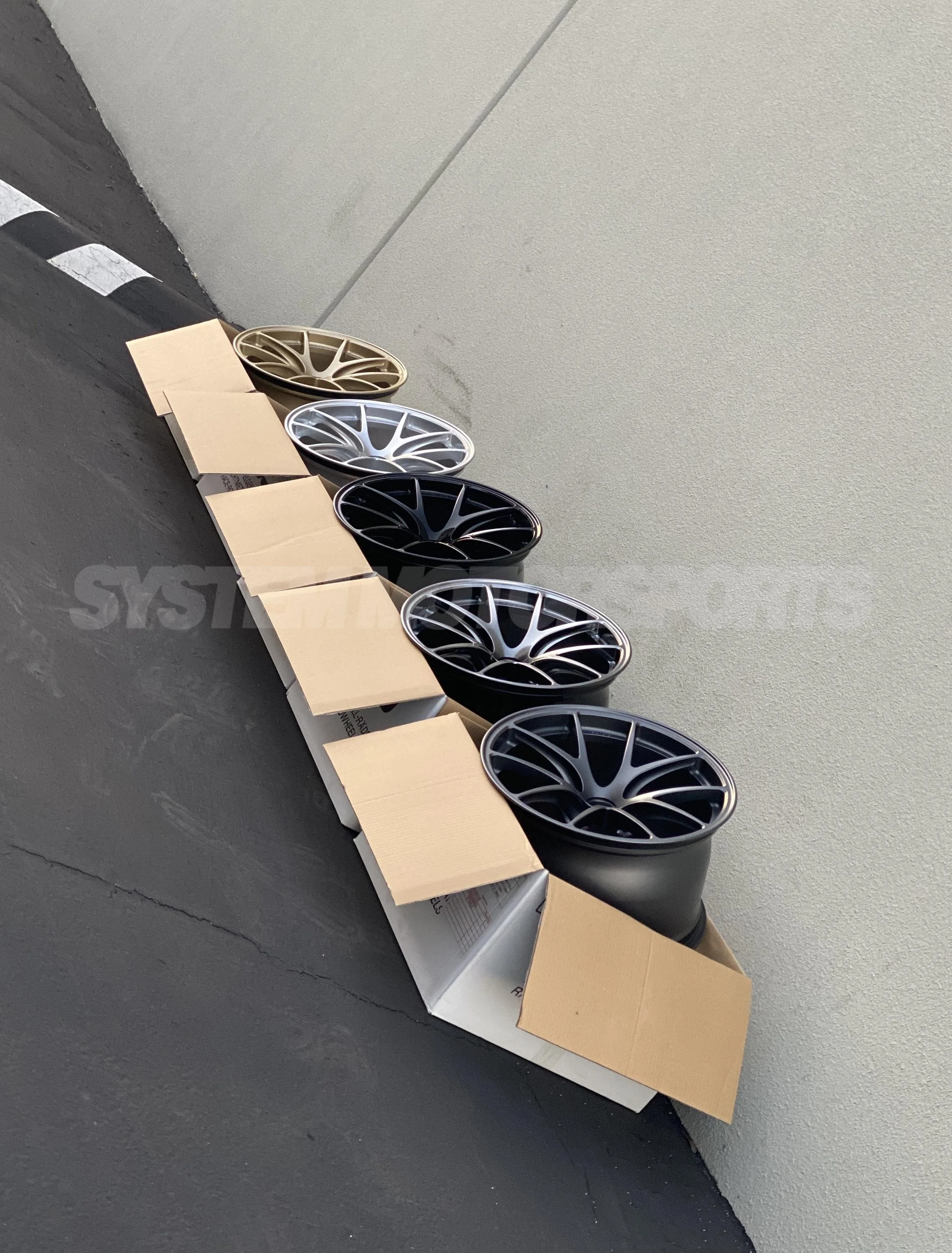

BBS RIA in 5 flavors, Forged in Japan.
BBS Gold, Diamond Silver, Gloss Black, Diamond Black, and Matte Graphite.
