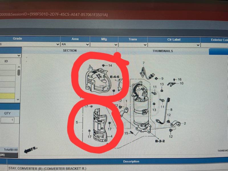

Whenever I get the TSP downpipe I will be purchasing the turbo cover and the catalytic converter cover and having them do the coating.
The turbo cover is around $60 and the catalytic converter is $70. I'd buy them individually and just send it to them vs having to take them off and send it in.
I feel like that should reduce temperatures a bit, at least it should in theory.
You think this is a good idea?
Not sure what you meant by "turbo cover is around $60 and the catalytic converter is $70"? I guess you are thinking about buying spare heat shields to coat? If that is the case, I would scratch that idea and just use the stock heat shields as they are. They could also be removed and replaced with blankets on the turbine housing and downpipe.

Those are just the official names for the heat shields, there is one that covers the turbo and one that covers the downpipe.

I only want to purchase them separately because id rather just buy them, have them and the downpipe go straight to swain tech, and get them back all ready to install. The parts are inexpensive so it doesn't seem like its a huge lost in purchasing them as replacements.

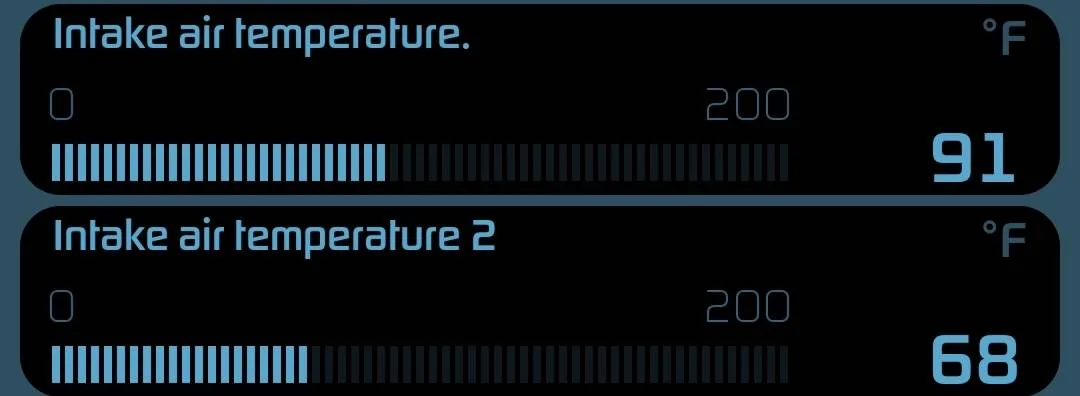

Here's my average heat management on my FL5 ;)
Let me know if you guys need any help!
Thanks...I understand what you are saying better now. White Lightning is a ceramic coating intended for exhaust components. I never really thought about coating the heat shields though as they are more like reflective baffles instead of a part where heat needs to be shielded or contained. For that reason, I really do not see a need although Swaintech has many other coating offerings that I have used in the past for other components.

Please elaborate…Thanks!
I live in S. Florida where the heat is always around so wanted to make sure my heat management was up to paar.
Heat Management Setup:
- PRL FMIC
- PRL HVIK
- APR Carbon Radiator Cooling Plates
- Dream Hardlagged Turbo Heatshield
- TSP 5" HEDP non-cerakoted
- PTP Hybrid Downpipe Blanket
- @Jester04 Custom Tune
I'm using the factory skid plate but thinking about upgrading to WOTs in the future however I don't plan on tracking. Eventually I'll install my PRL charge pipe kit.
