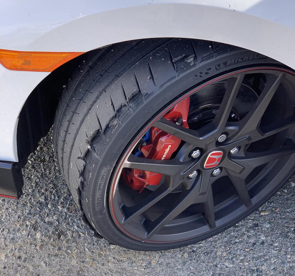

The simplistic principle works like this:
Higher pressure = better tyre stability, less heat due to reduced tyre movement, increases use of the centre of the tread due to ballooning effect thereby reducing the use of the shoulders.
Lower Pressure = more flex, more heat, reduces ballooning effect thereby increased use of the shoulders.
On a car that is camber limited (stock car without alignment mods) I would recommend staying in the higher psi range. Otherwise you will destroy the sidewall of the soft Michelins. The point is not to maximise grip as much as it is to protect the sidewall. You're not breaking lap time records on the stock tyres or alignment set up.
My tip for anyone I'm unable to be at the track with (thus unable to monitor tyre surface temps with my pyrometer) is to keep an eye on the sidewalls/outside shoulder of the tyre. You'll find you'll need to run more pressure in the front than the rear based on the shoulder condition alone.
There is no perfect number for everybody - cause every track surface is different, and every driving style is different, so tune to your circumstances.
Here's one from a member on the FK8 forum - running 43psi hot. Can you imagine if this tyre was sitting at say 35psi hot? The Michelin man would have left the chat along with the fender... It just goes to show these tyres are not designed to handle extended hardcore ragging on. They are not a race tyre. Take it easy out there.
