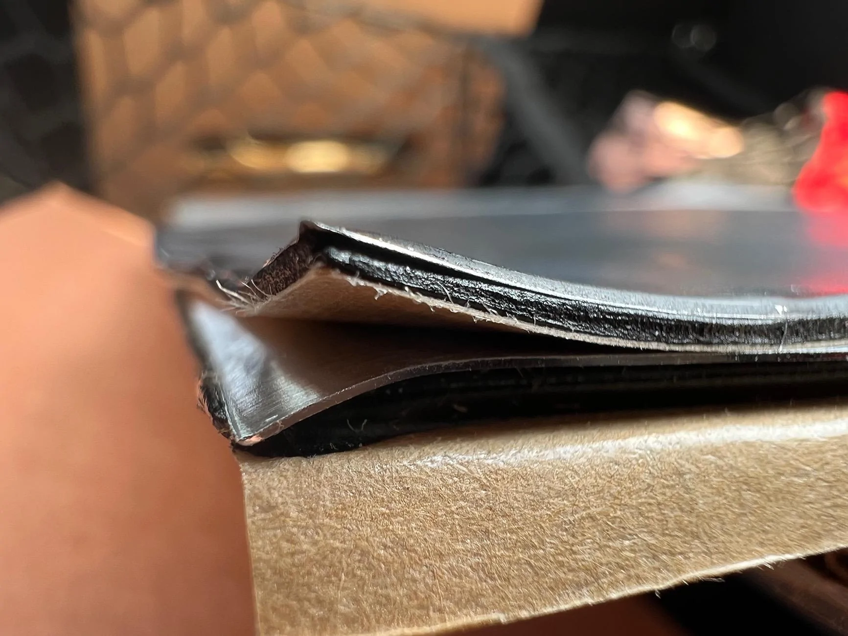

For the trunk area is it still worth doing the Amazon sound deadening then the 4mm or just the 4mm. Also I noticed they offer 10mm , would a single layer of this be beneficial over 2 of the 4mm? Or would it be too thick?

The sound deadening only really helps deaden vibrations - You probably can get away with just putting it into strategic areas that sound like a tin can. Then use the close cell foam - blanket it - The sound deadener - it does also reduce noise but really the foam is the way to go as this really insulates out sound - I went overkill with the sound deadening - as I didn't want to go back and experiment - I wanted to turn the car into a Mercedes - give it that vault like feeling - But in reality, if you are looking to just block off sound - This 4mm material is excellent - Super easy to install - Very sticky - And you can double up on it to get 8mm, which you should do everywhere you can.
If I had to do it all over again, I might only use this material as it's super light - easy to install - easy to manipulate - but you really need to seal off sound - blanket all the sound.
https://www.amazon.com/gp/product/B0BWD1M9Y5/ref=ppx_yo_dt_b_search_asin_title?ie=UTF8&th=1

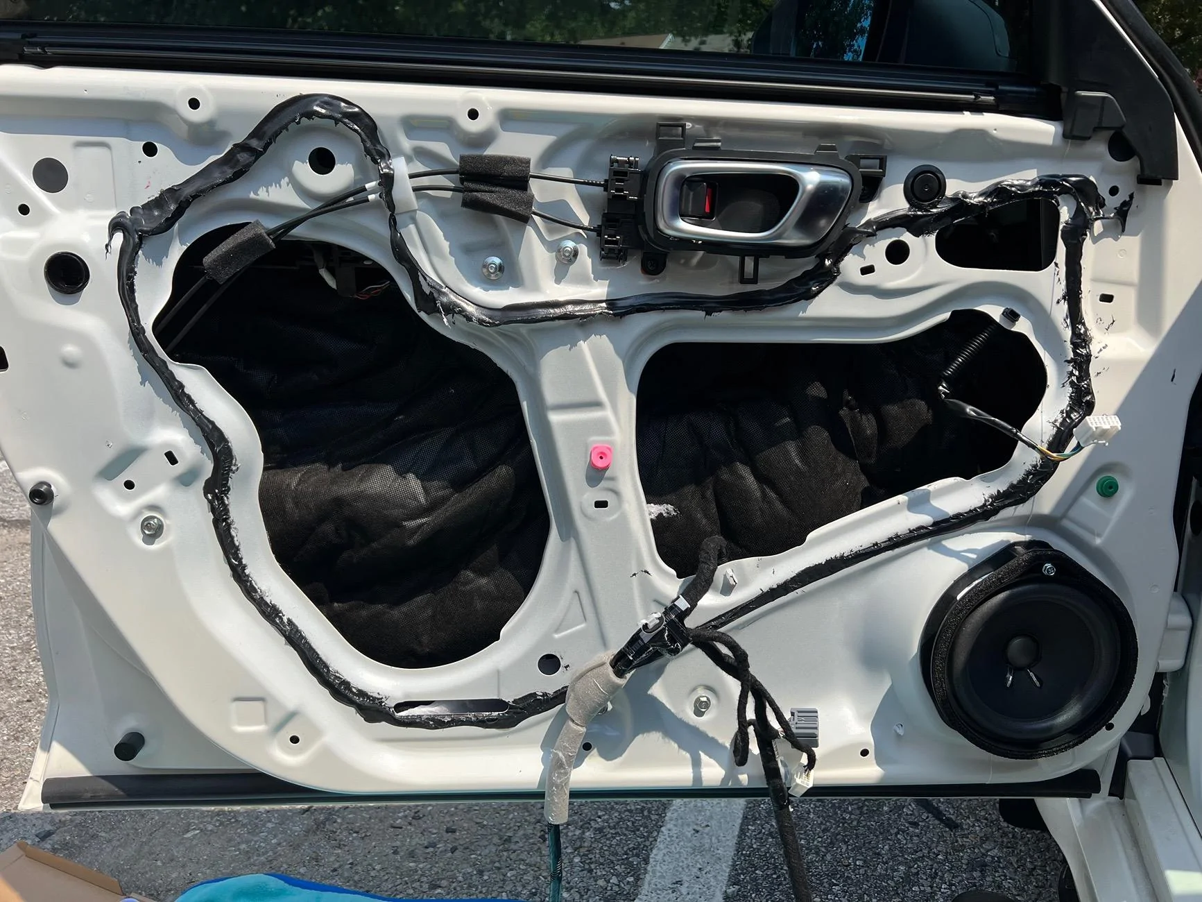

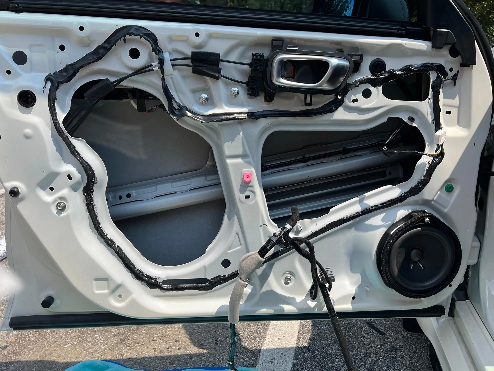

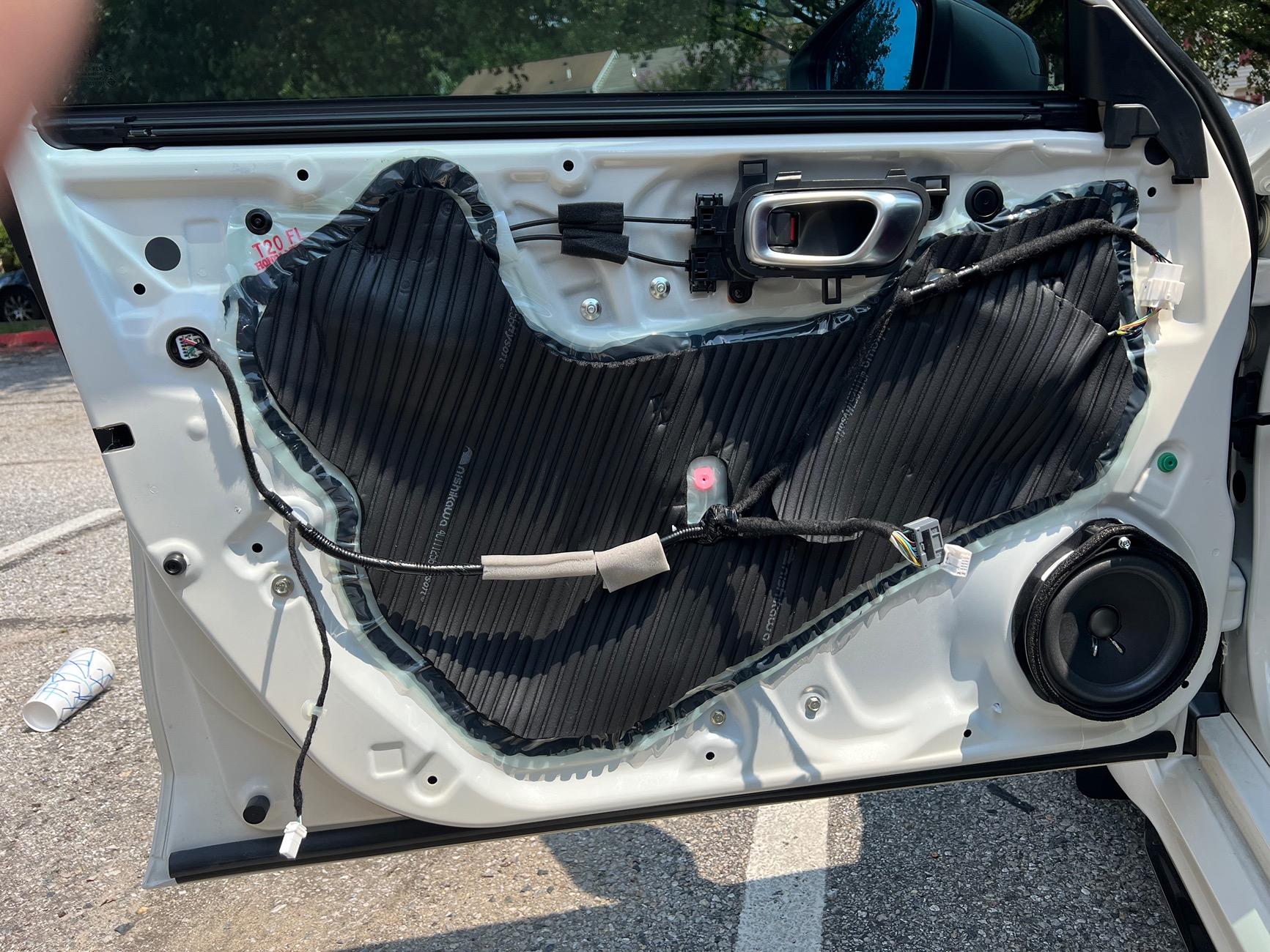

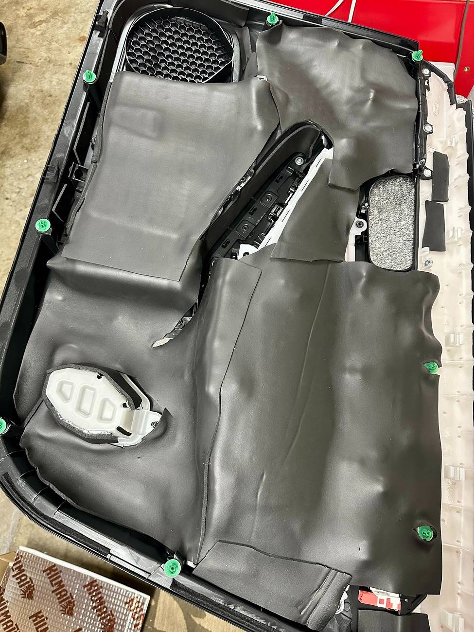

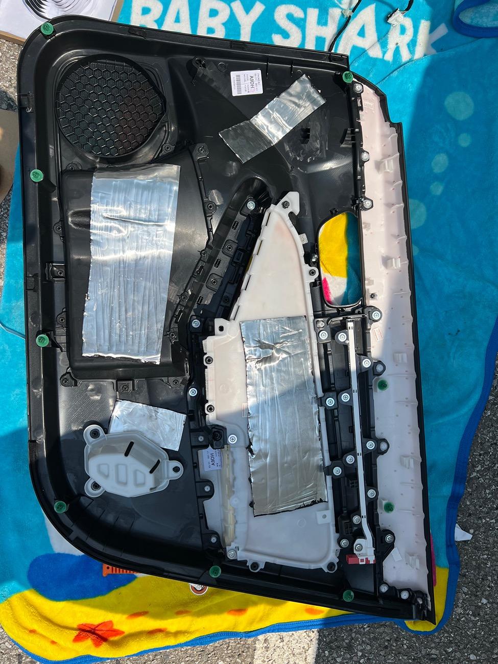

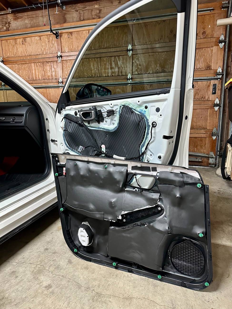

1) Doors - So if you're doing doors. I would just pop off the door panel - put a layer of this 4mm over the water membrane on metal door, and then do another layer inside the plastic door panel. This is very easy to do.
2) Rear wheel wells and trunk. Just use the 4mm - 8mm double up everywhere you can - Especially fully those rear wheel arches. You need to cover all the way around that wheel arch or sound will escape and be transmitted into the cabin.
3) Floors - helps a lot - probably also could have gotten away with simply just the double 4mm closed cell foam.
Super easy to work with vs the amazon deadener which was hell to manipulate and roll on, and massage into all the metal parts of the car. The 4mm foam just rips to size and just sticks very strong. For sure spray alcohol first on all surfaces and wipe off to clean dust off to get good adhesion.
Just the 4mm sticky foam - get a tone of this stuff - and double it up where you can - That should do a lot - and 10-100x faster to install.

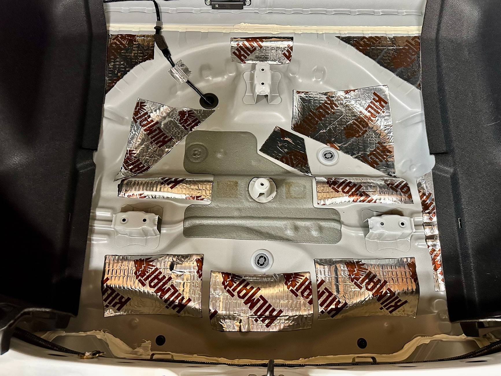

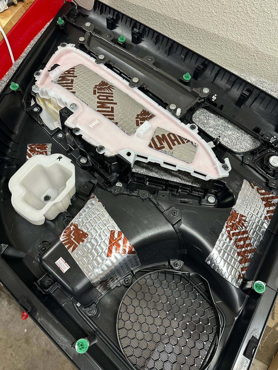

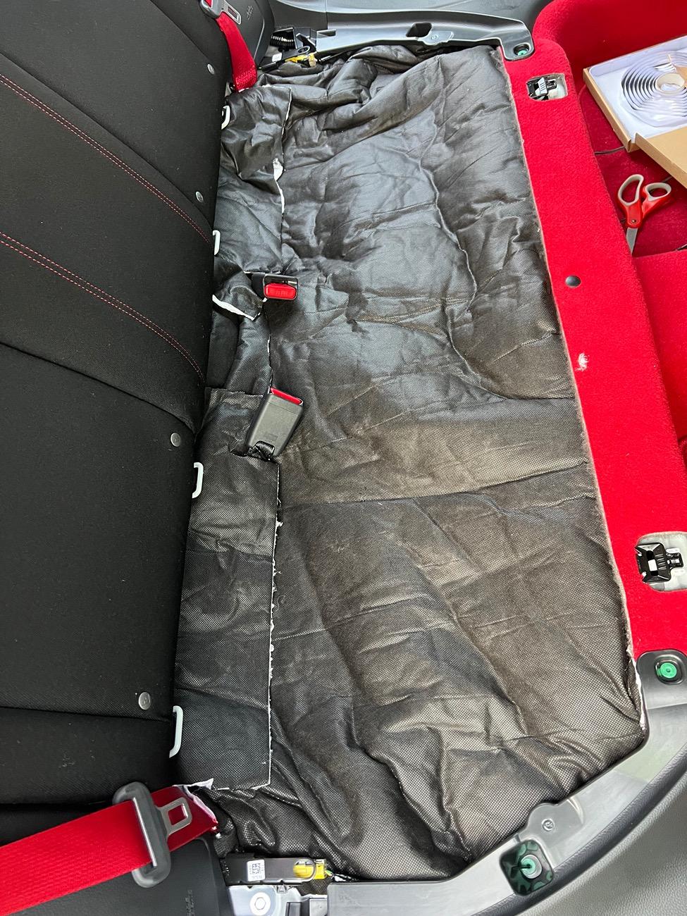

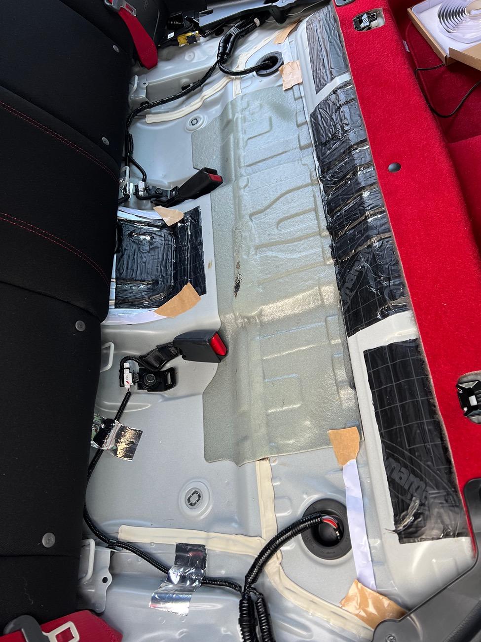

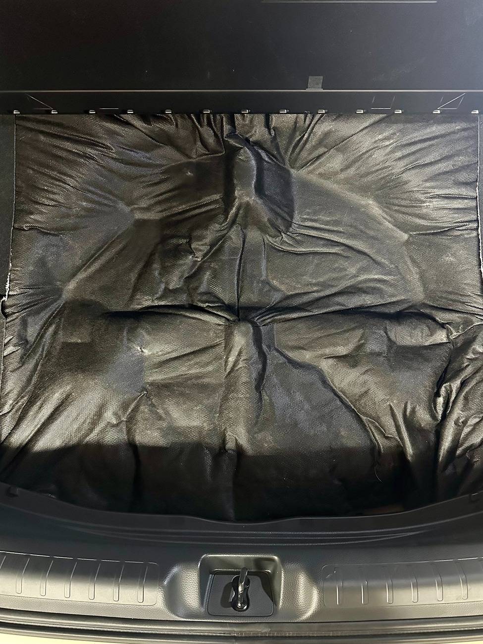

Wrapped up my initial sound deadening plan on the FL5 this weekend. Killmat in the trunk, door cards, and door skins, 4mm aggsound acoustic foam covering the door cards, 3M SM200L Thinsulate lining the trunk, rear wheel wells, and under the rear seats. Road noise is significantly reduced on the highway, the speakers sound much clearer with tighter bass, and the doors sound much more solid when closed. I was surprised how much easier it is to have a conversation on the highway. Next up, some goodies from CDT Audio!
11th Gen Honda Civic Sound Deadening Project IMG_7707
11th Gen Honda Civic Sound Deadening Project IMG_7709
11th Gen Honda Civic Sound Deadening Project IMG_7710
11th Gen Honda Civic Sound Deadening Project IMG_7737
11th Gen Honda Civic Sound Deadening Project IMG_7738

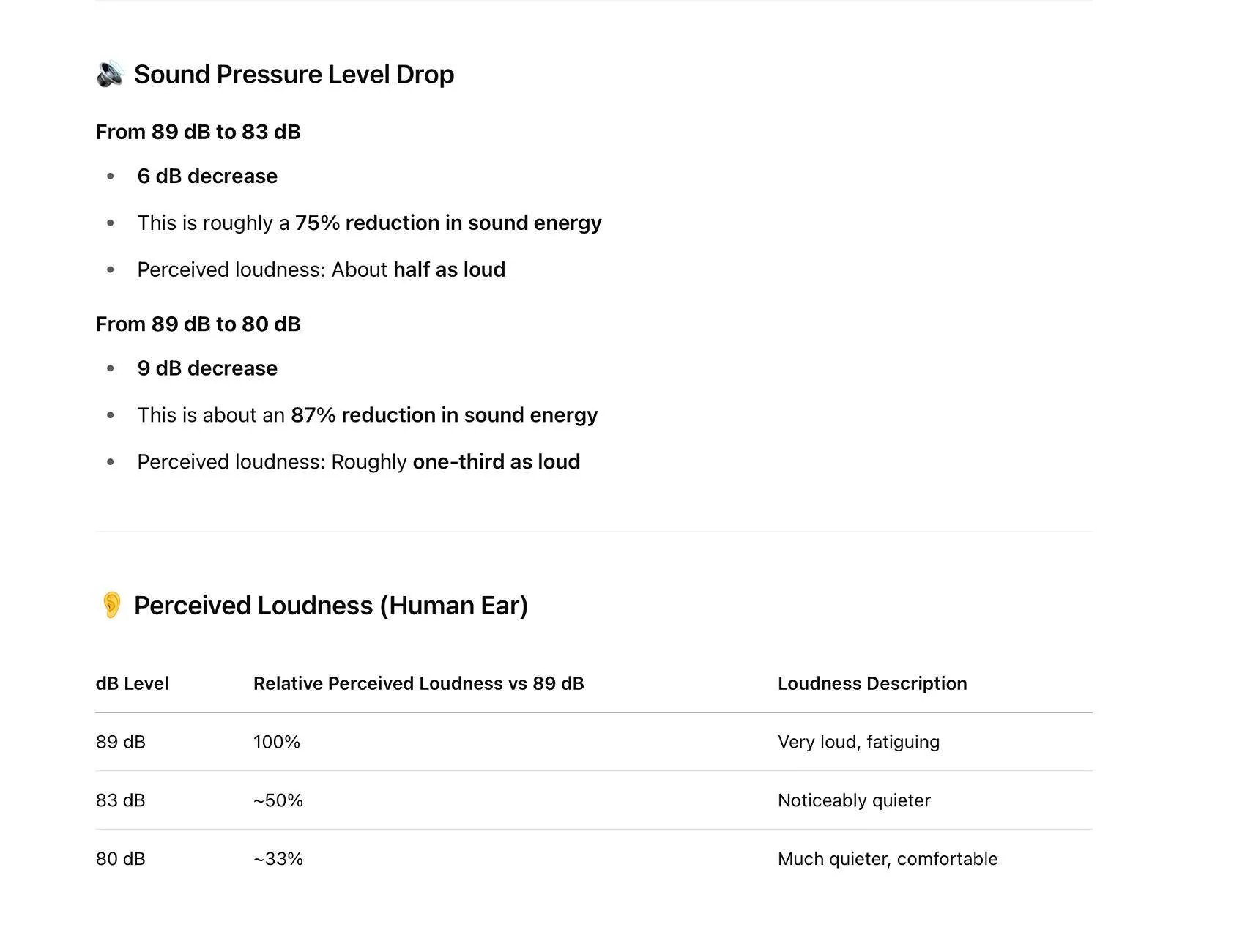

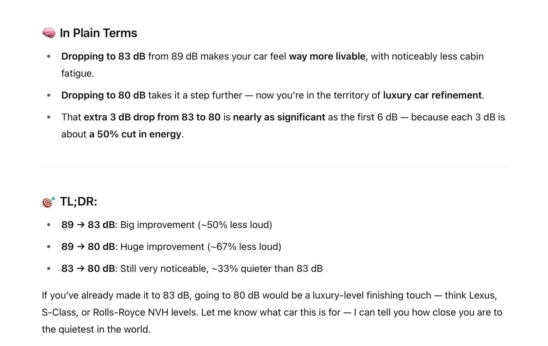

Here is the grand Finale, testing Stock Type R vs Sound Insulated Type R - This an Extremely well sound dampened Type R.
Thanks Everyone for the Support and Sincerely Appreciated Everyone that Helped and Cheered Me on.
It was a lot of real blood and sweat to complete this.
Car is being sold in a few days, and I'm happy to find it a new home.
Thank you, and God Bless

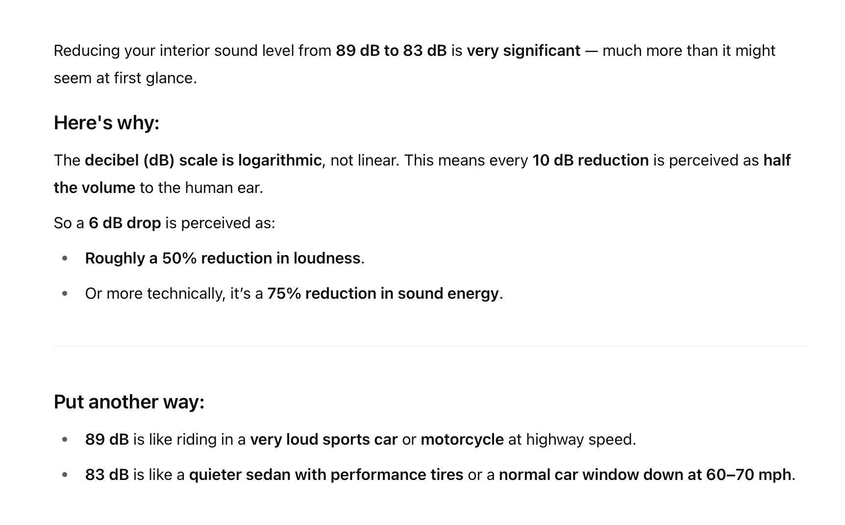

Here are the sound tests and videos of the project.
The DB only shows a very small part of the story. Put your headphone on, and you can hear the day and night difference of all the frequencies, harmonics, and vibrations being dampened.
