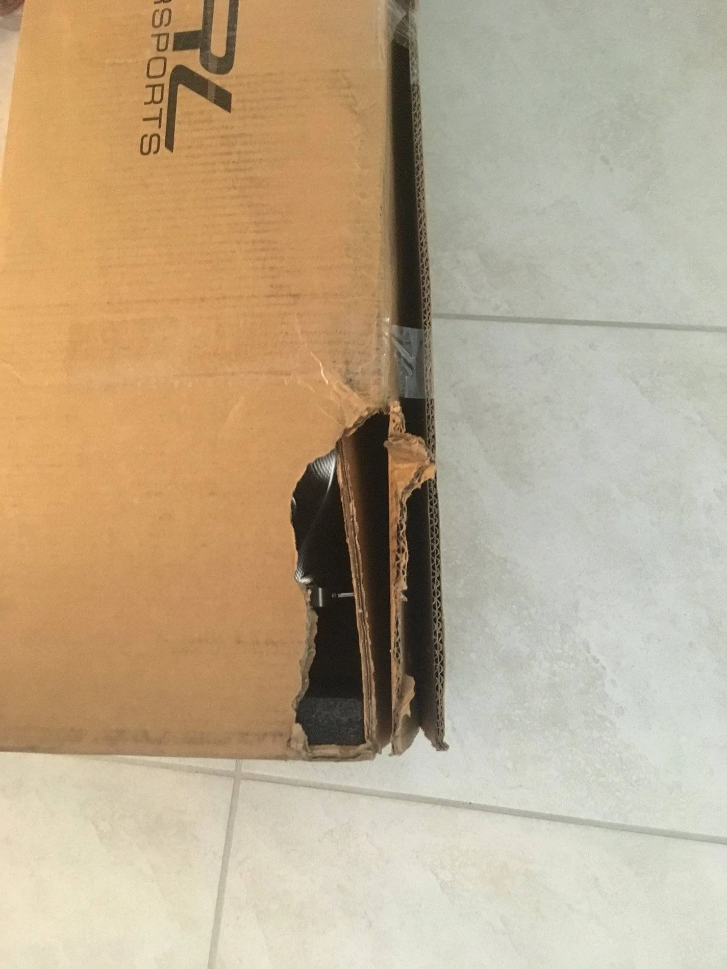

Just got it, super stoked but... small problem.
FedEx was equally hyped to admire the billet endtanks that they kicked open the corner of the box and ripped all the box staples fully out. :flame:
Fins are all OK, there's a small nick in one of the end tanks but it's small sub 1/8" size cosmetic damage because PRL packed it so well.
Gonna shoot you guys a PM real quick to make sure everything inside is accounted for.:cry:

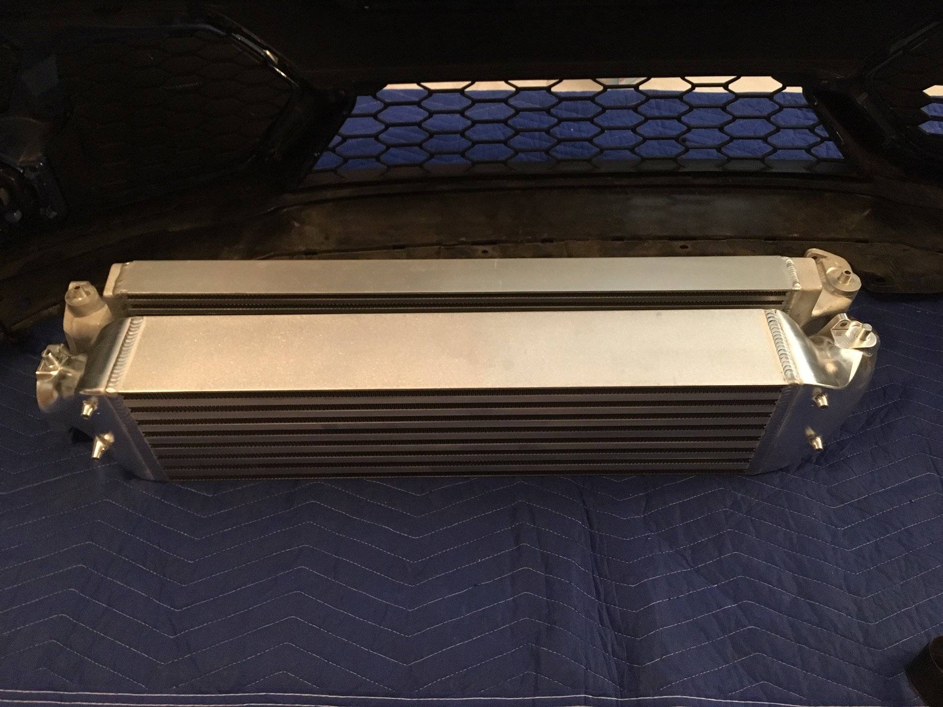

Alright, time for an update / write up / review of this IC!
First off, PRL replied to me very promptly and made sure all the box contents were present and accounted for.

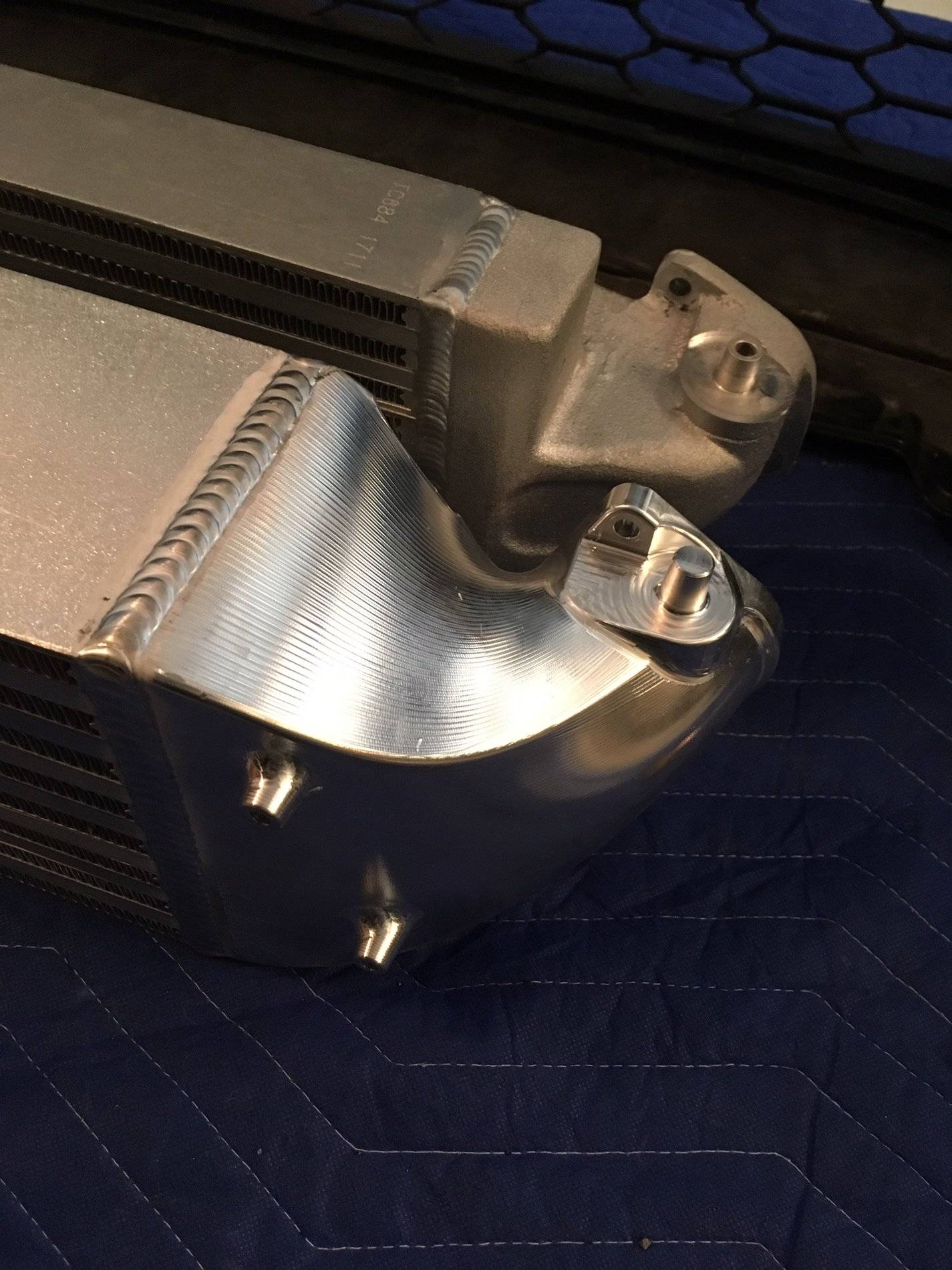

So then, after taking off my bumper we see... the old IC, an Agency Power unit that fits well enough and I am happy with:
11th Gen Honda Civic PRL Motorsports 1.5T Civic Billet Intercooler Upgrade IMG_2967.JPG
Cast end tanks, fits well enough, I would say a solid 7/10 product. Nothing amazing, interestingly designed with a thin top section to add a lot of surface area.
Well, it's a night and day difference when you lay it down next to the PRL unit:
11th Gen Honda Civic PRL Motorsports 1.5T Civic Billet Intercooler Upgrade IMG_2970.JPG
(Keep in mind that at this perspective you are only looking at the thin top section of the Agency Power)
There's absolutely no comparison with the end tanks and weld quality, PRL comes out on top.
First thing I noticed was that despite the way beefier core, the PRL unit only weighs about 1/2 a pound more than the Agency Power.
Breaking down the frontal surface/volume numbers, the PRL unit has 106% of the AP's internal volume, but only 86% of the frontal surface area.
Frontal surface isn't the be all end all though, because as far as cross section for airflow to go through the PRL is ~117% of the AP's airflow cross section.
I won't bog this any further down into the theory of Intercooler design, but basically what this means is while the Agency Power has the potential to catch more ambient air across the front, the PRL unit is going to flow better and has more air in contact with cooling fins.

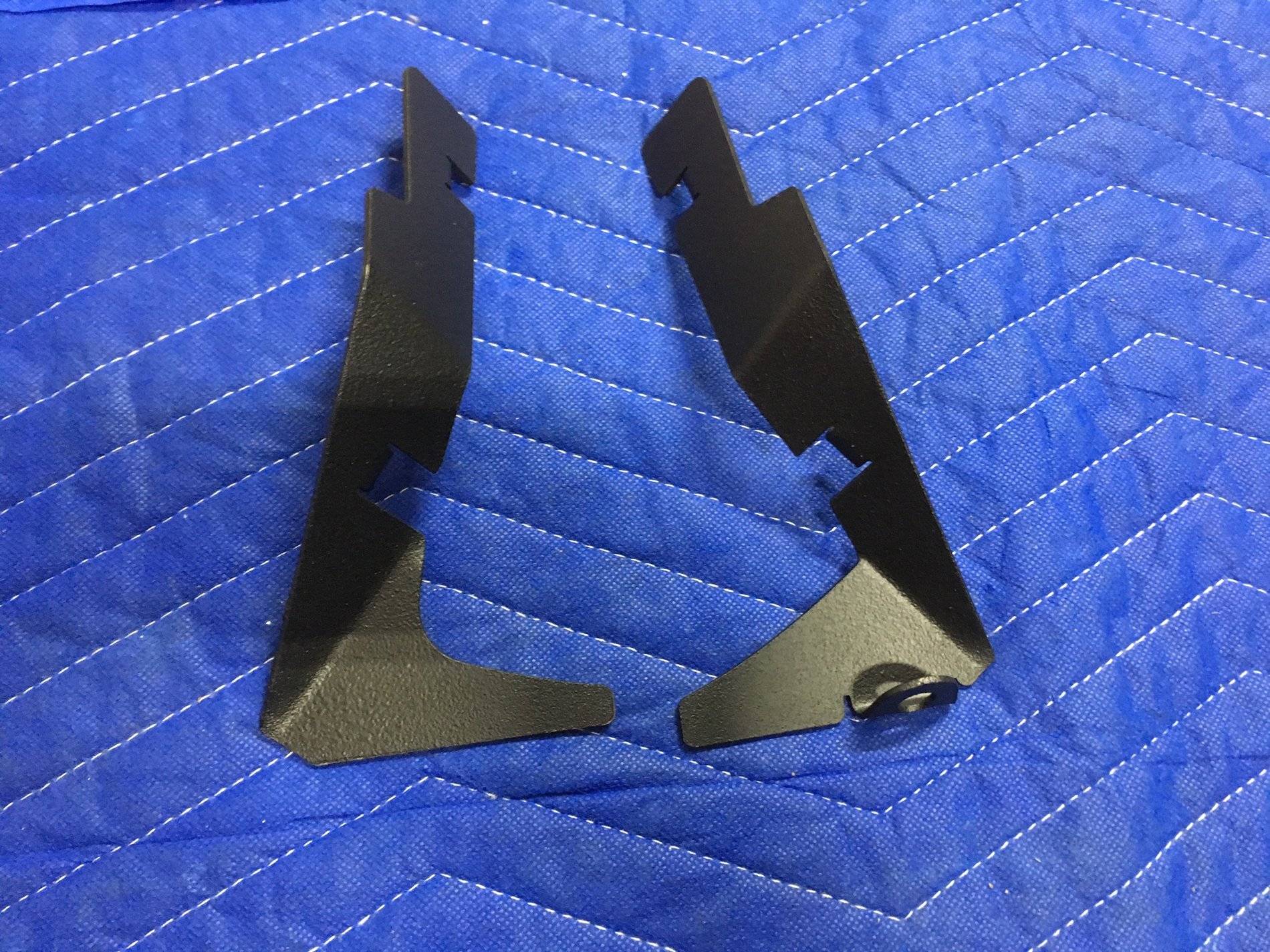

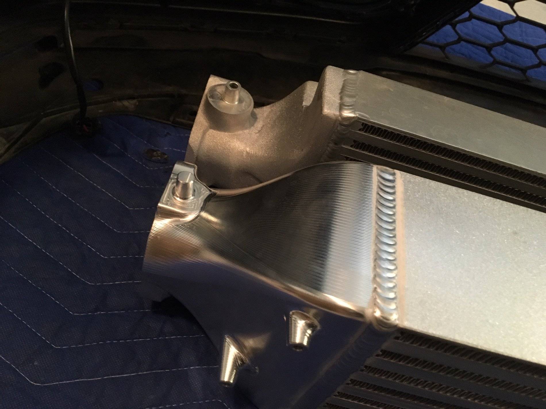

Just look at how smooth the airflow transitions into the core though:
11th Gen Honda Civic PRL Motorsports 1.5T Civic Billet Intercooler Upgrade IMG_2973.JPG
And on exit it's the same story:
11th Gen Honda Civic PRL Motorsports 1.5T Civic Billet Intercooler Upgrade IMG_2976.JPG
Agency power's offering kind of falls flat compared to the PRL. As a result I am almost certain pressure drop across the PRL unit is going to be remarkably better than Agency Power, which is already better than stock.

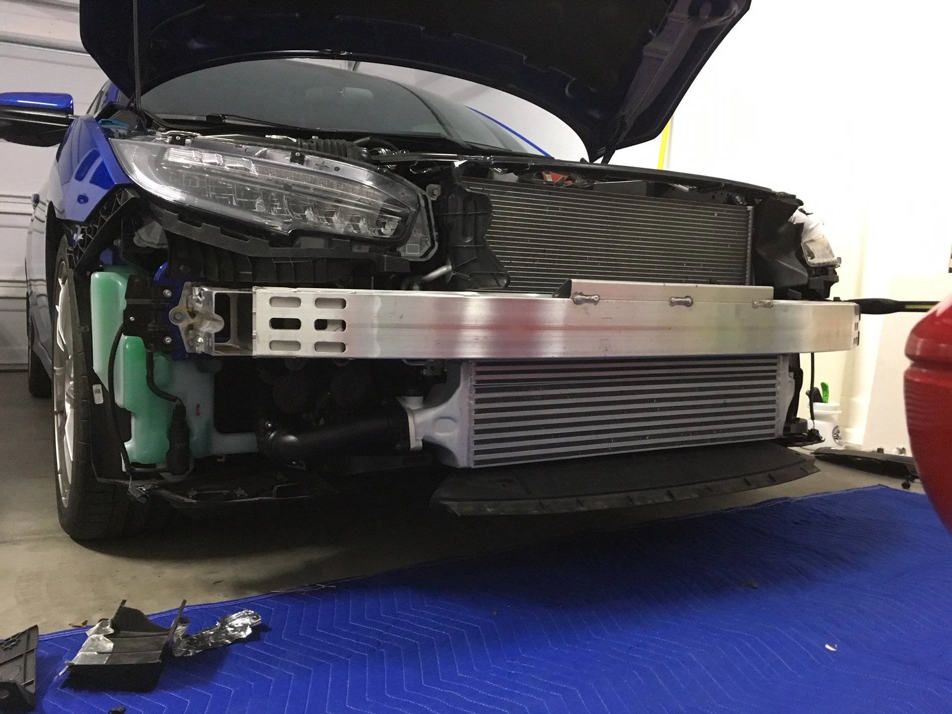

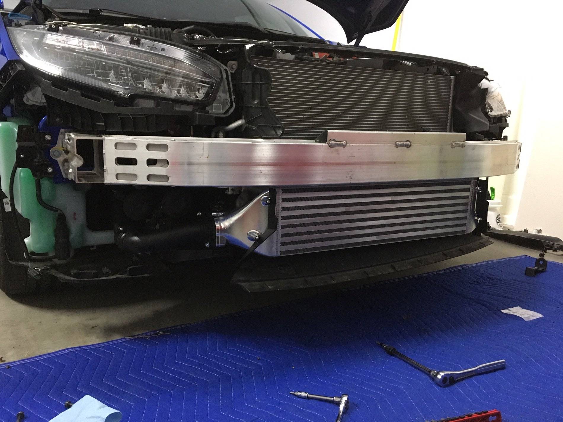

Installation itself is trivial, PRL has really paid attention to all the details here. Nothing needs to be "massaged" into place, nothing rubs, and this little detail blew me away:
11th Gen Honda Civic PRL Motorsports 1.5T Civic Billet Intercooler Upgrade IMG_2981.JPG

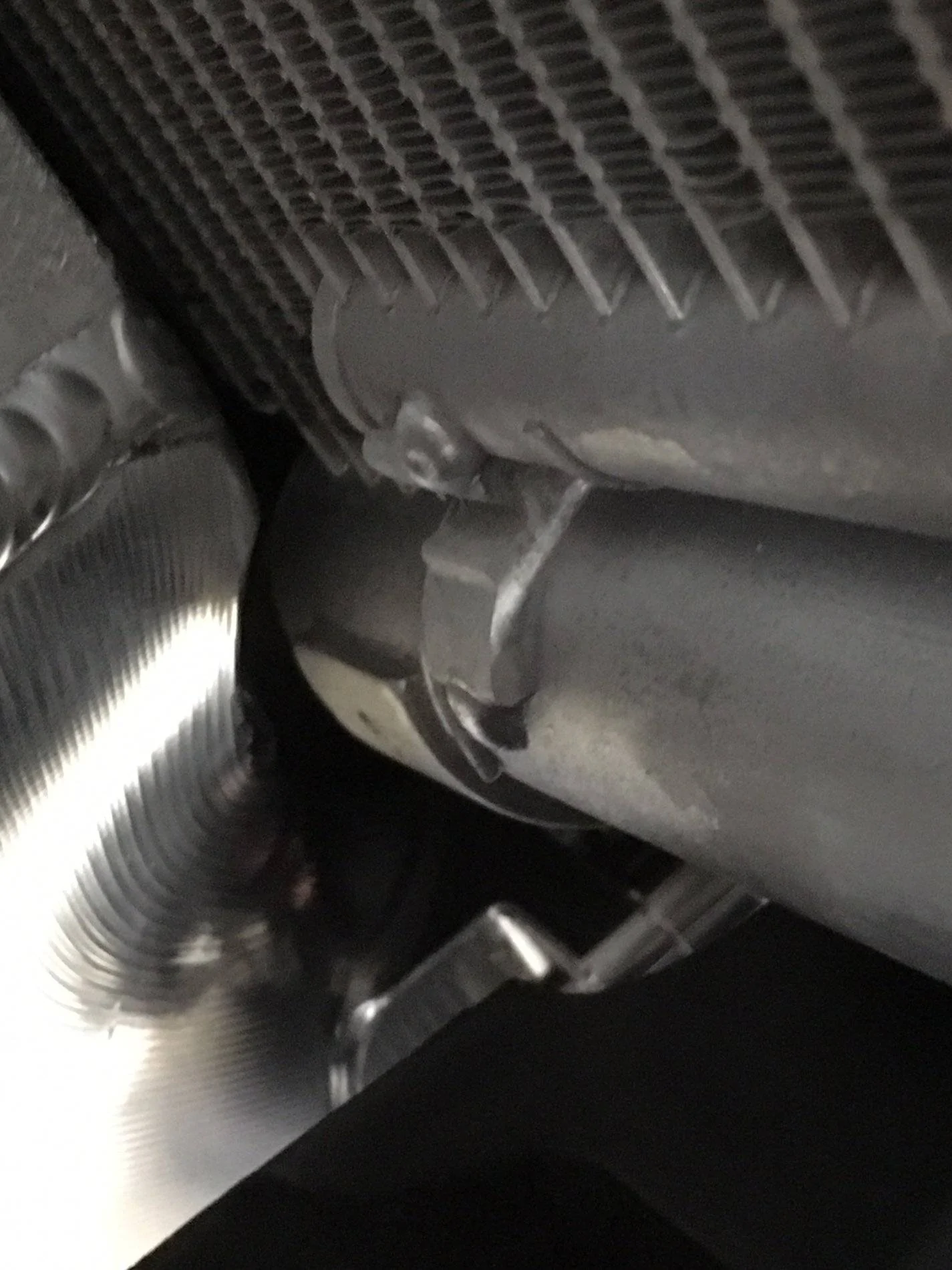

PRL even paid attention to the fact that the A/C Condenser gets close to the endtank here and there's a little cut in relief to make sure clearance is plentiful. I've been around the automotive aftermarket long enough to know that little details like this are often overlooked or just straight up ignored in favor of an "oh well, it might rub" attitude.
Possibly the most questionable thing about the whole install was my quick and dirty rattle can of bedliner on the air guides to black them out:
11th Gen Honda Civic PRL Motorsports 1.5T Civic Billet Intercooler Upgrade IMG_2968.JPG
I didn't realize until after painting and as I was installing that there was one small casualty of the shipping, and it was a little mounting tab on the airguide being slightly bent. A gentle pull with some channel locks sorted it right out.
But, now my bumper is ready to go back on:
11th Gen Honda Civic PRL Motorsports 1.5T Civic Billet Intercooler Upgrade IMG_2985.JPG
I can't say enough how awesome this intercooler turned out, I am so happy with the results and PRL!!
I'm gonna go ahead and say it. 10/10 product and hands down the best, absolute best intercooler on the market right now. :thumbsup::thumbsup::bow:
