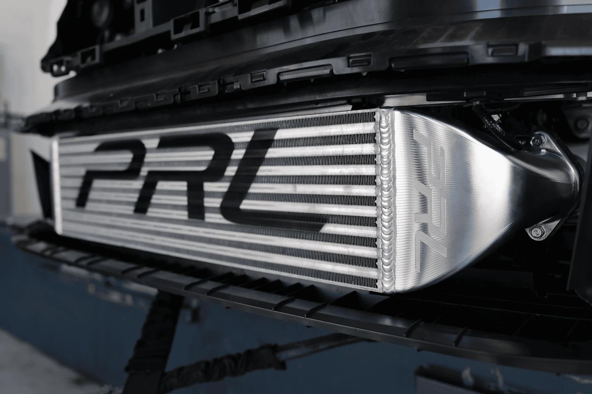

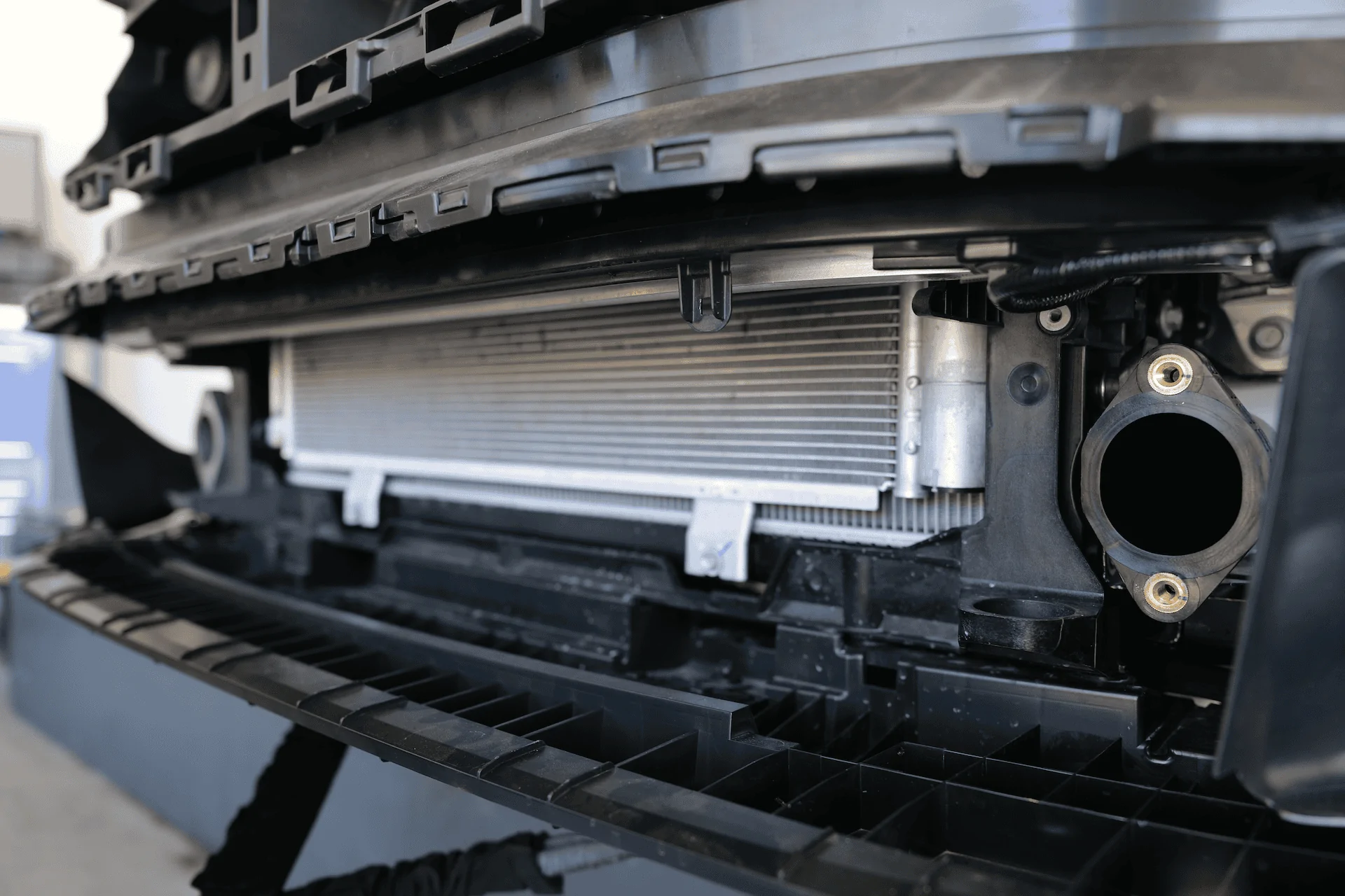

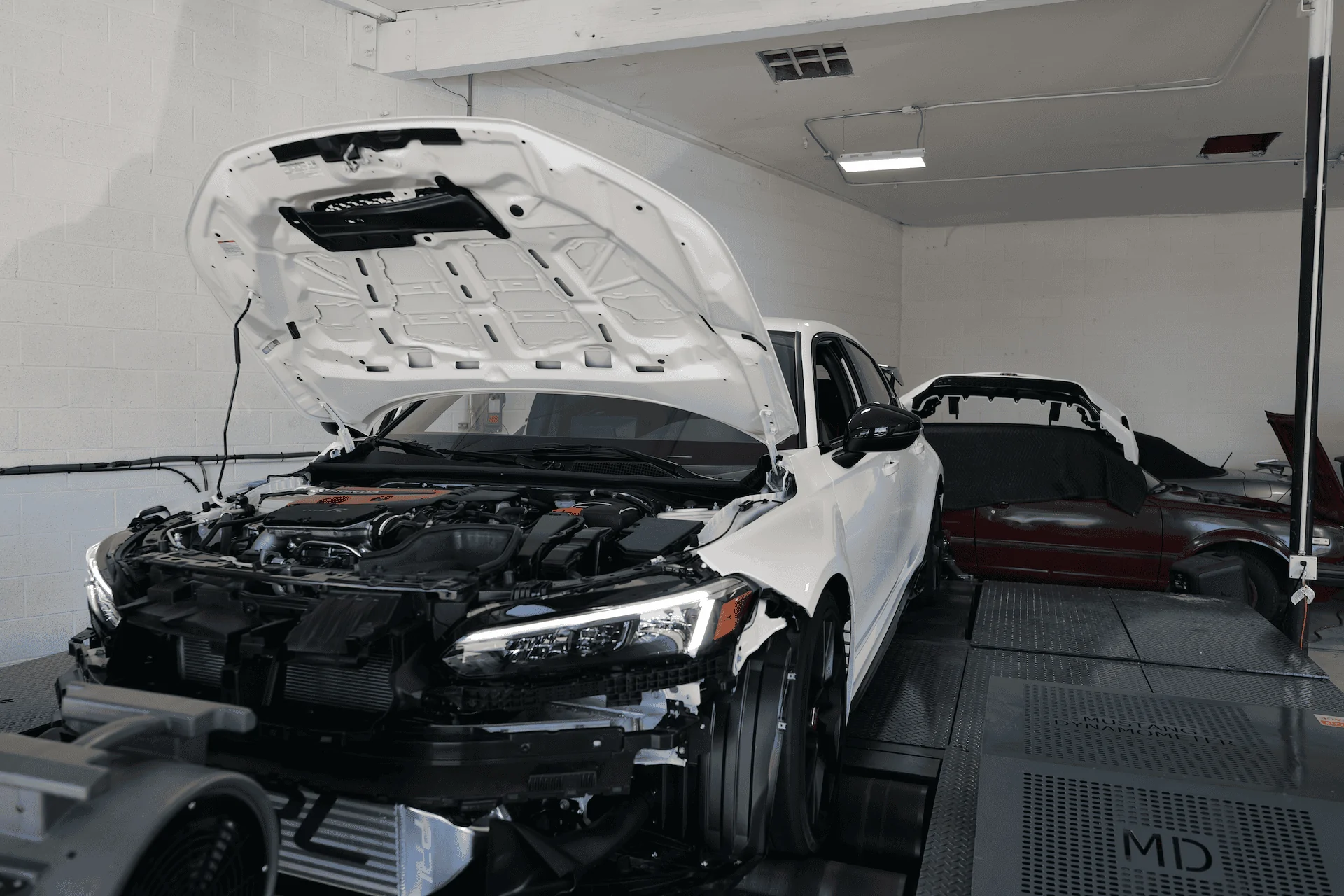

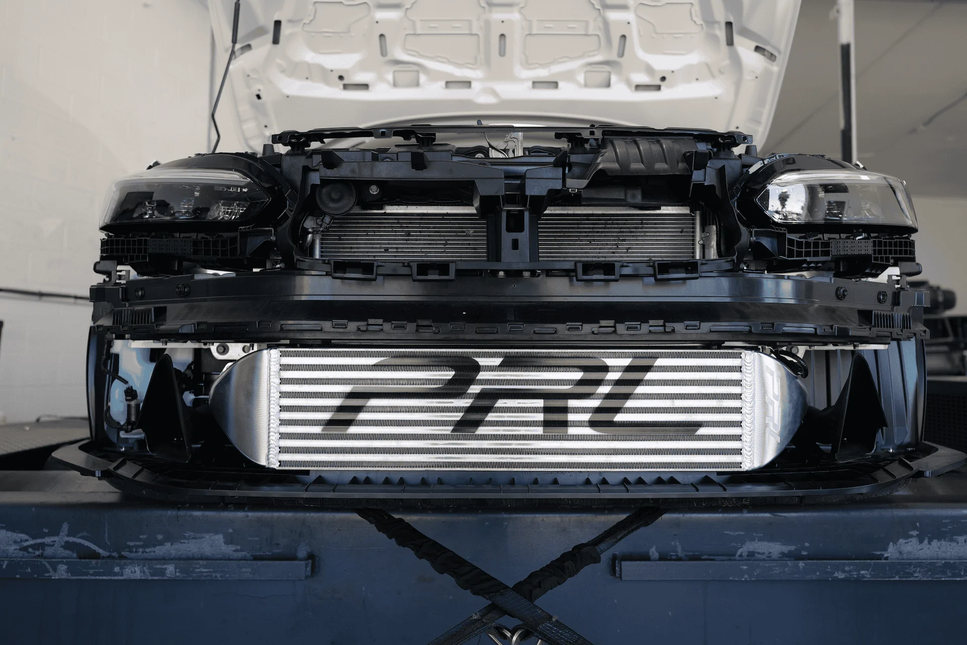

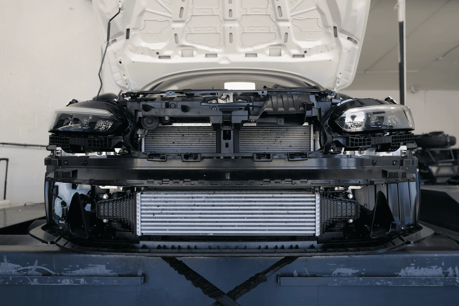

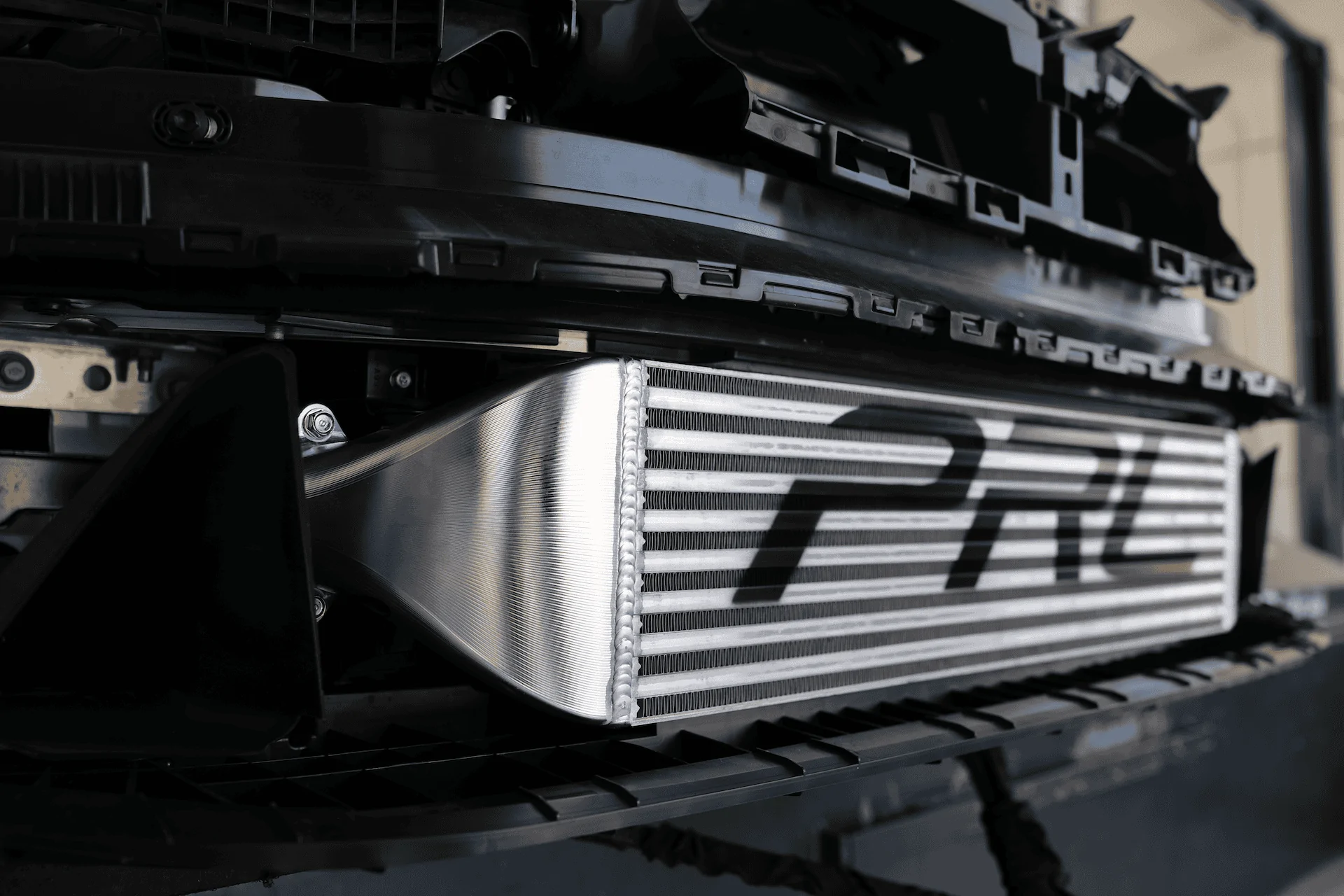

After installing the catless downpipe on our 2023 Honda Civic Type R, we decided to take it a step further by adding @PRL Motorsports Intercooler. This install was done on the dyno right after comparing the DownPipe results ("Free Flowing" DownPipe). To get the most accurate results we did this back2back test with the same Powermetric Tune on Hondata FlashPro with 2 min intervals. Not every test can be done this way but since the build is still in the early stages and these upgrades are simple to install, I figured I'd do back2back test and share the results with you all. That way you can decide if a PRL Intercooler upgrade is right for you. Now keep in mind, in summer it gets hot in my location and we only have 91 octane. Now time for the results!!!

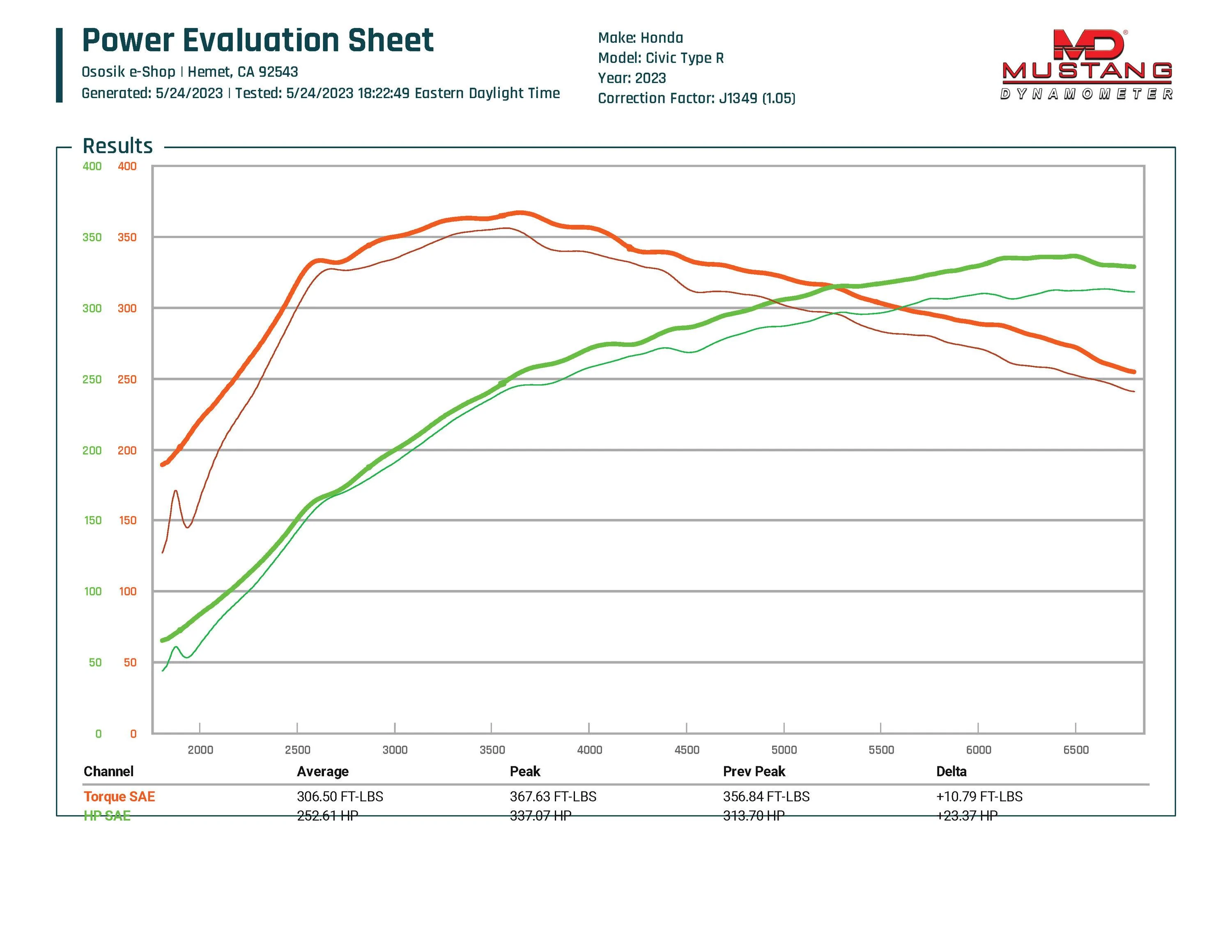

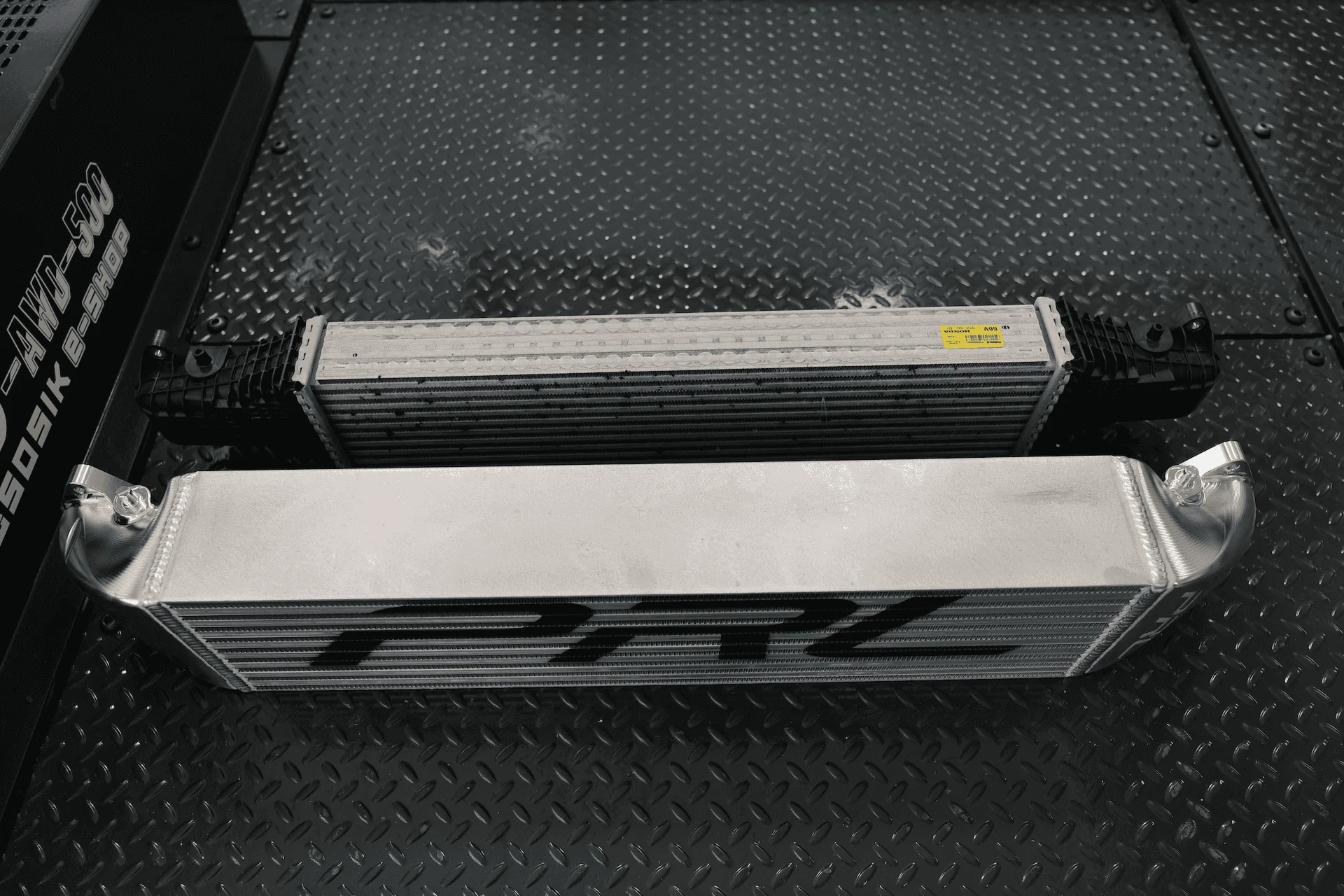

The PRL Intercooler for the 2023 Honda Civic Type R is a great upgrade over the OEM. It provides significantly more cooling power, which translates to increased performance and better fuel economy. Below is the before and after the intercooler Mustang Dyno Plots.

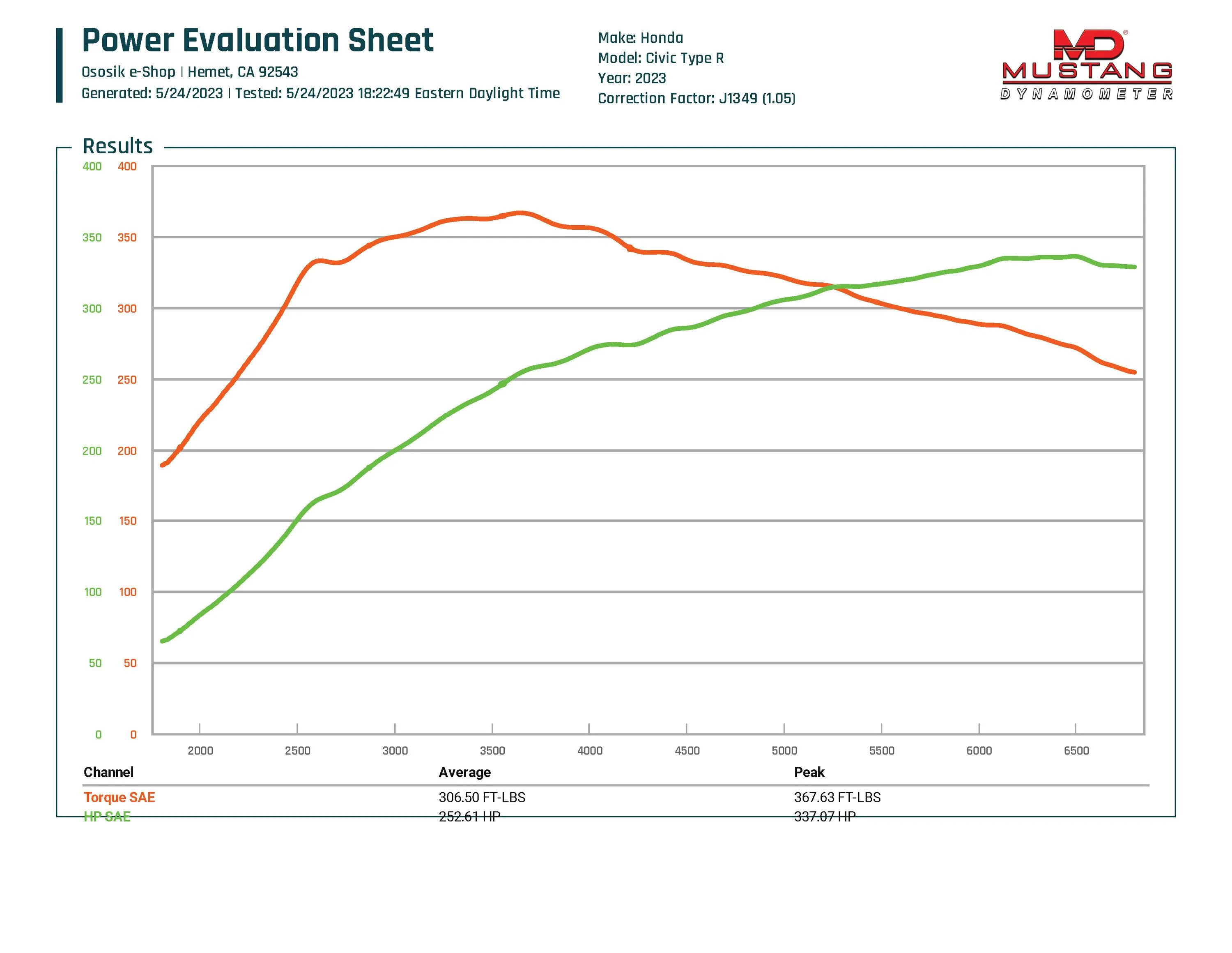

PRL Intercooler, DownPipe, PowerMetric Stage 0.91, Hondata FlashPro:
11th Gen Honda Civic Best Intercooler for New Civic Type R | PRL Motorsports | Ososik ososik-fl5-stage091-dp+ic-baseline
PRL Intercooler, DownPipe, PowerMetric Stage 0.91, Hondata FlashPro VS DownPipe, PowerMetric Stage 0.91, Hondata FlashPro:
11th Gen Honda Civic Best Intercooler for New Civic Type R | PRL Motorsports | Ososik ososik-fl5-stage091-dp+ic-baseline-vs-dponly

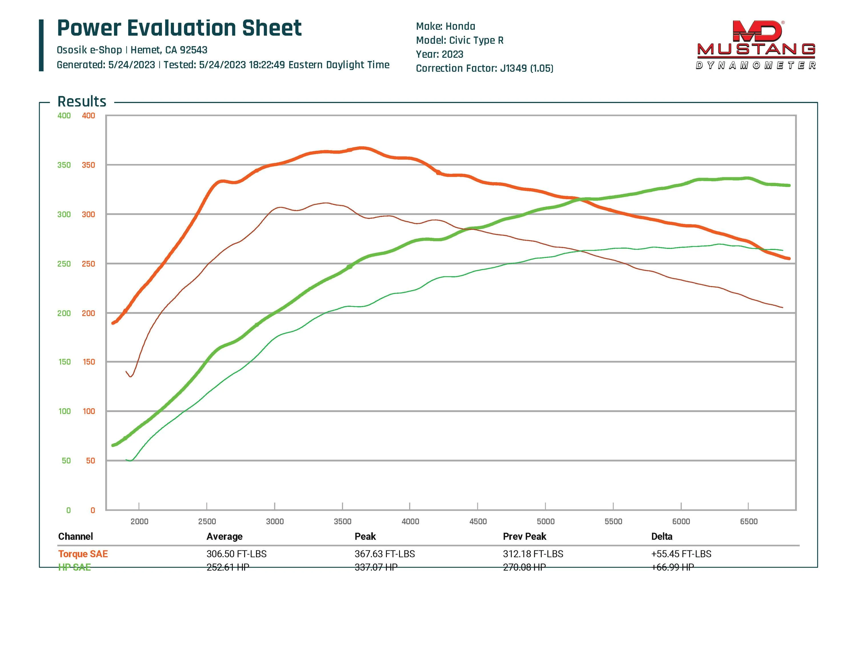

PRL Intercooler, DownPipe, PowerMetric Stage 0.91, Hondata FlashPro vs Stock:
11th Gen Honda Civic Best Intercooler for New Civic Type R | PRL Motorsports | Ososik ososik-fl5-stage091-dp+ic-baseline-vs-stock
Overall, installing a downpipe, PRL Intercooler, Hondata FlashPro with Powermetric tune on your 2023 Honda Civic Type R can provide impressive gains in both power and torque. This upgrade is definitely a must-have for any Civic Type R owner looking to get the most out of their car! With this setup, you can be sure that your Honda Civic Type R will have all the power and efficiency it needs to take on whatever comes its way.
