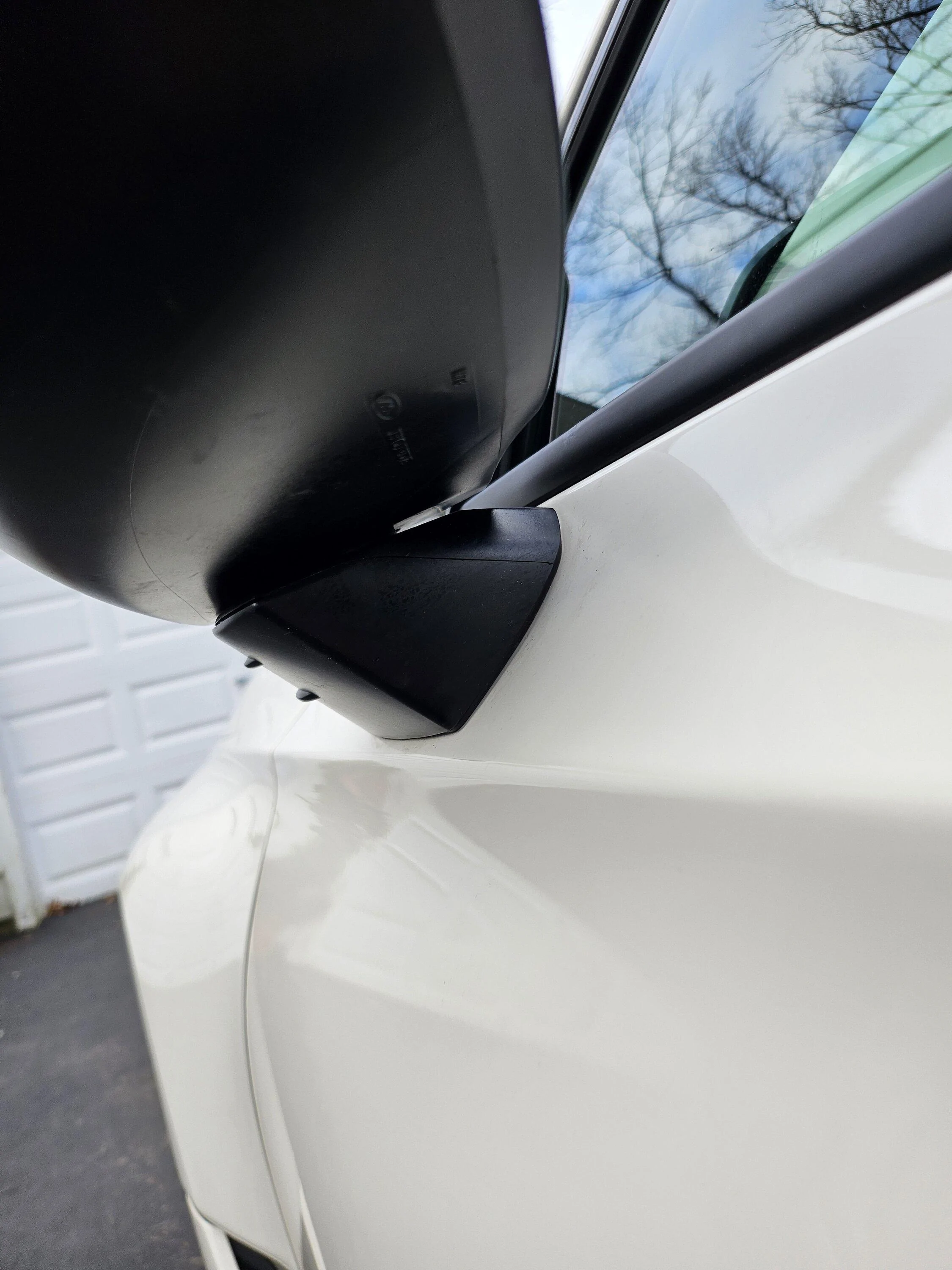

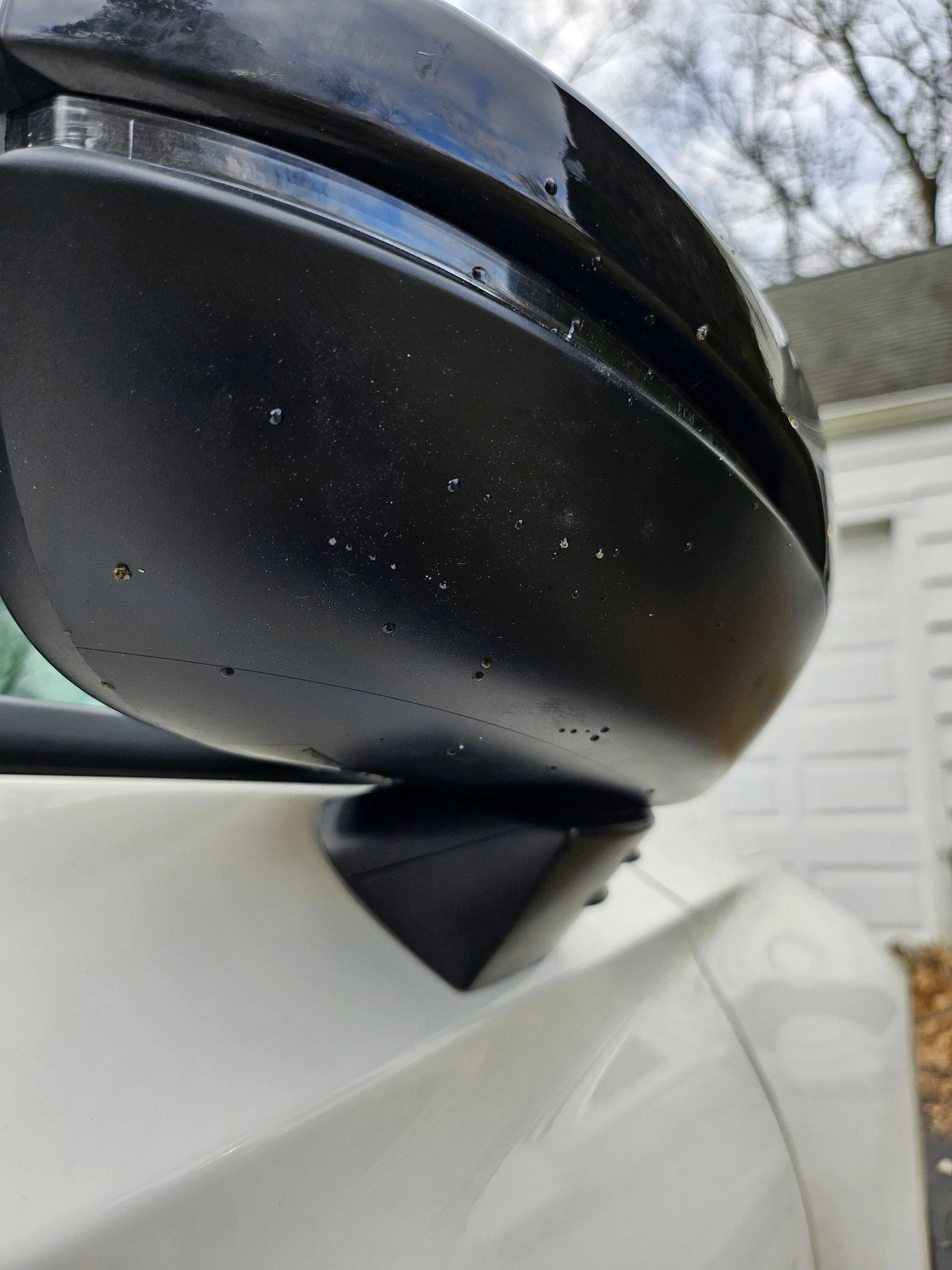

Had the mikstore fL5 kit installed by an shop a few days ago.
https://mikstoreph.com/products/civ...1&_sid=e0ca2a11f&_ss=r&variant=44409511117050

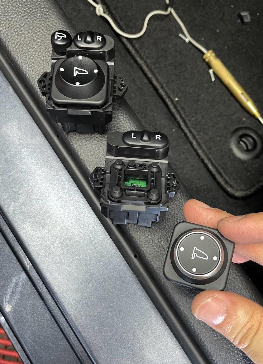

Works great! 160 bucks- Lock/unlock mirrors fold in/out. I did notice the drivers side is not as flush as passenger so i will be taking the car back for them to look at... also the switch itself- i did keep the silver trim- it DOES NOT illuminated(back light) with night driving... i'm looking at buying an OEM switch found this:
https://www.ebay.com/itm/1650274489...486&ssuid=&var=&widget_ver=artemis&media=COPY
Not sure if it will be plug & play AND have the backlight illumination.. could anyone perhaps confirm this? Part # is in the ebay link thanks!
