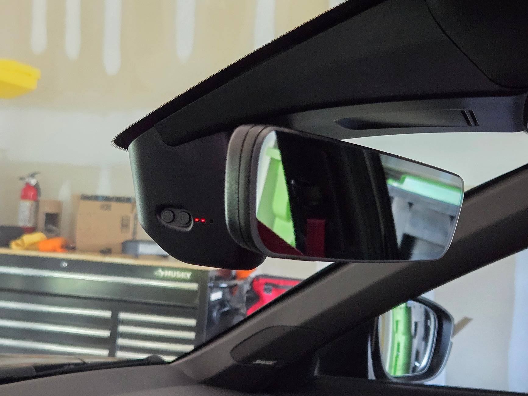

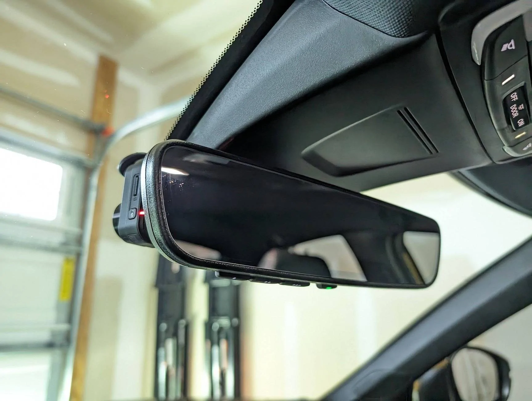

Crazy part is the Accord Frameless homelink mirror is way cheaper than the Civics Framed Homelink mirror.
I attached a picture when I had the Type S, but unfortunately you cannot tell the difference based on the pictures :(
Either case the Accord solution is simple and works perfectly well for me.
Top image with Civic frame mirror is from my old Type S
Bottom image with Accord frameless is from my Type R
**Looking at the picture, I also just now realize Type R does not have Off/Door/On map light switch like the Type S, no wonder it looked darker when opening doors haha ..I never really questioned it.

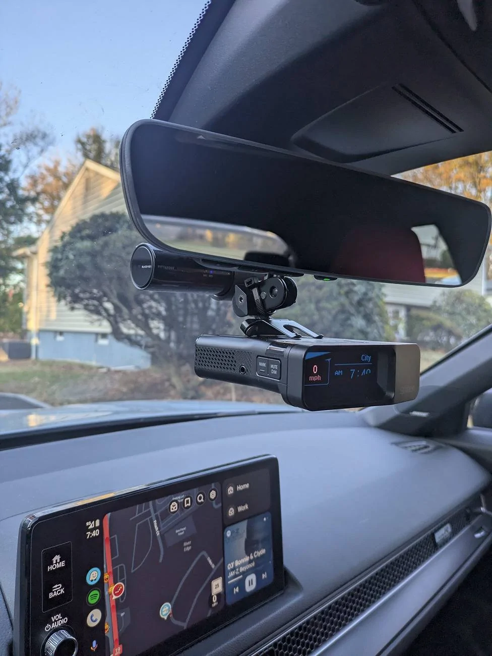

Completed my install a couple weeks ago. Thanks OP for the instructions and parts #!
Hardwired radar detector to fuse #45 with a fuse tap. that kicked my @$$ until i found a post on reddit. The cig lighter is not the choice I found out repeatedly.
Radar Mount, while not the prettiest, it does blend in with everything else. This same one has worked in 4 different manufacturers, so I'm a believer. https://amzn.to/3ZnXnx6
I wired in a Thinkware external battery to always keep the dash cam running, and placed it under the driver seat. used the power from the mirror harness https://amzn.to/4fFxQoG
And used a Blackvue https://amzn.to/3VtEqGX don't have the LTE module like this one, but probably will.
The only con is that I think this mirror vibrates a touch more in parking with the RMM than the OEM cheapie mirror
