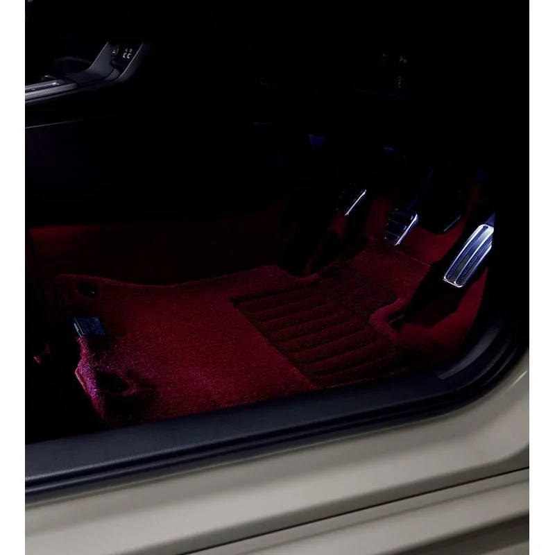

Question, I see that you upgraded the foot kit, what is the difference between this Japanese kit and the one that comes factory on the car? I received my FL5 this week and the footwells light red from factory, is it exactly the same and here in Canada we get it doesn’t included option on the car ??
The part number of the kit I’m talking about is 08E10-T43-000B
This foot light accessory adds an additional light that gets mounted under the front seats of the car as well as replacing the front ones that come with the car to a better LED light that is now tied into the dimer for the light control.

- 08E10-T43-000B -Foot light & Seat under light Red

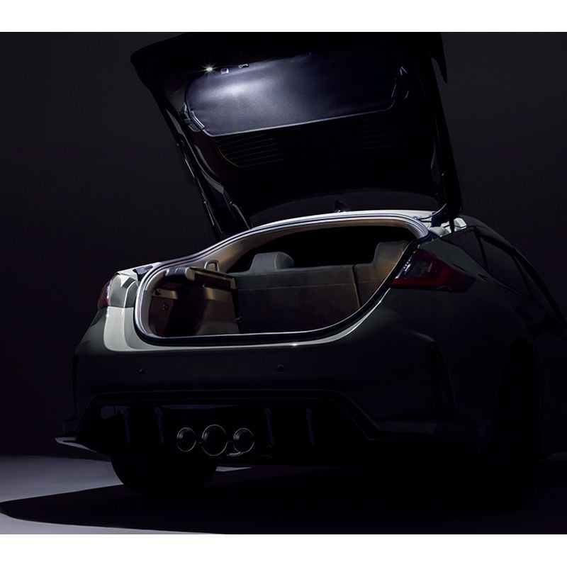

-08E17-T43-000 LED Tailgate Light

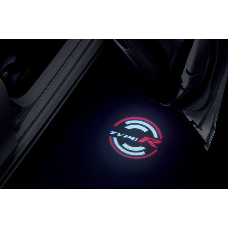

-08V27-T60-A00 (Pattern Projector)
-08V27-T43-000 (Paddle Light)
I posted pattern projector install instructions previously (they came from Cox in the UK)--they're RHD-specific, so you won't be able to follow them directly. If you do, you'll wire the projectors into the front power window switches (I posted a video of this). If you follow the left door instructions for the right door and vice versa, you'll wire them to constant power and they'll be on 100% of the time and will eventually wreck your battery (don't do that).
I tried to track down LHD instructions, but Honda Access says this accessory is only designed/available for RHD models. If you purchase, prepare for a potentially lengthy install.
@Clark_Kent has done the tailgate light, but I'm not sure if he did so with instructions from Honda Access.
I did not install the tailgate light. A friend installed it with no instructions. Not sure if they exist.
Do you know if there was a harness for an easy connection that existed under the tailgate interior panels?
Hey can it be the part number for LHD kit is 08V27-T60-600
because the jdm Rhd is 08V27-T60-A00
Yes, tie into the existing wiring. The kit comes with the splitter already made, so there's no weird wiring stuff. Plug the new harness into the factory spot where the existing light is (passenger side). Then use the short end to connect the existing factory light, then run the long end around to where the new light will be mounted. It's a fair amount of work for an LED light, but once completed, it looks good and it's a nice functional add.
If I knew this would be so popular when I had this installed many months ago I would've asked my friend to pull together a high-level installation guide.
