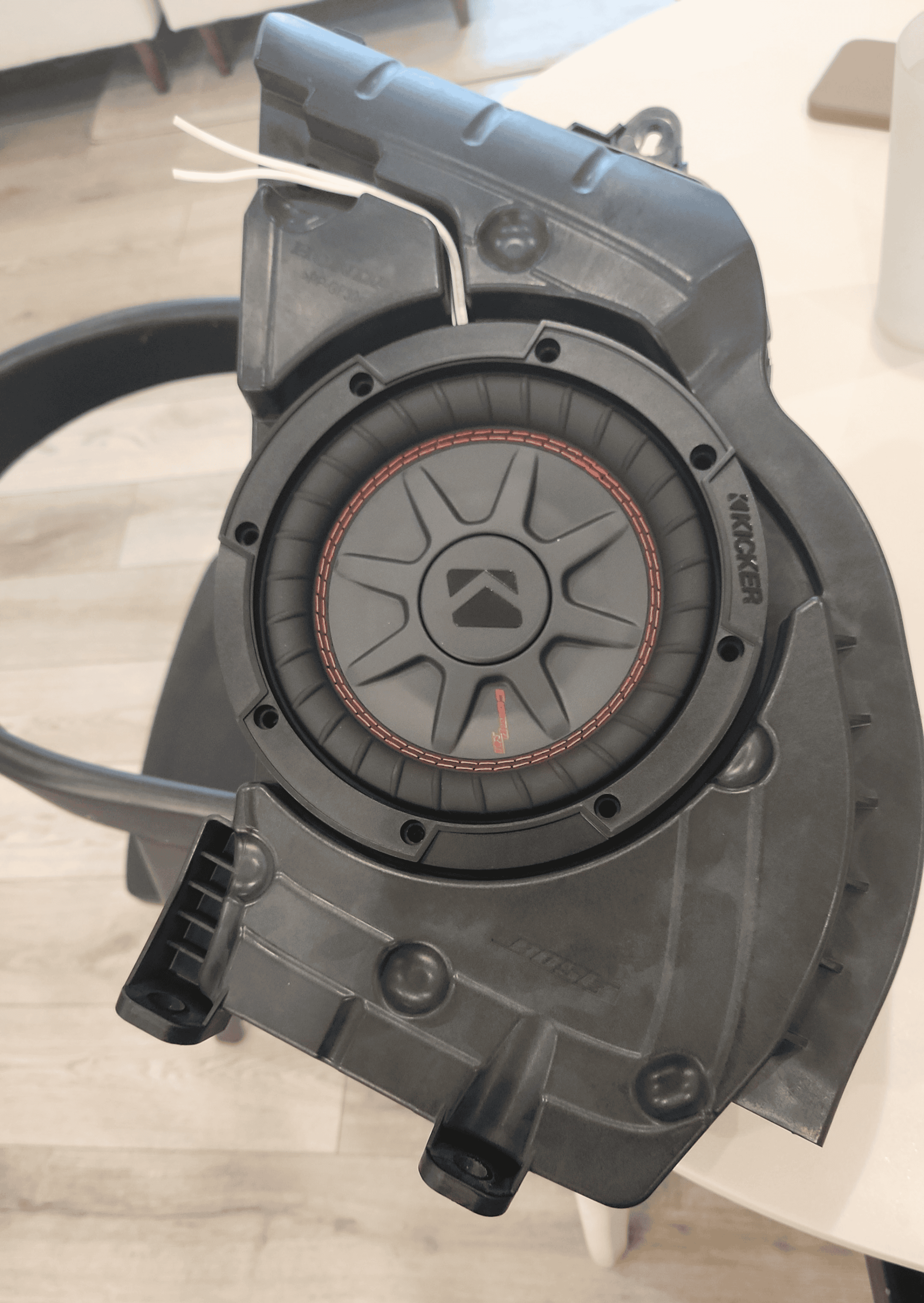

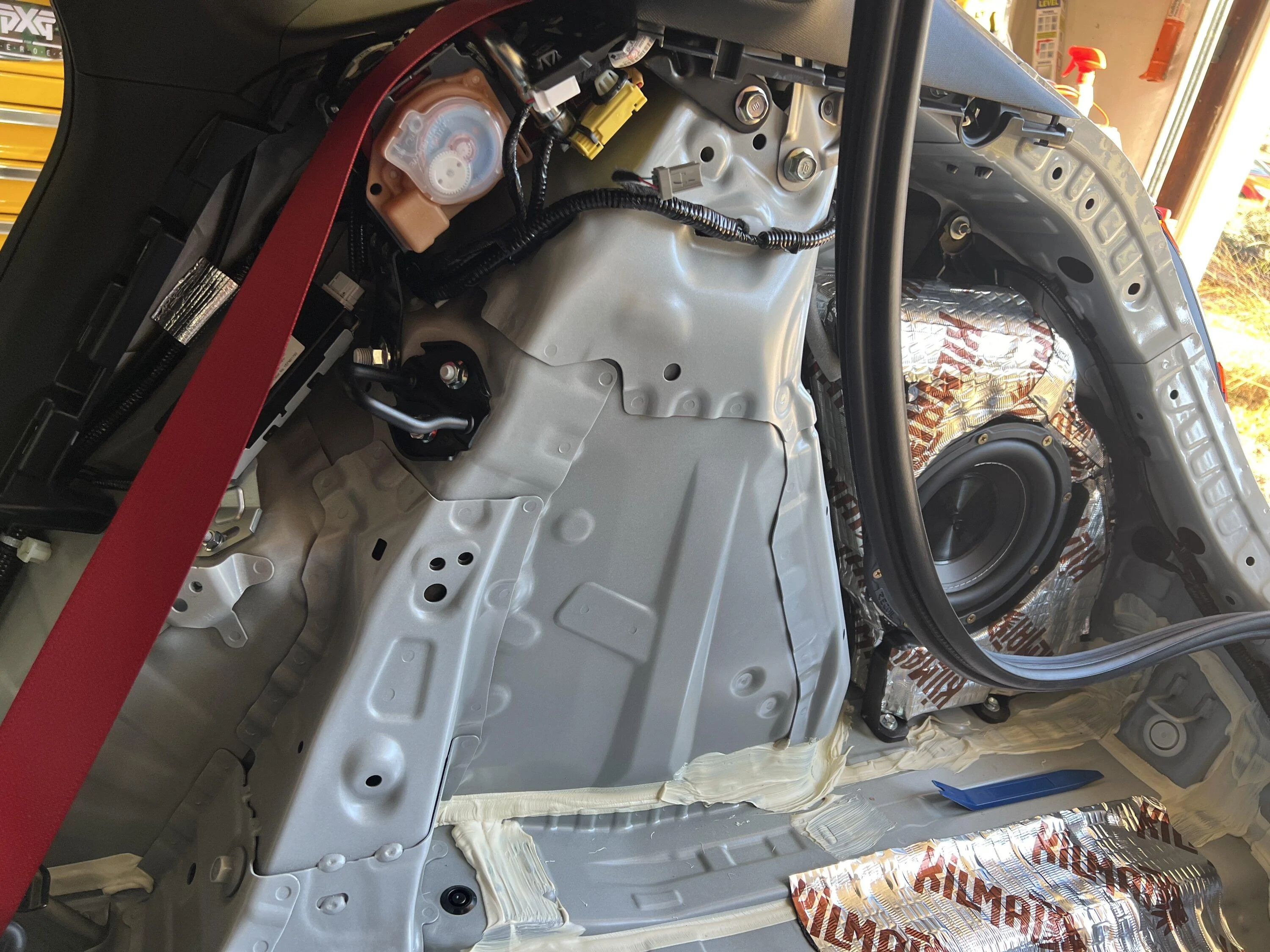

Phase 1 upgrade: Swap OEM Bose sub to aftermarket kicker 8 in shallow mount 2ohm DVC that I already had from a previous car.
Results: not enough juice to power 2 ohm DVC 8 in Kicker wired to 1 ohm. Waiting on amp and loc to arrive to complete my goal.

Yeah, as I said the stock amp doesn't provide enough power to really exploit a driver upgrade. Even with more power I wouldn't expect to get too much - we're only using an 8" driver in a very small enclosure so it's not going to go deep.

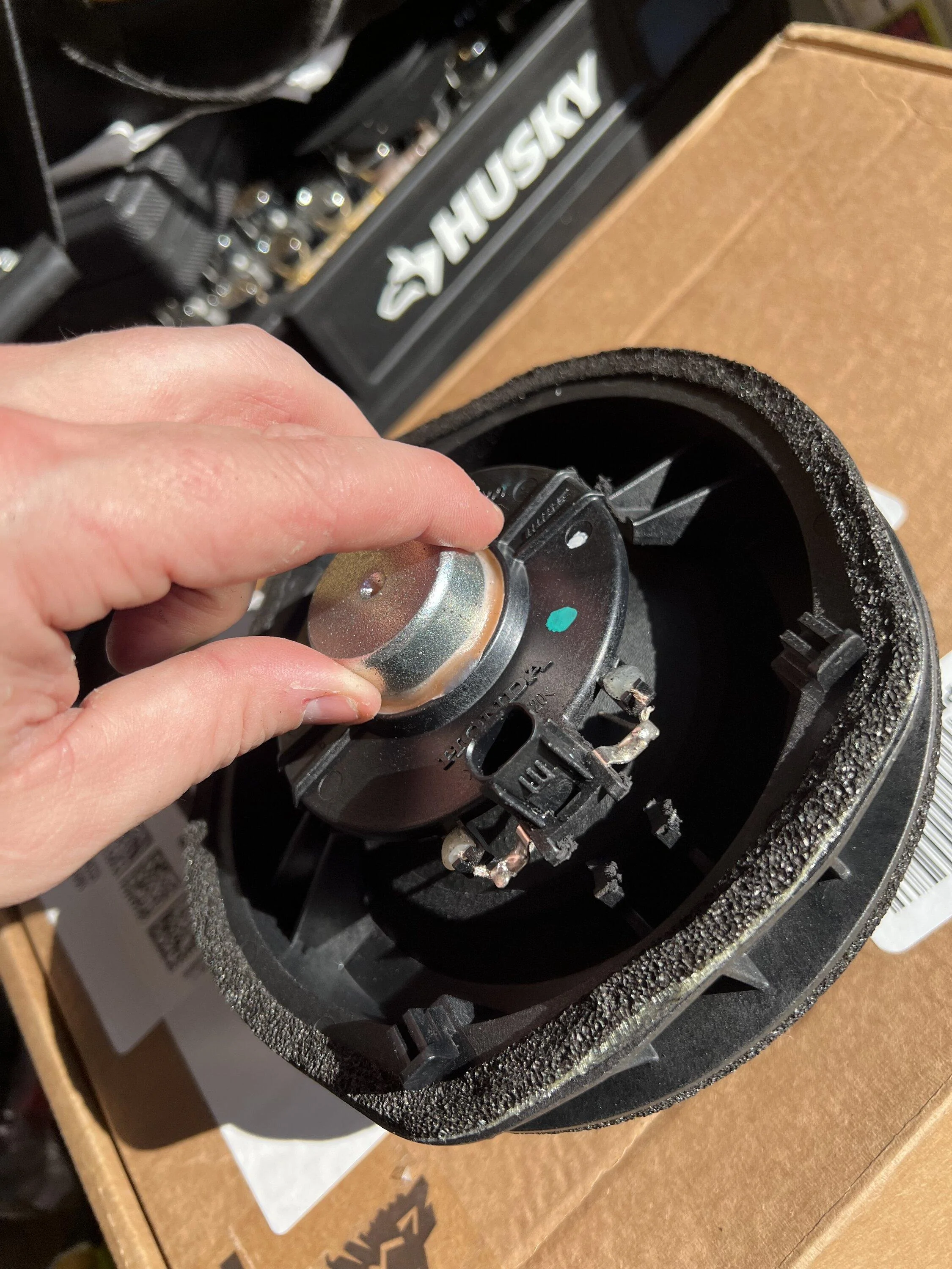

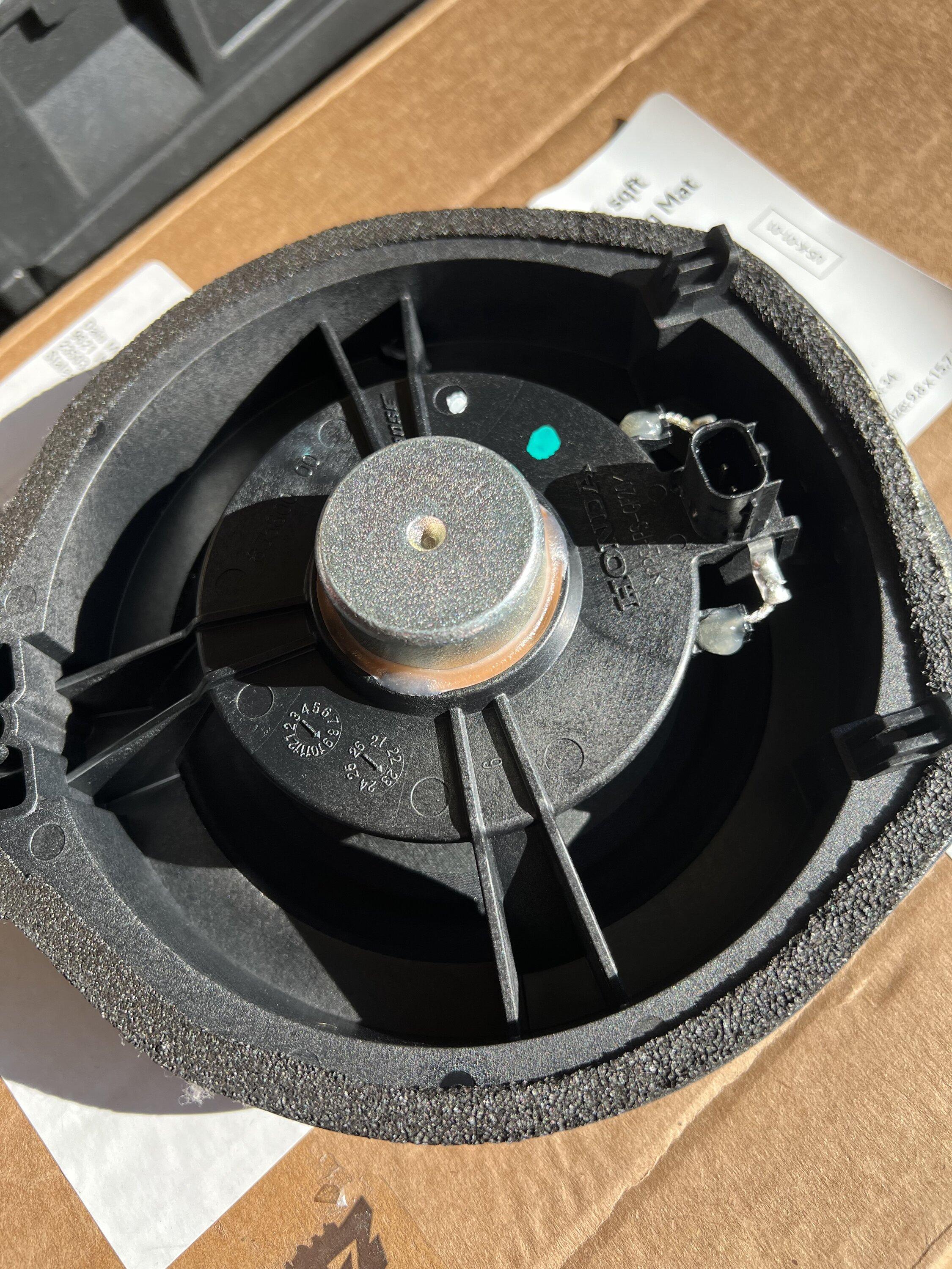

My speaker project today. I’ll give the full details later but this in the OEM housing with OEM plugs 🥰

What are you using there? Remember the front doors/sub are 2ohm and everything else is 4ohm. Looks like it's downsized too?

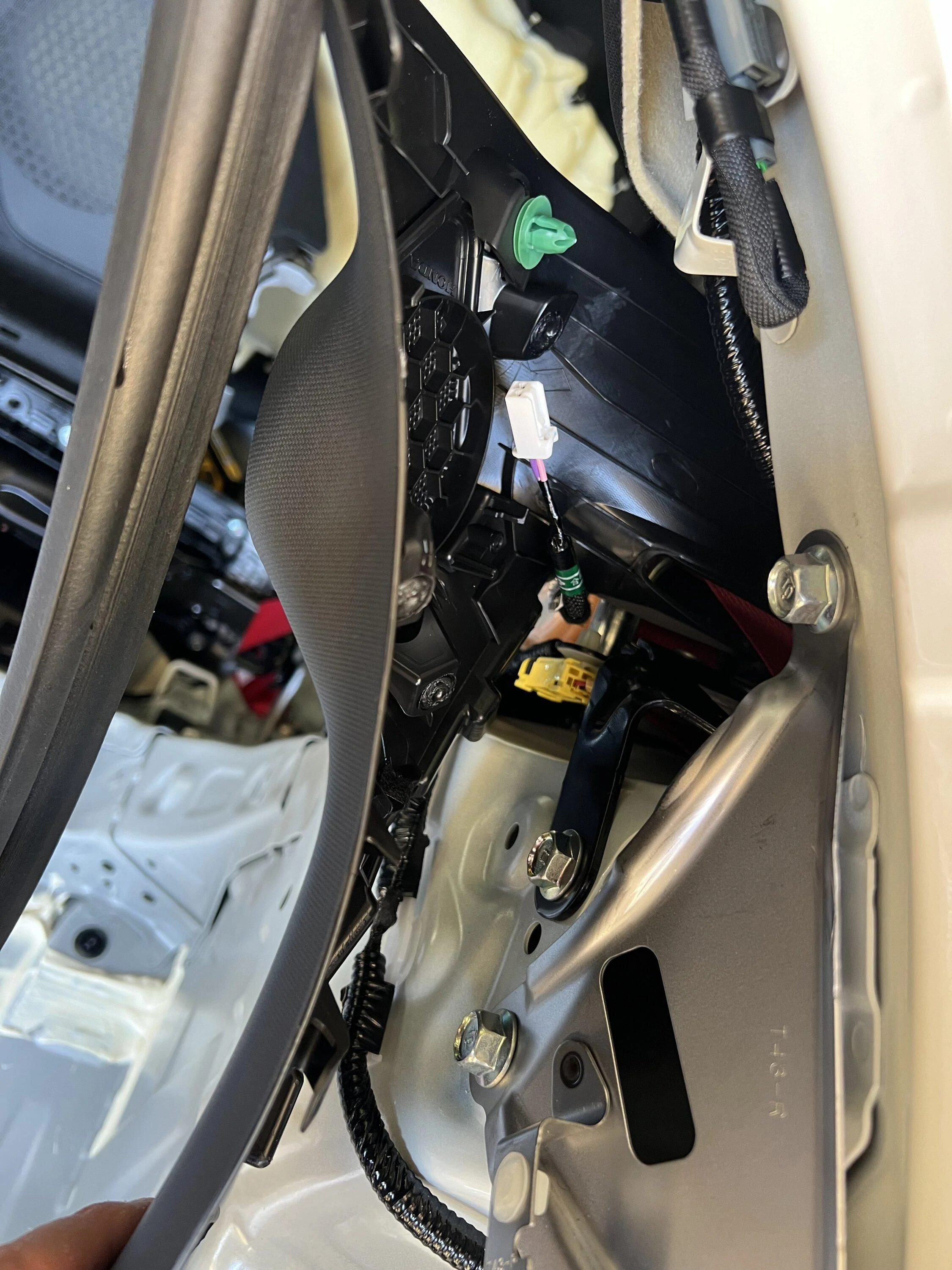

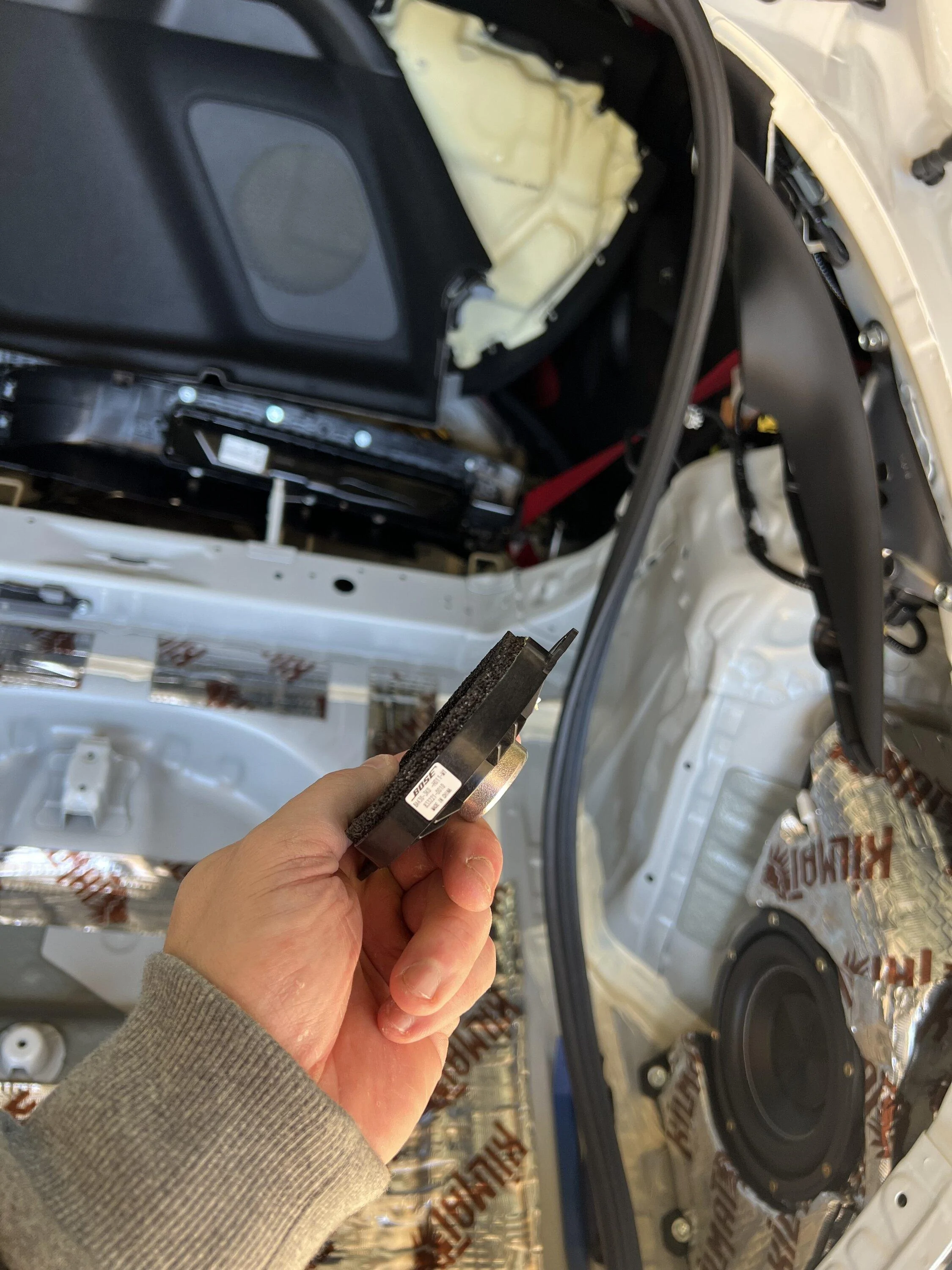

I wanna make a suggestion to everyone and tell them do not mess with the speakers in your c pillars a.k.a. your hatch. The speakers are less than an inch thick and anything thicker will not fit because it will hit the roof support frame rails. Here’s some photos so you have some evidence.

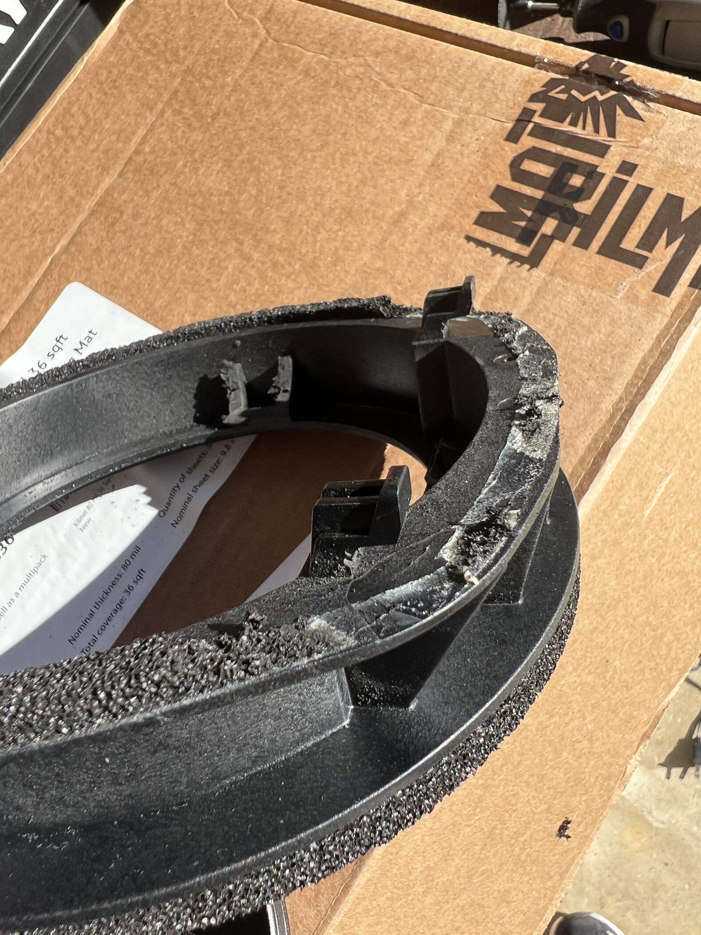

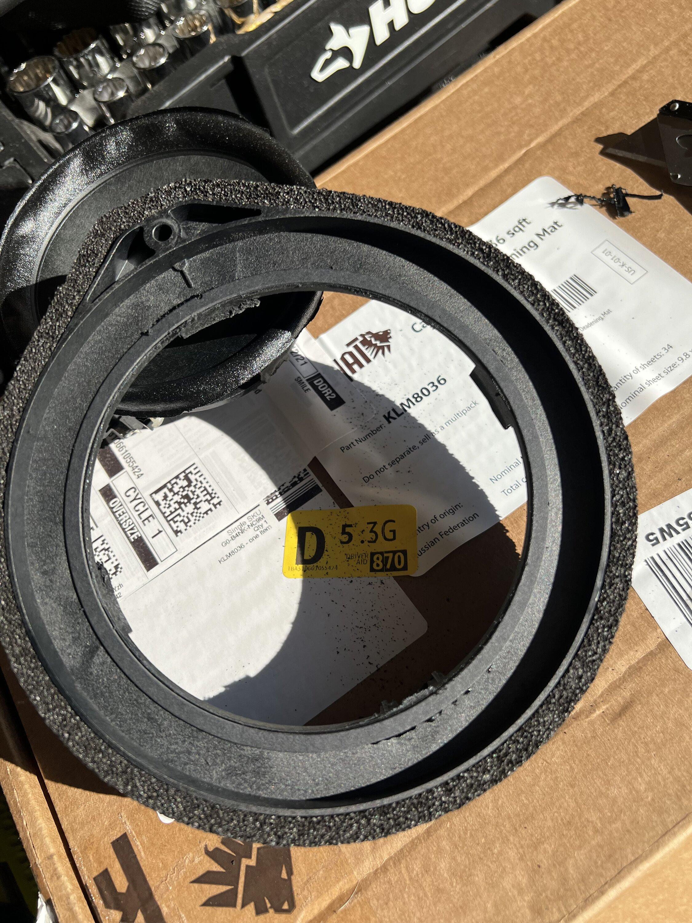

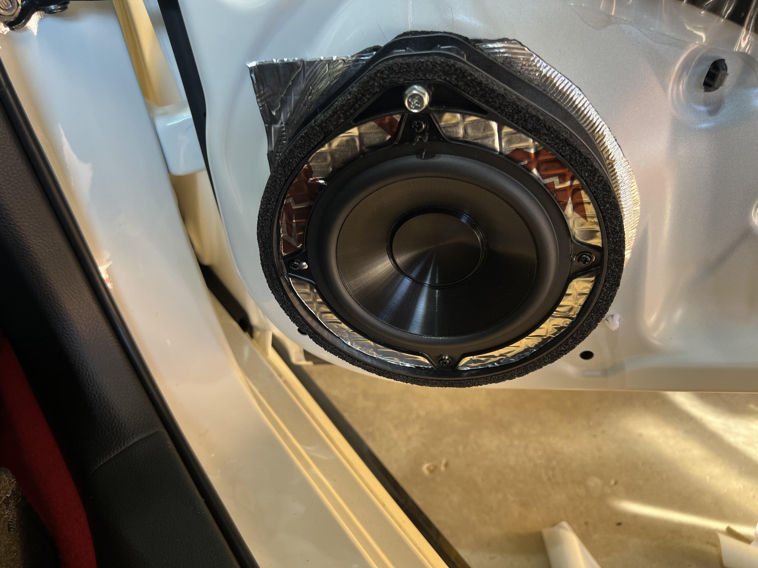

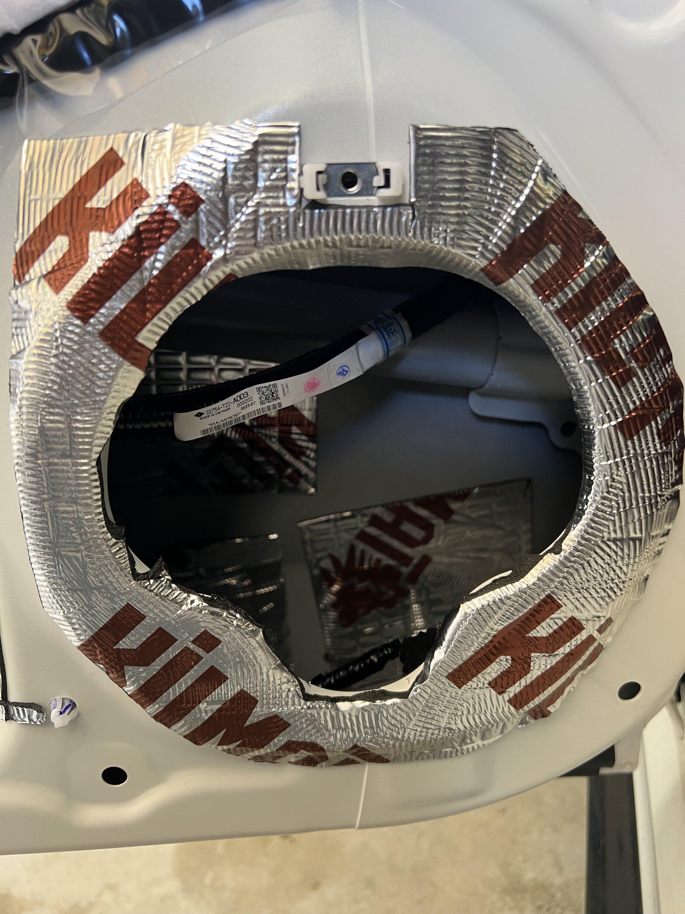

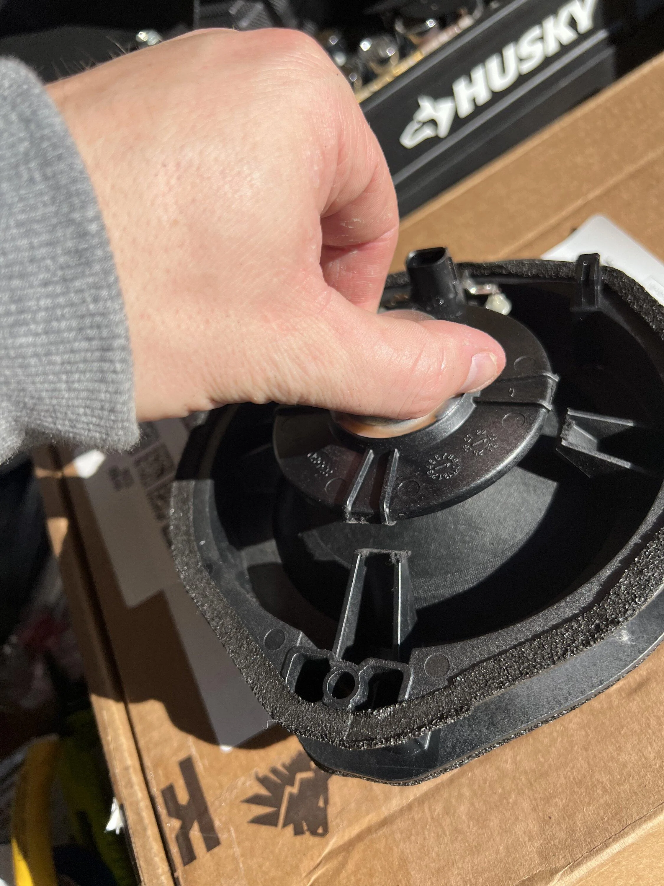

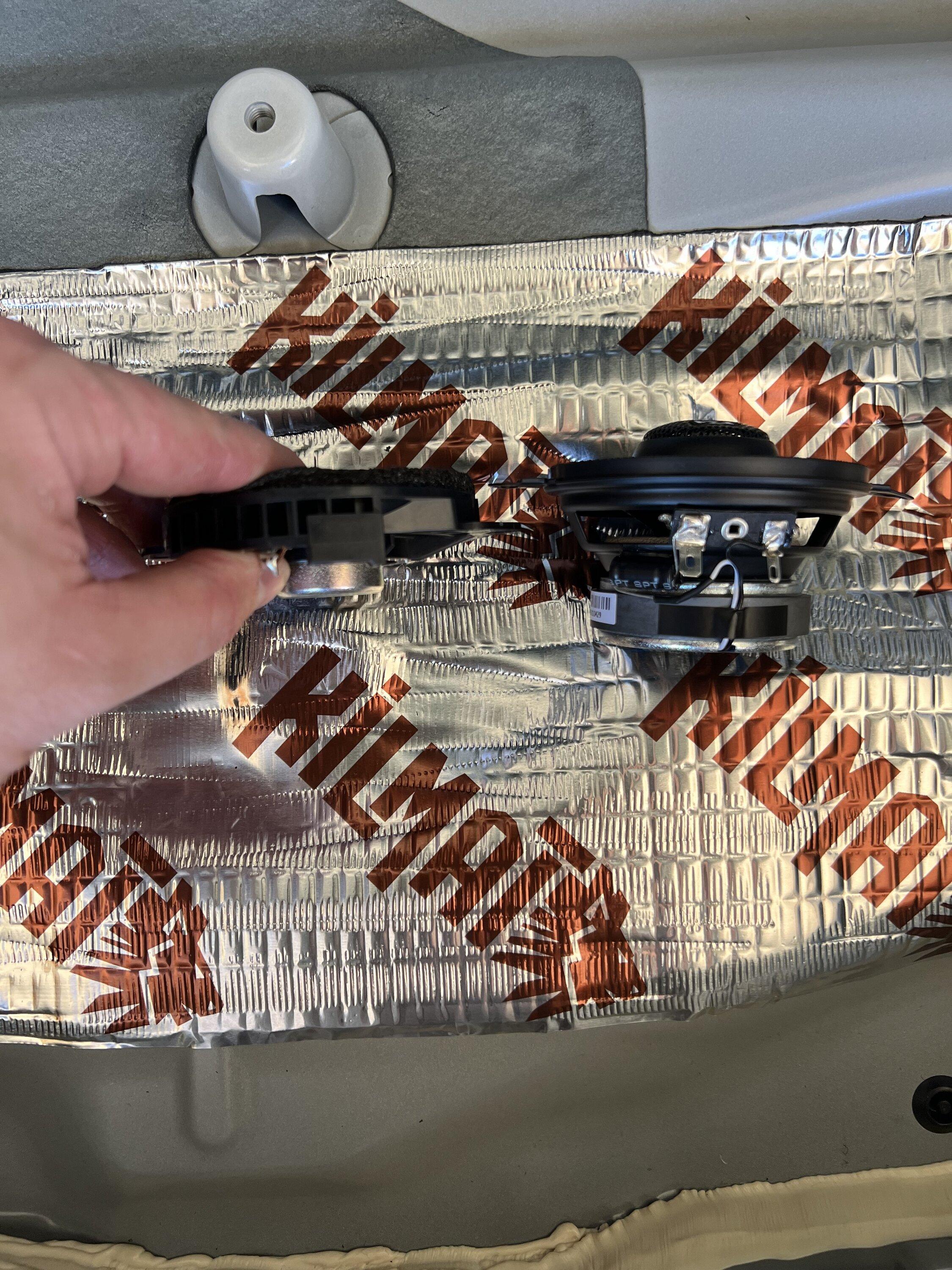

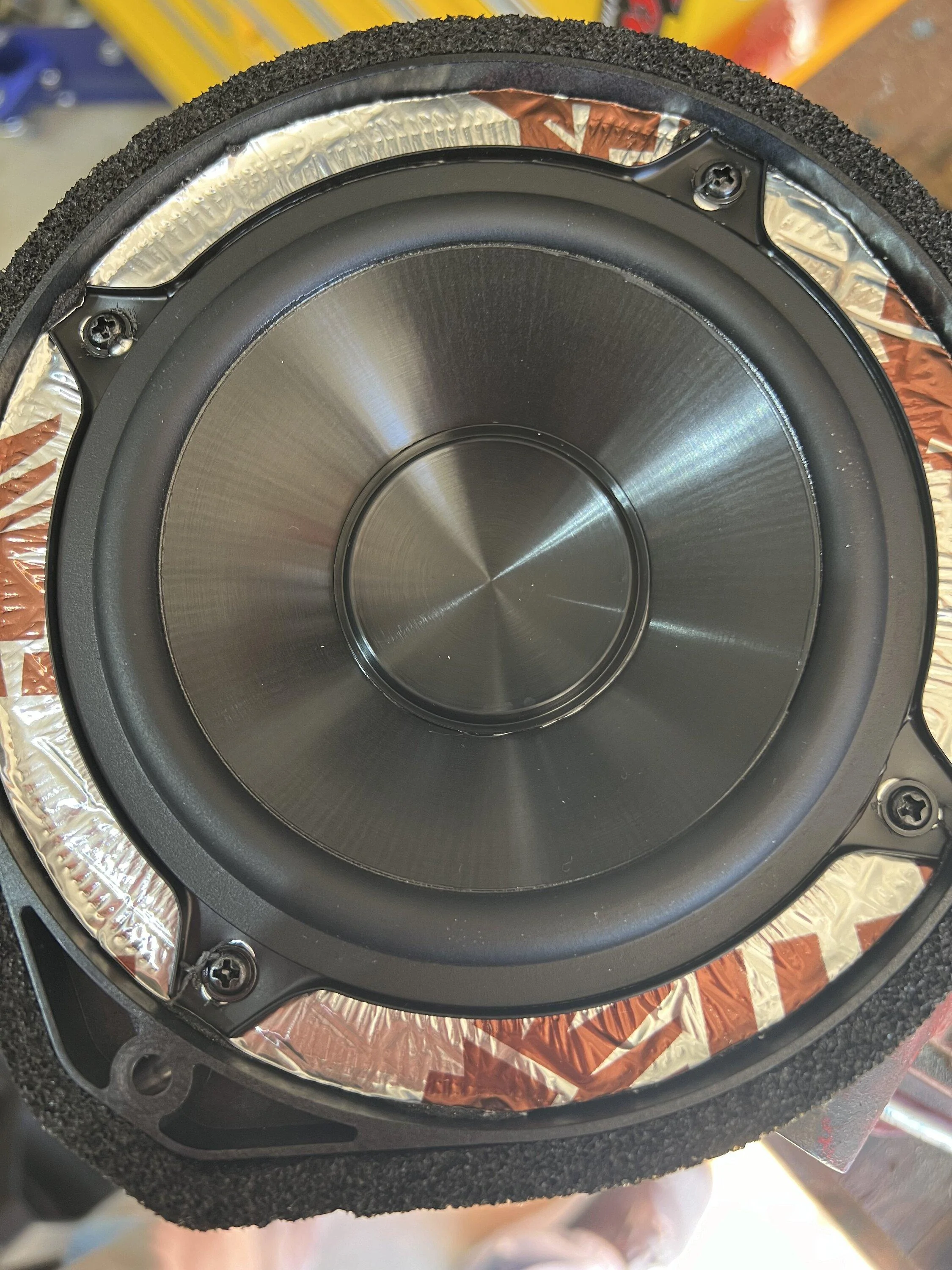

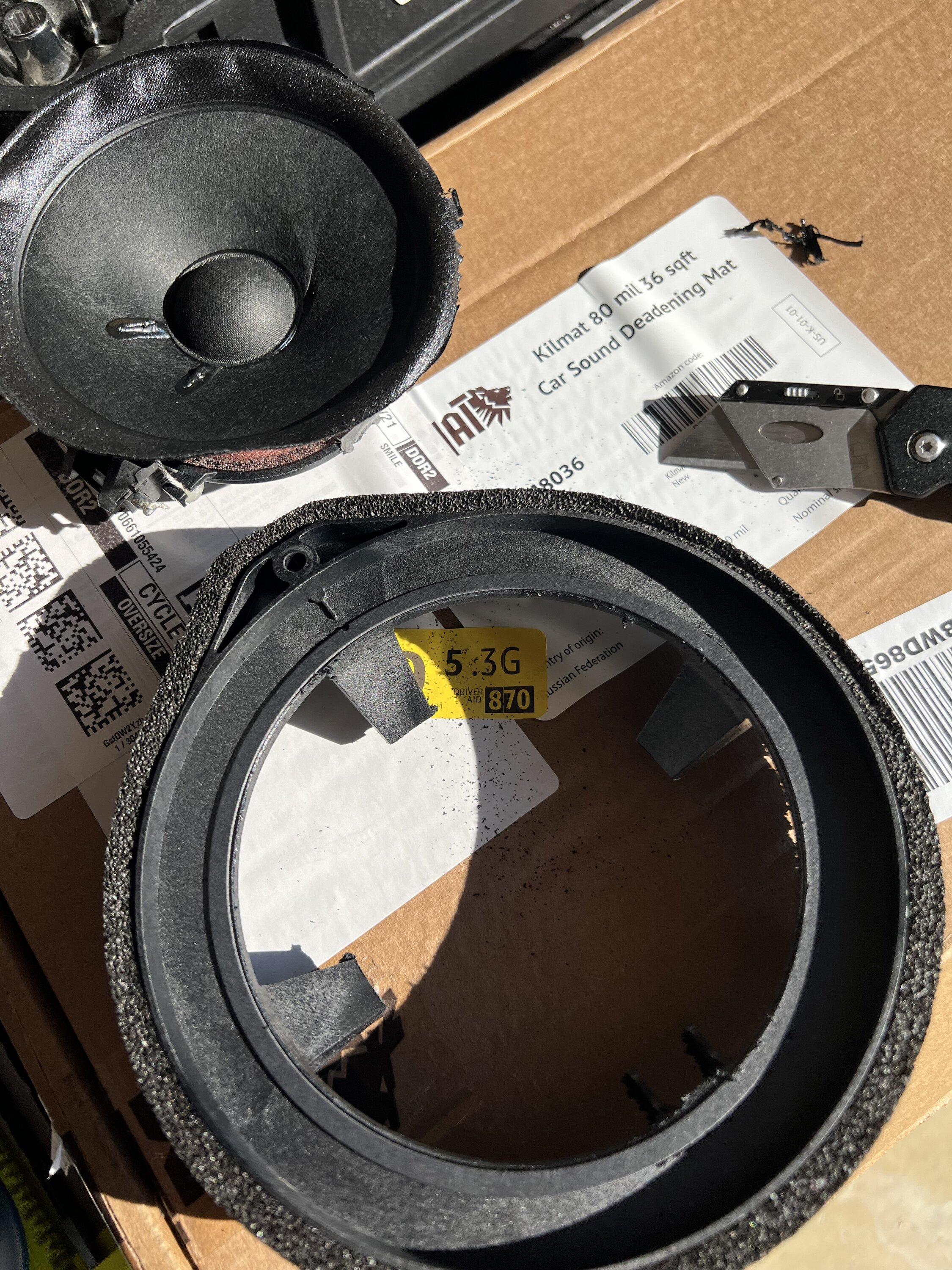

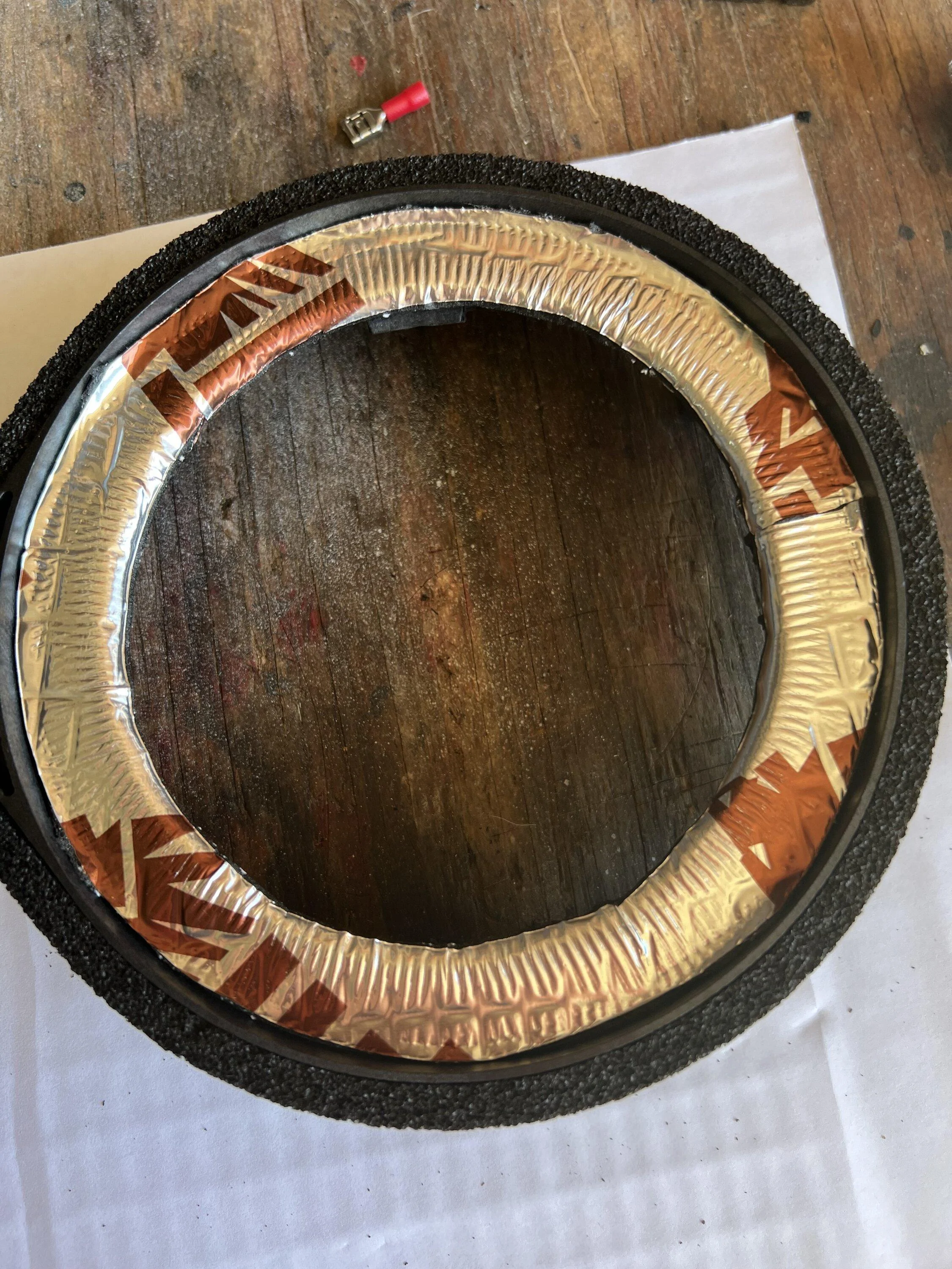

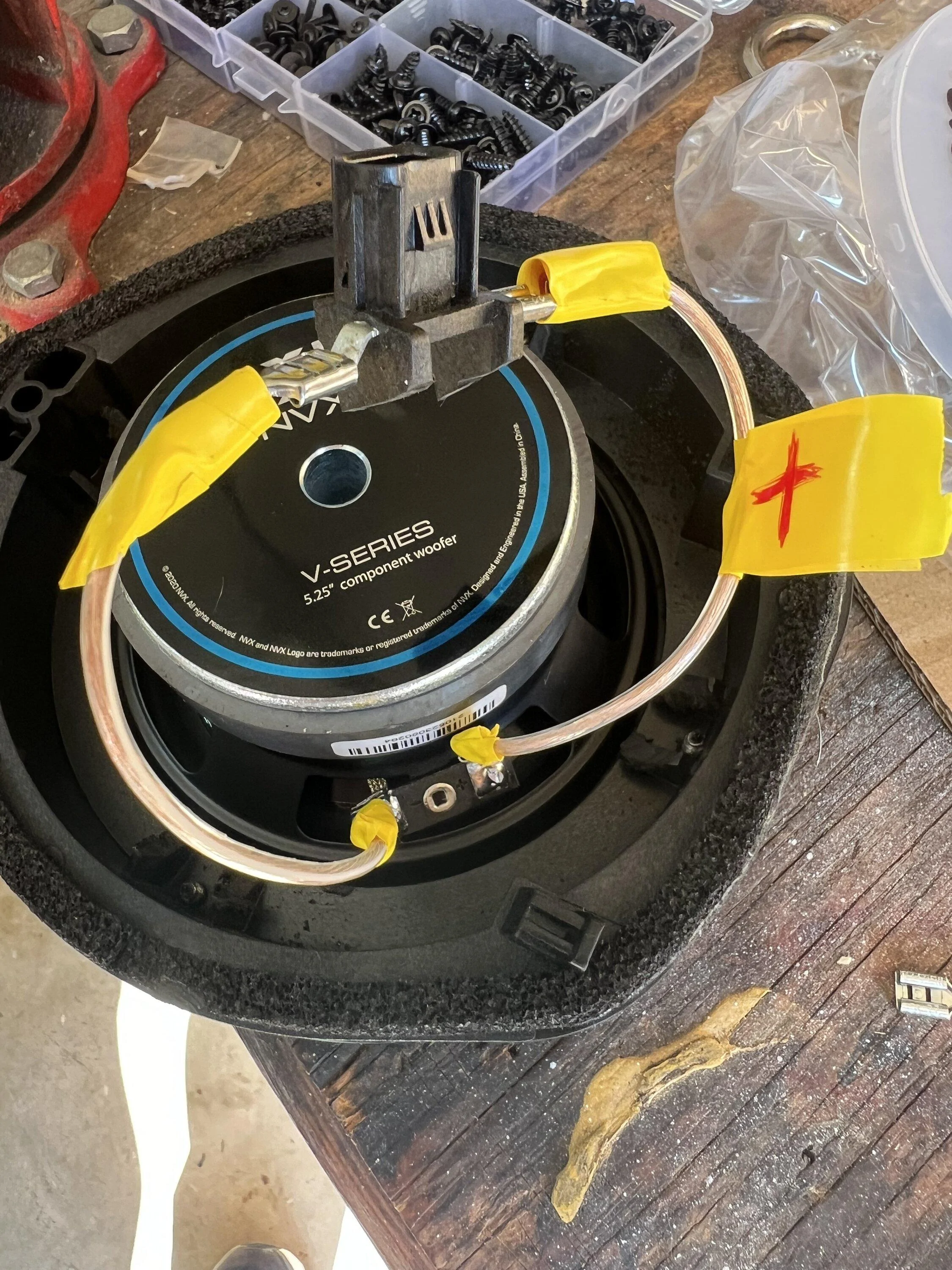

I put the rear door speakers in today. I took a different approach as I wanted to door woofers only. I think the tweeters in the car are fine just want a little more punch from the mids. So I removed the OEM Bose speaker. Cut it out of the housing. Saved the adaptor. Wired the new speakers to the adaptor. Used some killmat to seal it all up and put a little in the doors and on the door panel. Came out great. I can always answer questions just LMK.
These contribute basically zero so I don't recommend replacing them either. I did not realize the space was so tight but I only took a quick look when I was doing some other work (sub) back there.
I would do the front tweeters, the rear ones I can understand saving some money since they aren't likely too audible from the front seat. IMO, the most critical speakers are the front doors followed by front tweeters, then either the center speaker if you use it or the rear doors. Center, rear tweeters, and sub are much less important IMO and as mentioned the hatch ones... just ignore.

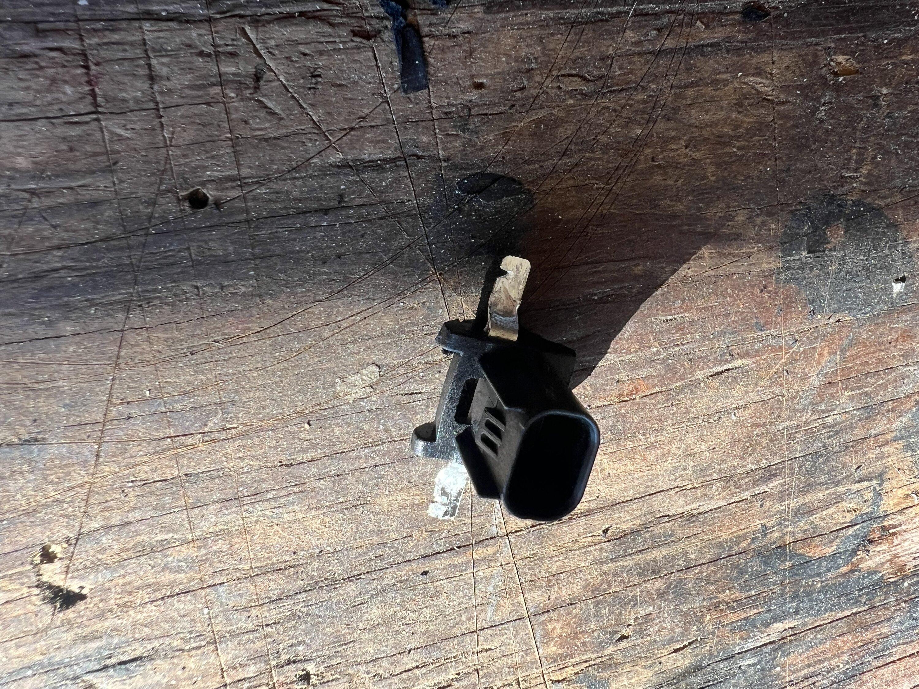

I like that you repurposed the rear door speaker mounts, I hadn't considered that. I did post part #s for the door driver plugs so you can save the effort of removing the stock ones and reusing. I never found plugs to use for the tweeters, center, or sub though.
I do suggest some baffles or rain guards for at least the front door speakers - I had to fiddle with mine and saw there were water spots on the magnets. I imagine that if the front has water intrusion the rears do too. Didn't see this on the OEM ones though...

As for the plugs for the tweeters and sub and center I'm still looking as well. i have ordered 2 different plugs that said they are the ones but have not been correct. I have more coming in the mail currently. Hopefully we can figure this out.

FL5ap how broken in is the sub? how big is the driver? the lower the power rating and the smaller the VC and smaller the magnet the easier time a lower power source will have moving it, I get enough bass to slightly sake my rearview mirror, that's all. Sorry you did not like it.
I wouldn't say it's broken in. I think my biggest issue with the swap was it wasn't an improvement over the OEM sub and overall car audio was worse.
I think you are onto something - the driver I used is "heavy duty" and while it's better than OEM I barely notice its output. Maybe a more reasonable driver would actually sound better in this application but there is also a low pass cutoff it feels like.
Would you mind playing something like this freq test and see what you can go down to?
Regardless I think using a cheap driver here makes the most sense unless you are going full hog w/amp. Spend the money on the front door drivers and tweeters - it's where most of what you can hear is going to come from.
