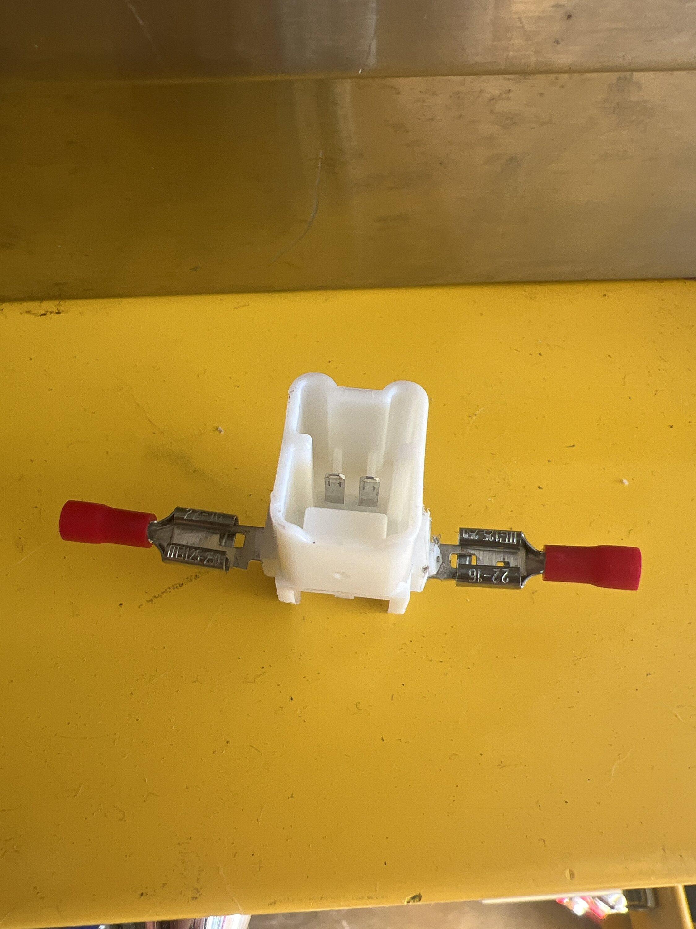

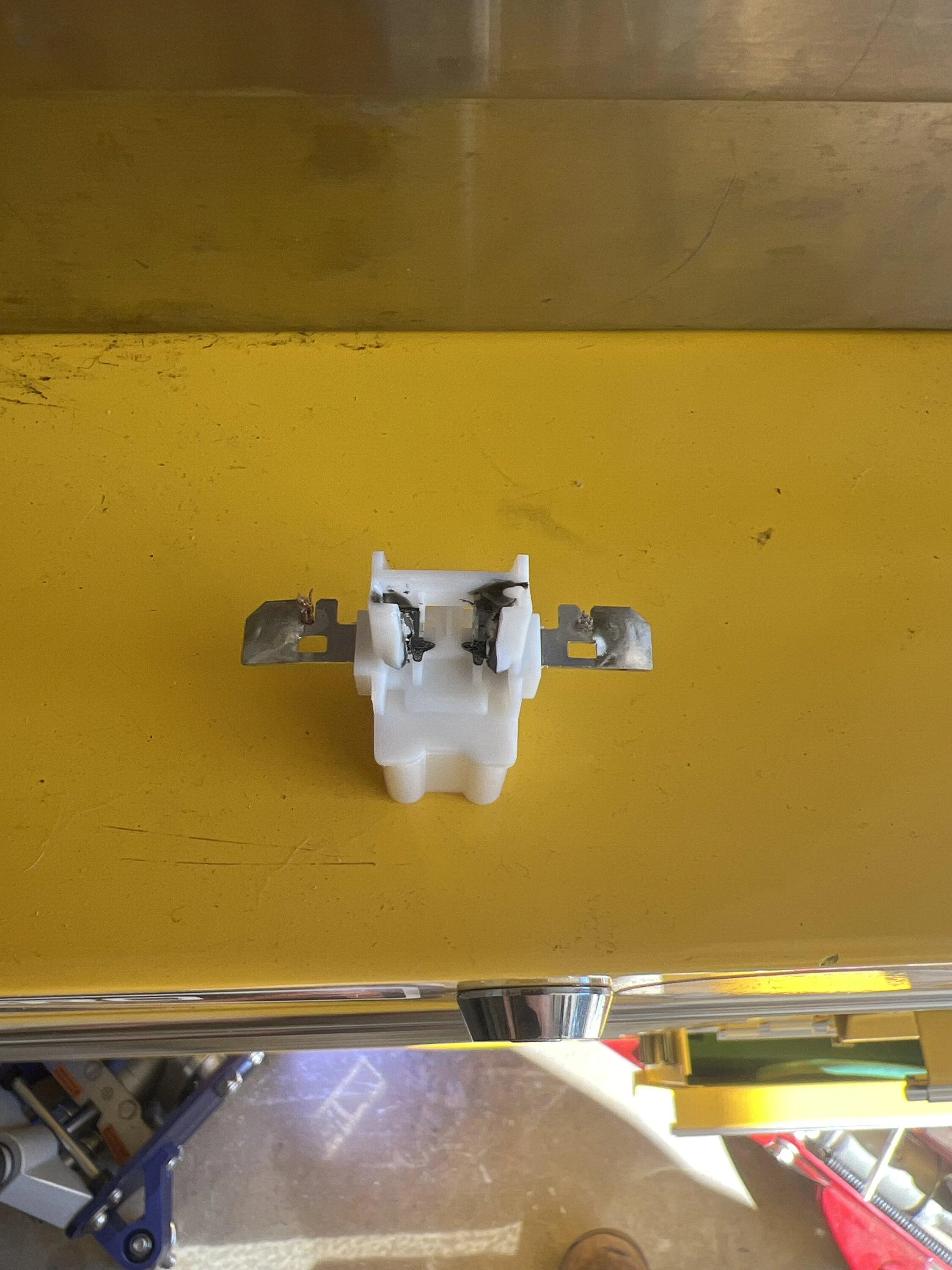

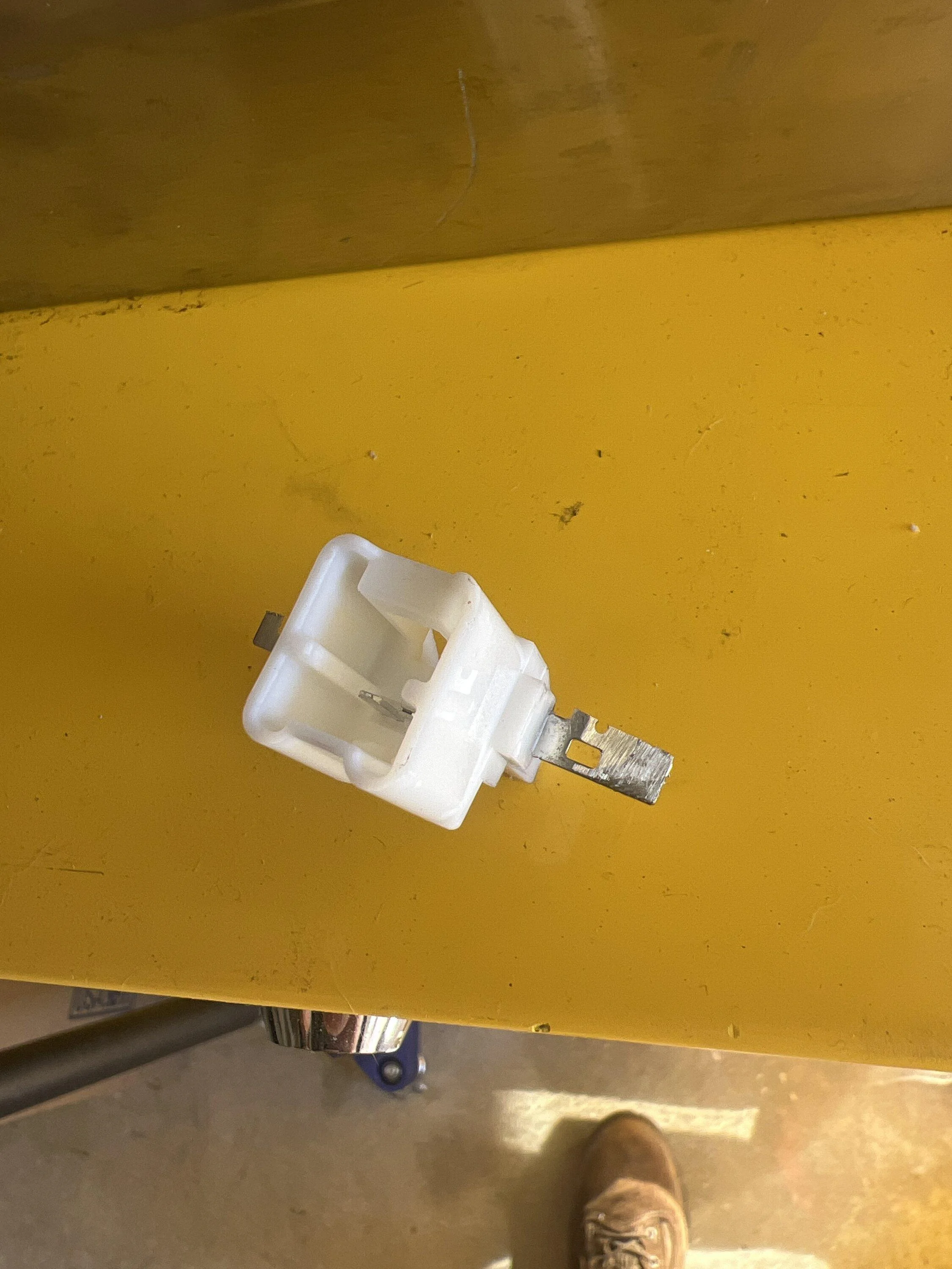

Update. : This is more details about the plug on your OEM sub. I wanted to have the option to put it back so this is what I did. Removed the clip from the speaker. Removed the solder. Then filed down the connected just enough to put a connector on it. Now I can use the factory wiring and plug. Issue solved. .

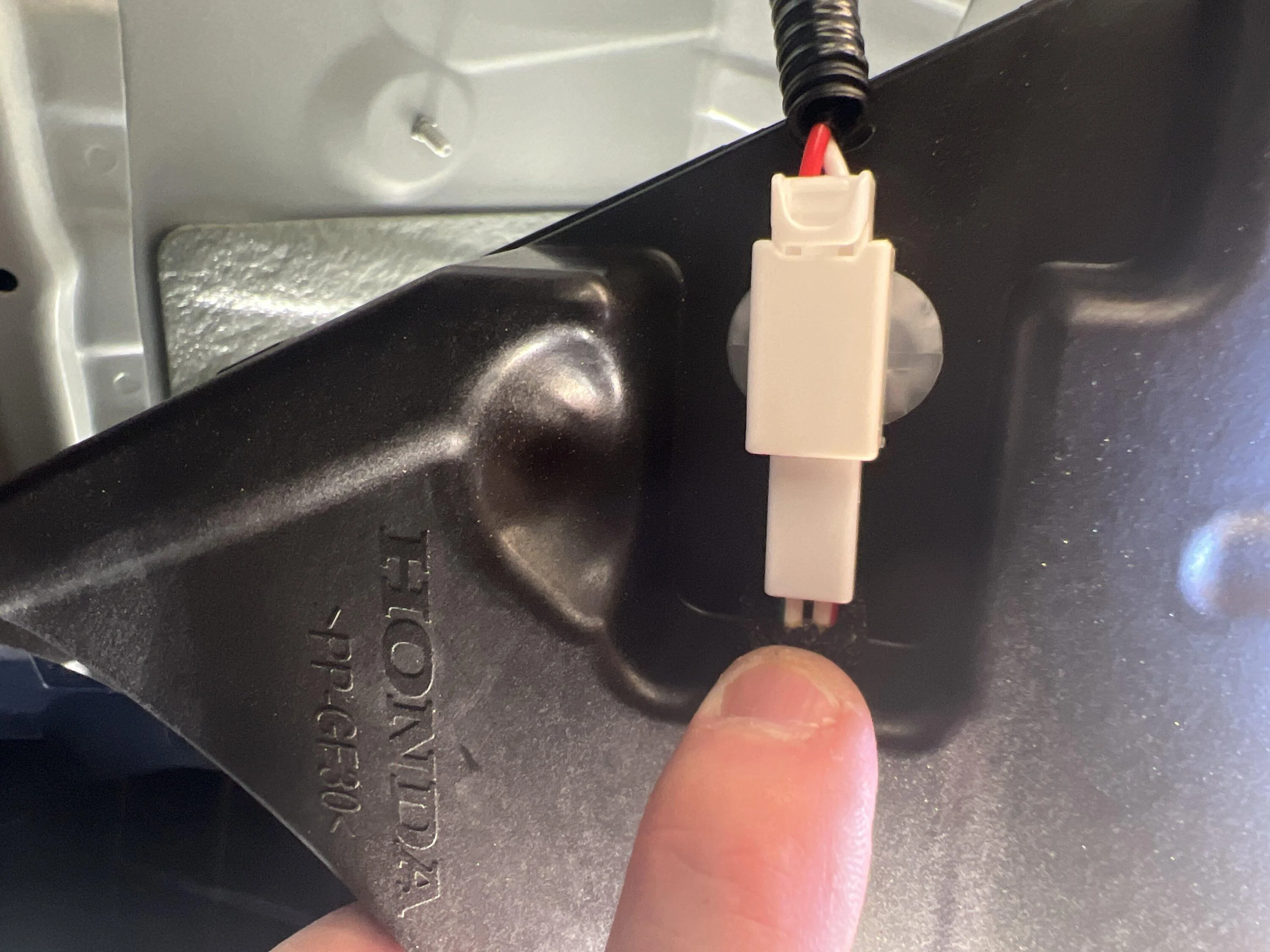

@Icehawk I’m sure the green wire is actually the positive. I’m gonna show you a picture if you trace the wire back on the actual enclosure itself to the plug that goes into the body harness, the bottom is red and then that correlates to the green and white wire on the speaker box. See photo.
11th Gen Honda Civic Icehawk's "OEM+" speaker upgrade image
Edit: I checked this with the multi-meter and this configuration had a positive value in mV. This according to the internet means it is correct and the sub will fire outward. As long as I don’t mess anything else up 😳

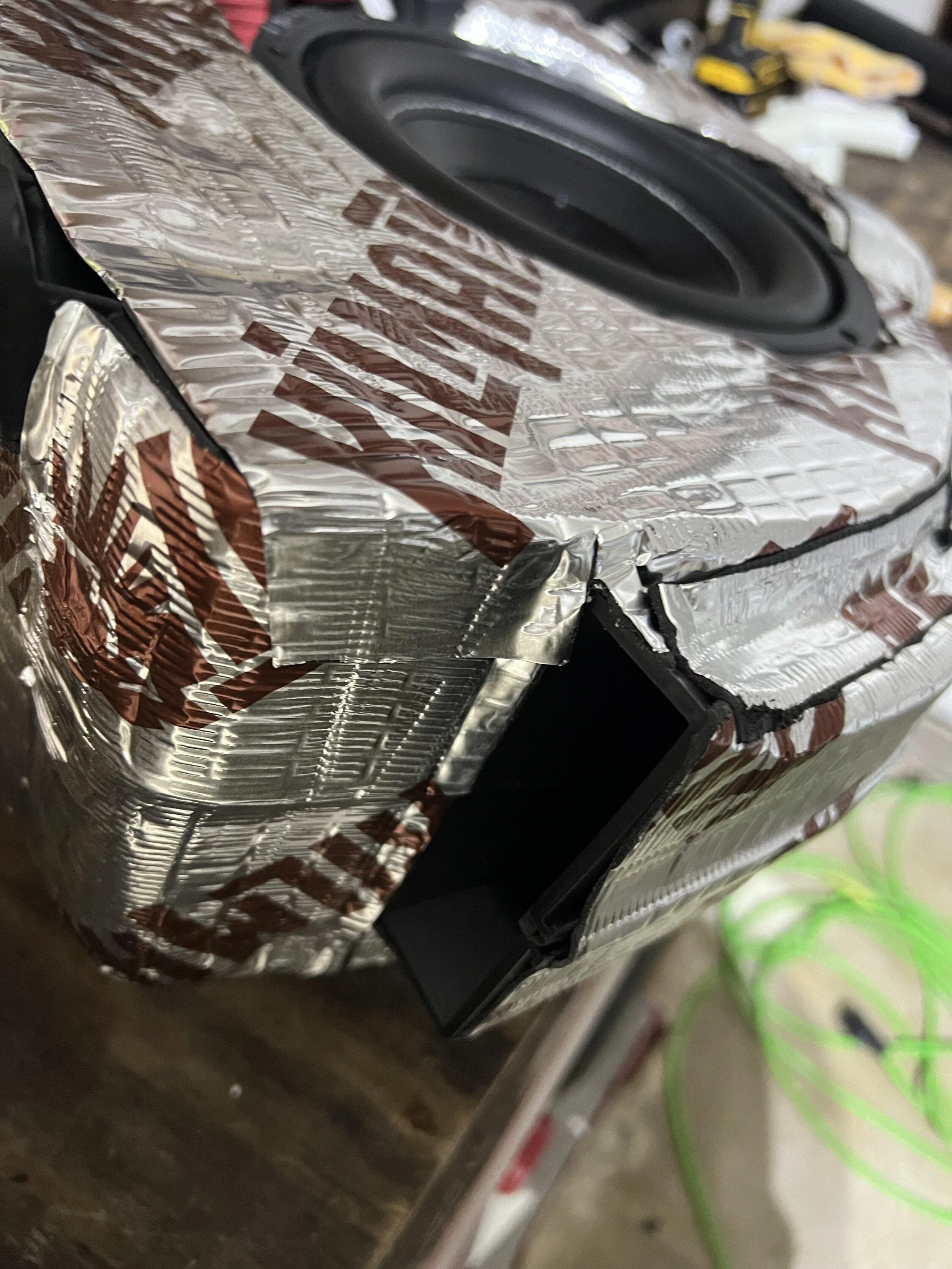

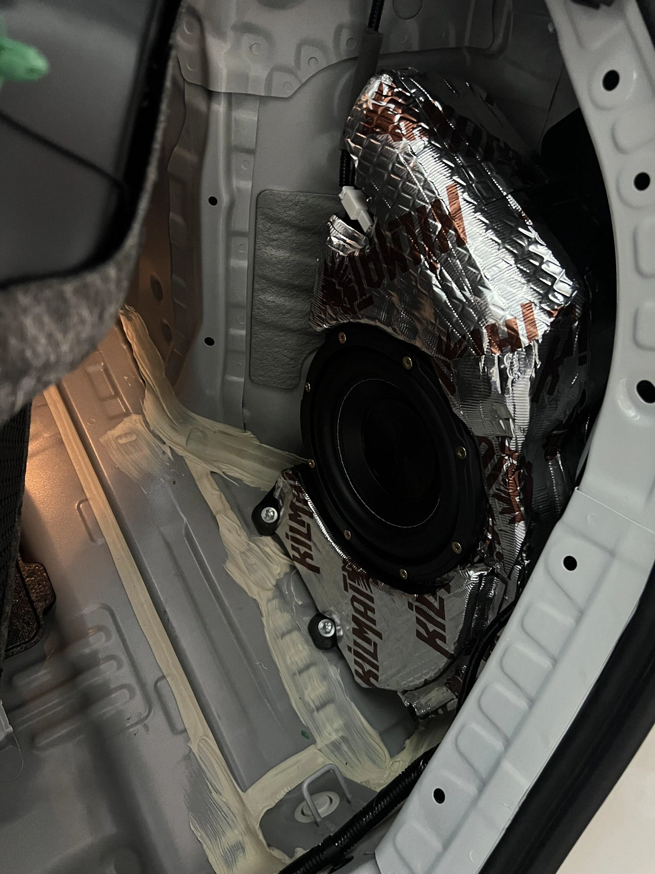

Ok update as speaker arrived.

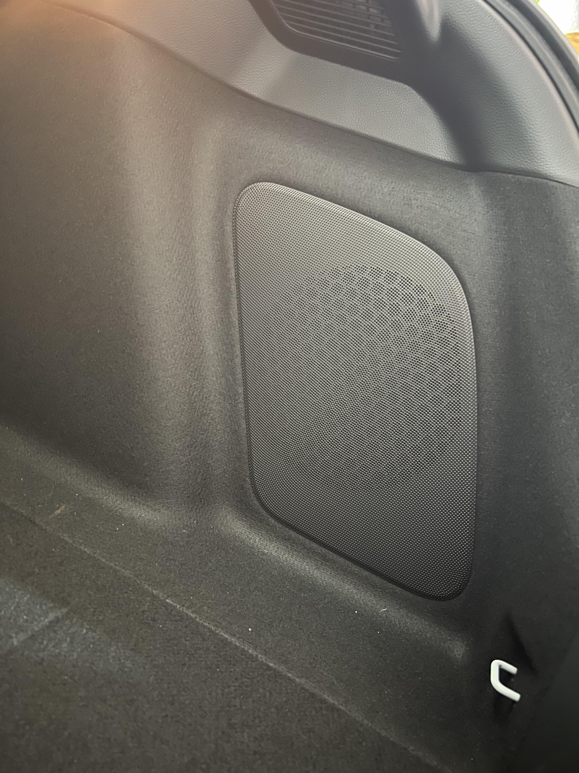

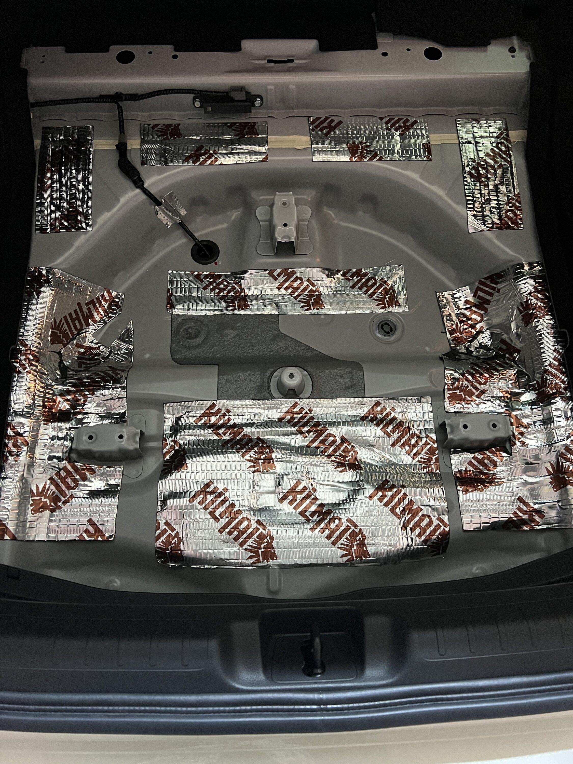

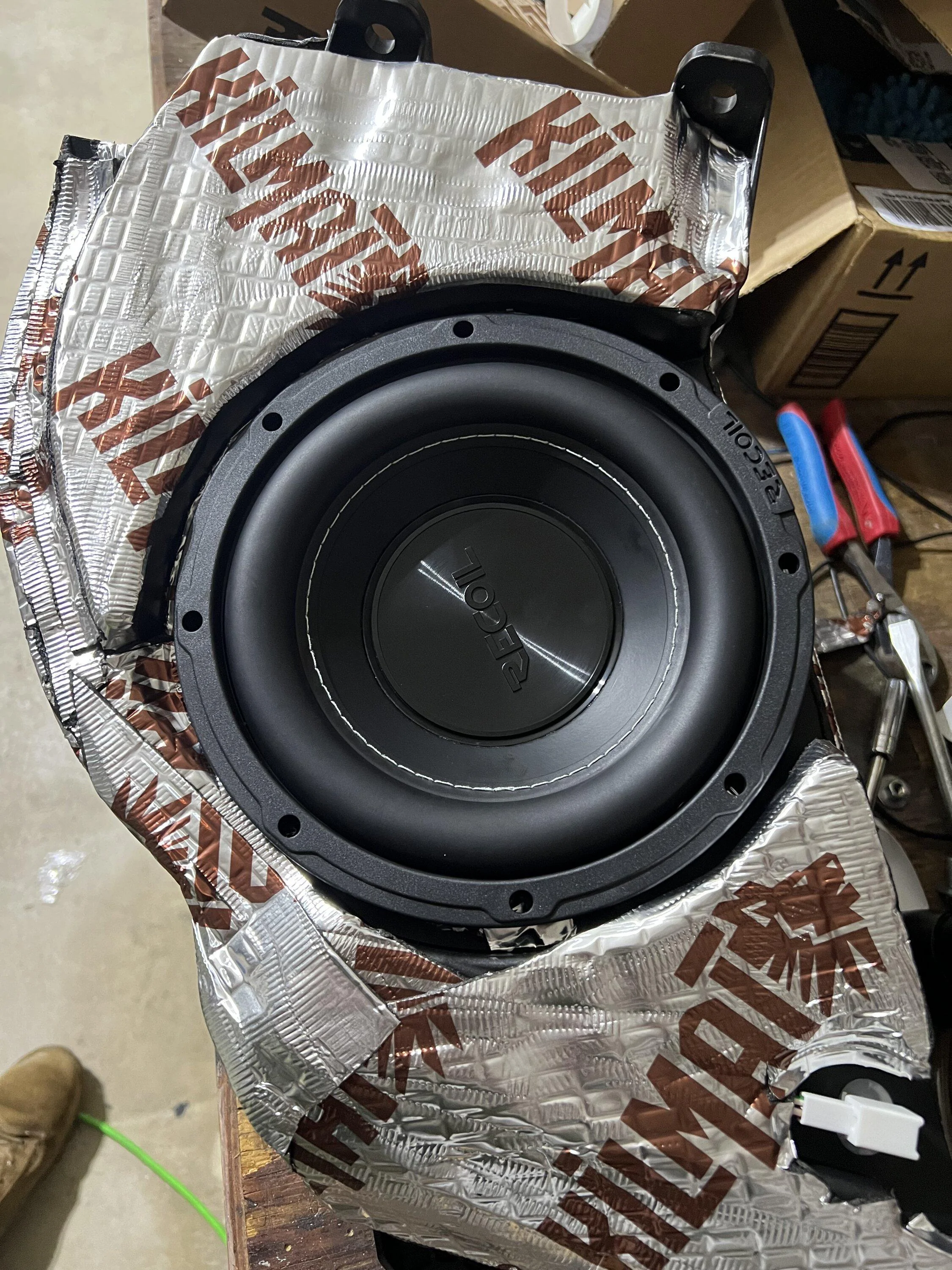

I wanted to make the box more solid so I used a layer of Killmat. Get it all wired up and had to make some new holes to drill in the screws for the sub. Added just a little killmat in the trunk areas as a precaution. I mean less than 5 sheets so not much weight. Here is how it turned out .
Ok, good because now that I see this pic I know I used the red wire as + and the white as - so I'm good there. I didn't reuse the original plug but spliced the wires.

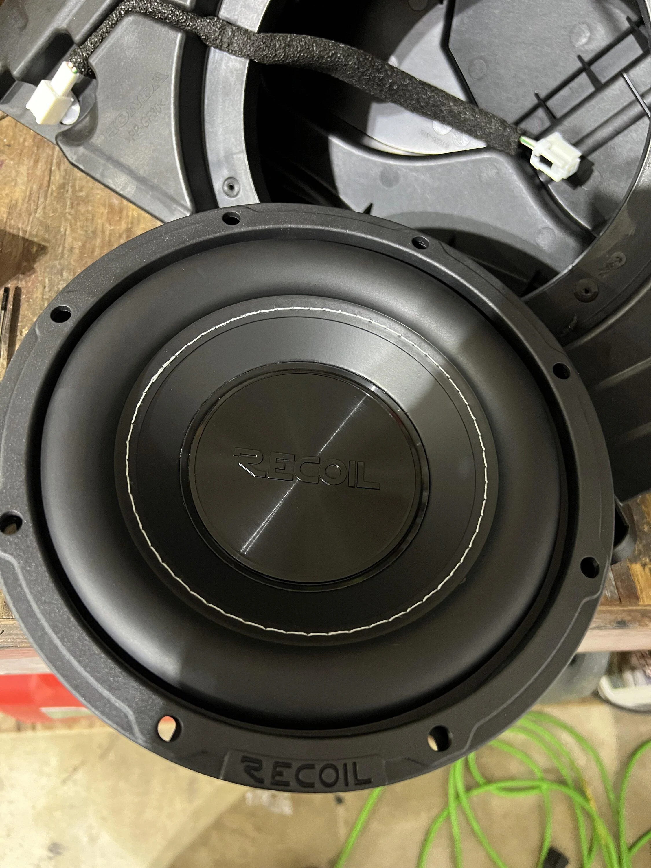

What's the sub name/model that you used?
RECOIL RW8D2 Echo Series 8 Inch 400 Watts Power Dual 2 Ohm Voice Coil, 2" Black-Coated 4 Layer High Temperature Voice Coil, Competition Grade Pressed Paper Cone, Car Audio Subwoofer
https://a.co/d/5sYKaqd

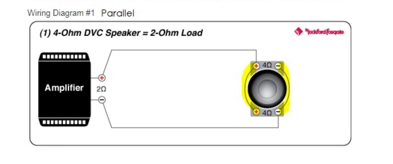

I used this to validate the wiring :
11th Gen Honda Civic Icehawk's "OEM+" speaker upgrade IMG_7234
And I used a 2 ohm DVC wired in parallel so I’m sitting at 1 ohm give or take.
