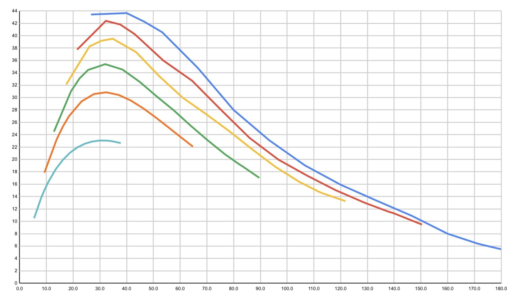

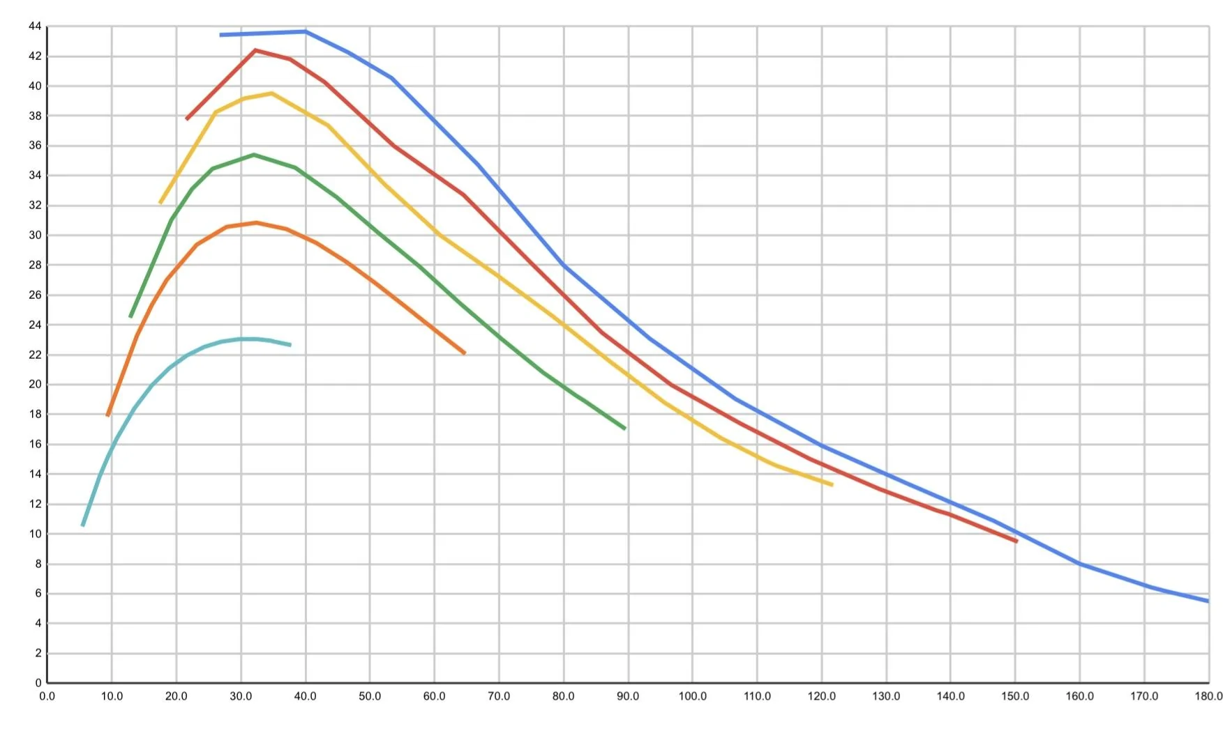

Not sure you are going to see 40+ on the Type R.
The Type R has a higher rolling resistance with its larger wheels. More aero drag with the extra downforce. The engine displacement is larger, increasing pumping losses and its also running a lower compression ratio.
I bought an SAE paper for the K20c1 a while back that had a BSFC plot and calculated the fuel econ for steady state driving in each gear. There are a couple places that you can get over 40, but wouldn’t expect in daily driving.

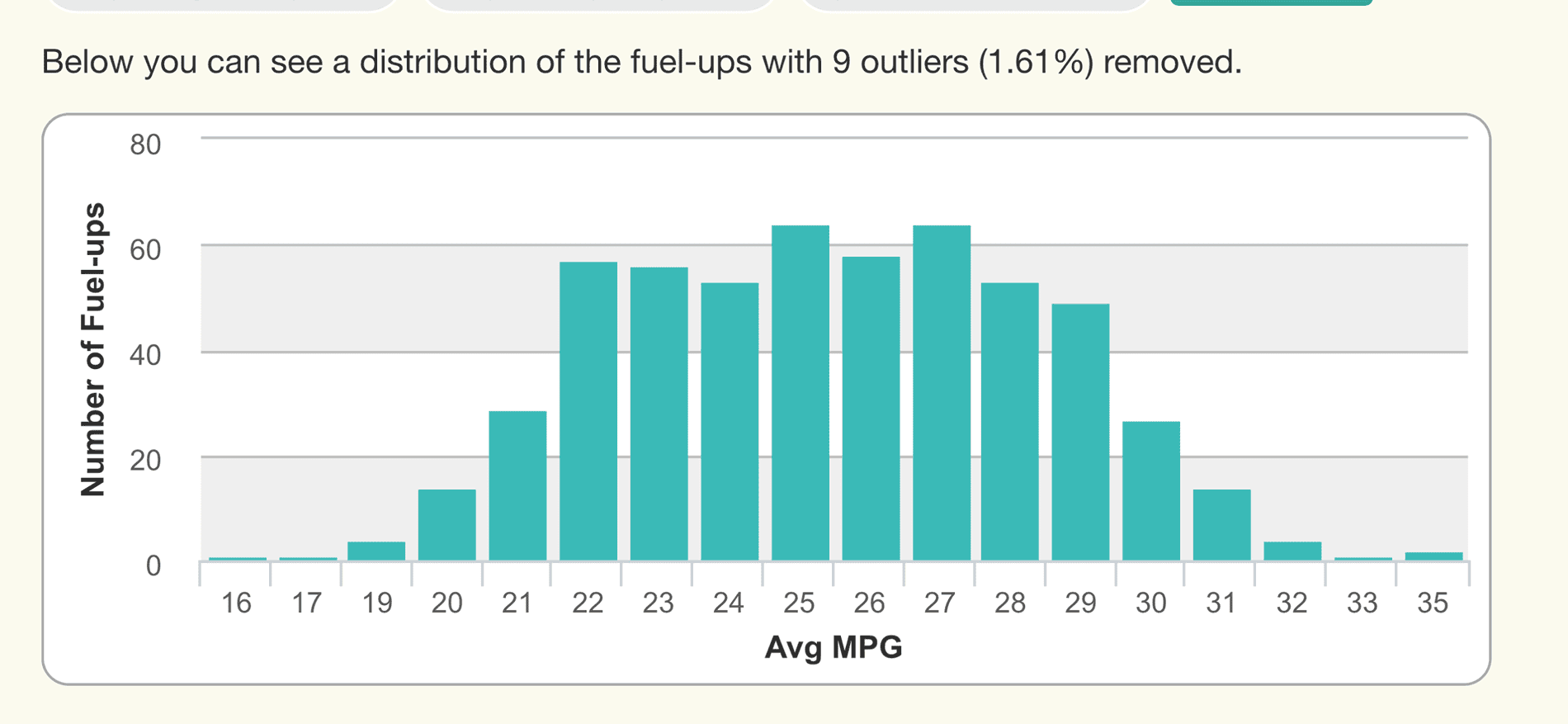

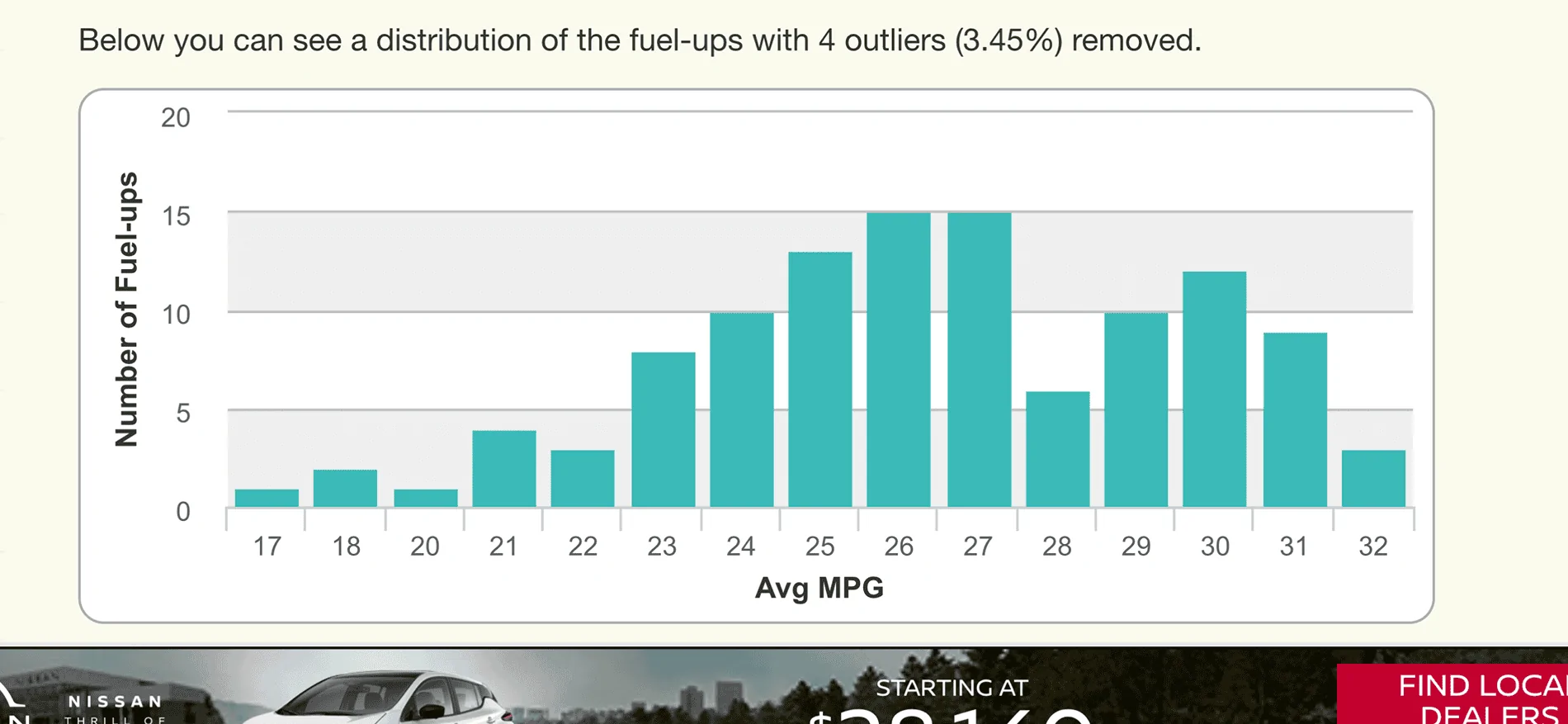

You can also look at histograms on fuelly.com. I’m attaching pics of the 23 and 24 Type R’s in this post.
Excel plot is mph vs US mpg
