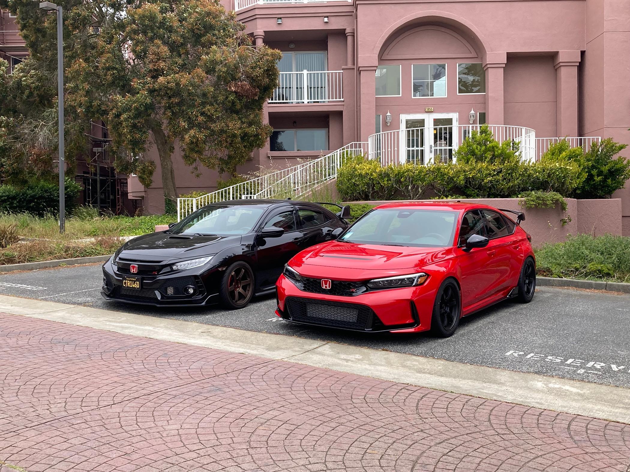

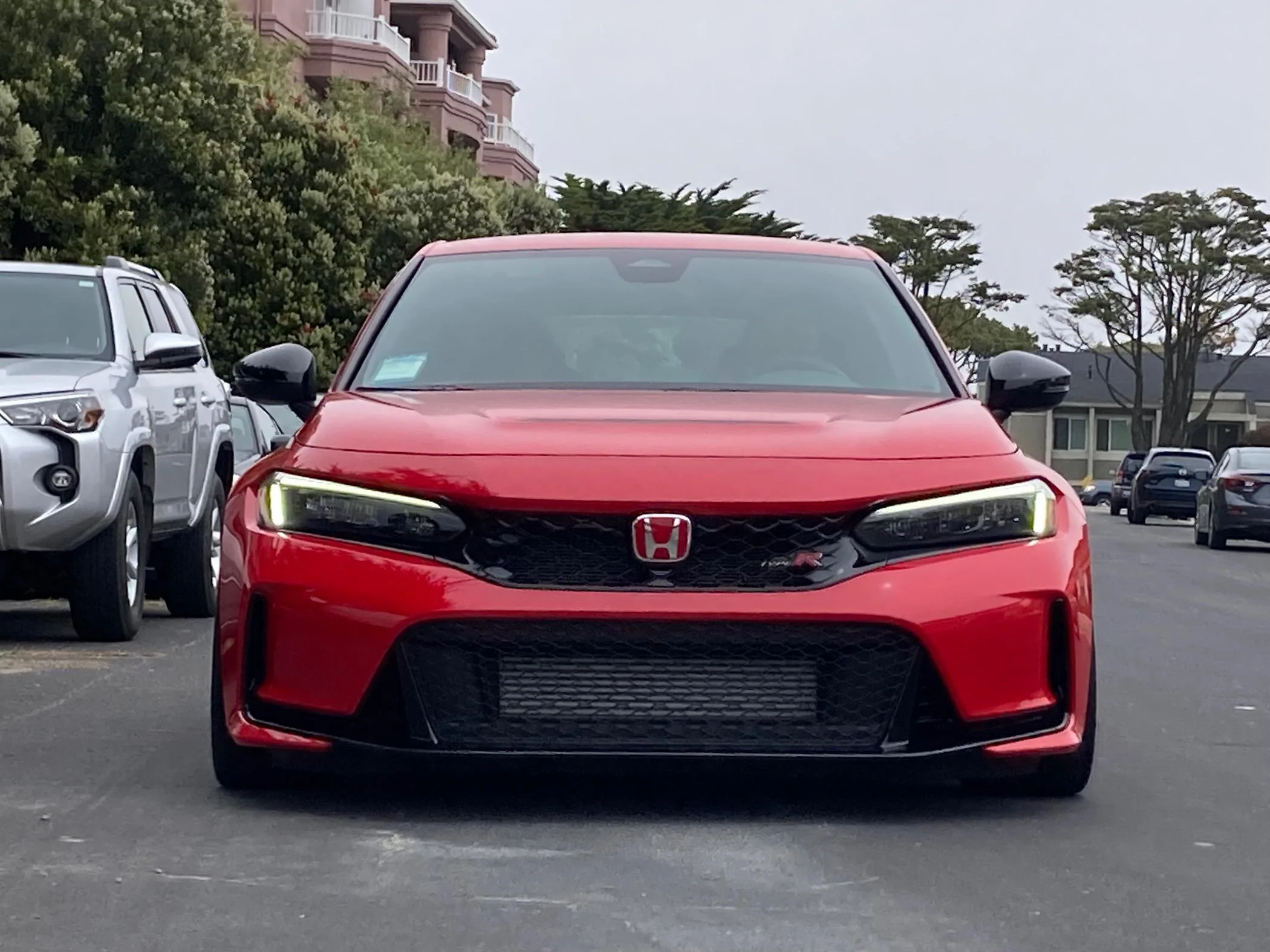

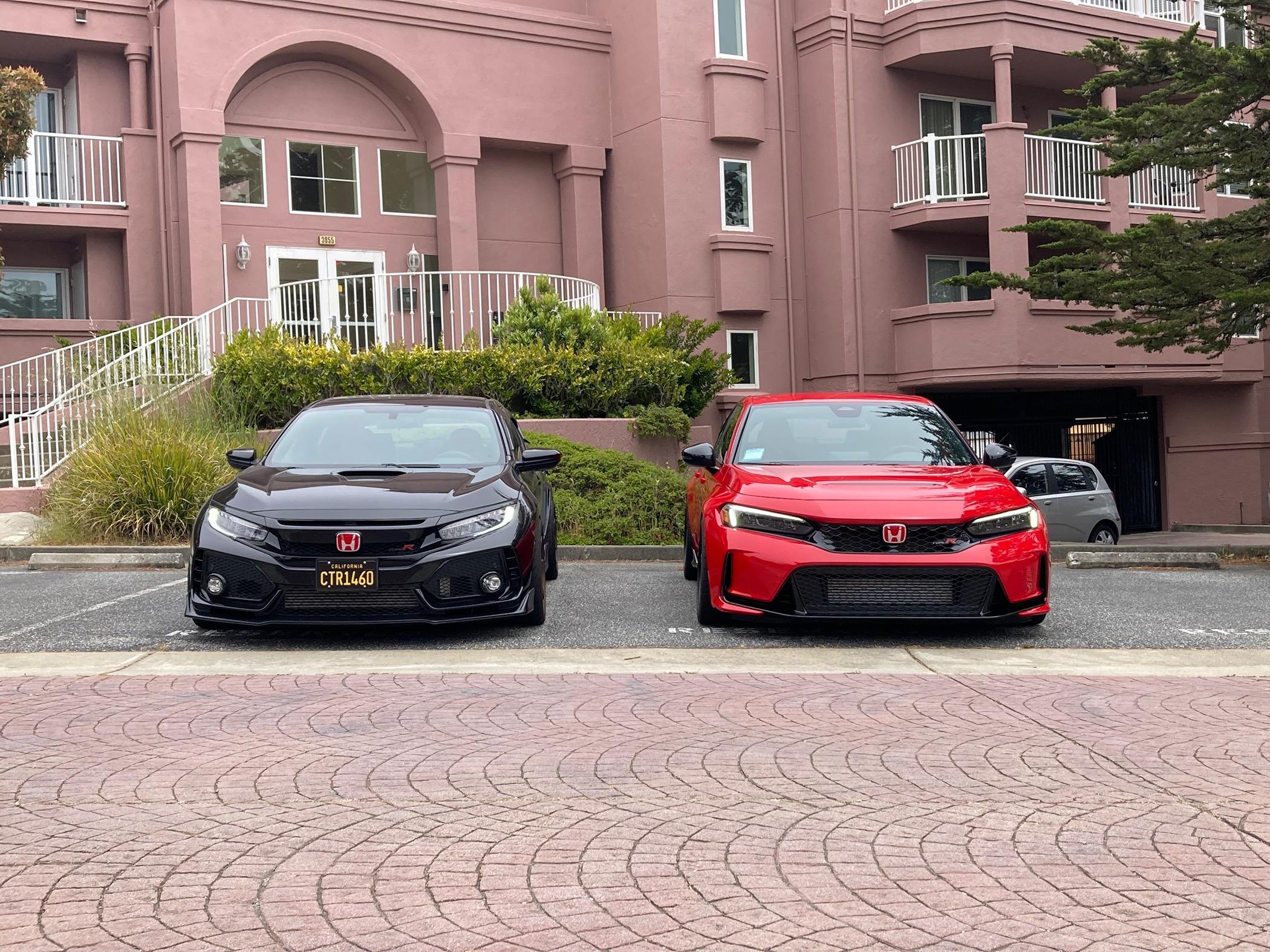

Thanks mate. I have the same ones about to fit. I have a RR too and really like your stance did you sort the noise out?
These springs definitely give the fl5 a fresh new look and driving experience.
I did sort out the noise I was initially hearing. I went back to torque each nut and bolt and found that one bolt completely backed out from the rear sway bar end link. Everything is good now.
