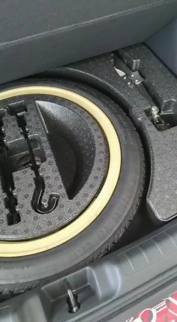

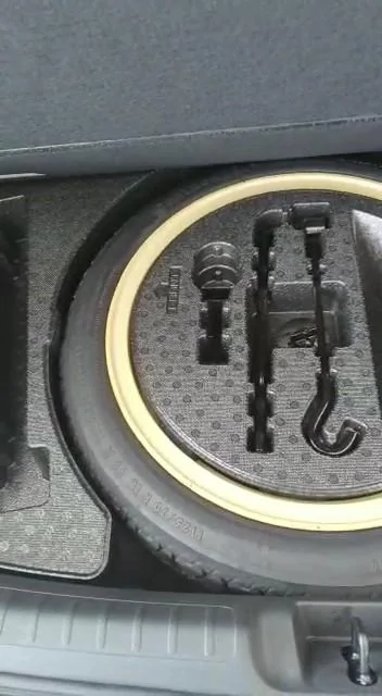

Last week I went to a honda dealer to see a FL5 on display. It hasn't been released in the country yet, so it's still using the red camouflage. These are pictures from the spare tire with a nice foam kit. It's better than the kit I have in my fk8.
So this is the kit that comes with all FL5s sold in Brazil:

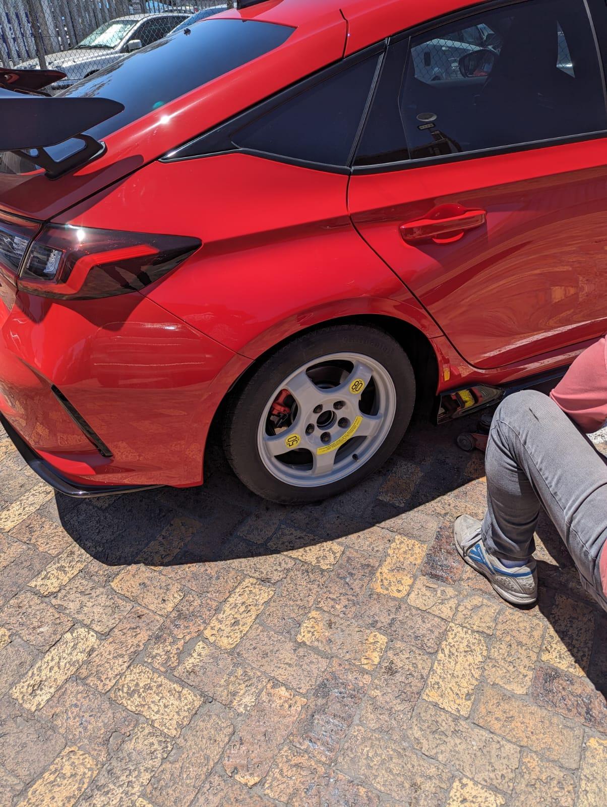

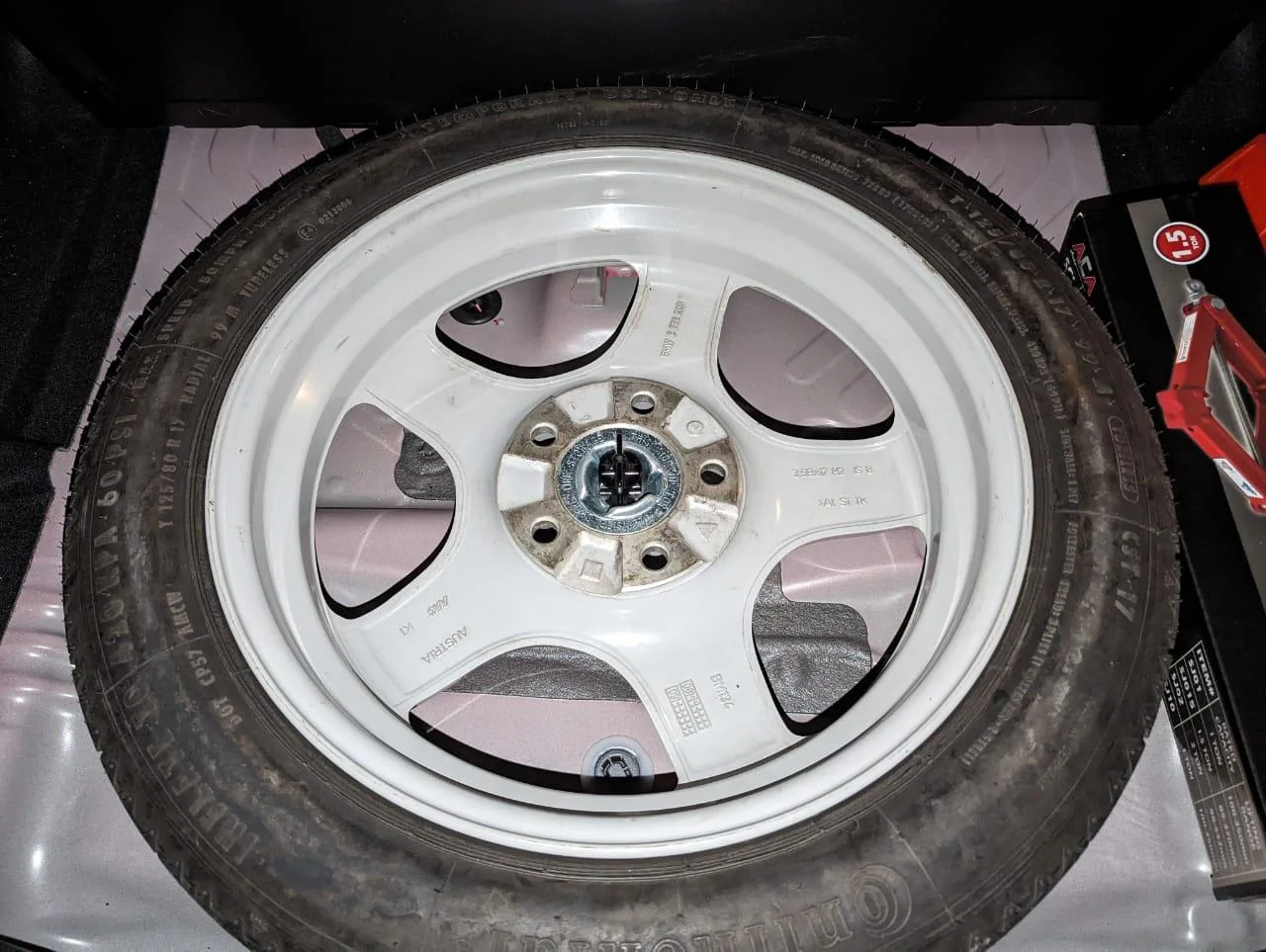

I am having a tough time sourcing a space saver spare wheel. The Honda dealership I purchased the car from refuses to give me the wheel and tyre dimensions unless I purchase the kit from them which will have to be imported from Japan which in South Africa will cost approximately $1400 and will take 8-12 weeks to arrive. I am also unable to easily source an 18/19" space saver wheel outside of the dealership as well.
I managed to find a used 17" BMW space saver wheel with the correct 5x120 pattern. It does not clear the front calipers and can only be fitted on the rear which I believe is the best place to place it given the posts above taking into account the LSD, etc.
The wheel that I'm looking to buy to use as a spare which will be stored in the boot/trunk is using a 125/70 R17 tyre. My question if anyone can assist please, the wheel does clear the rear calipers and seems to roll unobstructed, is this all I should be factoring in? Are there any concerns with using this size as a spare wheel? It will only be used in case of emergencies.
NB: The tyre itself does need to be replaced as it is more than 8 years old.
If the wheel size is good, should I look at a 125/80/17 tyre instead of the 125/70/17 tyre?

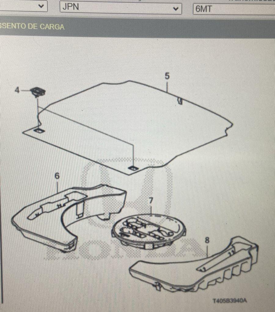

So I asked the local parts guy and he said there was not a kit. Since all parts come with the car, you can only purchase a replacement for each of them individually. It's crazy expensive, unfortunately.
11th Gen Honda Civic FL5 Spare Tire ? IMG-20240105-WA0026~2
5 - 84521T50E01ZA
6 - 84527T60K50
7 - 84545T60K50
8 - 84572T60K50

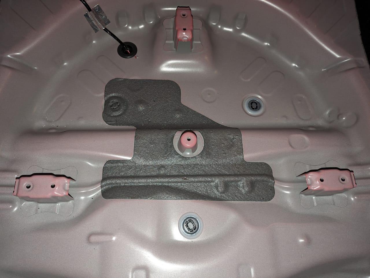

Does the FL5 has something in the bottom of the trunk to secure the spare (even if the car does not come with a spare)?
Shrapnel
Justin
Dec 8, 2023
136
137
Los Angeles
CW 2024 Civic Type R #16838
I believe there is a threaded bracket at the bottom of the spare tire well on all FL5's regardless of delivery region.

Can somebody with a FL5 confirm? Ideally from Canada...
FerrisBueller
Dec 18, 2023
South Africa
Honda Civic Type R (FL5), 2006 Honda Civic 8th EXi
Not from Canada but here is the wheel well that we get in the South African FL5.
I'm using a tyre holder screw from the 8th Gen Civic which works fine.
The wheel well is only roughly 70-80mm deep before the boot/trunk floor.
