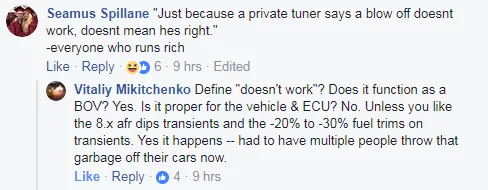

from a pro,
11th Gen Honda Civic Blow Off Valve - Boomba Racing upload_2017-8-31_8-54-42
ryanfk7
Jul 23, 2017
PA
Honda Civic ‘17 Hatch EX
from a pro,
I said I was done but, dude seriously? Why do you keep coming back to this? Why won’t you just drop it. Let the people do what they want and go find another thread to troll. If they want it, let them have fun instead of ruining their days. I’m convinced people like you are the reason Boomba is staying away from this site as much anymore.
SkyeHack
Jan 12, 2017
211
Japan
2018 Honda Civic Si Sedan
Boomba is not replying because they have no ground to stand on. They made a half assed video showing their BOV on their dyno under partial acceleration. Everyone knows damn well that a lot of civic owner's (especially those that tune their cars) will go WOT on the street. They decided not to test WOT (I wonder why *sarcasm*). When we pointed that out, they decided to disable the comments on all their videos showcasing this BOV and no longer partaking in discussion of the topic.
Boomba's Quote:
There's been a lot discussion since we have released our BOV if the piece makes your car run rich or not. In this video we decide to show everyone what happens. The results are in, and this piece is perfectly safe to run! We performed simulated street driving under partial acceleration runs and shifting to see what happens when you let off the gas and shift when running our Vent To Atmosphere BOV.
They are advertising that it is safe to run when it is NOT. That is the problem a lot of people are having. It's not about ruining their days, it's about informing people of the truth so they don't make mistakes.
