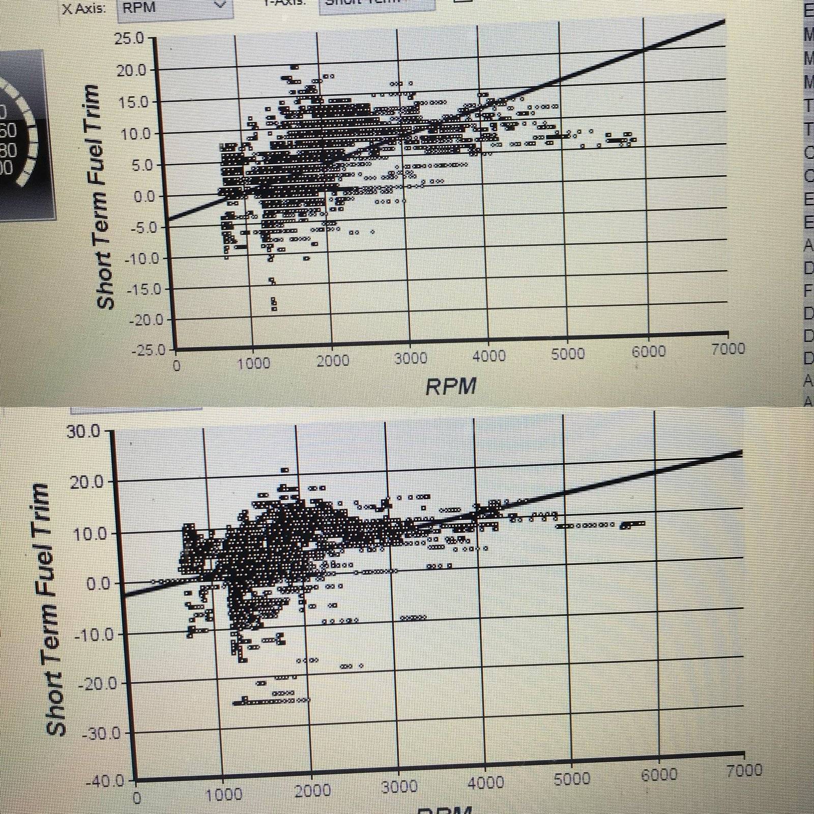

Just did some testing with this bov. Here are the results. On a CVT with a ktuner 21 psi stage 1 tune and short ram intake and 93 octane fuel. Top picture is without and bottom picture is with bov. As shown, it does make it run rich when letting off the throttle, or in MT between shifts. Your car will not throw a code unless the STFT goes below -30. Without the bov it was maxing out at -19 and with it was maxing out at -25. Every time I’d let off the throttle and the bov was releasing air, it would drop to -25. Did not affect gas mileage. Both ended up around 30 mpg for each trip. So it did not affect that. Unless you floor it every single time you drive, as I was doing during this test, this bov will do no harm. Everyone’s been talking without actually having the proof, so here it is. For those who like the sound of a bov, it’s useable but like I said try not to floor it every time you drive :spaz:
had the same proof that was uploaded a while ago, I'd say that with a M/T after 100,000 shifts where a/f dips for .1 seconds could cause a problem

@Acraig3 i may have found your post after I posted this :eek: but yeah the only real issue I’d see possibly happening is the whole carbon build up and even possibly washing the oil off the cylinder walls. BUT many other turbo’d cars from the manufacturer run more rich than these civic x’s Example: STI’s run about a 10 AFR stock during max torque. While with a stage 1 tune on ktune it runs about an 11. So many other cars come stock tuned more rich. Who knows, I’ll be running this for a little while and seeing what happens lol

@SkyeHack I’m just here to learn about stuff I don’t know too much about and when I run across people arguing about something I like to do the testing myself :thumbsup:

Blowoff valves are used to prevent compressor surge. Compressor surge is a phenomenon that occurs when lifting off the throttle of a turbocharged car (with a non-existent or faulty bypass valve). When the throttle plate on a turbocharged engine closes, high pressure in the intake system has nowhere to go. It is forced to travel back to the turbocharger in the form of a pressure wave. This results in the wheel rapidly decreasing speed and stalling. The driver will notice a fluttering air sound. On a car equipped with a mass airflow sensor located prior to the blowoff valve, venting to atmosphere confuses the engine control unit (ECU) of the car. The ECU is told it has a specific amount of air in the intake system, and injects fuel accordingly. The amount of air released by the blowoff valve is not taken into consideration and the engine runs rich for a period of time. Typically this isn't a major issue, but sometimes it can lead to hesitation or stalling of the engine when the throttle is closed. This situation worsens with higher boost pressures. Eventually this can foul spark plugs and destroy the catalytic converter (when running rich, not all the fuel is properly burned in the cylinder which can allow unburned fuel to combust upon contact with and melt the converter or to cause incompletely combusted fuel to leave heavy carbon deposits).
