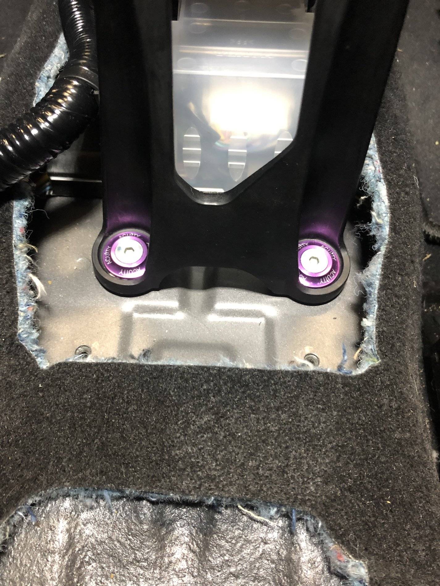

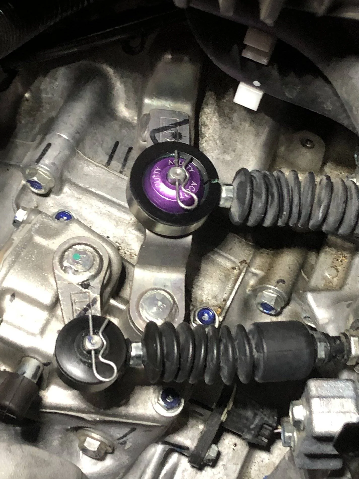

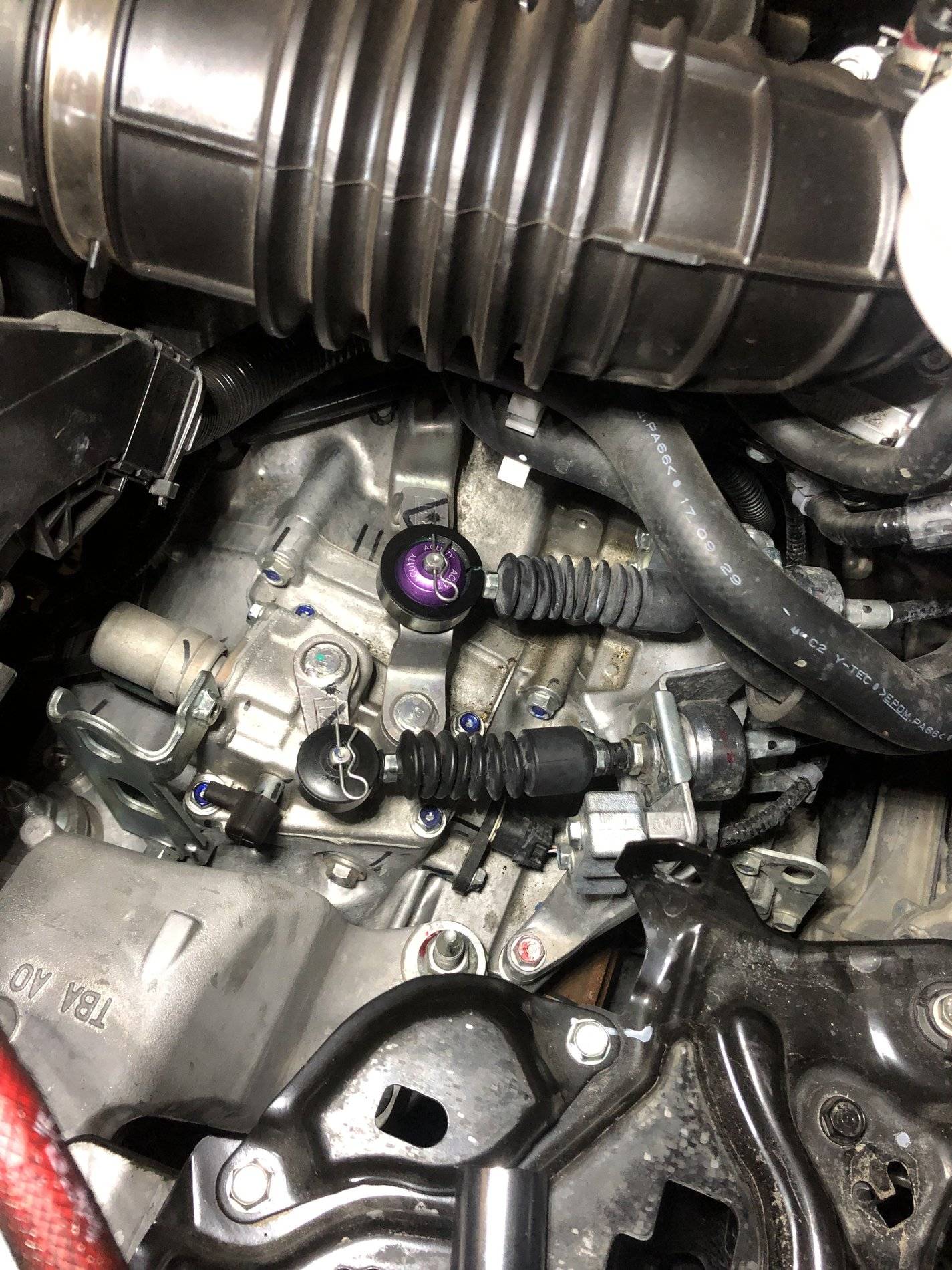

Well I installed the base bushings and the shift linkage bushings. But I was not able to install the shift knob because I need a boot collar. I just ordered the stainless boot collar. So I’ll have to wait till it comes in to install the shift knob. But the install on my 2.0 was pretty much the same as the 1.5t. I do have a couple pictures and can answer any questions if anybody has any. One piece of advice is there really is no need to remove the the two c clips that are holding the shift cables. You see them being pulled off in the video on the acuity website, but isn’t necessary. That just makes the install harder. I left them on and had no problems.
11th Gen Honda Civic ACUITY Prototype 10th-gen Shifter - My review E69C0EA8-5776-4830-8BD3-F48F8B5CB390

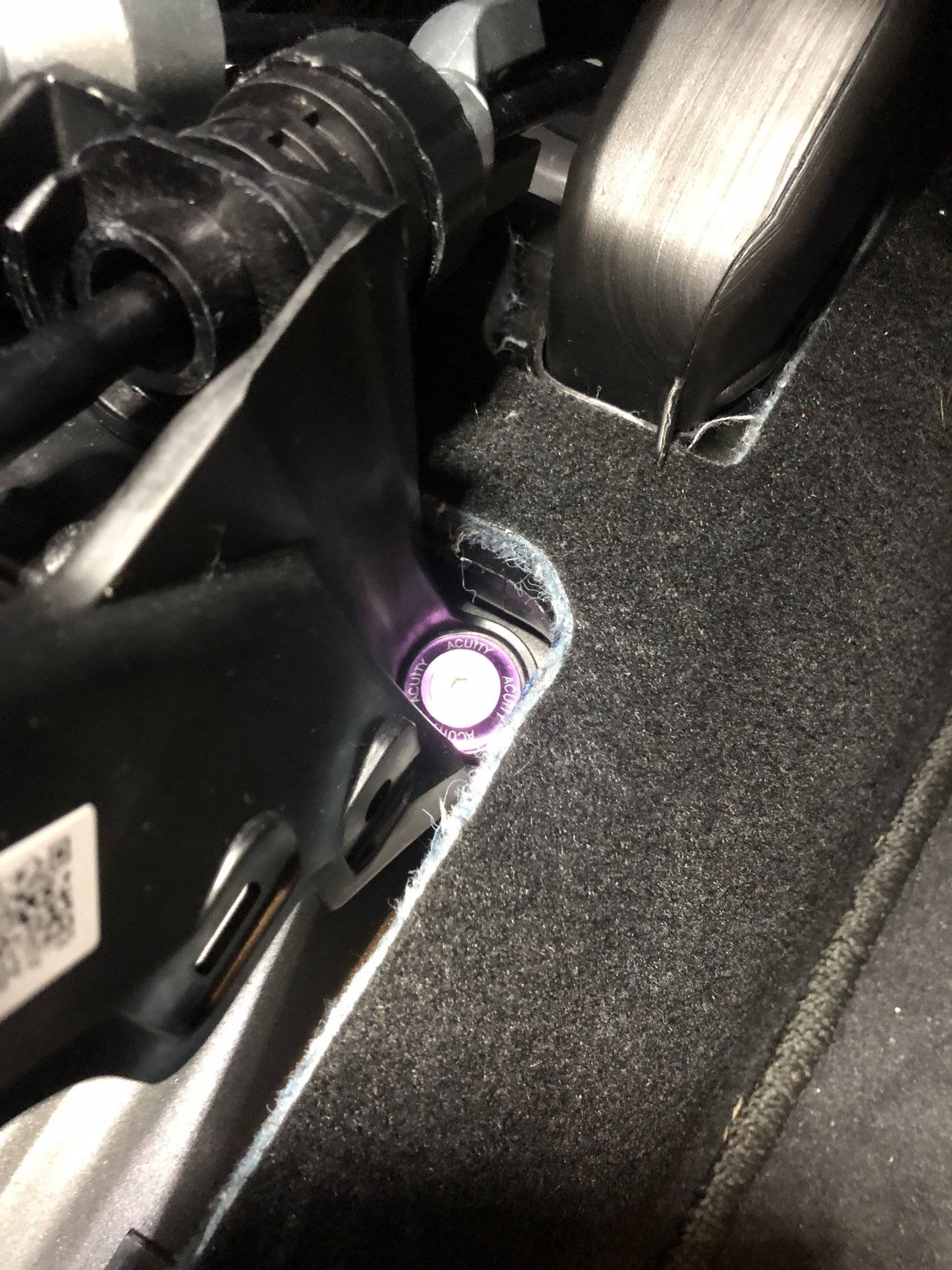

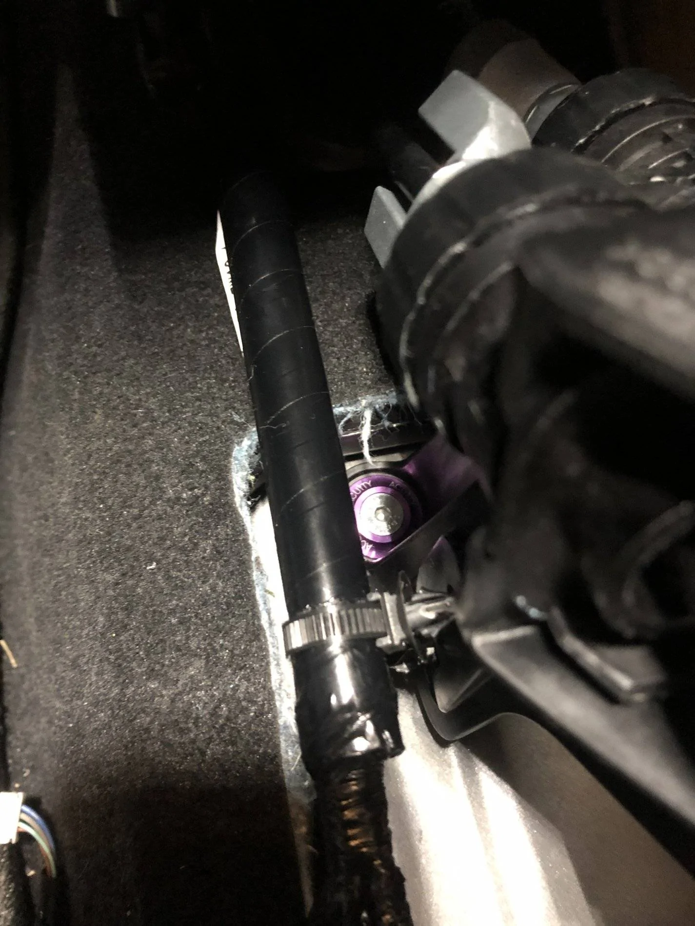

Here are a couple more pictures of the install
11th Gen Honda Civic ACUITY Prototype 10th-gen Shifter - My review 21C2769A-E28A-4C3B-90D6-E51F78B756EF
11th Gen Honda Civic ACUITY Prototype 10th-gen Shifter - My review 1B8B2E95-CF97-4F30-AB78-258CB46BC734
11th Gen Honda Civic ACUITY Prototype 10th-gen Shifter - My review D17E6C31-D3D5-4107-A627-913071AB9260
11th Gen Honda Civic ACUITY Prototype 10th-gen Shifter - My review 9ECFC682-2E57-4A54-BEBC-00711520DB89
