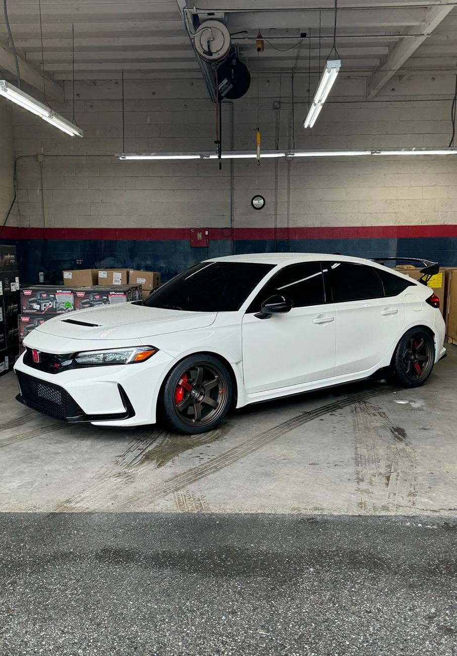

275 is 100% the way to go. You won't rub at that offset even if you are lowered.
18x10 40 is about the equivalent in poke to an 18x9.5 35 correct? I’d think a 275 could be a gamble unless it ran very narrow
BigBird
May 29, 2023
1,018
754
yeah like running a 25mm spacer. this is less than than the 18x11 +44 that some run for track but with camber, so i'm sure it's fine with either size.

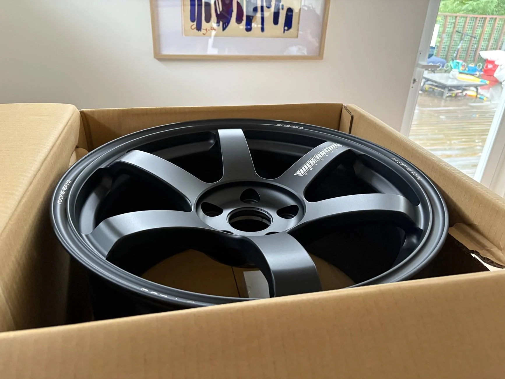

Thanks. I’ve gone for the V601 as well in 275/35/18. My matte black saga s plus wheels just arrived in country (18x9.5 +40) so only days to wait now.
Thanks for all the help. Based on the collective experience here and what I’ve read I’m hoping there will be no rubbing or poke.

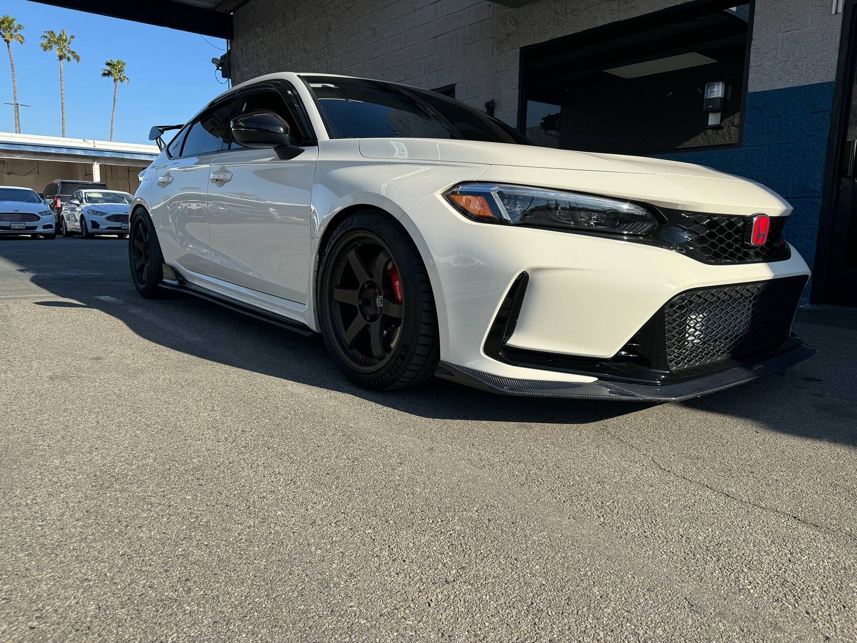

Just sharing photos of the final fitment. Thanks to all for the advice.
Tiny bit of poke at the front from the beefy sidewall of the 601s. A slightly narrower 275 would probably be perfect. Doesn’t seem to bad to me but let me know if I should be worried as it’s my first step into aftermarket wheels.
