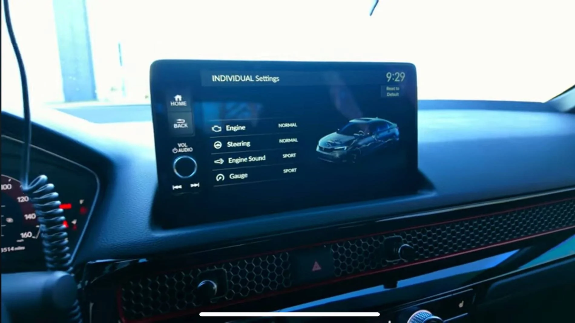

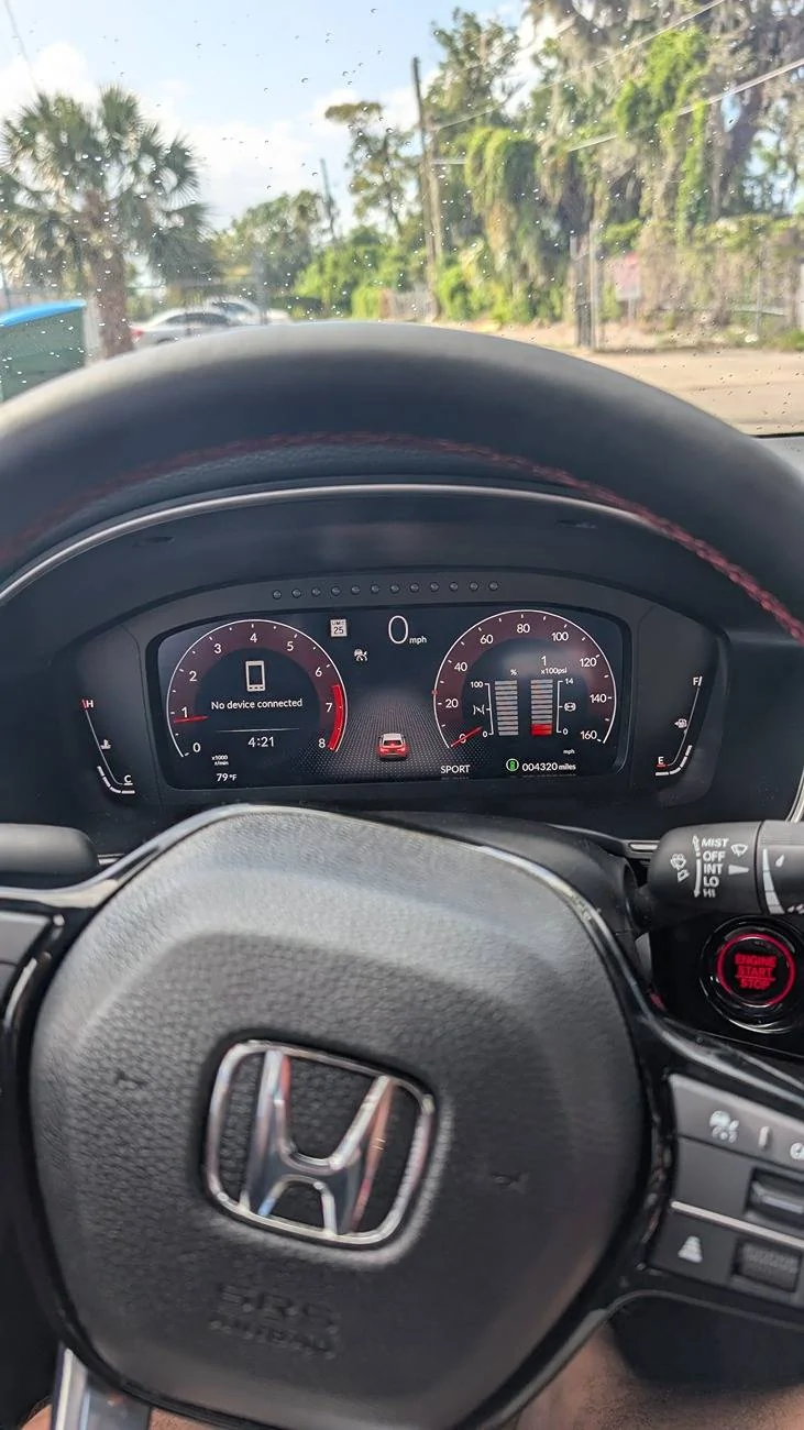

11th Gen Honda Civic 2025 Si full digital cluster works in 22-24 and here's what you need to get it done! IMG_3240
does replacing the cluster give you the new INDIVIDUAL Settings customization?
i reached out to my local dealership about supporting the cluster swap and they said they wouldn’t, but if it gets this customization i’ll definitely try to make it happen at a diff dealership. thanks in advance!

Yes it does, I have my cluster on sport so I get the red and normal for everything else.
