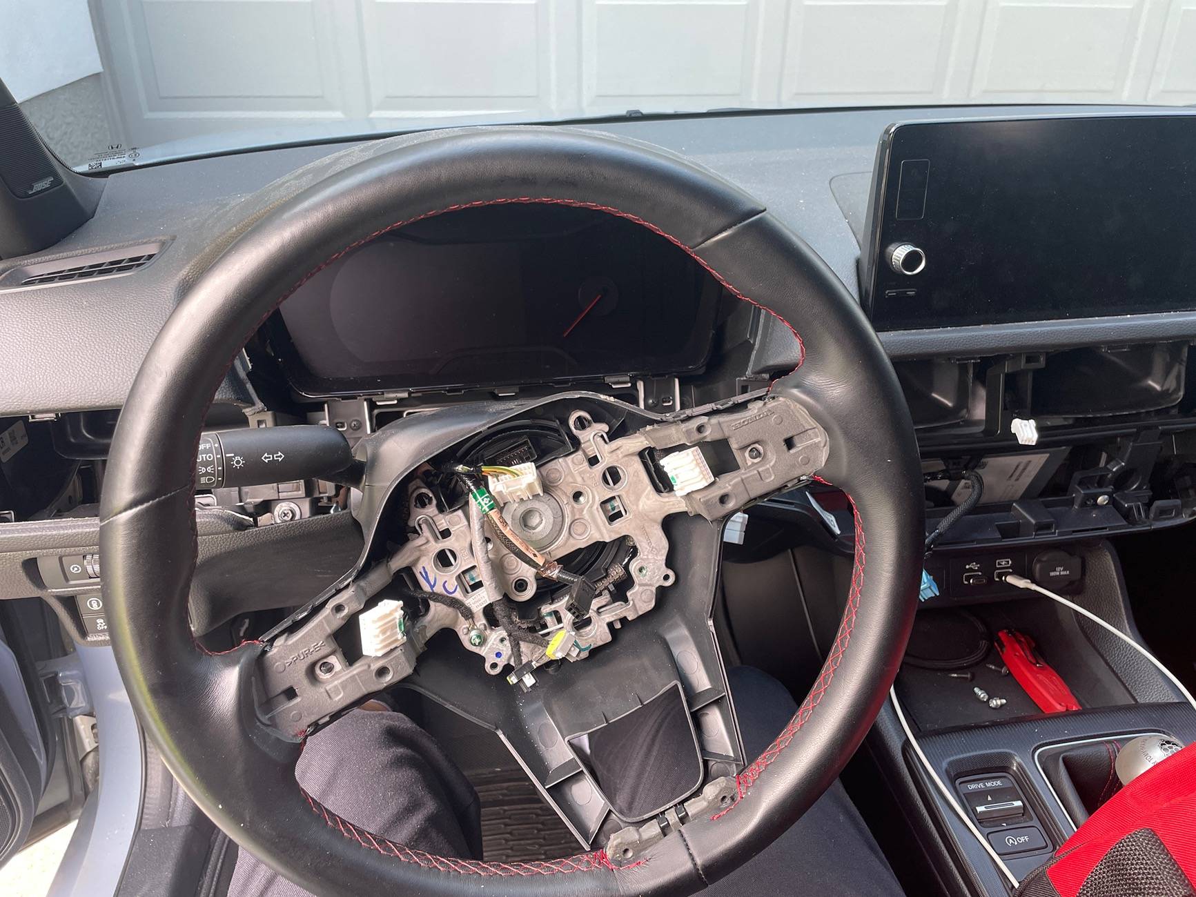

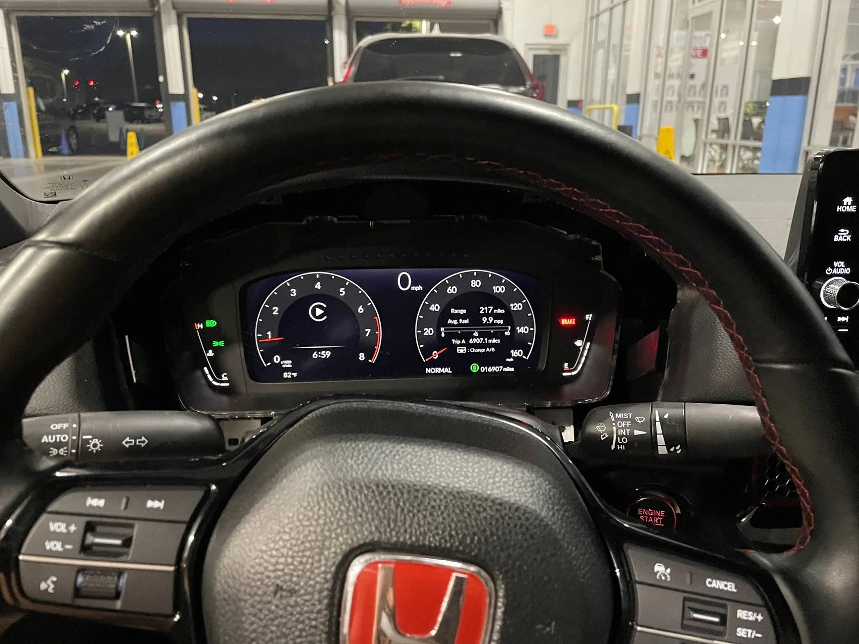

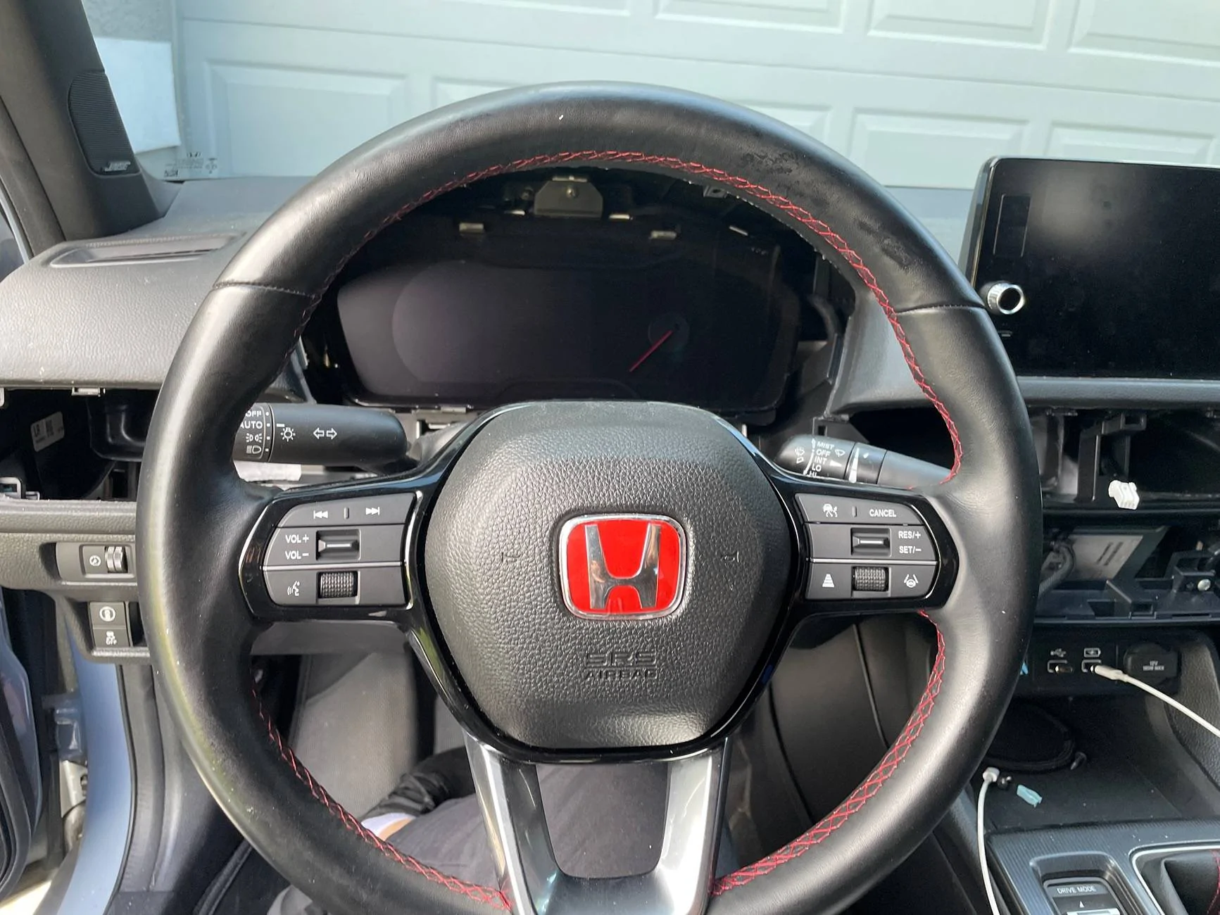

I plan on getting the steering wheel out to swap buttons get dash apart go to dealer have them reprogram and re assemble dash in the lot
Johaw
Mar 31, 2023
55
2023 Civic si
New buttons and harness installed hopefully i can find time for the dealer this week at some point and finish this up
