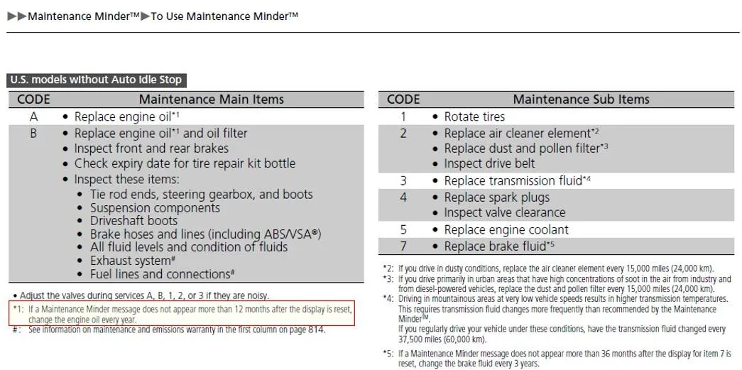

Watching the threads on this forum and others, in most normal-use cases I'm sure you can find reason in oil analyses that early first change is beneficial, but it doesn't seem to actually make a difference in day to day or long term.
Somewhere there is recommendation for "break-in" period for some 500 miles or so of easy driving and still with no OC required, but also this is Honda and they don't tend to design things that require specific user behavior other than don't abuse it. On one hand it doesn't hurt (especially if you are modding/tuning early), on the other hand if you're not flogging it cold or driving a lot it is just more oil to be paid for and recycled.
If you trust your dealer, you can take advantage of the 24 months of OCs.
Pekingduck
Albert
Jan 24, 2018
183
133
Southern California
Na
I would change it once a year especially if you do short drive. Motor oil is considered hygroscopic so unless you keep it in a dry environment it should be change yearly. You should also consider your gas to. I wouldn’t trust the gas after 6 months due to octane degradation unless you keep rpm low. Dot 4 same thing should be change every 1-2 years. I like the gf analogy…
