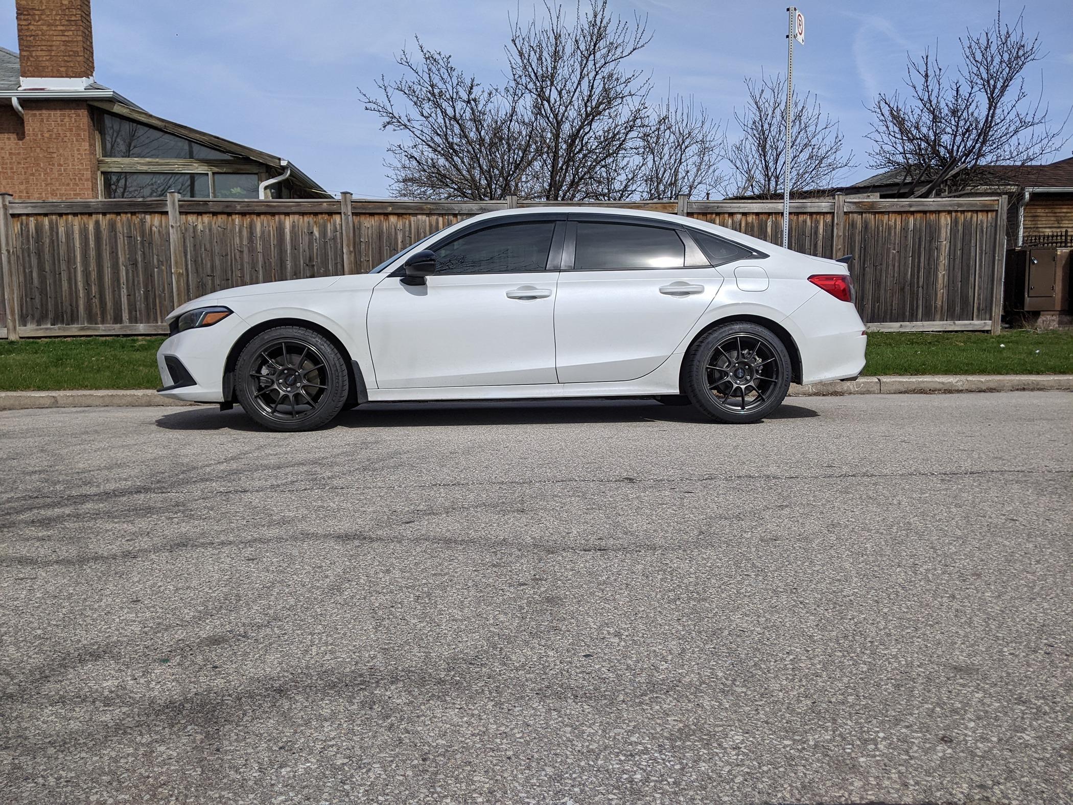

Do you have a picture?
absolude
Dec 18, 2017
197
GTA
KW SC 2007 CSX Type S, 2023 PWP Si
Thanks for the pic. Is the road slightly downhill?
Petty sure mine is higher in the front compared to rear.
I'll take a picture if I drive it to work tomorrow.

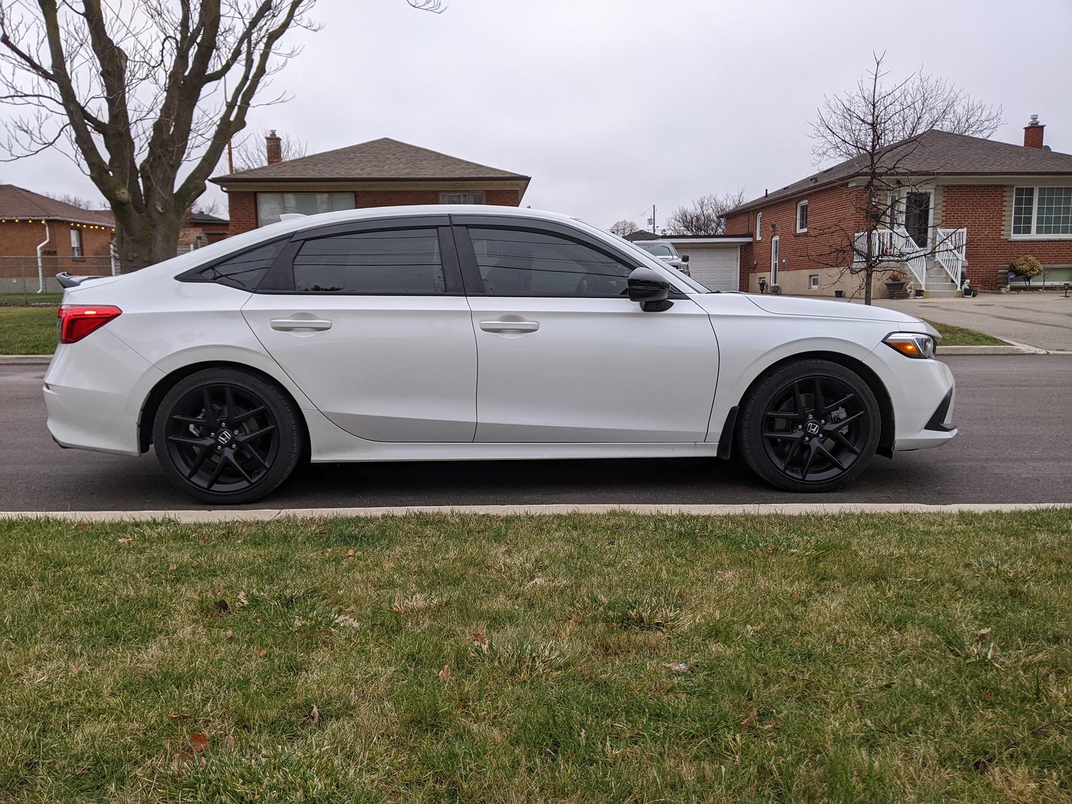

11th Gen Honda Civic 2023 Civic Si Spring Rates, Motion Ratio, Ride Frequencies, Autocross PXL_20240112_203407958
Forgot about this one I took not too long after install.
Maybe I should take another one in the same spot...
It’s up slightly. So slanted up from left to right.

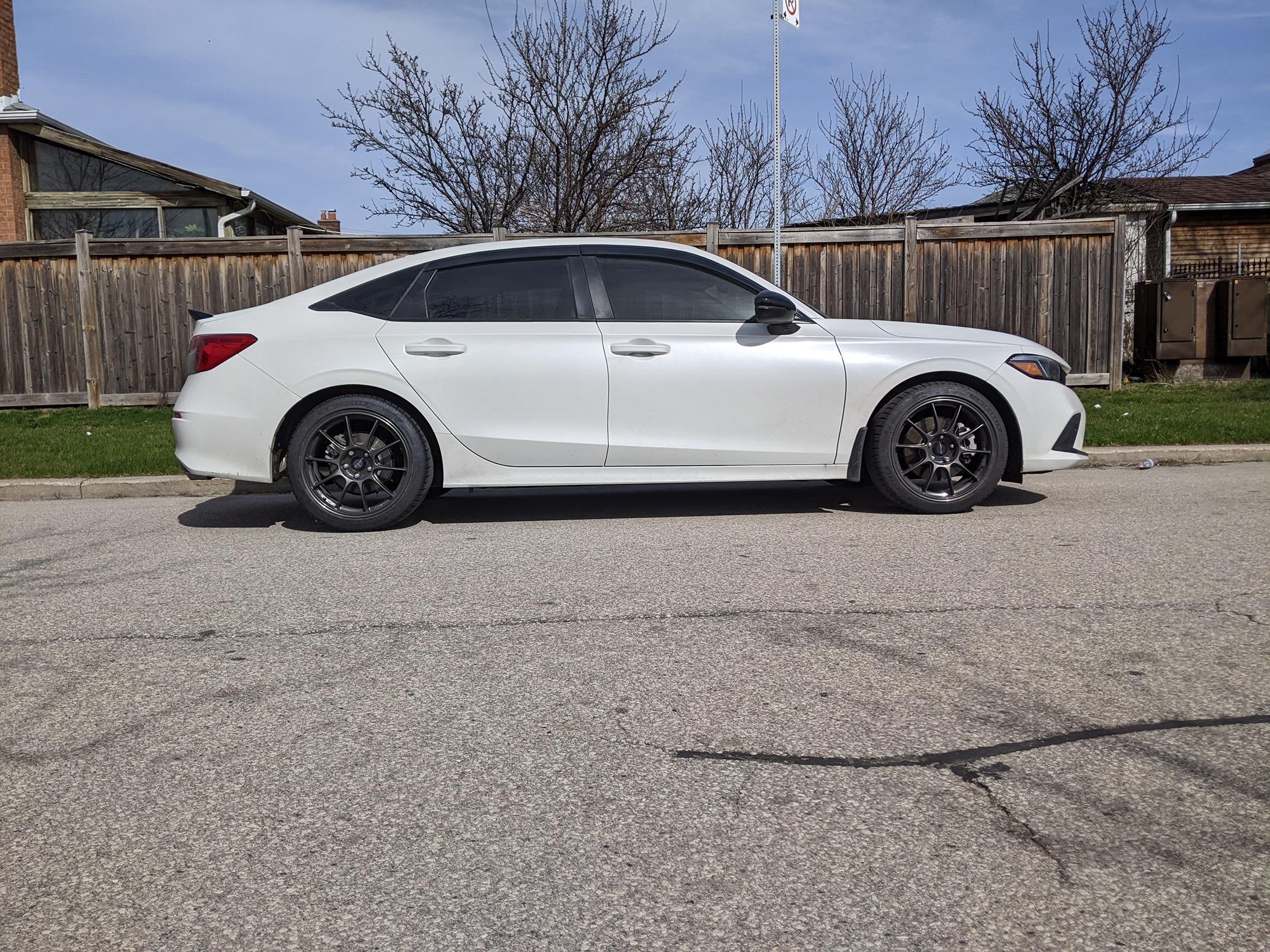

According to these pictures I took today it seems to have settled in the meantime...
11th Gen Honda Civic 2023 Civic Si Spring Rates, Motion Ratio, Ride Frequencies, Autocross PXL_20240410_195340419
11th Gen Honda Civic 2023 Civic Si Spring Rates, Motion Ratio, Ride Frequencies, Autocross PXL_20240410_195707388

Yeah that actually looks good. Can’t find any FK8 springs near me only FL5 unfortunately.
Got mine used on Marketplace. I'd love to try the ones I mentioned before. These are a bit bouncy on real rough roads.
