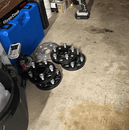

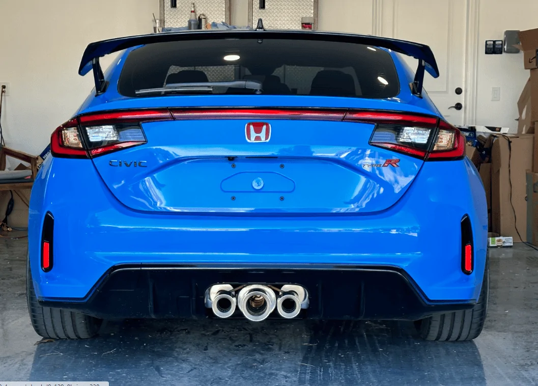

this is aggressive! I love it, but I like the looks of the factory forged wheels, so I'm thinking spacer, maybe? just so happen to save my set from my FK8....maybe just the back first? the back seems to be a bit more recessed in... :hmm:

What you guys think?
Give it a try! Should look nice
makes that hip looks so much wider with the 36 offset...
so if I add 20mm spacer in the back, I'll eccentrically turn the back into ET40mm offset
The back end is now wider by 40mm...so maybe I do all four wheels.
I'll give this a go tomorrow and post some pics...
I might be misunderstanding what you've said but if you add a 20mm spacer to a +36 offset wheel you are effectivley making it a +16 offset. Your offset is the centre line of the wheel barrel relative to the mounting surface of the wheel.
I was referring to adding a spacer to the OEM wheels which are +60 to make a +40
