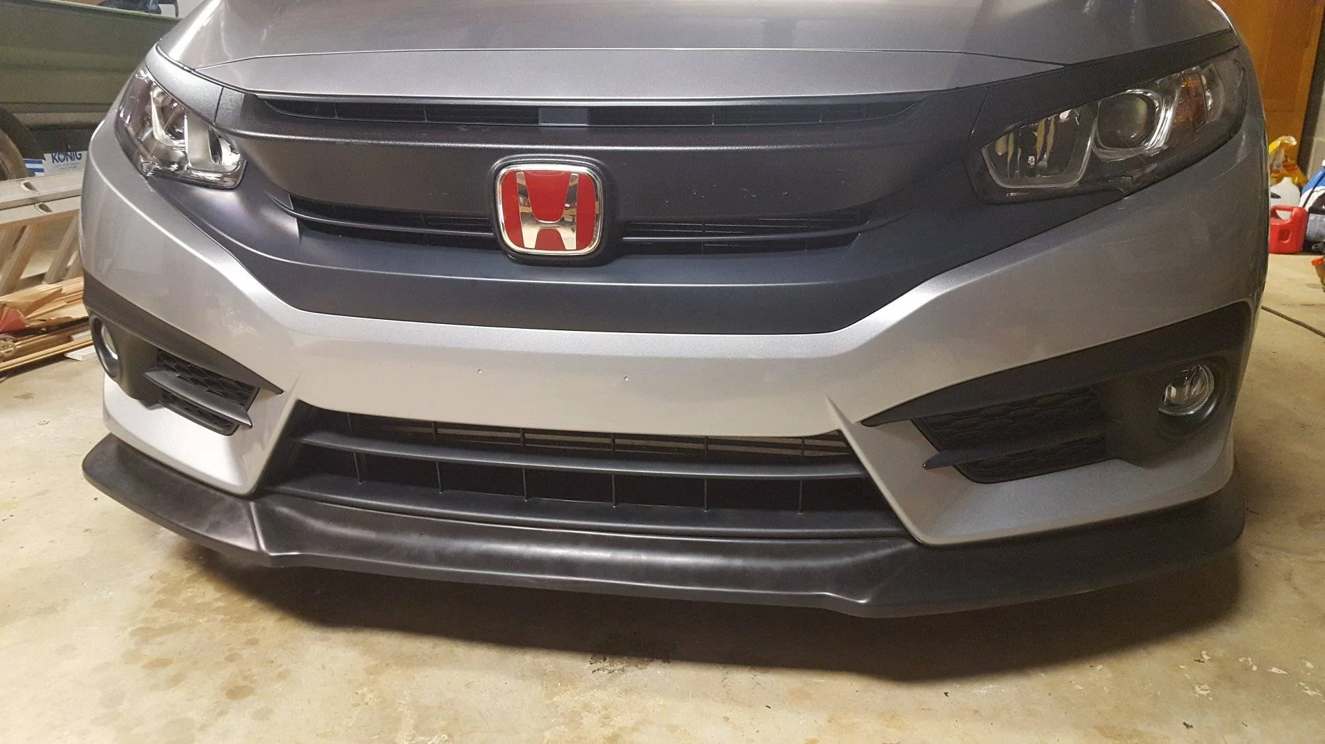

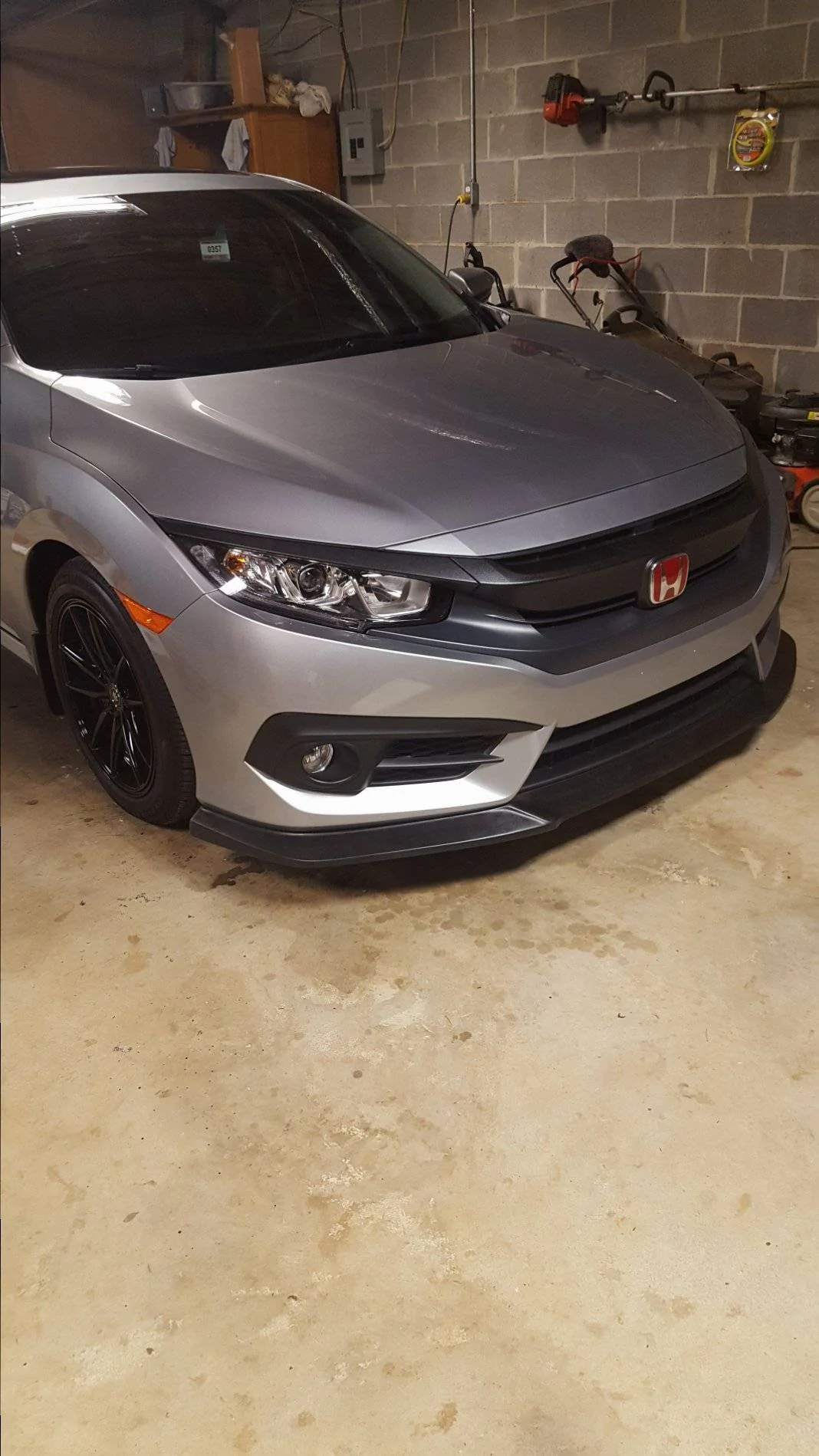

I just installed this lip by myself. This is a two/two and a half hour job. I used 1 inch long 10/32 bolts and nylon lock-nuts with Fender washers on both sides. I used 11 bolts in all. Version 2 of this lip seems pretty strong. There is no way in hell I would put this on with just screws!!!! It was very difficult to get your hand in the center part of the underbody to put the nuts on but, this baby ain't going to fall off going down the road!!!!

Hi andyboyd102:
That look great, using nylon bolt and washers is the best way to mount any lip to fully secure it. If you had a lift, we noramlly take a whole bumper off when installing lip. That way we have a lot more room to make the drill on the underside of the bumper.
