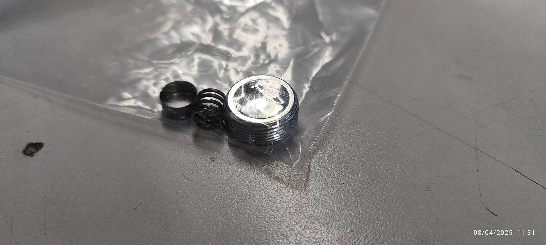

Driving is on the right in all EU (European Union) countries (our steering wheel is on the left -LHD-) except in Ireland, Malta, and Cyprus (RHD). UK (RHD) is no longer part of the EU, which is a real shame because we have always felt very close to them from the continent. We used to shop in the UK without any problems or tariffs, and UK tourism in my country is highly appreciated.

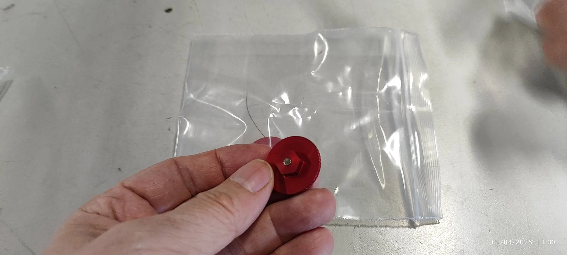

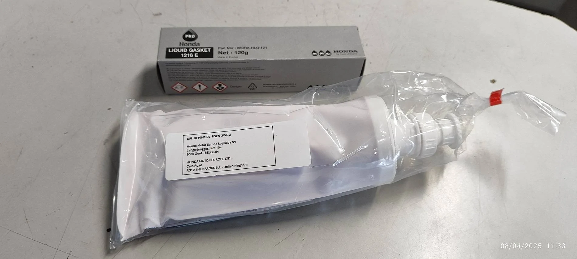

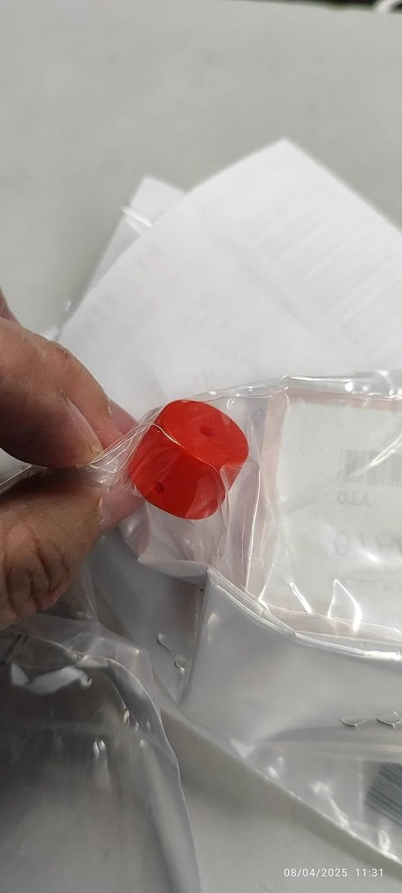

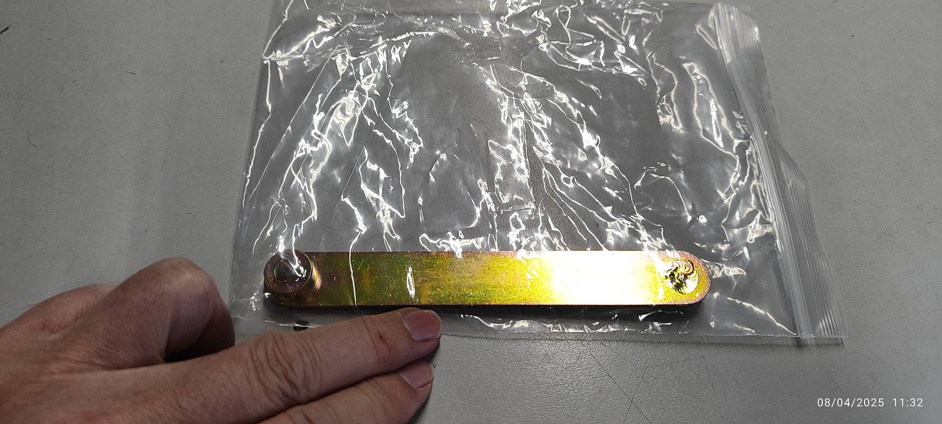

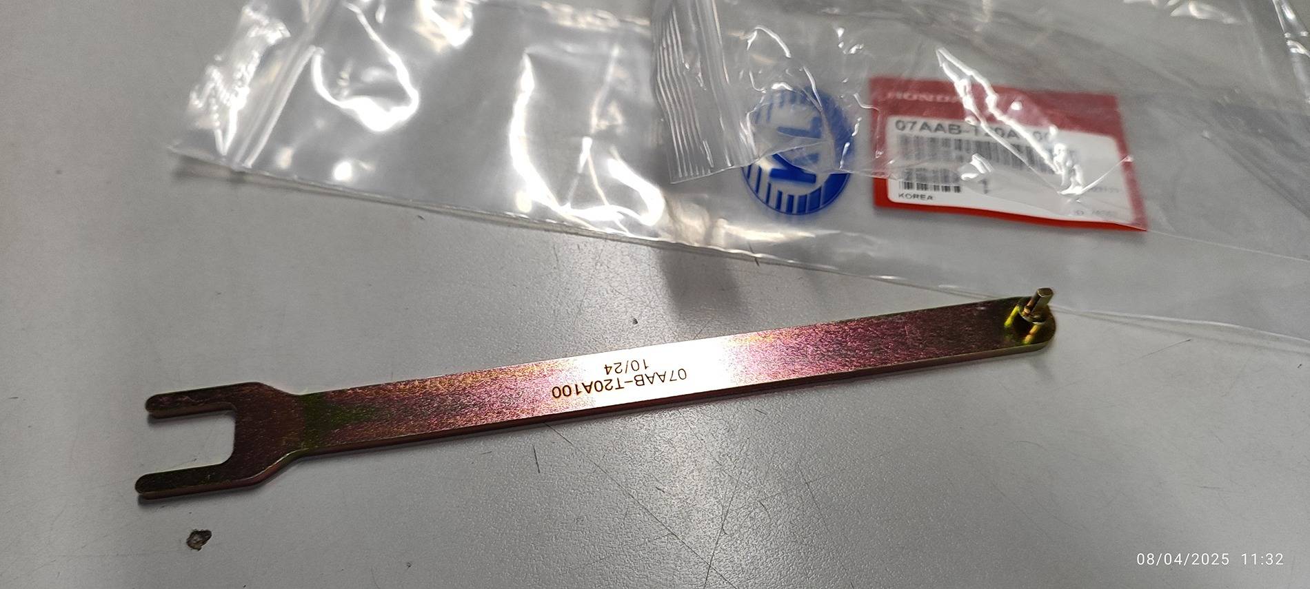

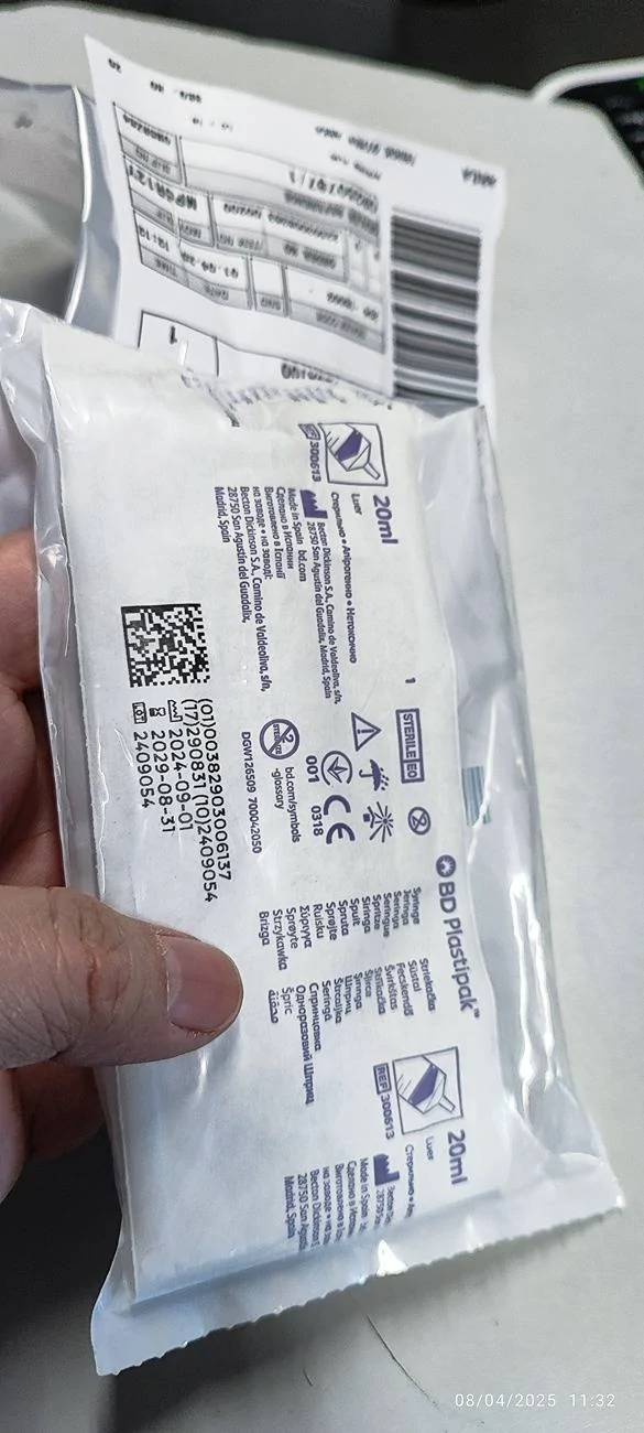

Recall Fix for Civic FL4 (Hybrid), ZR-V and CR-V sold in my country has already begun and repair kits are being sent to dealers.
11th Gen Honda Civic Worm Gear Recall Fix Reviews IMG_20250408_113134
11th Gen Honda Civic Worm Gear Recall Fix Reviews IMG_20250408_113155
11th Gen Honda Civic Worm Gear Recall Fix Reviews IMG_20250408_113221
11th Gen Honda Civic Worm Gear Recall Fix Reviews IMG_20250408_113241
11th Gen Honda Civic Worm Gear Recall Fix Reviews IMG_20250408_113256
11th Gen Honda Civic Worm Gear Recall Fix Reviews IMG_20250408_113312
11th Gen Honda Civic Worm Gear Recall Fix Reviews IMG_20250408_113355
Personally, I think the US solution for the FL5 is less invasive than the European one. In fact, the solution for the FL4, which is the same as the US FL5, only takes 0.6 hours, while the FL5 takes 2.5 hours and requires a complete replacement of the steering box and subsequent alignment.
Otherwise, I think that if the US solution doesn't work, Honda will resort to the european solution, i.e., a complete replacement of the steering box.
