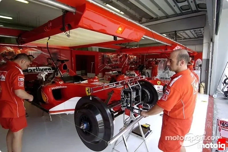

@CaryH a lot of really smart people and most professional motorsport teams disagree with you. I've been doing string alignments on all my cars for a while now and haven't had any issues. I would encourage you to check out some of the HP Academy videos for more info on that topic.
That being said, this thread is not about string alignments vs laser alignments. That is completely irrelevant to the VSA Neutral Position Memorization procedure that Honda suggests you perform after adjusting any alignment settings.
