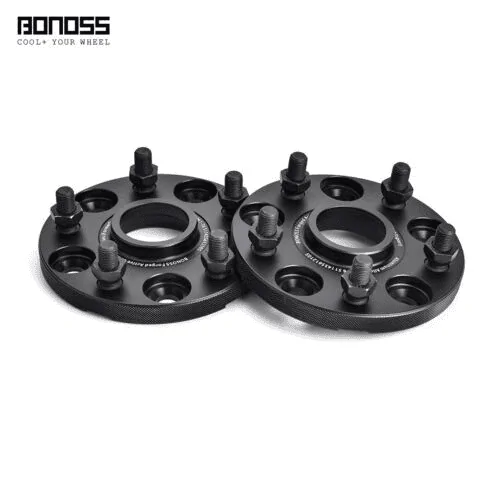

That is correct - the stock studs on the oem hub remains, the spacer is secured to these studs using the supplied low profile nuts. The wheel is then positioned over the studs attached to the spacer and secured using the OEM wheel nuts. The correct spacer is the one above - which is commonly referred to as a "bolt-on" spacer.
The spacer below (which is what I suspect you have tried to fit) is considered a "slip-on" spacer and will not work with the oem studs - the oem studs will need to be removed and extended ones fitted (the extension of which needs to match the thickness of the spacer). Additionally, the extended studs need to be M14x1.5 matching the OEM thread diameter and pitch.

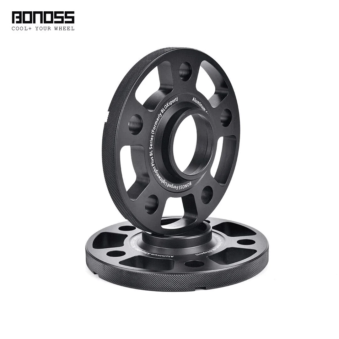

Just got the bonoss spacers I never ran spacers in general so I don’t really have any experience with them. Are the torque specs the same as the wheels at 94ft pounds? What intervals (miles) do I re torque them at?

Thanks, my concern is stud length. Some of the Si/Integra folks broke their wheel locks when torqued because the spacer studs were too long.
Buy H&R or Eibach so u dont need to worry about those studs.
They r made to bolt on and hard driving.

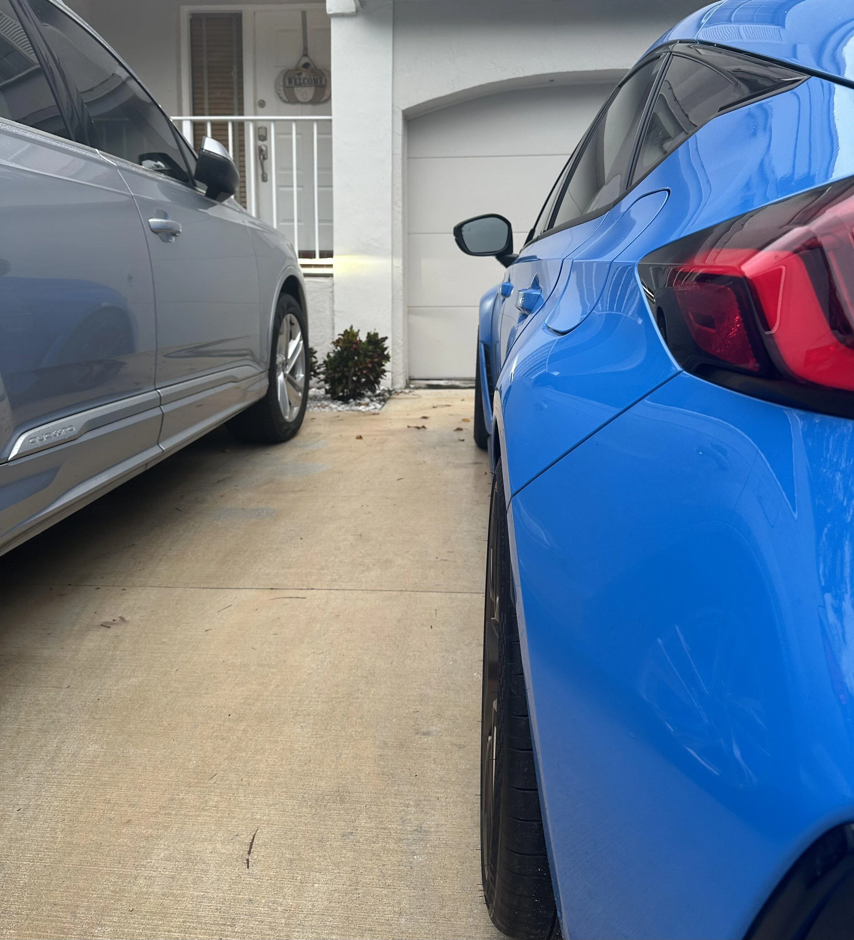

Swapped my Spoon Srings to an Eibach Sportlines.
Running 20mm Bonoss spaces making the stock wheels a +40 offset.
11th Gen Honda Civic The FL5 Civic Type R Wheel Spacer Reference Thread DSC_4172-2
11th Gen Honda Civic The FL5 Civic Type R Wheel Spacer Reference Thread DSC_4184
