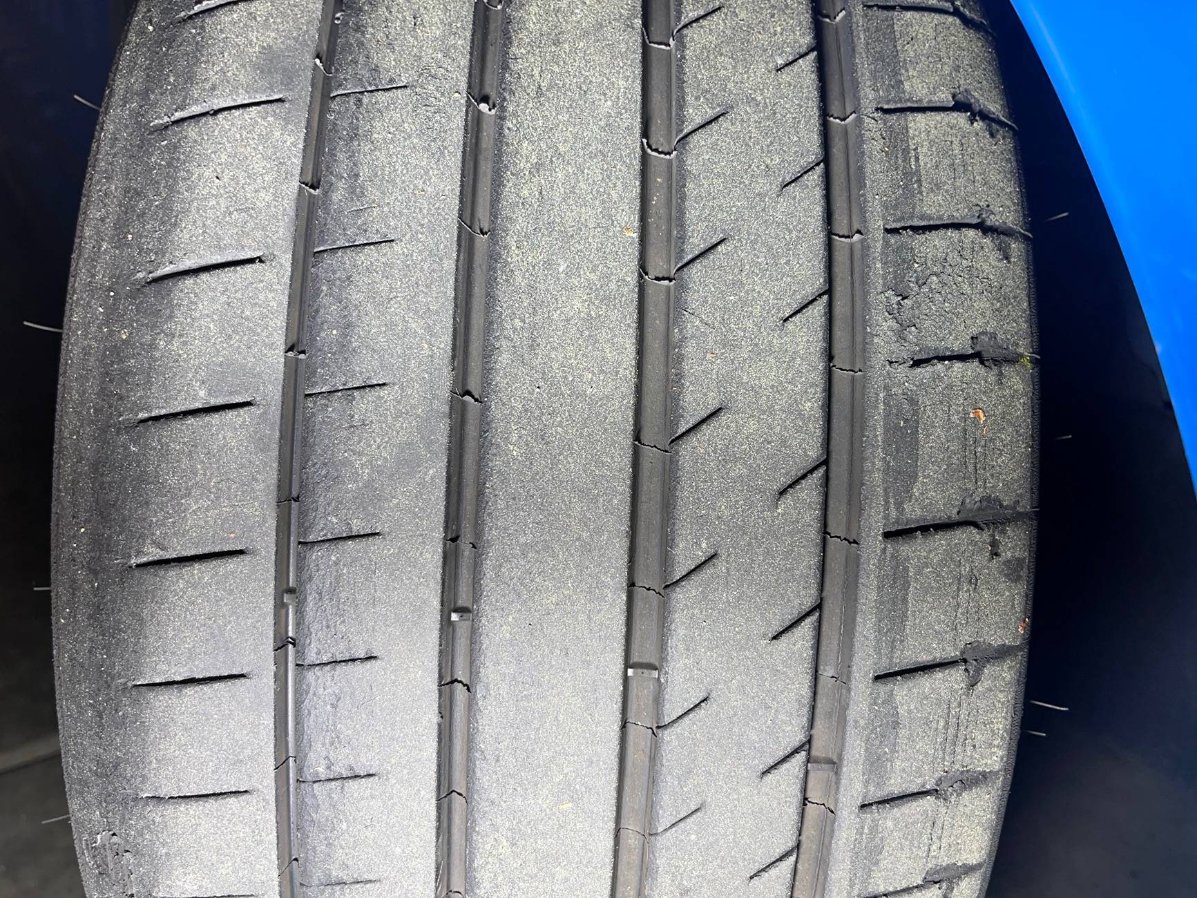

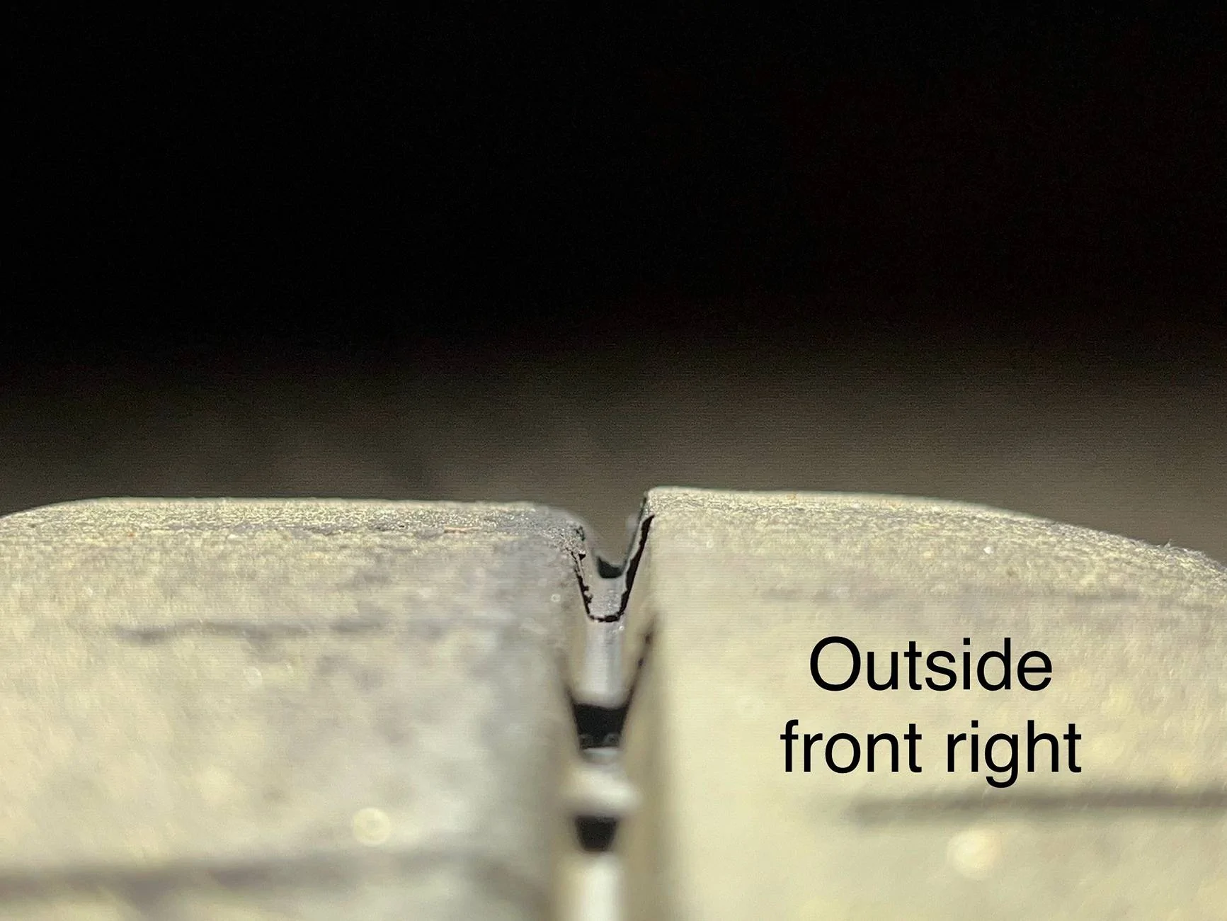

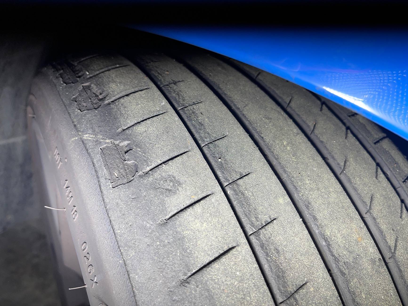

Check this. Was 35 psi cold nitrogen filed too low? I was tracking on 35/32 @tezzasaurusrex
After inflating it to 45 psi, to check tread wear - I noticed the outside is higher - should I have been running higher psi to get even wear and zero toe. I’m understanding the 4s side walls were too weak and needed more psi. And 2MM total toe out started to scrub the inside tires. What does the tire wear tell us.

Going to 45 psi and then tracking your car just seems extremely dangerous.

The car was not tracked at 45psi -
35 psi cold front 32 cold rear
We pumped it up to 45 psi - to take a look at tread wear.

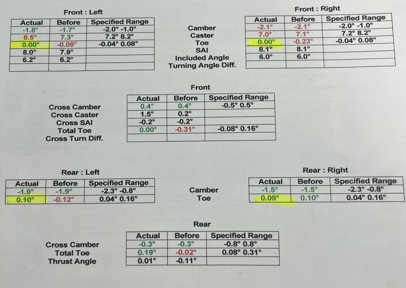

New Alignment specs:

That alignment looks like how I'd like to drive around, which would be fine on the street. I would put more front camber based on how your tire wear, but you'd like to be as close to stock spec as possible.
Tell us more after you get some laps with the Cup 2.

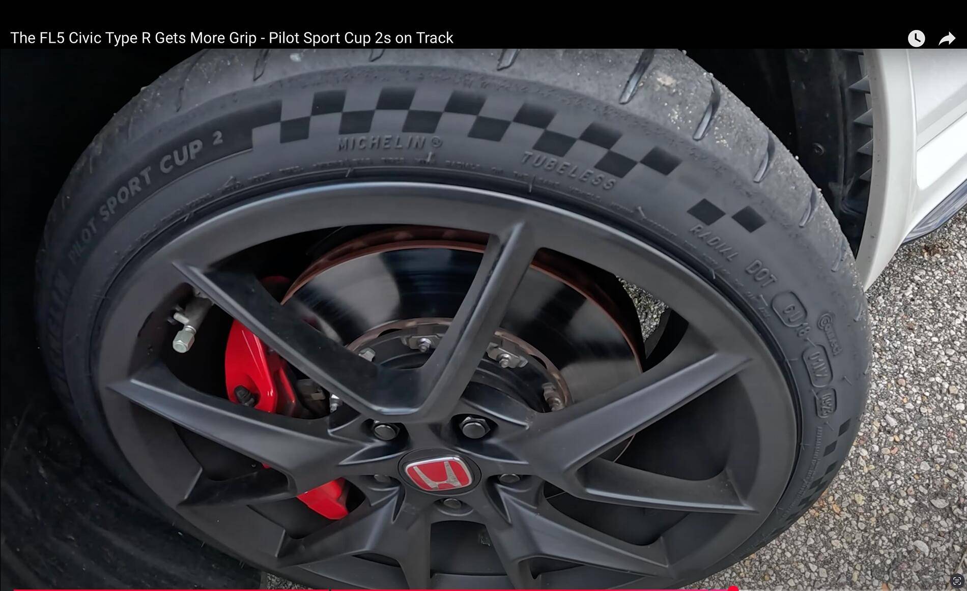

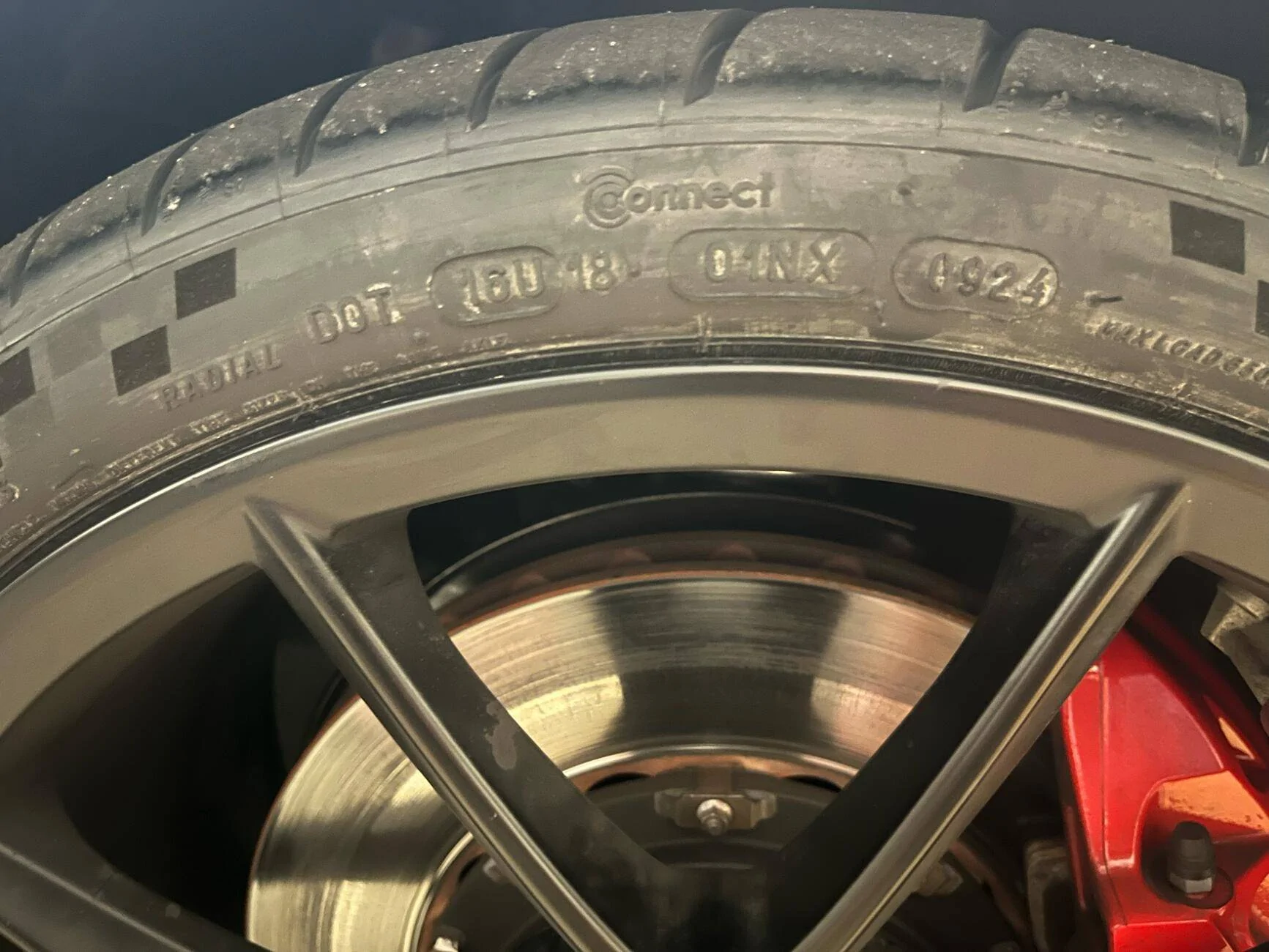

More interesting fun facts. Spoke with Michelin, they actually said the Cup 2 Connect should be the same as the Honda HO, and they are both improved versions of the Cup 2.
Here is some more information that validated that:
https://www.thedrive.com/guides-and-gear/michelin-pilot-sport-cup-2-connect-tire-review-test
And TheTopher's CUP 2's Honda gave him after a Type R track day, do say Connect, and match my tires exact numbers. . So maybe these are the same as the HO's?

What's for sure known knowns - is both the Cup 2 Connect and Cup 2 HO ( Honda Optimized ) are improvements over the previous gen CUP2, but I'm not totally sure yet if the HO version is a bit different. They both have the same tread pattern, which is different than normal cup 2's

Even though the tread pattern is identical, the HO version may have a different compound layout/setup than the standard Cup2 and should have "HO" stamped somewhere on the sidewall. You will have to drive both versions and see if you can tell the difference.

The HO will definitely have HO stamped on the sidewall. I've had them.
They are also both 240TW...the HO is not lower treadwear.

I did realize I had close to zero toe on the rear previously, and is why maybe I didn't feel understeer. I did have 2.5mm toe out total in front and close to zero rear - and now it's Zero toe in front and 1.5MM toe in on rear and can feel it does feel this could cause it to understeer.

Do you still recommend zero to on stock suspension with pins out -1.8 negative camber in front, or a touch of toe out, and is 1.5mm toe in on rear too much? I understand with more than -2 negative camber, everything should be closer to zero all the way around.

I don't know if I've ever recommended -1.8° or any amount of toe out on the car, not sure why you ended up running this set up.
The separation of rubber on the outside shoulders is a clear indication of excessive load and heat, so you need to run more negative camber.

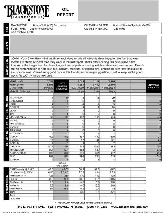

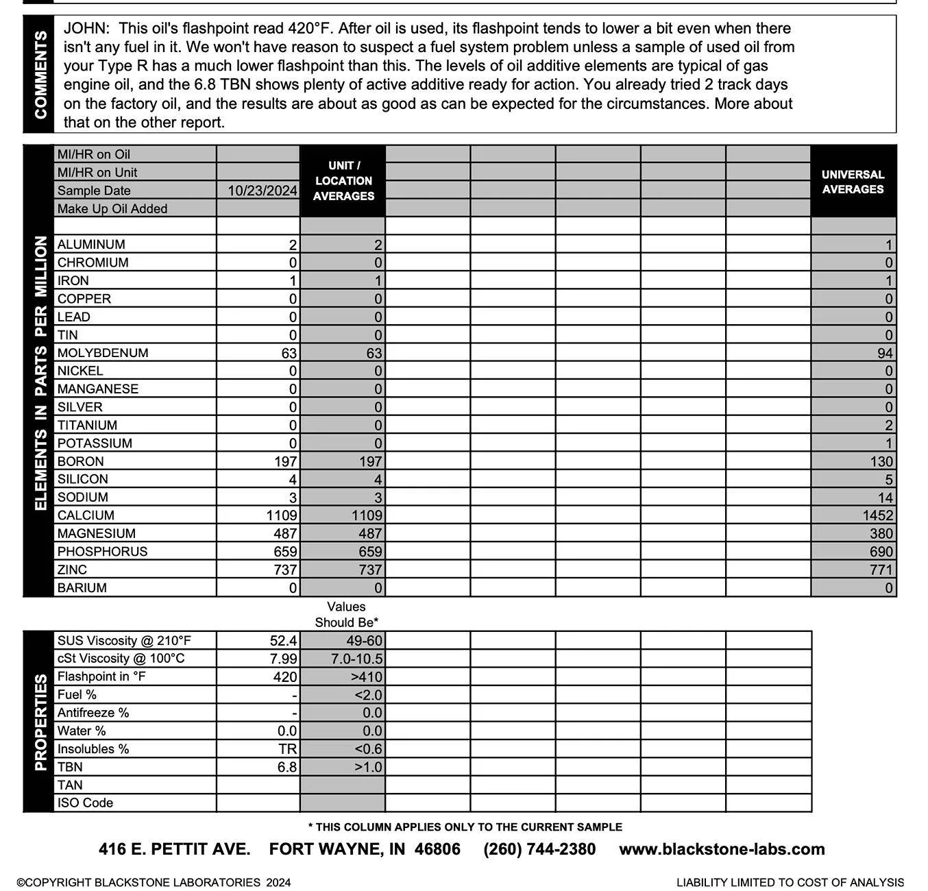

1) Honda Ultimate Engine Oil Analysis - Looking Excellent - After 3 Track Days - Aluminum is down to 5ppm in total, but really it's down to 3ppm as the virgin oil has about 2ppm of aluminum in the fresh oil.
2) Engine Temps decreasing? - What's interesting is my car used to get up to 279F oil temp when new, the last oil change it max I saw was ~257F, and today at Laguna Seca, with the newest oil change, ~247F max on track..... hmmmm
