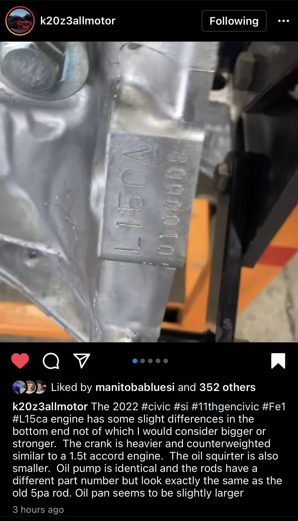

@D-RobIMW any guess on honda changing lower internals and fuel system to something more juicy

So is the Si Turbo different or is it the same as the non Si 1.5T?
Curious what is different on the engine.

That's very interesting. Great post. Do you know if for sure the intake side does indeed have the traditional variable lift VTEC mechanism, or is it just VTC?
I know the L15CA has variable lift VTEC on the exhaust side as well as VTC, but on the non-Si I'm under the impression the variable lift VTEC is more for fuel economy (as in the valves can go into a low lift mode maybe when cruising or in other scenarios). It would be nice if Honda added some extra lift capability on the exhaust side of the Si motor.
