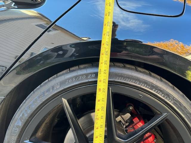

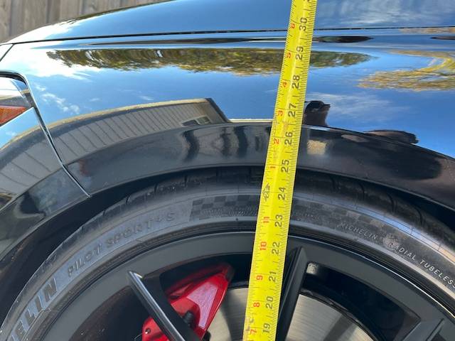

FWIW, I had MPP/KW coilovers on my 2019 Model 3 Performance and thought they rode perfectly on middle-of-the-road damper settings. So I've been hopping to have a similar ride quality and sharpness for the FL5. I've been wondering whether my preload on the Ohlins is too low, so took a look today at the perch measurements to confirm whether they were on the recommended values:
  • Front: 170mm height of front springs, on jack stands, wheels off (this means that there is only 1-2 threads below the bottom perch lock nut)
  • Rear: 12mm of threads above the rear spring perch, 215mm of height on the damper body
I found that while the rear was in spec, the front was maybe only 150mm, meaning about 20mm of threads below the bottom perch lock nut. Adjusting this to 170mm meant lowering the front even further.

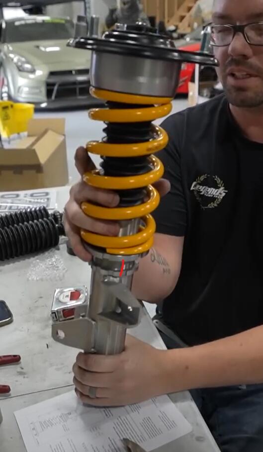

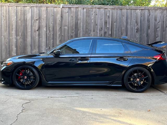

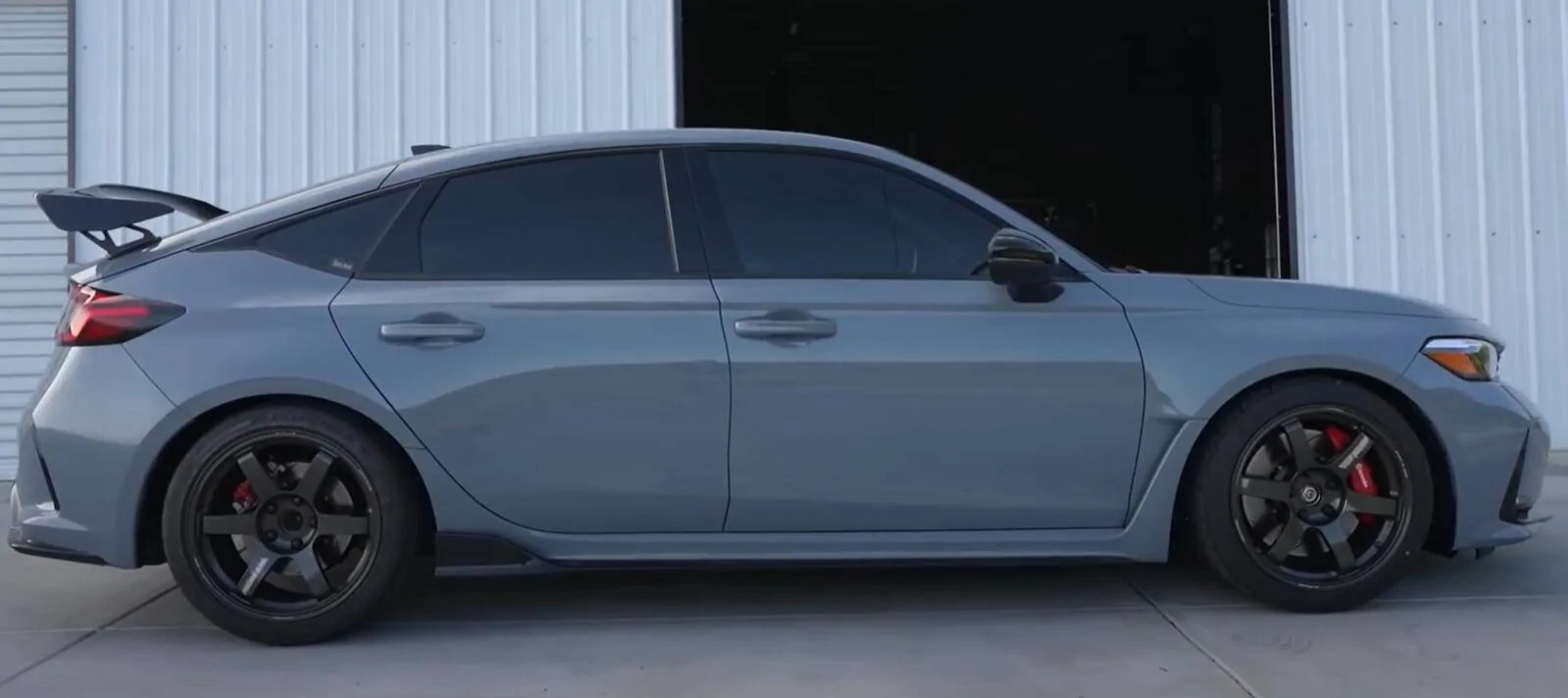

I've looked at various videos on YouTube and photos in this forum to see what ride height looks like for Ohlins, and the far majority of times photos look like the car rides MUCH higher (especially (608) Dustin Williams - YouTube). I know that Ohlin isn't meant to "drop" a car so low, but below are photos I took today after I made the adjustment to 170mm. Looks like the recommendations (for me at least) resulted in a slight forward rake (1/2").
@SakeBomb Garage I reached out to you to see if you had any advice, even though I didn't buy the Ohlins from you (though I did buy the cancellation kit from you). I bought the Ohlins from Tire Rack.
I'm still hoping that there's something wrong that is causing the ride to be rougher than I was hoping (I experiment bet ween 10-20 clicks), and this disparity in ride height makes me think there still might be something going on. I can see how more preload (higher) gives more travel, but also means the initial spring strength in higher - not sure which is more related to my issues.

11th Gen Honda Civic Ohlin DFV Height & Ride Quality 1733525026228-v8
This is the Dustin Williams screenshot I'm referring to.
Driver32503
Jun 3, 2024
And here's a quick screenshot of the front coilover that's been adjusted (according to them) to spec. Clearly more threads than I had showing below the perch nuts.

He also went with different wheels and tires on his FL5, I believe they went with 18 inch wheels with a 35 sidewall tire, compared to the stock 19 inch wheel with a 30 sidewall. That increase in sidewall will make it a little bit more comfortable.

sugarl4nd
Andre
Aug 29, 2023
128
174
Sugar Land, TX
2023 FL5 CW & 2021 FK8 LE Phoenix Yellow
Yea, but I’ve measured the rear and it’s spot on from the instructions, and I’ve confirmed the 170mm measurement for the front preload. I think pictures of the threads from another install would really be helpful. @sugarl4nd do you have any advice?
Hey, it's been a while since I login to the forum. Has been busy with work & travels. I just took exact measurement of front & rear (in order for you to do comparison with my set up).
My front measures : 25.75" and my rear measures : 25.25" with 19" wheels. Mine is slightly lower than stock height but not by much and also has slight rear rake ~ 0.5".
Hope this helps you to figure out the issue.
