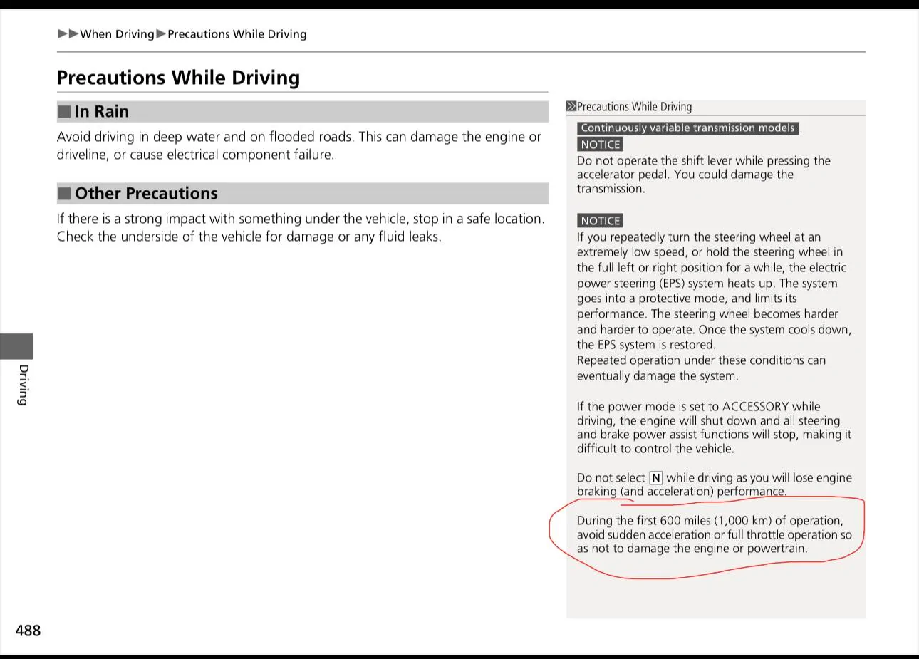

Page 488 in the 2024 manual.
That's crazy how hidden it is in the manual. I just looked at my 2025 manual and it's on the same page, etc. Thanks for brining my eyes to it!

Yeah you can’t miss it! 🤣🤣🤣
It is silly how it’s buried in a side note that’s not even really related.
Yeah. 2023 NA manuals were missing a few key pieces of info, but EU manuals were seemingly complete. That’s where the 600 mi (1000 km) break-in period came from. Honda eventually added the missing info to NA manuals.
I think the lug nut torque spec is missing from the 2023 manual as well…so for awhile we just tightened the lug nuts real good. Then tightened a little more. Patted the fender and said “Yep. That’ll do it.” No one has reported problems with this method. It’s 94 ft lbs in case you trust your torque wrench more than me.🤣
