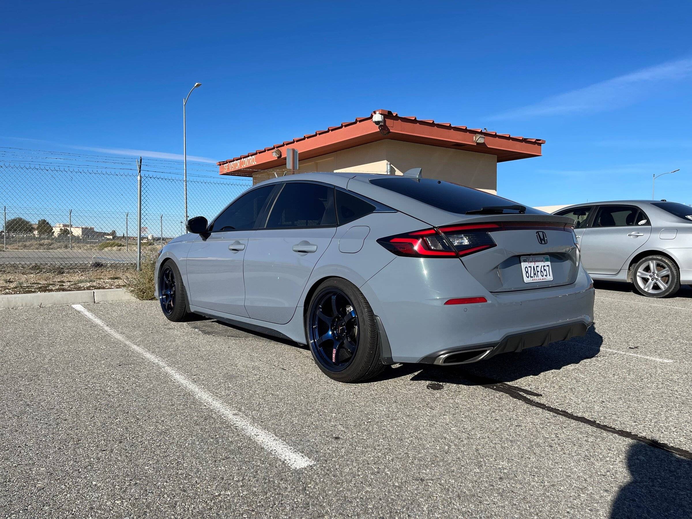

Quick picture before work. Ordered the new 27won RMM today so will install that and CTR RSB together :thumbsup:
