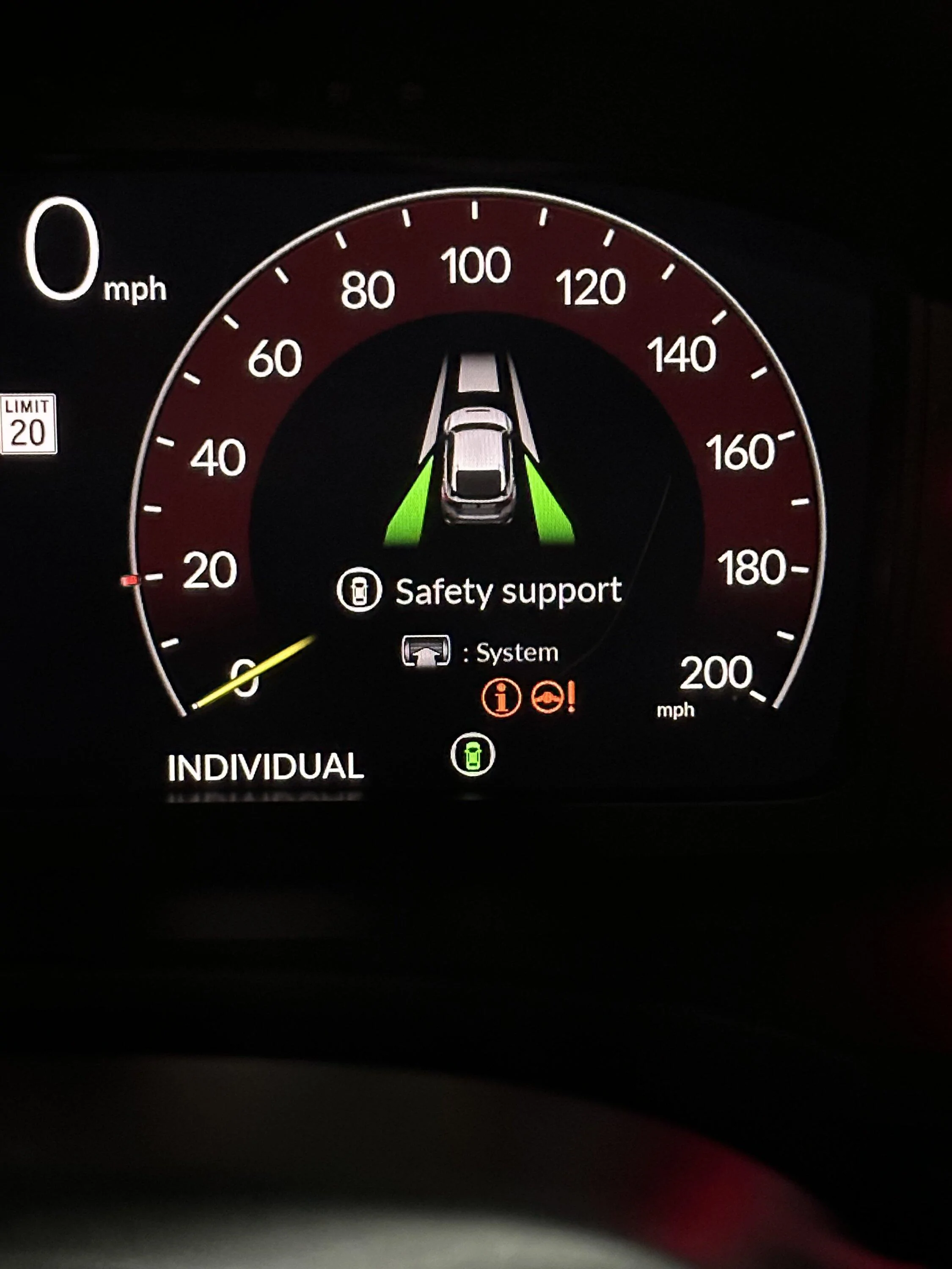

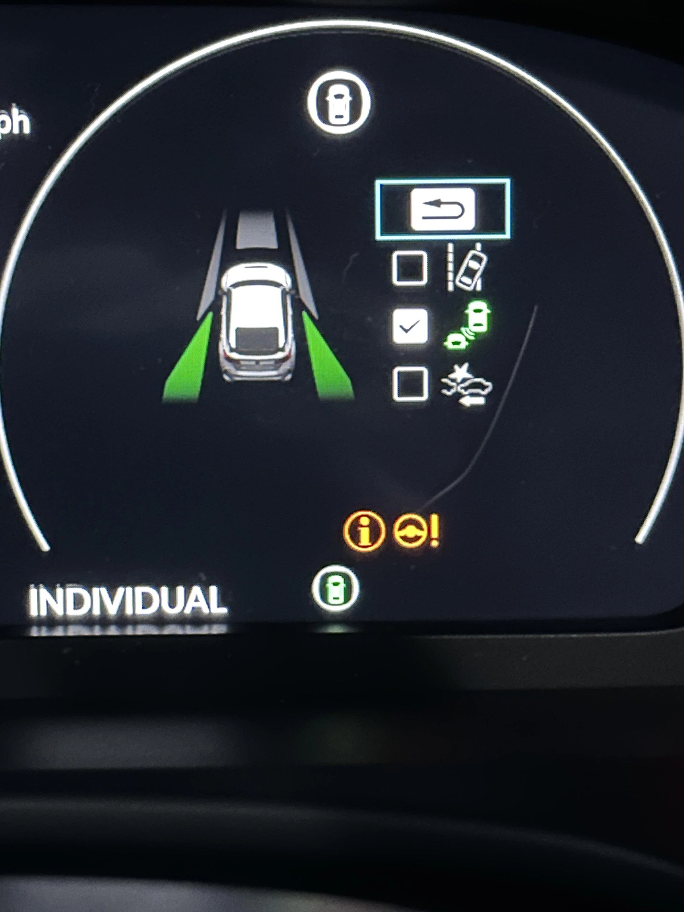

You have to put it in warning only in the infotainment. And I also switched off as many assists as I could on the gauge cluster. Lane keeping assist will stay off but collision will turn on every time you restart. So you have to turn it off every time.
11th Gen Honda Civic Lane assist & auto brake disabled IMG_2121
11th Gen Honda Civic Lane assist & auto brake disabled IMG_2122

You left Blind Spot Information System on! Boo! I turned that off day 1. I look anyways, and the flashing yellows get annoying.
Jester04
1,973
2,475
Lol I always look also but blind spot does not bother me since its only a warning. What really bothers me is the car doing something that I don’t want it to do.
