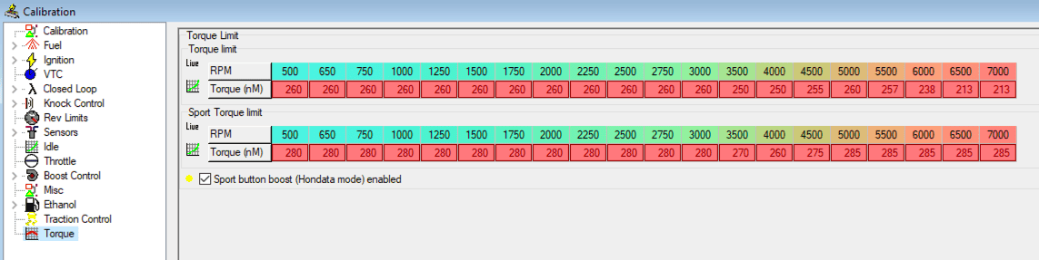

I'm aware of that but was wondering which specific parameters makes one tune CARB legal. I assume anything related to emissions but which specific parameters cannot be modified?
You cannot alter fuel, ignition, error codes. You cannot change anything associated with the secondary oxygen sensor. You can alter boost because we retain the stock Honda code for providing fuel and ignition at the different boost levels. Here's how to do it. Edit the torque tables:

Is the checkbox for ‘sport button boost’ in the above torque table image an indication that one could set up the calibration to only be applied in sport mode? In other words, ‘normal’ (and ‘individual’, I guess) would retain the stock ecu settings?
I believe so. The torque values for both tables are different so that would suggest the "sport" mode changes the boost level to a higher amount. I'm not sure at what boost pressure how much torque is produced across the rev range. After looking at the "250/250" tune, the highest torque value is 300 nM but converts to ~220 ft-lbs.
